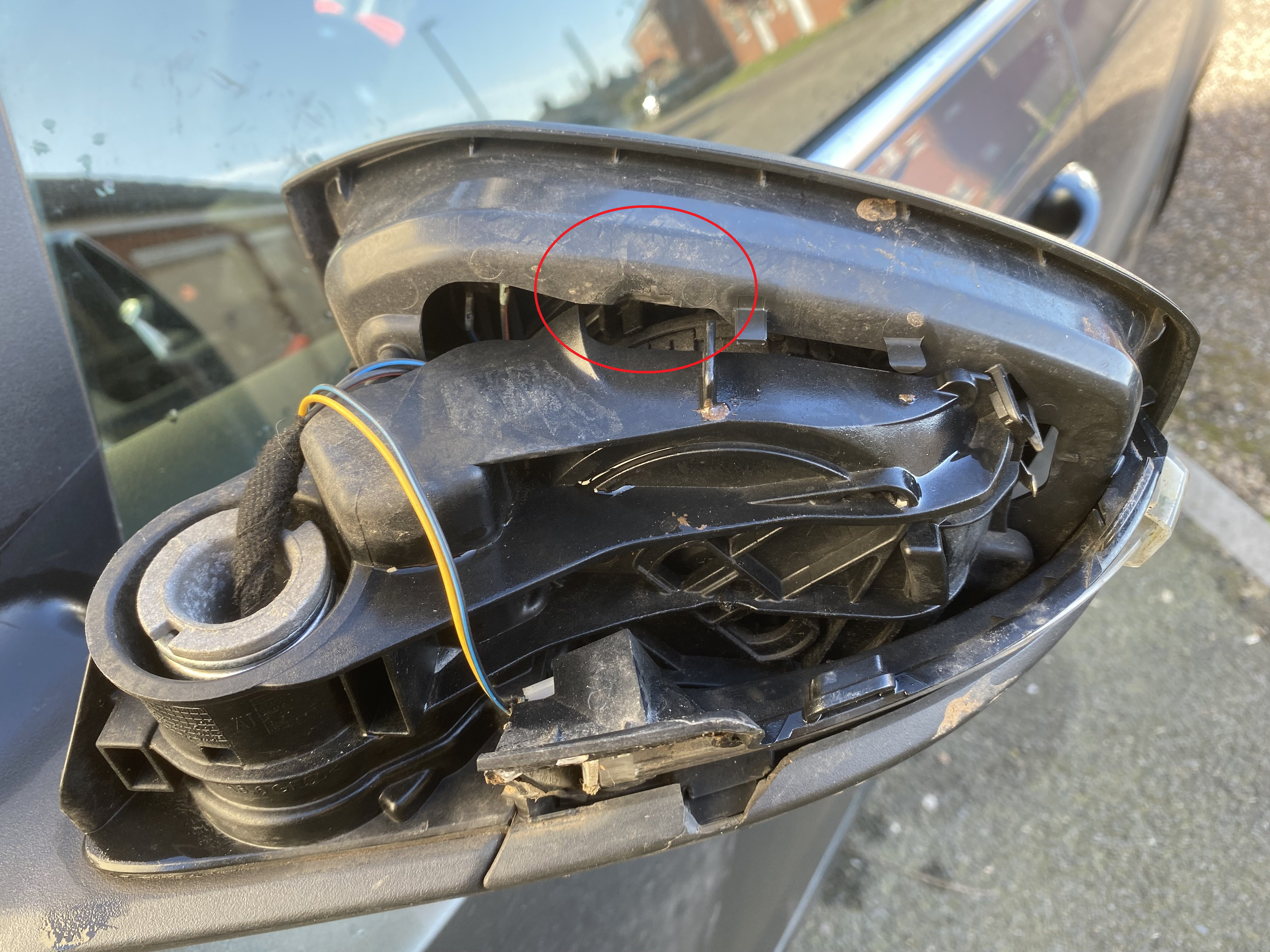

Replacement wing mirror on MK3 Octavia Estate not staying firmly clipped in
Probably broken clips - I assume you're replacing the other plastics so I'd just wait for them all to arrive. You can see the two clips on the new cover, take a look at see if there is anything for them to clip into. Certainly looks like something has snapped off here:

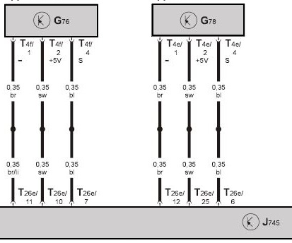

2010 Superb 2 Xenon Headlight aim codes 00496 00497 01537
I think the AFS master be behind the climate control panel as I'm pretty sure the MK2 Superb is similar to the MK2 Octavia in this regard. Snippet of a wiring diagram: If I remember correctly: - J745 is the AFS master - G76 is the rear sensor - G78 is the front sensor
At a guess, it's either an issue with the internal voltage regulator in the AFS master control module or there is a wiring issue between the AFS master and sensors shorting out the power line... I expect both sensors share a power supply but I know they have separate pins on the connector for each sensor. Should be a very easy job to disconnect the AFS master connector and then beep the wiring out to each sensor to rule out issues.
