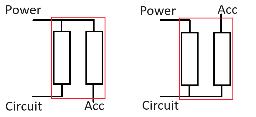

  11. I think you're over thinking it... It makes little difference which direction the piggy pack fuses go as they are very simple things: Fitted in the 'wrong' direction, both the original and new device will pull current through the original fuse which 'could' cause it to pop. Given the current use and likely fuse rating for a dashcam, this is unlikely so either orientation is fine and both circuits are still protected I would rather have the piggy back holder held in at both ends (so an existing circuit) as it's the only mechanism to secure it in place. Cars are subjected to lots of bumps, jolts and vibrations so it feels a safer option to me.

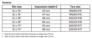

  15. From the snow chain section of the 07/2018 owners manual: That suggest some 15" or 16" wheels might fit but it'll depend on the size of your front brakes I think you have the wrong tyres sizes... The profile alone doesn't dictate the side wall height as it's a percentage of the tyre width. So a 255/45 will have a larger sidewall than a 205/45 tyre. Anyway, a 'normal' Octavia (not Scout) runs: - 6J x 16” for 205/55 R16 (~112.75mm sidewall) - 6,5J x 16” for 205/55 R16 (~112.75mm sidewall) - 6J x 17” for 205/50 R17 (~102.5mm sidewall) - 7J x 17” for 225/45 R17 (~101.25mm sidewall) Changing to 205/55 R16 would give roughly a 1/2 inch difference in sidewall height. Changing to 195/65 R15 would give roughly a 1 inch difference in sidewall height (~126.75mm sidewall). I assume you've checked the pressures are correct and tyre are decent quality...?
