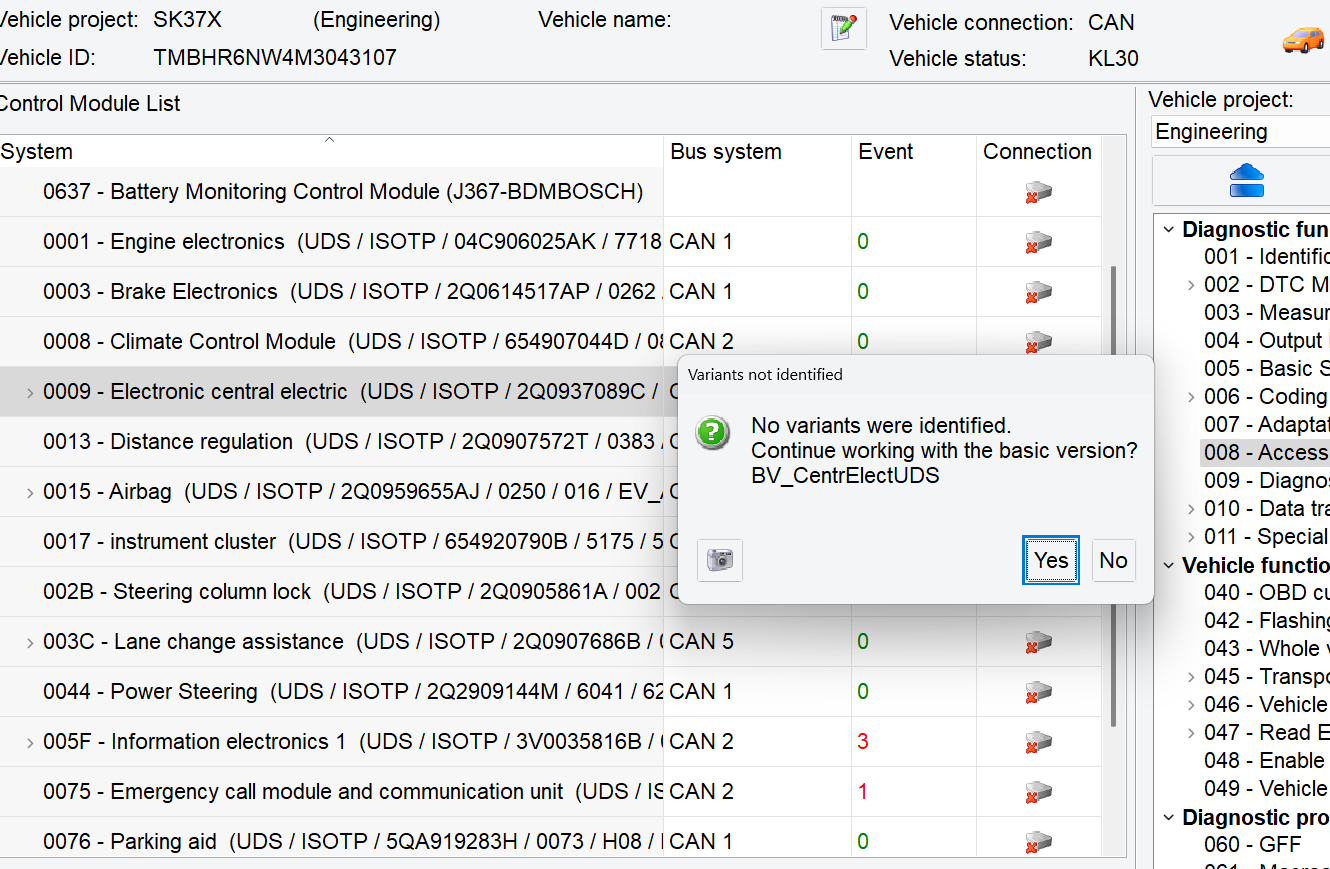

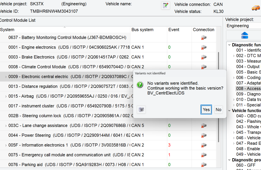

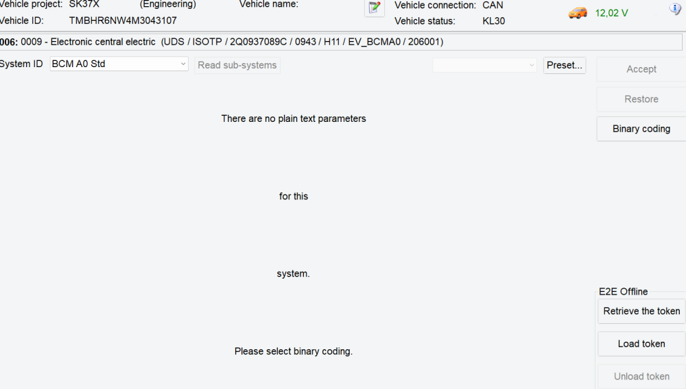

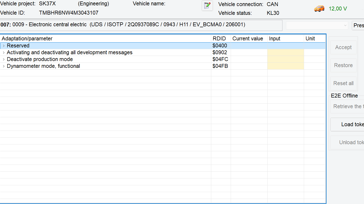

  1. Problem solved. When I connected ODIS it auto-identified the car. In the attached screen shot you can see that it says SK37x. But the Kamiq is a SK27x. When I changed this manually ALL controllers were read without issues and coding was a breeze.

  8. Hi, So a swap is out of discussion. Do you have an idea why I am unable to see the adaptation channels? Other people seem to be able to see them and change the coding.
  9. Hello, I wanted to do some coding on a 2020 Kamiq SEL using ODIS. As the title says I was unable to code 09. I was expecting loads of Adaptations and Plain text / Long coding, but instead this is what I saw with NO options at all. Stg 03 is a similar picture. Is this an issue with ODIS? But I can easily read and code STG 03 and 09 in our SIII. My next thought was, do I want to swap the BCM for a newer or more "advanced". Are BCMs on Kamiq easily interchangeable? The 09 is a BCM A0 Std with PN 2Q0937089C.
