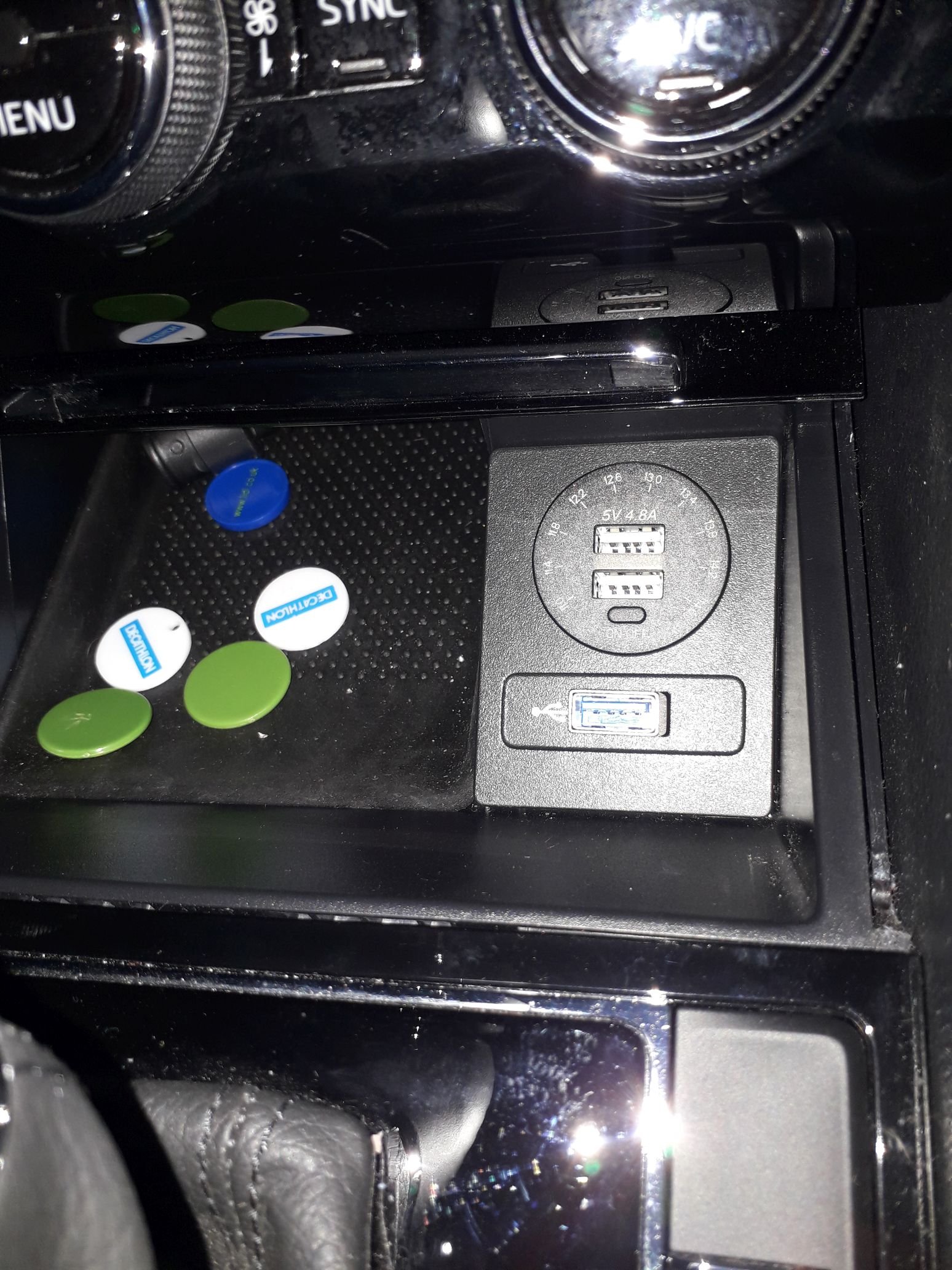

  18. I got the USB socket from Aliexpress because I ordered other bits from there, but you can find it on Ebay too. eBay UK12V Car Cigarette Lighter Socket Dual QC3.0 USB Ports Fas...Model: QC3.0 & PD. QC3.0 output: DC 4.5V/5A, 5V/4.5A, 9V/3A,12V/2.5A. Model : Dual USB. With a switch, you can freely switch display mode or turn on/off the power;. PD output: DC 5V/3A, 9V/3A, 12V/2.5

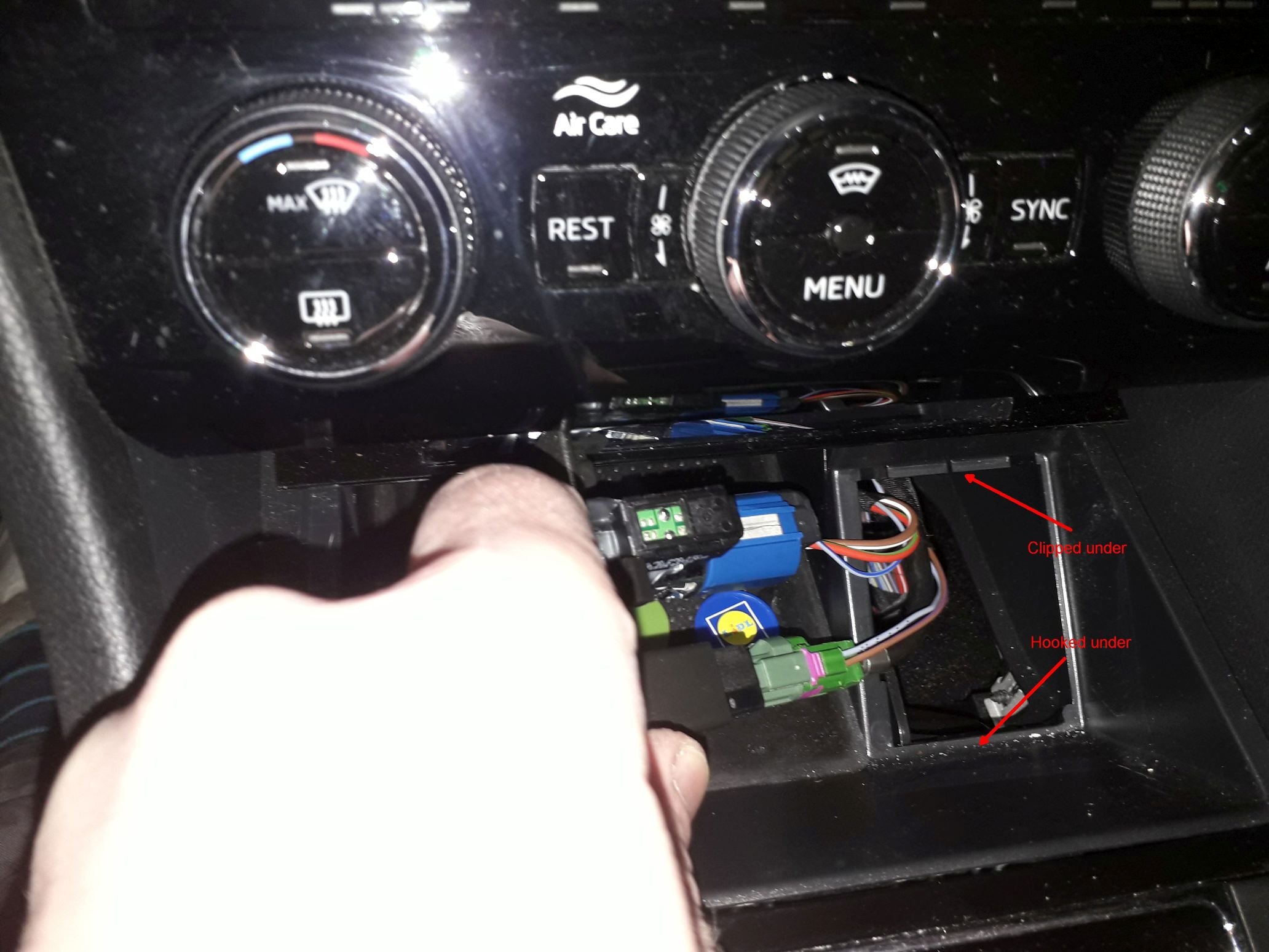

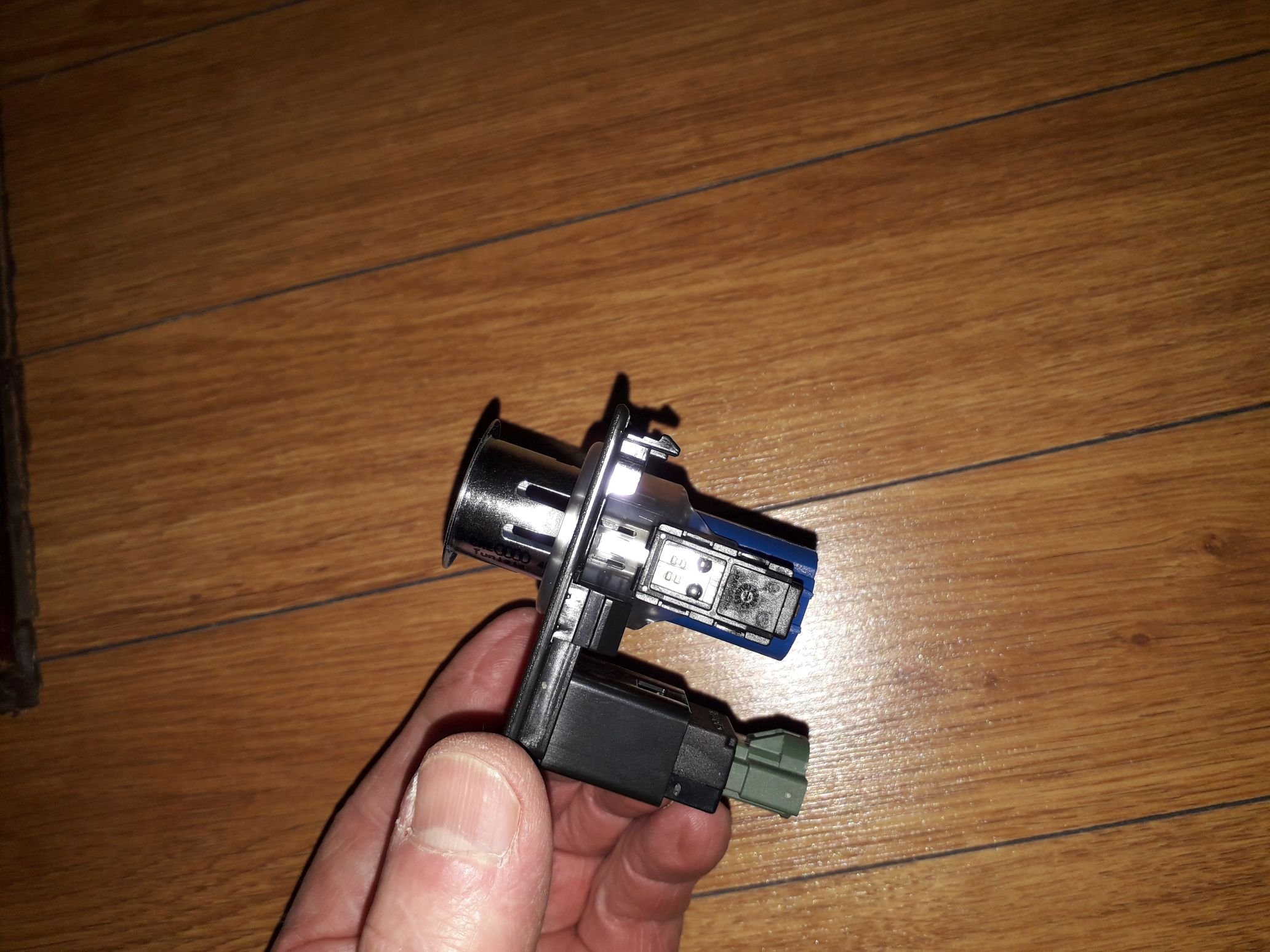

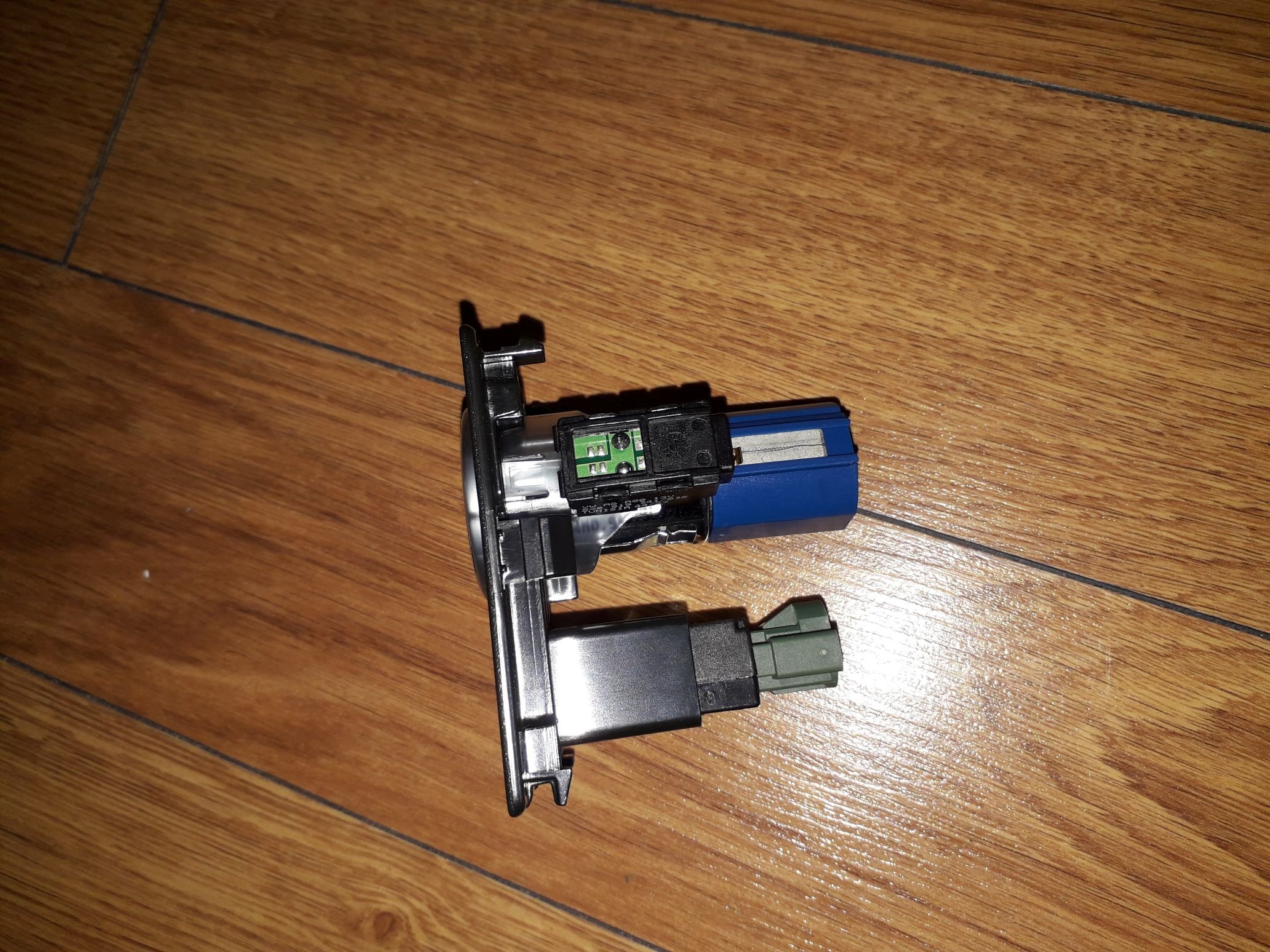

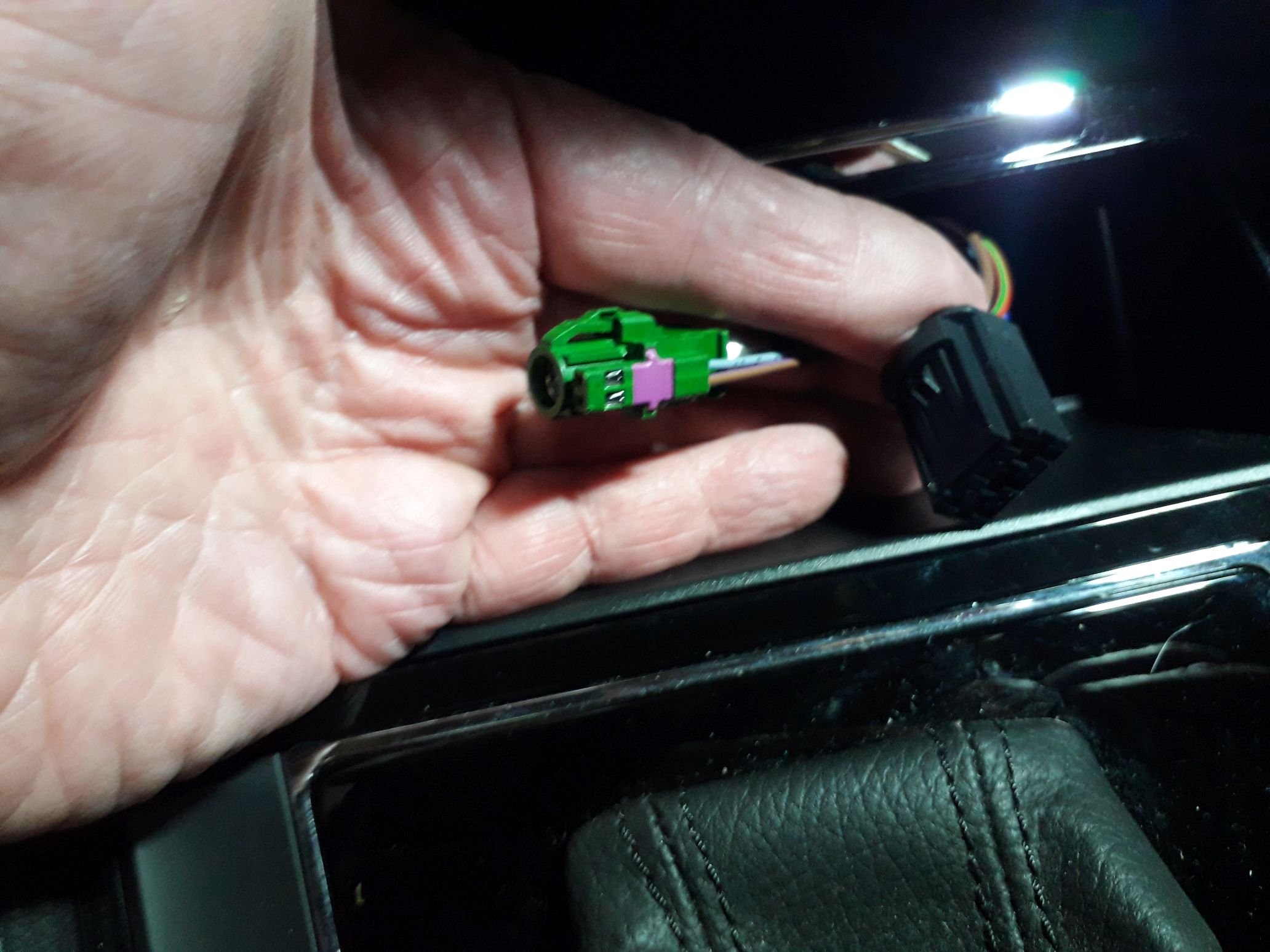

  19. And back to my original thread title - front cigarette lighter replacement. The socket can be unclipped by lifting the front end with a trim tool. The back is hooked in. The lighter comes out quite easy once removed. Just push a couple of clips and it slides out. The whole in the plastic flap needed to be slightly filed out as it was too small to take the USB socket. I soldered the USB wires onto the 12V and earth. Access is not the greatest but works.
  20. My idea was to not use an adapter but to replace the complete cigarette lighter. It worked well on our last Superb.
