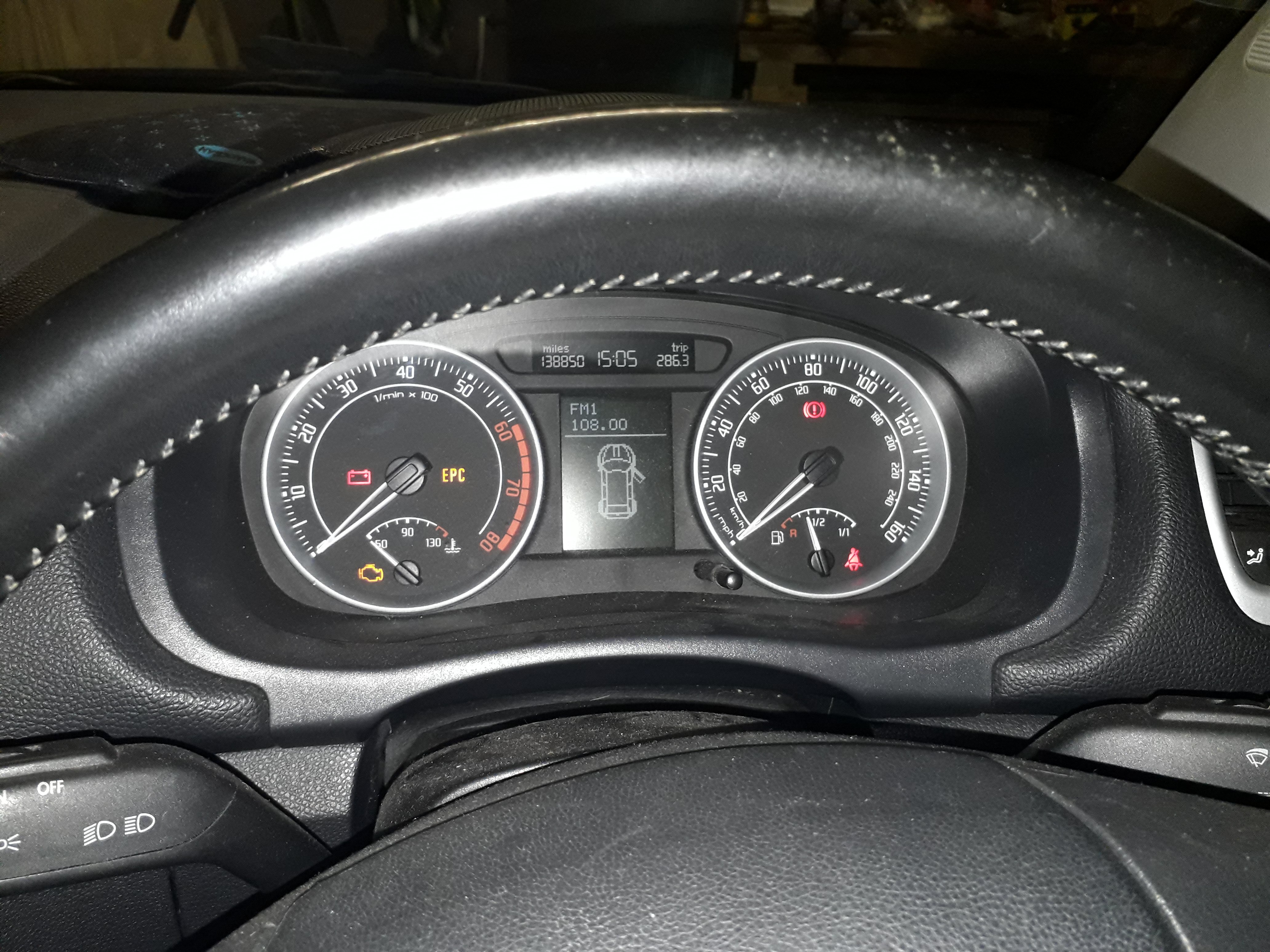

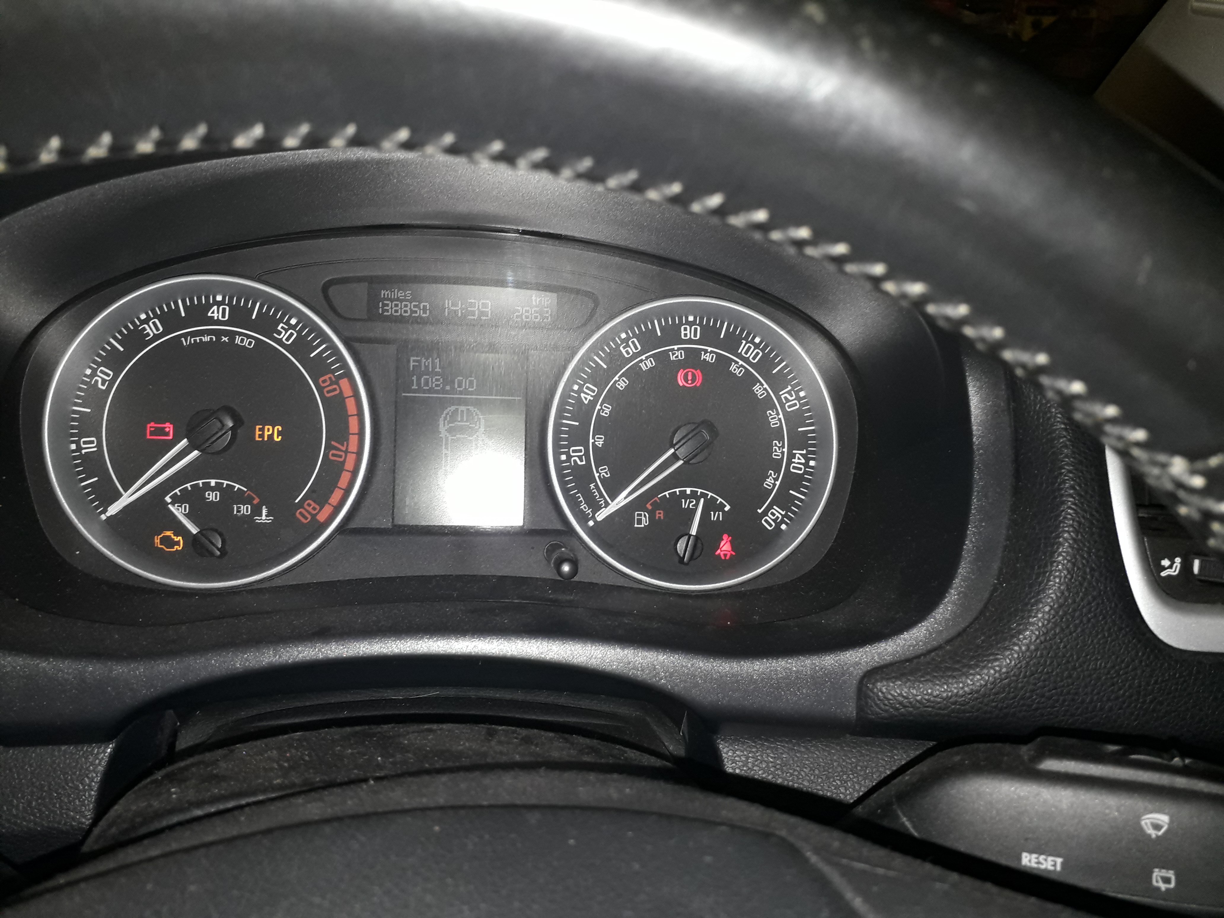

  11. This is an update on the reverse display of the fuel gauge. Today I changed the BCMs - replacement out and an old one I still had but with no functioning wipers in. I took pictures... Reverse display Correct display As you can see on the clock they are 30 minutes apart. The BCMs have the exact same PN and nearly the same age. The biggest difference is that the BCM I bought as a replacement for the failed one came from a VW Fox from 2009, so the same year as my daughter's FII. I need to find some pin outs for a 6Q1937049F BCM for a Fox. I have been checking the FII pin outs and nothing indicated that there is any connection to the fuel gauge. Maybe the FL ones do but they are a complete new design. I had started to make plans to replace the complete electrics from dashboard, ignition barrel, door lock, keys... So, the Fox must be using a different wiring with the same PN.

  18. The fuel gauge is working in reverse with the old and the replacement fuel sender. I still have the previous BCM and can try that again. On the wiring diagram the fuel pump / sender do not have a link to the BCM.

  20. Thanks for the dashboard hint. The display is still working in reverse. The car is away again and it will be a few weeks before I can check again. I am still thinking that there is a connection to the BCM fix when there was a short on the circuit board.
  21. I retrofitted HBA to my old SII and it worked really well. I have Matrix LED lights in the SIII now and they are excellent except for when we travel with tourist mode / continental driving turned on that it seems to be unable to blank the oncoming card on the left hand side and I get flashed by lorries and buses. My HBA is coded to be on all the time if the light switch is on Auto.

  23. Just an update. I replaced the sender last night as I thought that HAS to be the faulty part. I think the fault is not fixed as the fuel display on the gauge was the same as before. Unfortunately I did not do any major testing, i.e. level up and level down and electrical measurements. I looked on the wiring diagram again thinking I must have missed a connection but there is only one straight connection into the dashboard. I have not removed the dashboard for inspection yet. That will have to wait as we are going away soon. Any other ideas?
