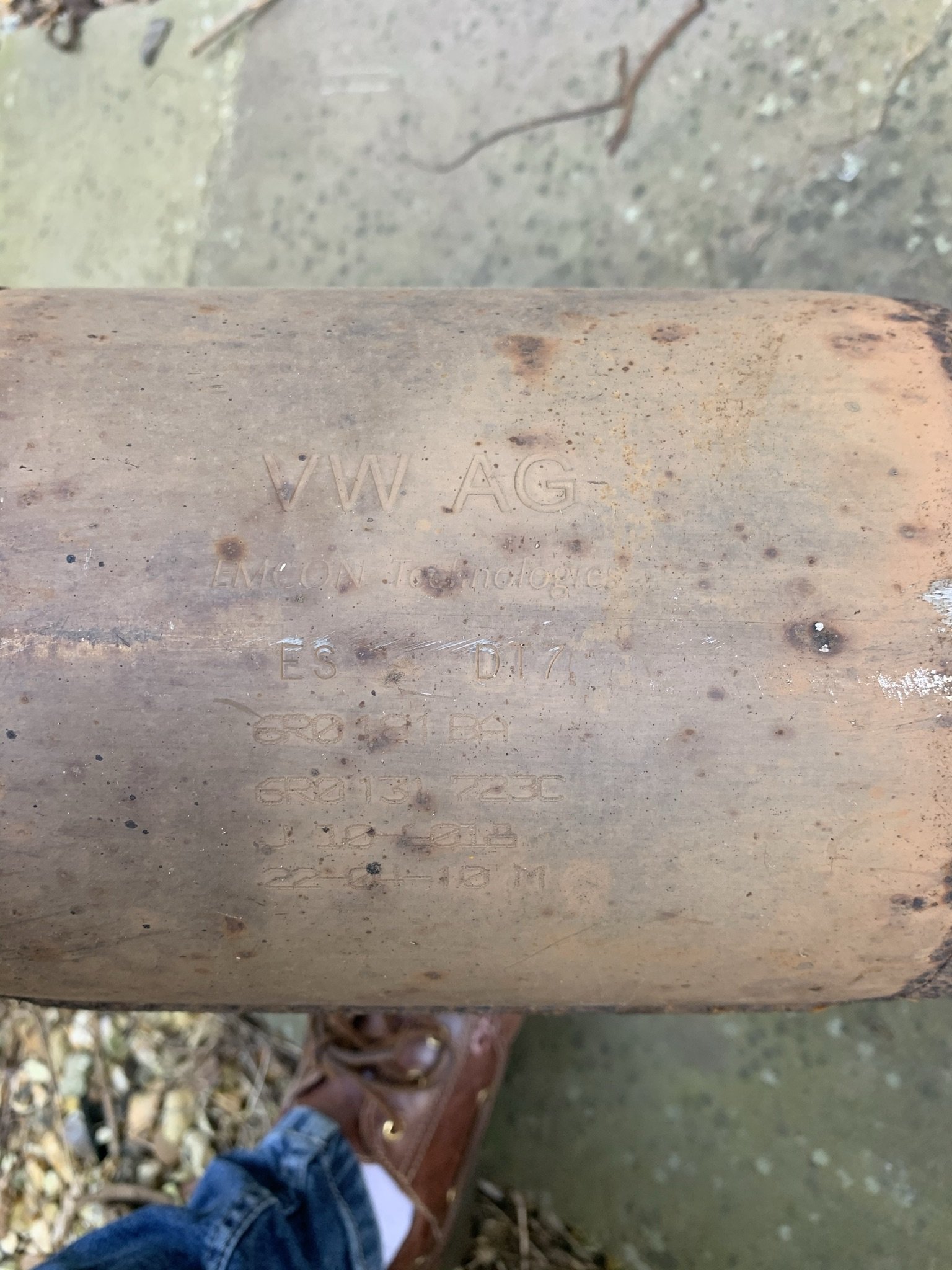

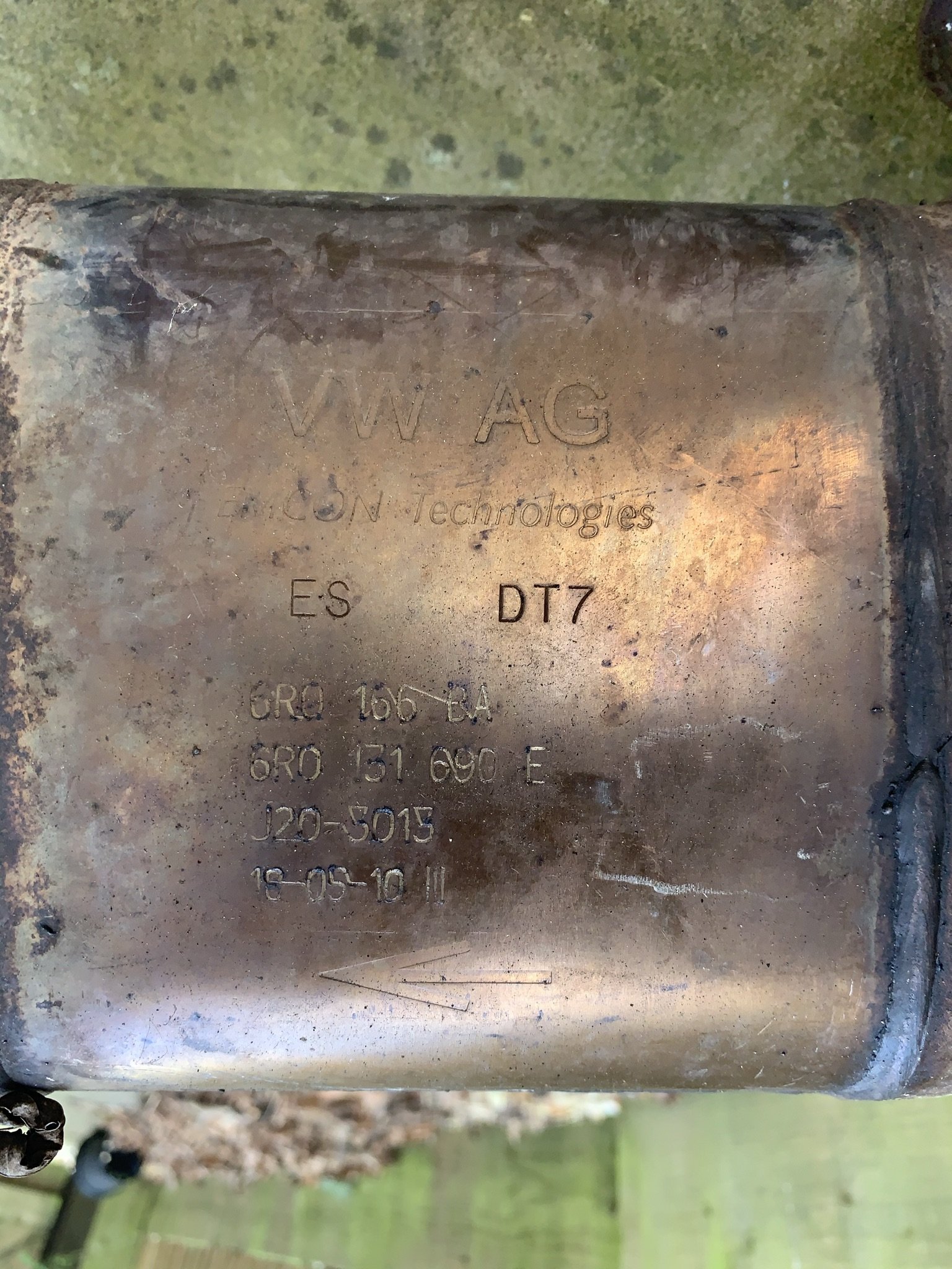

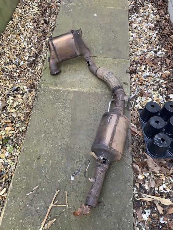

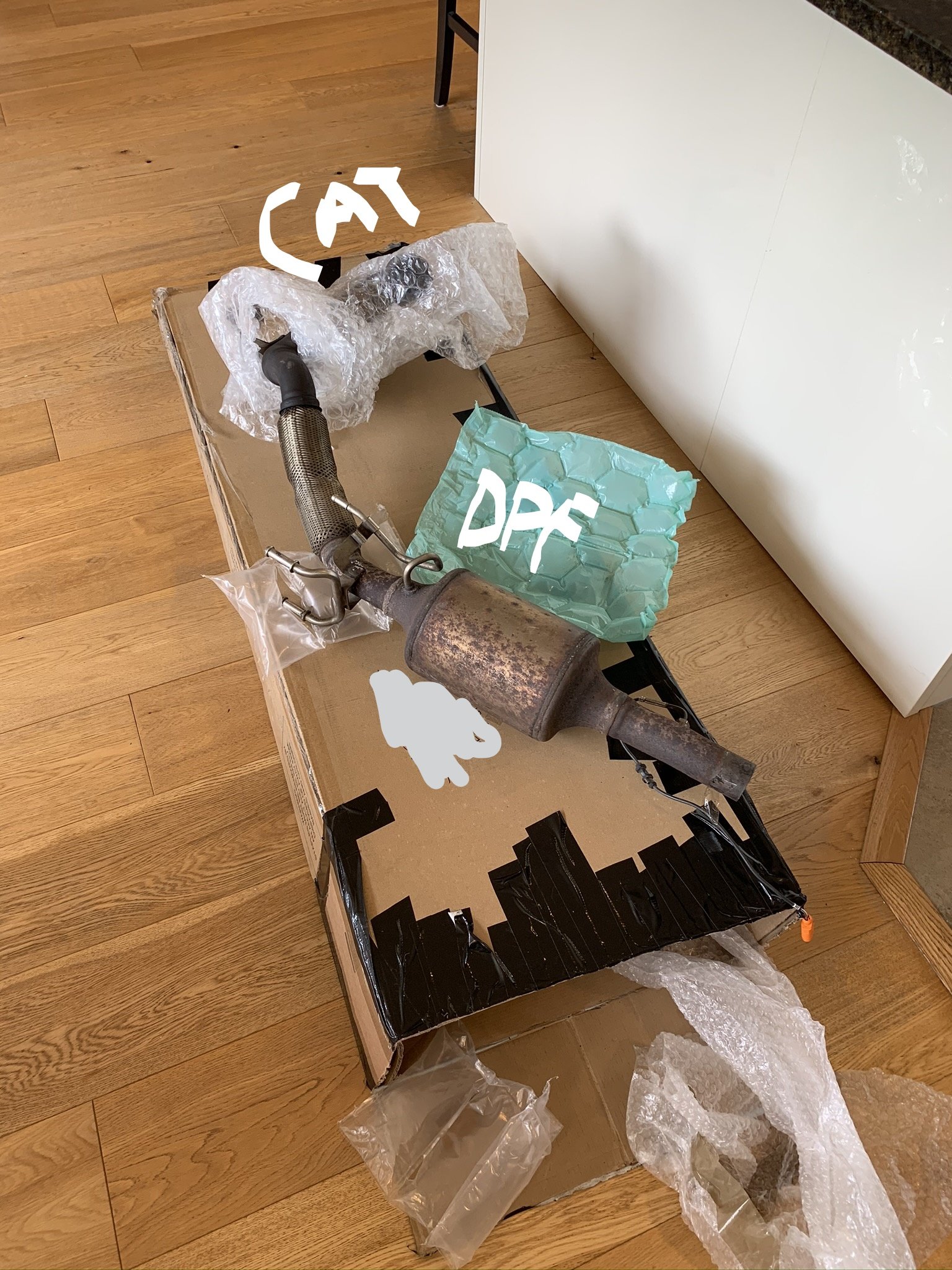

  12. Due to the pressure sensors places before and after the DPF which then get sent to the DPF pressure difference sensor in the engine bay. Mine had both before and after but the 2014 replacement only had before, hence the garage welding the aft sensor onto the replacement. The problem with the 1.6tdi engines is the DPF was too far away from the engine itself and struggled to get up to temp and they tend to clog easily. @AMD87also advised me the DPF was the second box.
  13. They are one piece, the cat is the portion that connecters to the turbo and the DPF is the large box at the bottom past the flexi. There are slight variations between 2010-14 on the 1.6tdi. Do you know if your dpf has 1 or 2 pressure sensor pipes? My 2010 dpf had one vs the used replacement i got which was from a 2014 fab had only one sensor pipe. (on the photos of the exhaust on the pathway you can see where the garage cut out the post sensor pipe off my old dpf to weld onto the newer one. Is there a reason you need a new one is the cat failed or is there a problem with the exhaust piping? A new part will set you back over £750+ VAT I have attached a few photos of my old and replacement so you can see what to look for

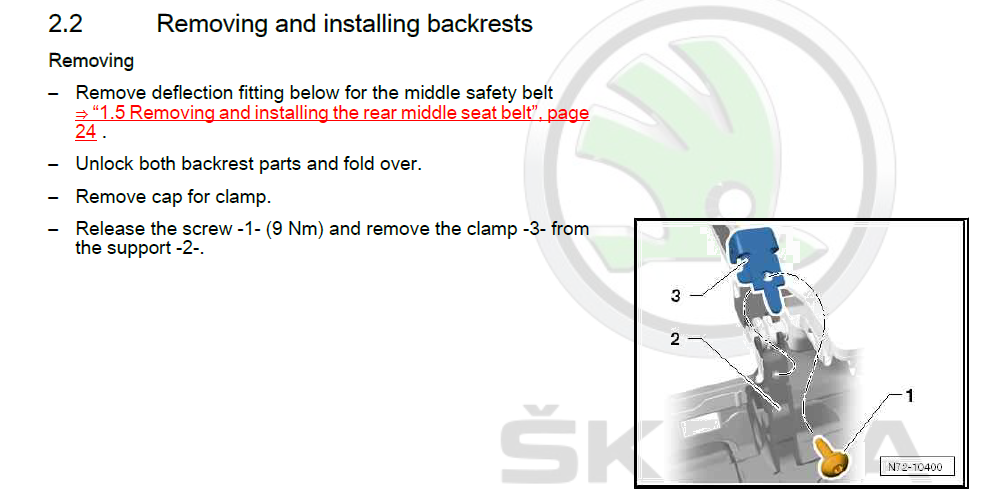

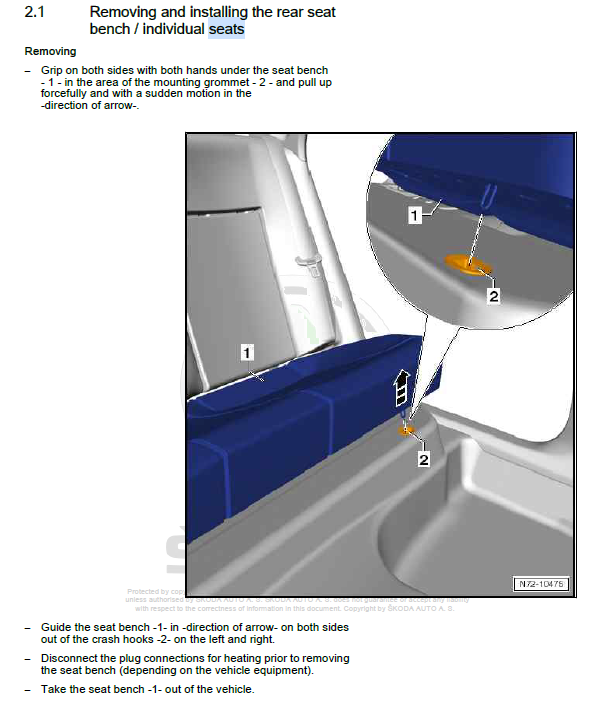

  22. Removing rear seats is easy. The lower bench on the hatch comes out in one just pull from the front corners and it will unclip. The isofix clips might come loose but just clip back on easily. The rear 40/60 bench is removed by unscrewing the retaining clip at the split point accessed by the boot. Then releasing the outer clips using a flat head to rotate the locking mech. http://i784.photobucket.com/albums/yy127/SC16v/seats/8.jpg http://i784.photobucket.com/albums/yy127/SC16v/seats/9.jpg Photo source from mk2 guide as the locking mech is the same.
