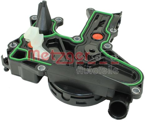

New PCV valve Failure (1.8TSI)
Ok. Yes agree with that. Maybe Topran do make 2 versions then, as there is also a 117 361. 114 985 does look right and it inspires a little confidence that Topran run the two versions. The unknown is exactly what the quality of the valves and spring release tensions are for example. As it's being replaced and it appears as close a match in the aftermarket world, probably try it and monitor... A
You should be on the revision journey 06H 103 495 E, AC, AH then on you mfr date, (not to be confused with the H AD AJ). There is an additional check valve visible in the bottom of the unit in the H, AD, AJ units, that presumably should not be used on pre June 2010 cars. Very few dealers, VW, Audi, Skoda look carefully enough at the etka listings to realise there are two "current fitments" each with different applicability. Although aftermarket products like Vaico, Metzger and topran are usually decent quality they only seem to release 1 version of the oil separator and sometimes they mix the part revisions between AH and AJ. Clearly they are a slightly different design and from what I've seen listed on ETKA for the CCZA should not be interchanged. I have attached the image here to show you the extra valve arrangement, this is not an endorsement of the specific products listed. Personally, I'd probably get genuine as you don't know spring preloads, check valve vacuum release etc etc. But in the UK they are about £90 so up to $300 in Oz would not surprise me. It's a lot. And you have to get them to check for the two current version mfr date applicability. It should be as I outlined at the start of this reply.
What date is your engine manufactured? Timing chain cover barcode usually easiest to identify.
Right. These engines are pretty fussy and the PCV is probably a 3 or 4 year replacement item. Did you buy a genuine, as you just can't rely on the chinese pattern parts for this item? Also, a lot of people and even skoda / vw / audi dealerships here that there are actually two "current" PCV / fine oil spearators for engines of different years and they are not exactly the same, one version includes an extra check valve. Which version did you install and what version was originally fitted? i.e the part numbers and suffix.
