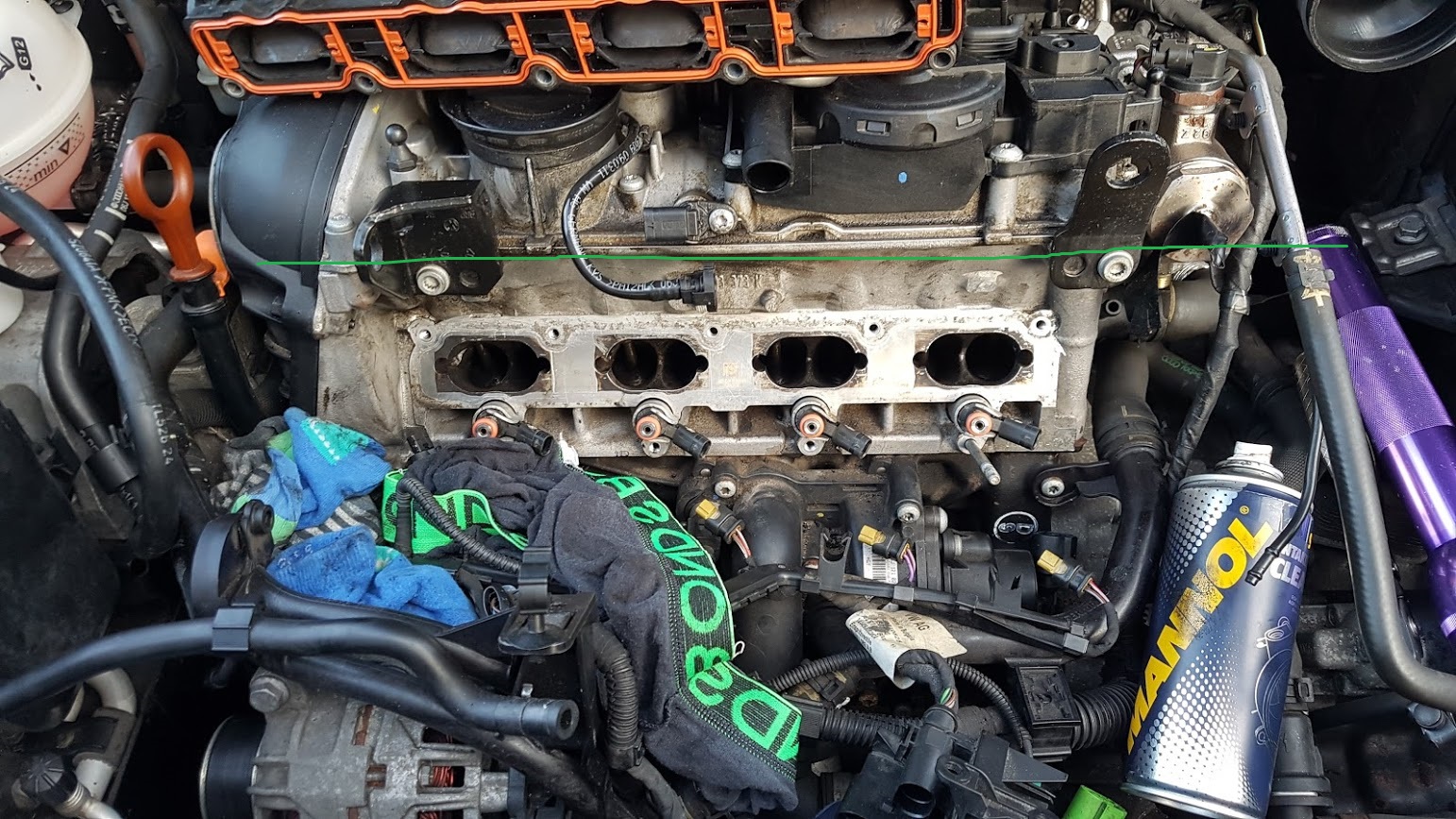

  16. If you are just cleaning, I don't see how a prime would matter than much? Lots of other DIYs don't mention it. The re-learn procedure I can understand if the filter mesh was blocked. Gives incorrect set up to the ECU needs to be re-learnt. I did neither on my car from what I've read on VWROC forums OBD11 stalls and/or doesn't work properly for 2 of 3 basic settings referred to. I might have a look later as I have OBDeleven but don't want to create a problem where I don't think I have one! Pic attached.

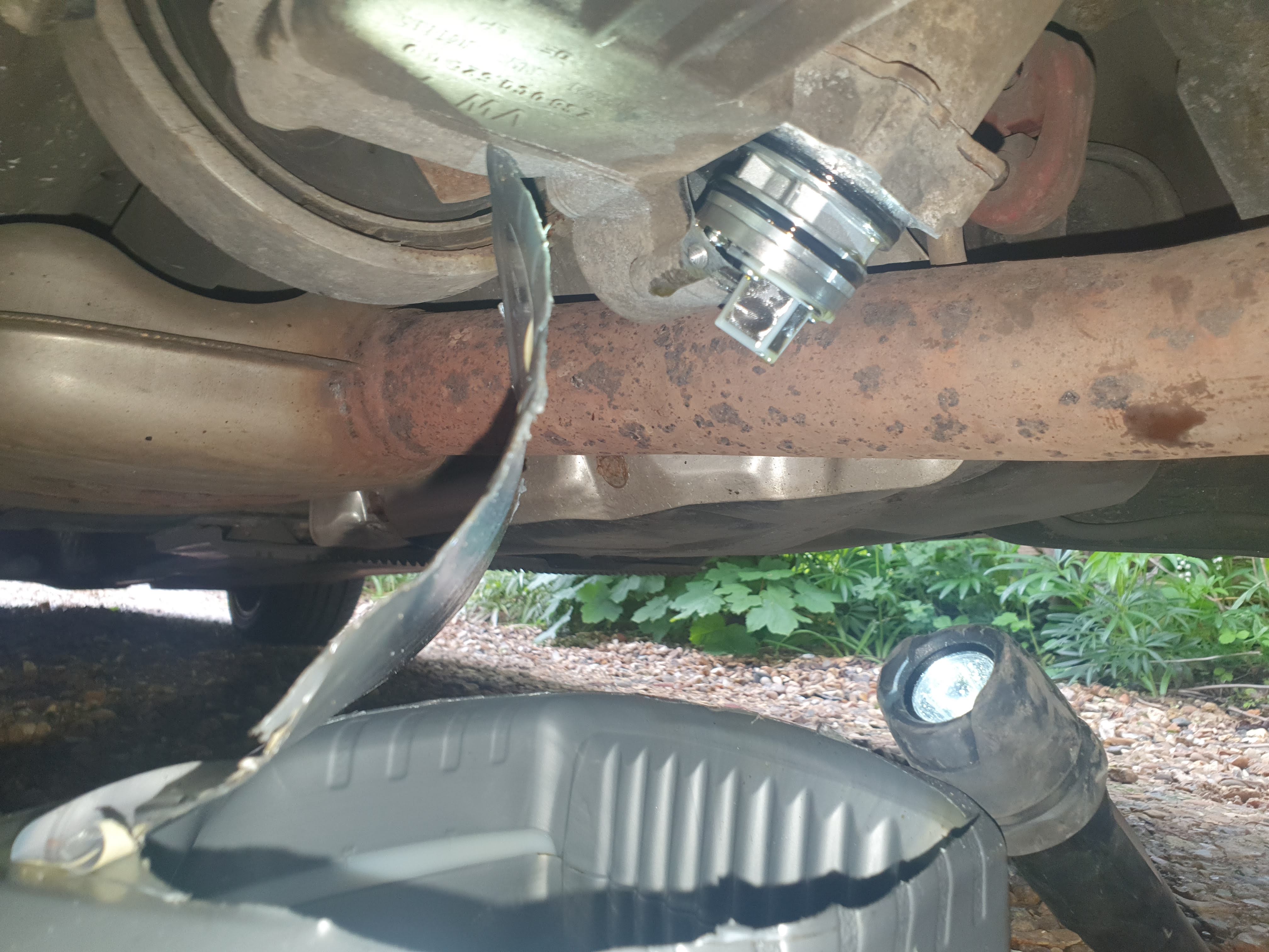

  17. Me. heaps of guides on the hinternet. No diagnostic tool required. If you don't think it's working properly the pump maybe gone. Mine was surprisingly clean though given 50k miles and I suspect no previous change. It can be done with the car on stands, I did. Reaching up for the bolts and removal of the wiring loom (and refitting is tricky) from flat on your back is a challenge though.. I left the loom in place but its not ideal with the pump hanging from the loom and you need to clean the mesh screen in situ in that case. https://www.youtube.com/watch?v=2pUXkDXt1cw
