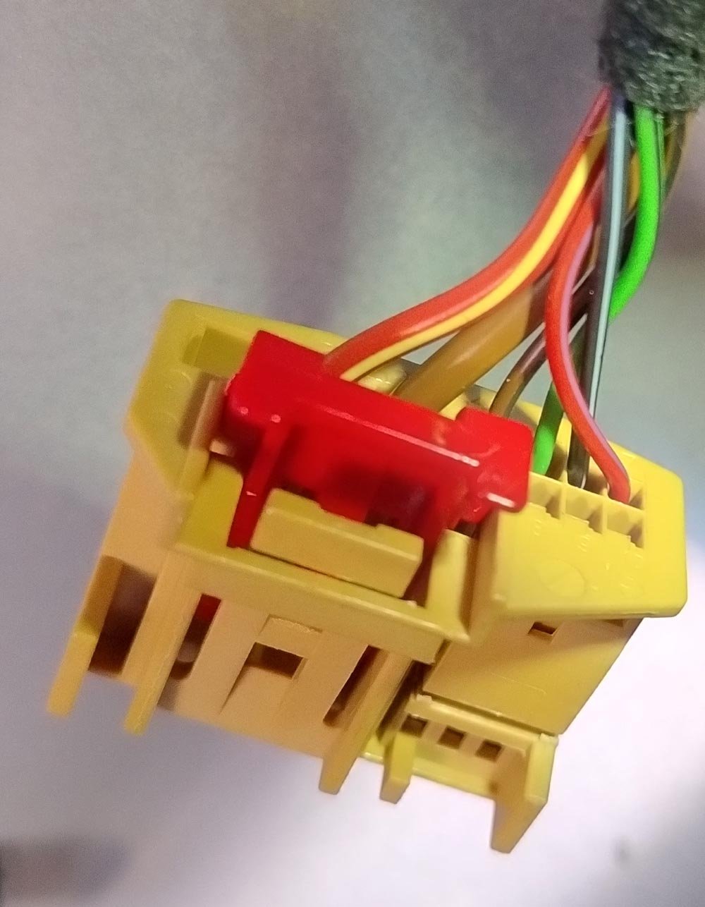

  5. Did mine today. First clue for me was the 'Clack, Clack, Clack' when going from recycle to fresh. The two screws on mine were both a 15 Torx and 5.5mm AF head in one. Would agree with @cliveb on removing the wire connectors on the glove box. I have OBDeleven so I can/have reset the Air bag light. And also cut the cable tie so that the motor assembly can be pulled down to undo the wire connector. I then pulled the assembly out. It looks like the same problem as @lewiswal47 and others have had. The Black cog has moved and opened the motor housing case apart. Also note that the red gear has gone past the stop point. My solution was to regrease, reassemble and then Cable Tie the housing back together. It is in the bottom right in the photo above where it pops apart. So made sure the cable tie was around the housing at this place. Now reassembled and all working with no 'Clack, Clacking' any more. Thanks. AG Falco
