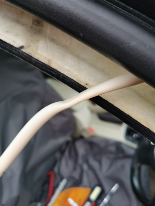

  17. At the risk of tempting fate since I repaird the damaged hose I've had no sign of water ingress from the roof. I still had the rear left corner to look at but that's stopped now. I suspect the hose might have been a major issue from the start. I did check it when I first noticed the problem but I'm thinking it was failing and couldn't see it when the headliner was back in place.
  18. So I had a look and the only place dry as the joint that I presume was the issue. The real issue was immediately apparant. The drain pipe had completely collapsed as can been seen in the photo. The whole roof had obviosly filled and run over the edge. I've manage to cobble a temporay replacement and water is flowing out. Still got something happening on one of the rears but hopefully the majoy culprit is sorted.

  20. And back to pouring in again. What an absolute load of junk that roof is. Love the car in general, got it running really well but I'm not sure I can cope with this anymore.
