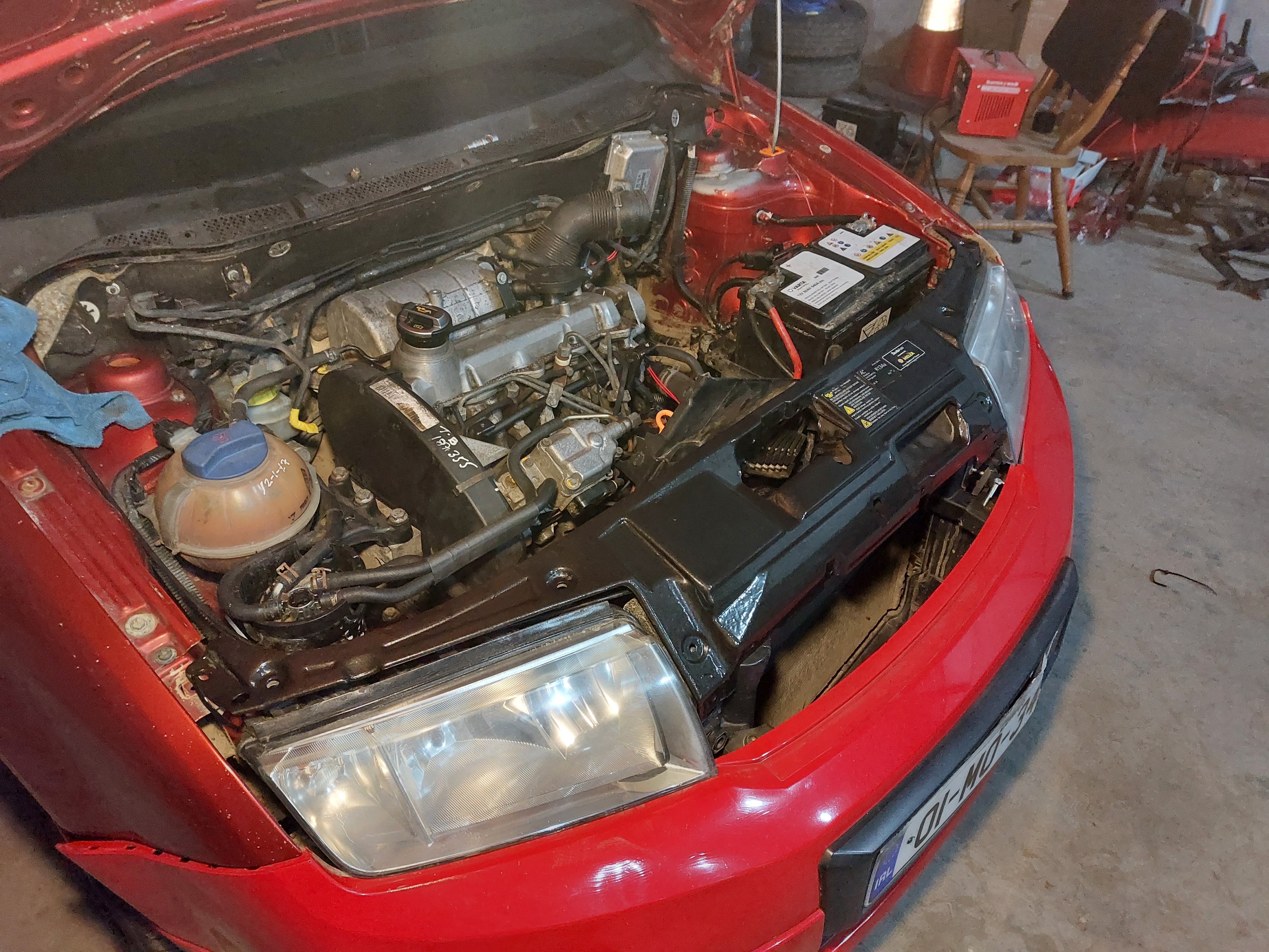

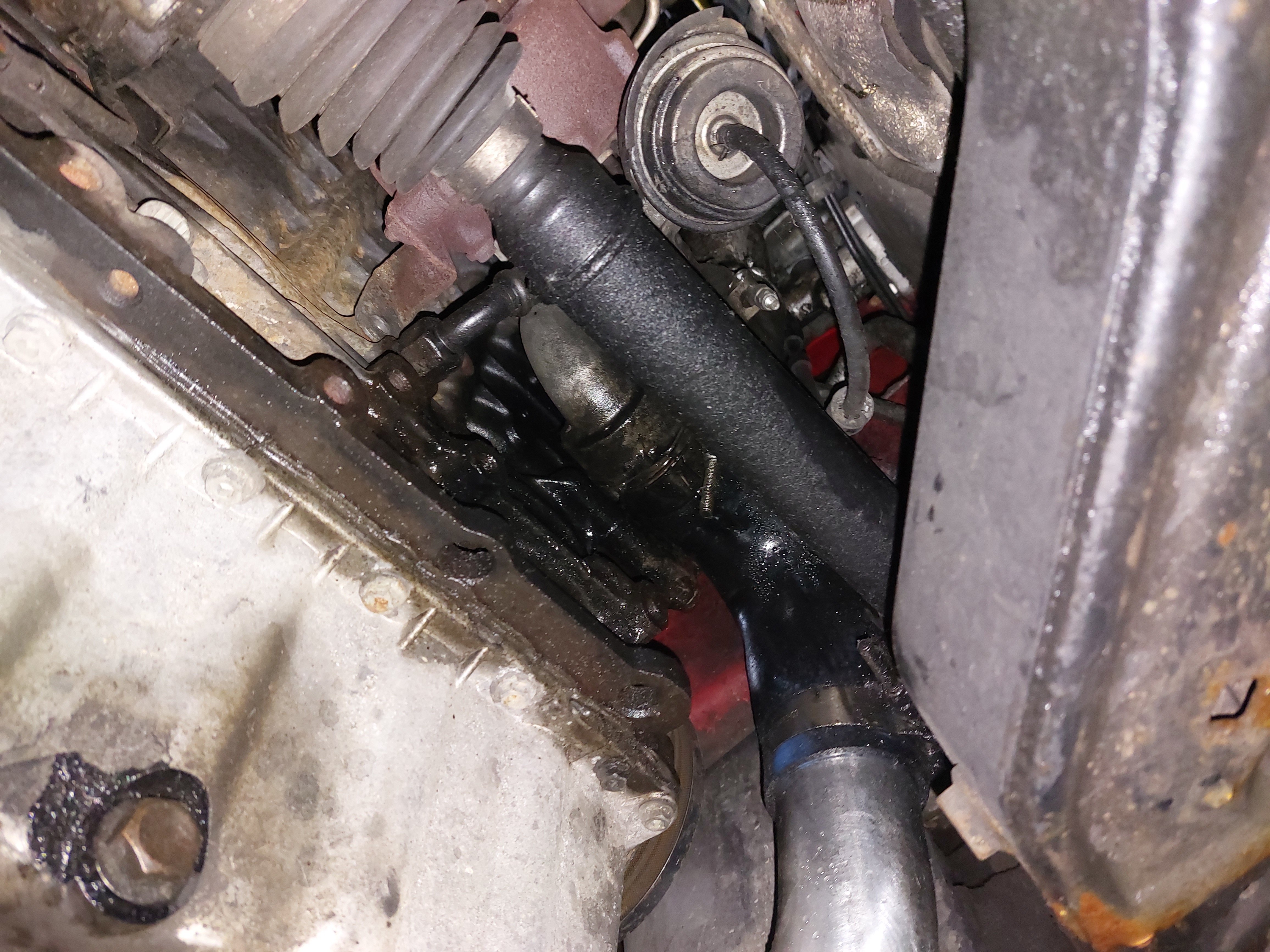

  1. Set about getting this fired up this evening. Had a bit more work to do than I realised, biggest headache out of this whole thing was fitting the return properly. Mounted it to the turbo at first but found out it needs to be fitted to the block first, THEN you need to somehow slip a gasket onto the piece connected to the turbo and tighten all up. Must have took 40 minutes to just sort that out. Nearly gave up there it was that bad. Pushed through, changed the oil, got the downpipe on and gave it a few cranks to build oil pressure. I pulled the fuse for the "diesel computer", fuse 14 on this, so it would crank but not fire. Seriously good battery on this, same battery that came with it all I did was charge it. Made sure to record the first start up Died after a few seconds seemingly run out of fuel. After cranking it a bit more it fired again and stayed on this time. Changing the fuel filter must have got air in somewhere. Gave it a few revs even, found where the popcorn limiter is on it Not brave enough to let it pop and bang away just yet. Didn't even move it under its own power but I was happy to leave it there for tonight. Extremely impressed at how healthy that engine sounds, given the miles and having bought It with a grenaded turbo. I'll take it for a few laps next day.

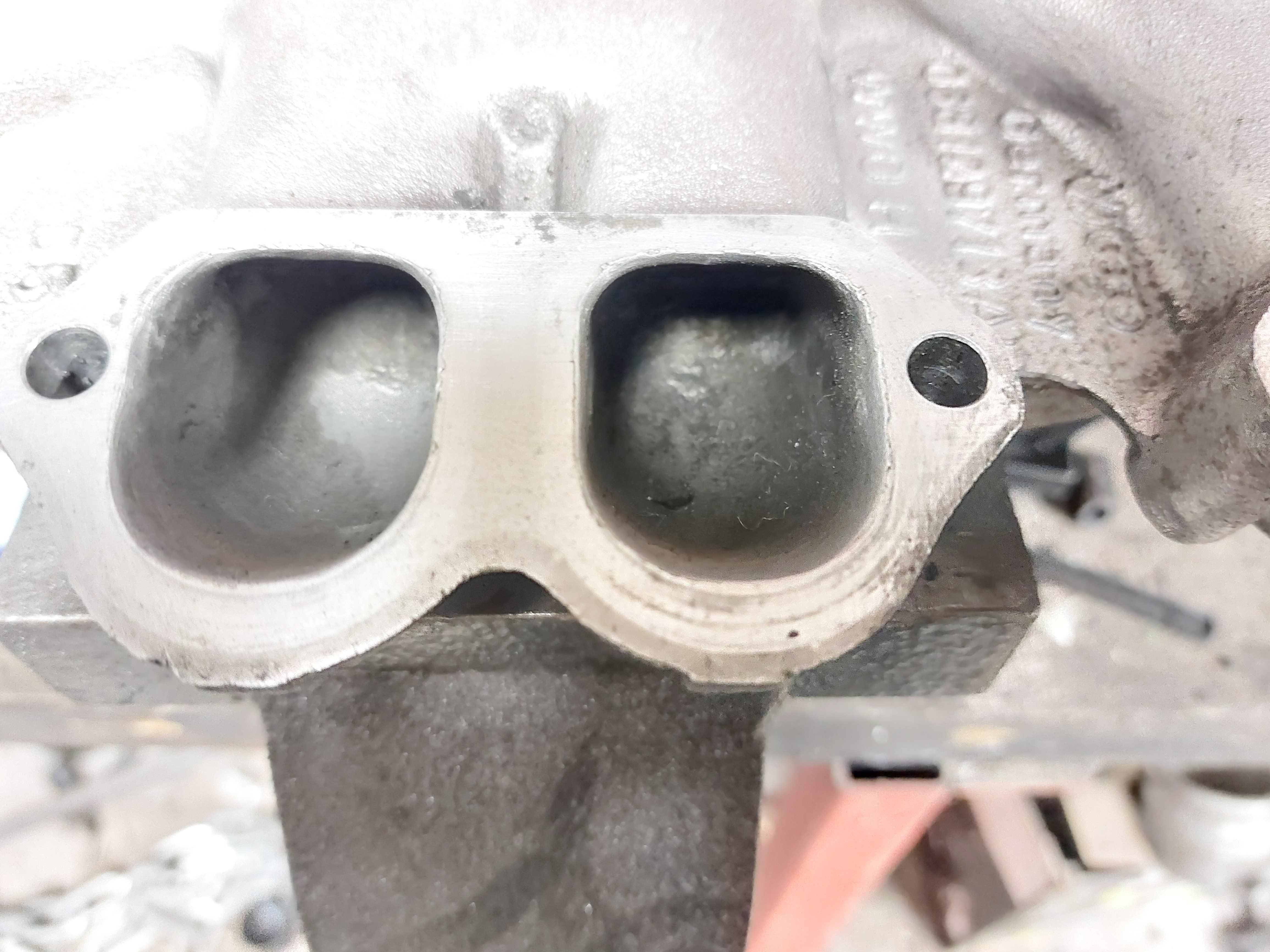

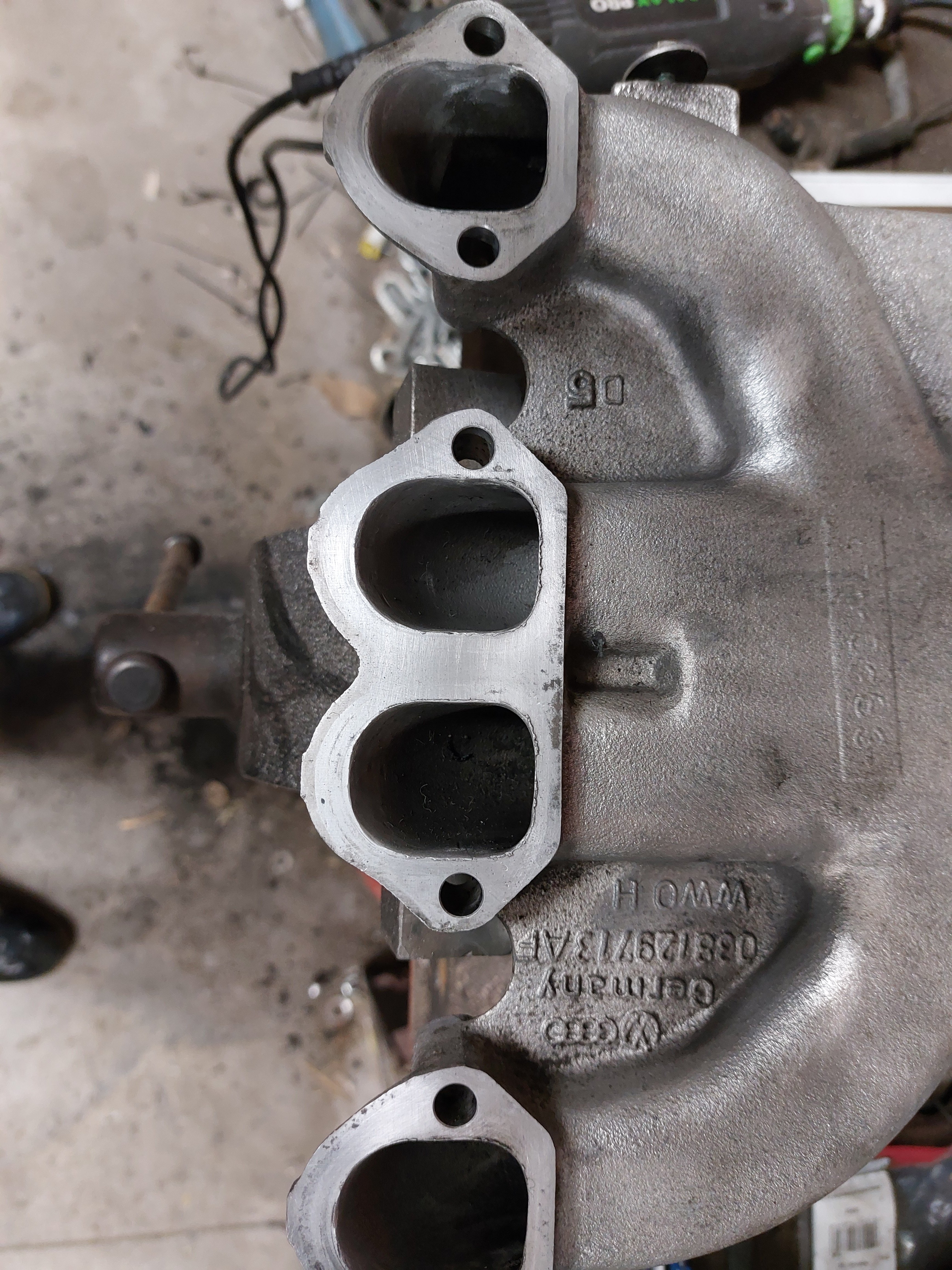

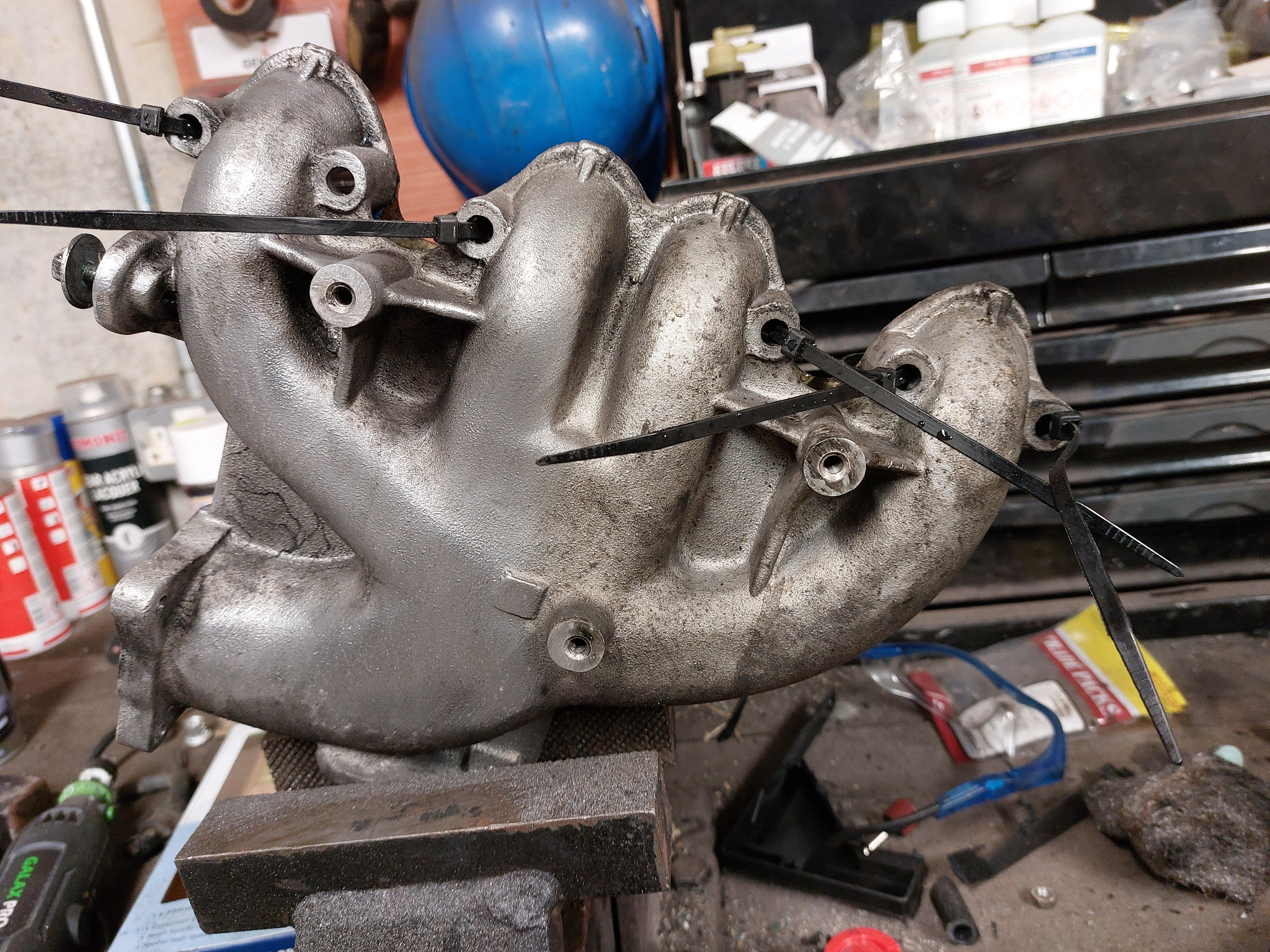

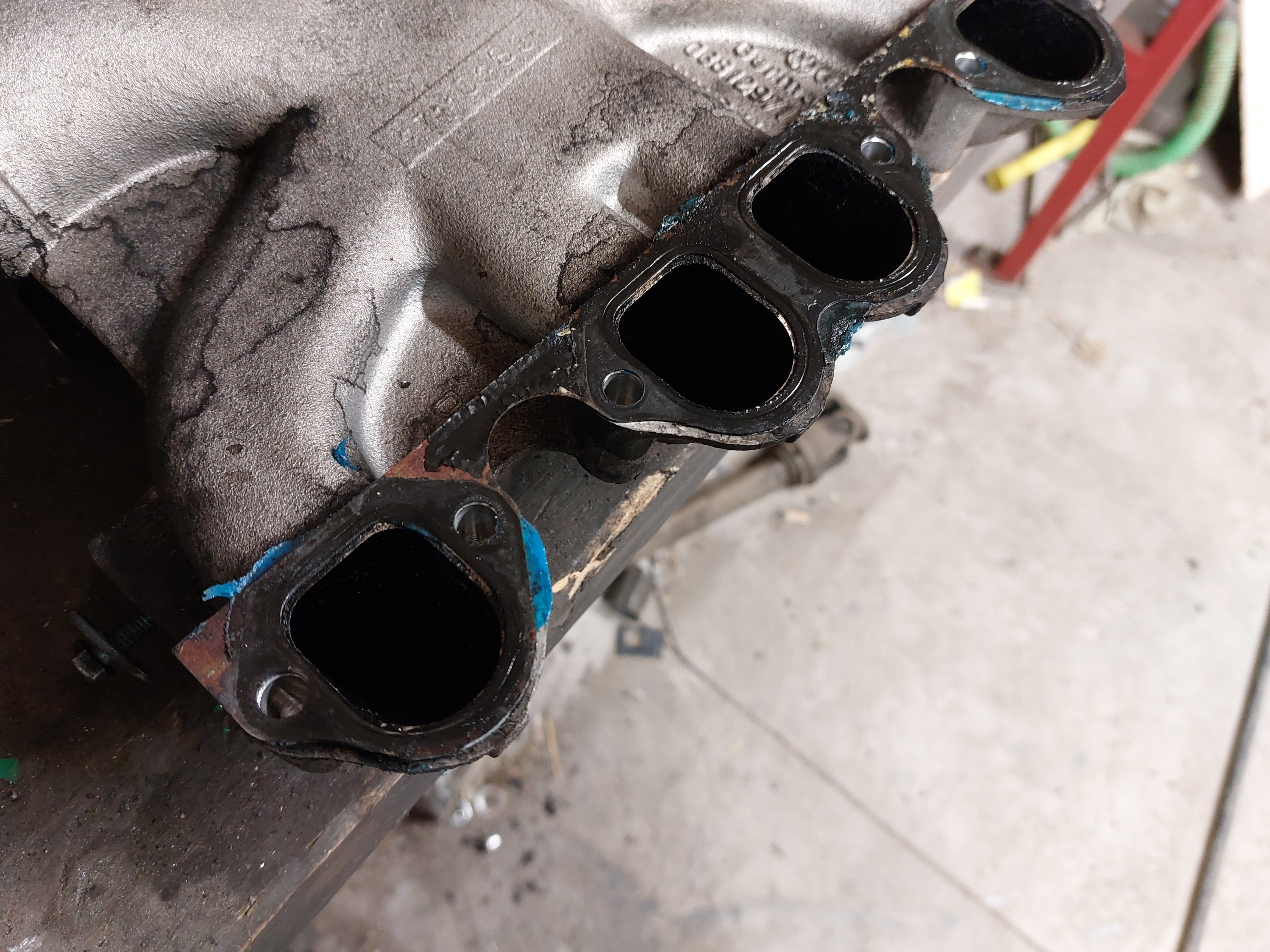

  2. Fitted my diy shifter bushes. Feel great and if I'm honest they're a nicer job than what I did to the Monte with tigerseal. Got them adjusted, 6th is a bit stiff but other than that I'm very happy. Gaskets came in all genuine from the dealership. Turbo on, easy enough to hang the gasket on the studs. Intake manifold was a bit tricky because it doesn't have studs to mount the gasket on, so used zip ties to hold it in place temporarily. Took a snap down one of the intake ports, looks good considering the miles and having recently had blown turbo oil chucked down it. Left it at this for tonight. Most likely will get it running tomorrow.

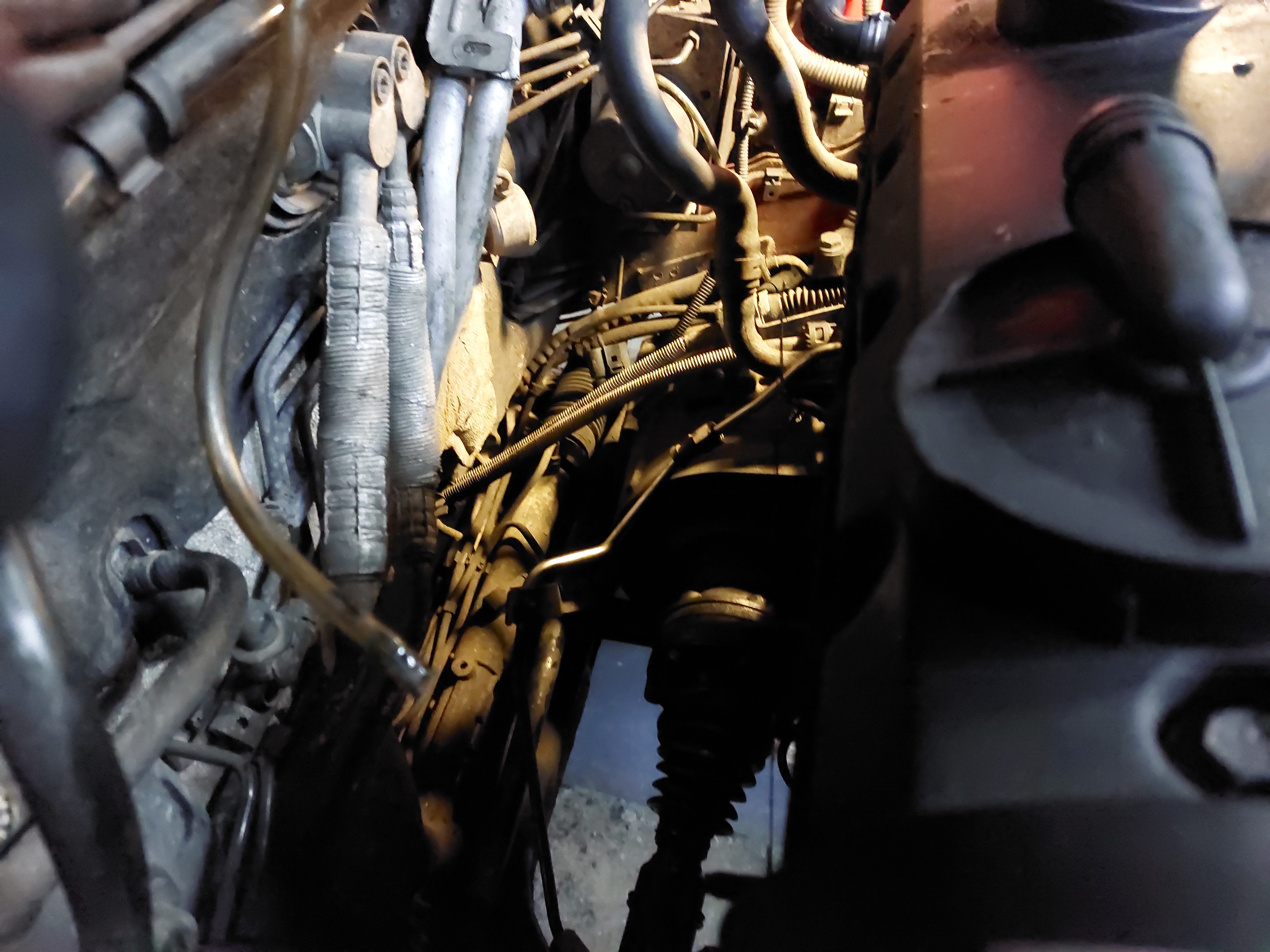

  4. Hi all, I'm looking for any ways to increase steering feel through vcds. I have new everything on the front of my car, including a poly steering rack bush and caster increase bushes. These have helped but I still feel like there's room to improve. I have vcds and played around with it. Changed the coding to the "sports" setting, again helps but not enough. I'm looking for any other ways to add more "weight" to the steering. If anyone has any suggestions I'd really appreciate them. Thanks.

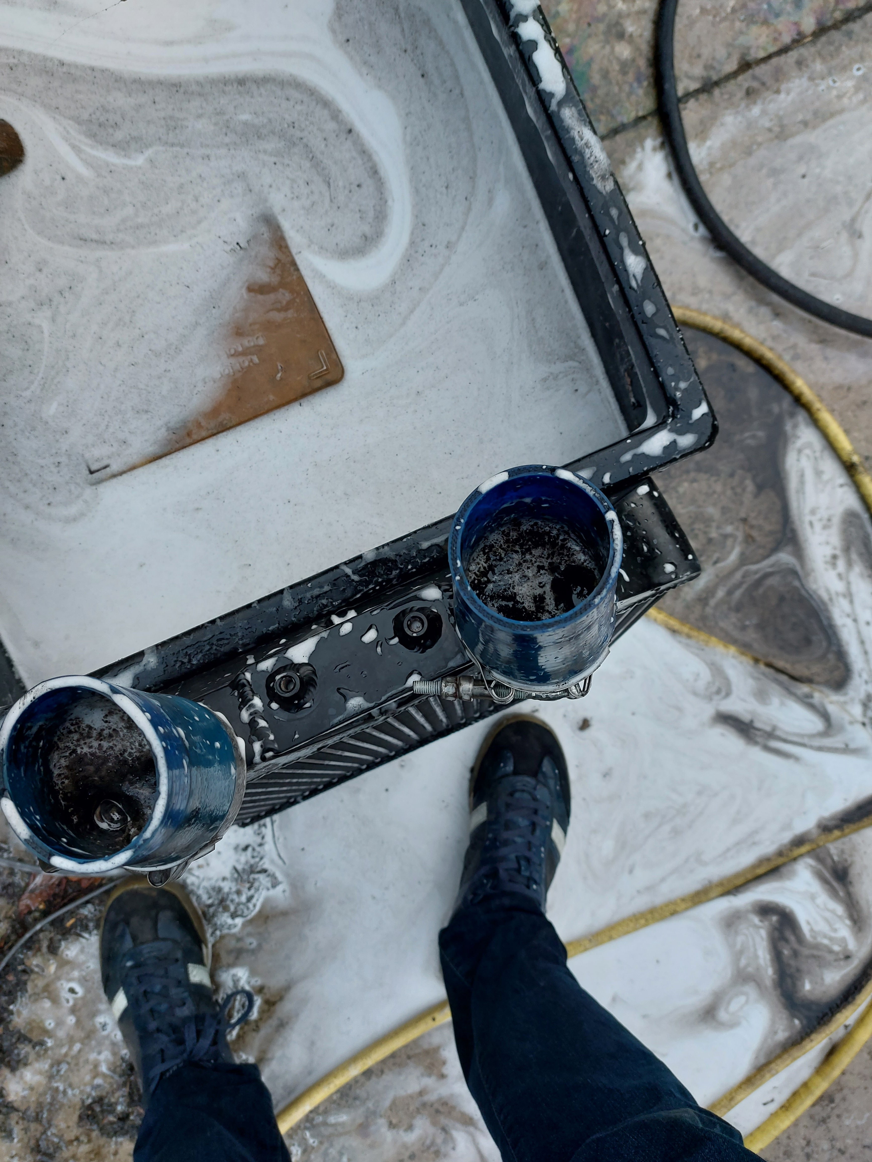

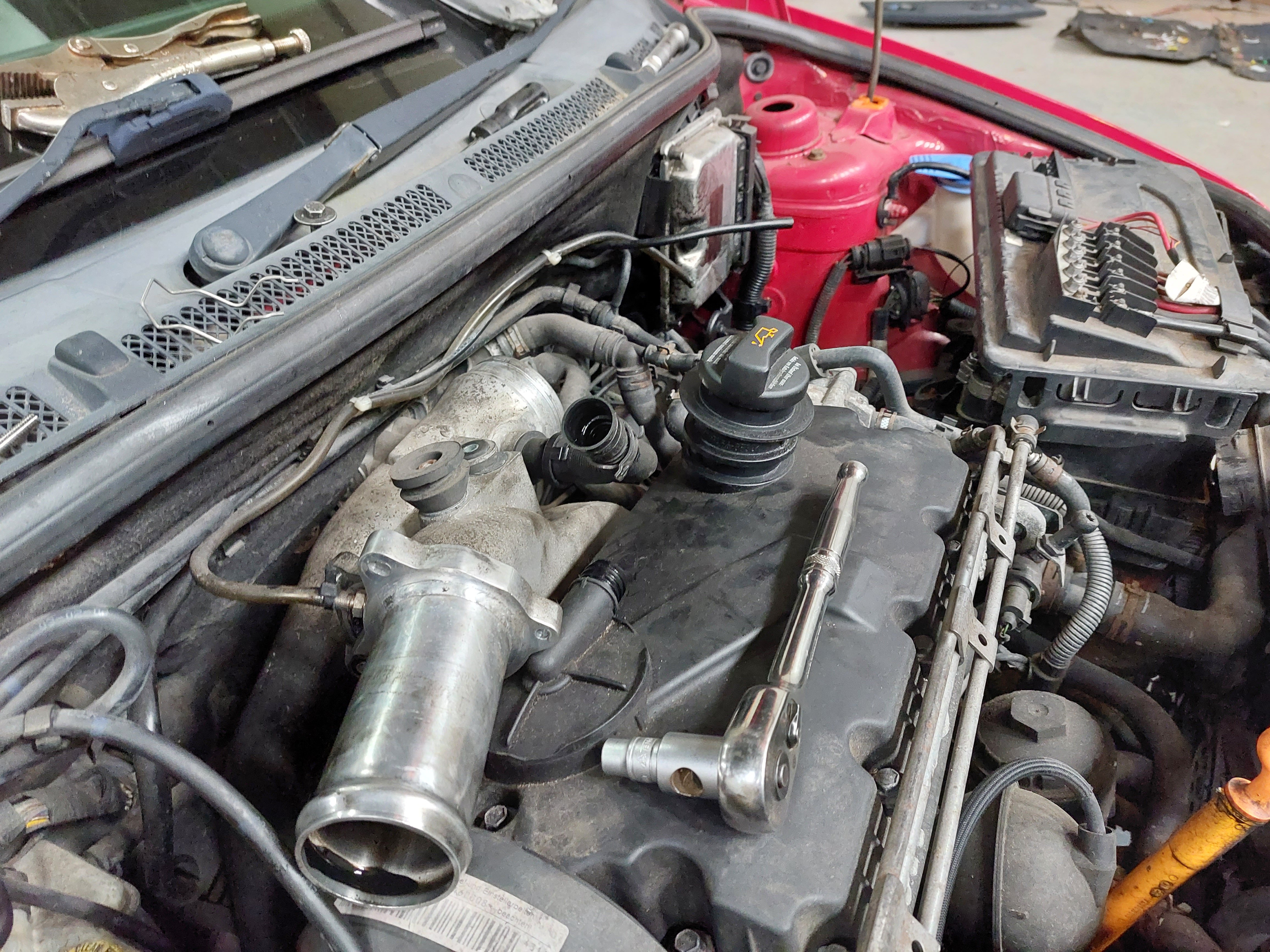

  6. Few more odds and ends done when I have not much else to do. Changed the crunched wing Also did some Rust Proofing, ish. Was high build primed and quickly painted over with some silver left over. Intended on getting the correct red mixed up and then forgot. Also changed the Fuel and Oil Filters ahead of firing it up again. Oil filter was definitely old, no chunks of metal hiding in it happily. Needed a breaker bar to free the oil filter housing cap off, weird considering these only need to be snug. Fuel filter was swapped easily, only took a few minutes. Same as the oil filter it seems pretty old. This is what I drained out of it.

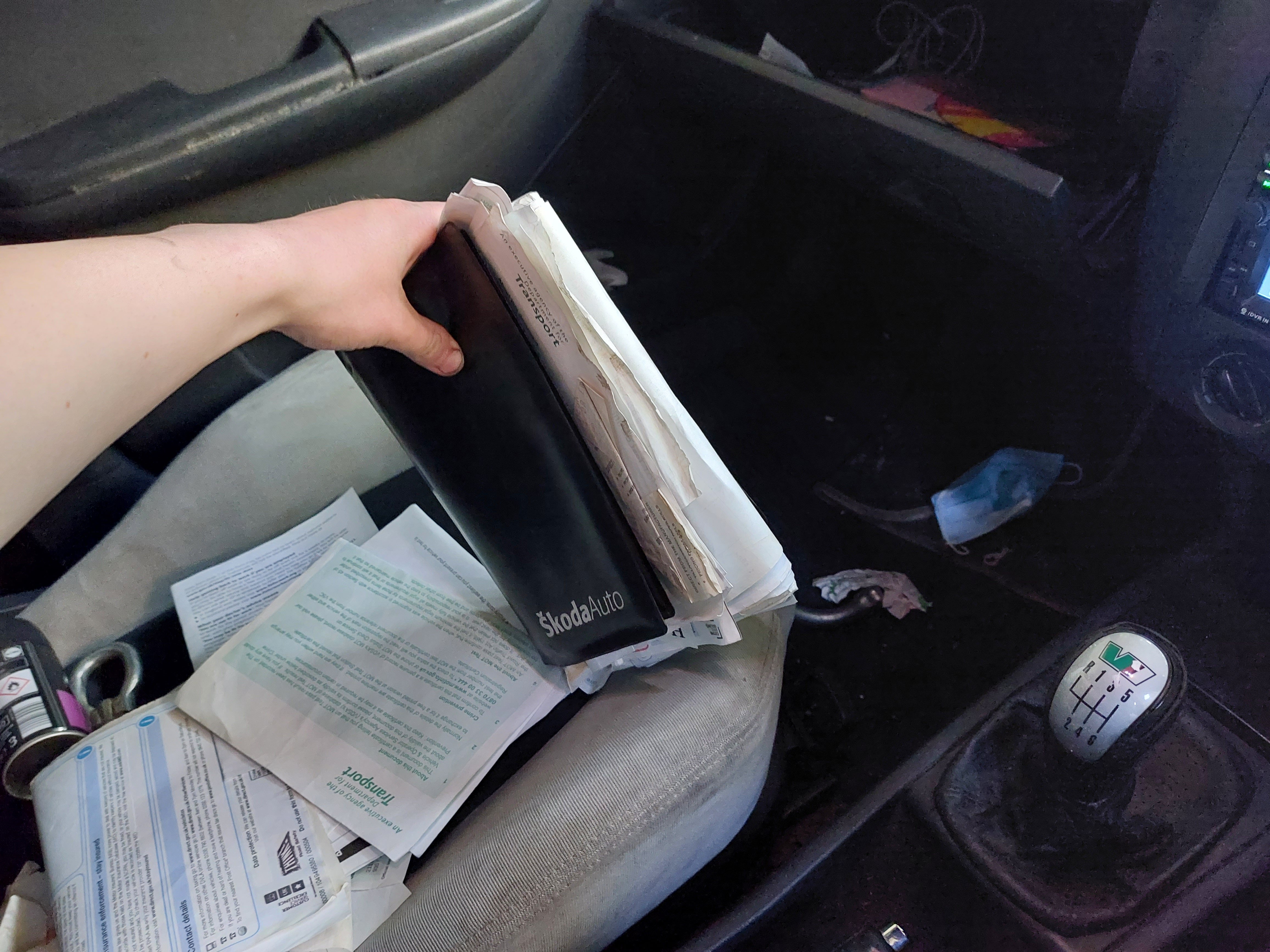

  7. This one's got the black headlining Was looking through the reams of service history and its had a lot of money spent on it through the years. Unfortunately no invoices or anything on the mods that were done. Was hoping to atleast see a dyno printout or something.

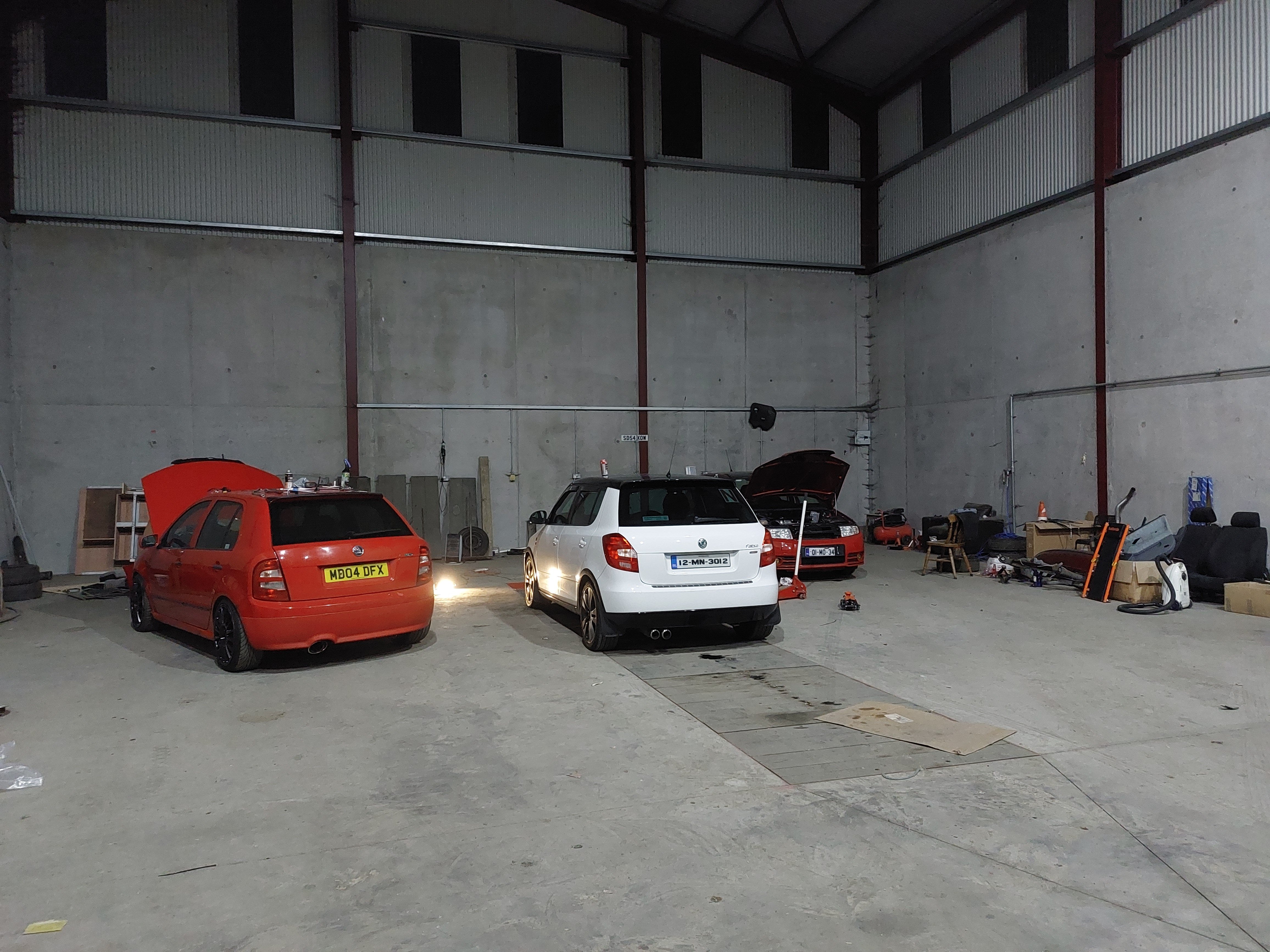

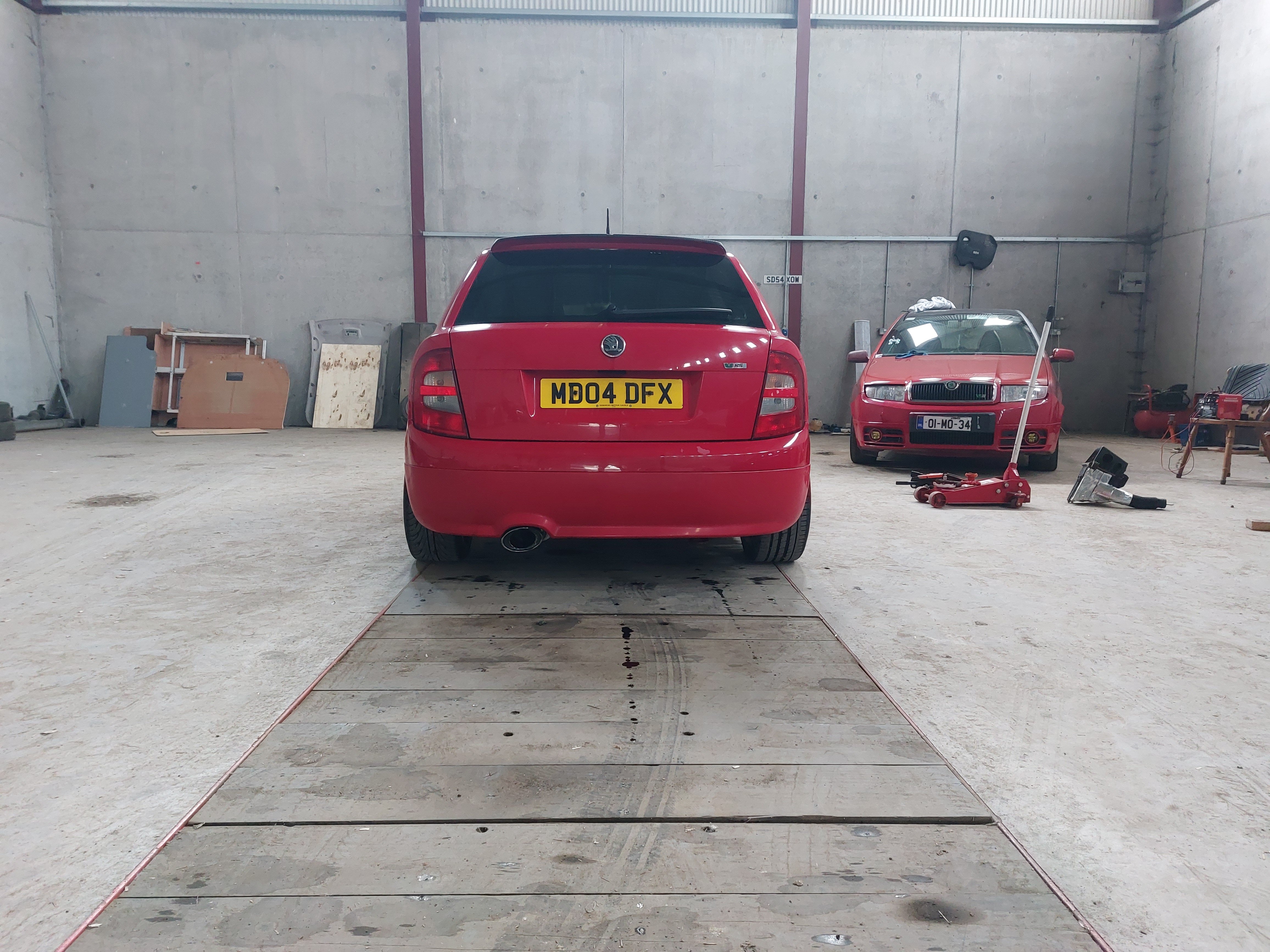

  8. Turbo is back. Thought it would come with gaskets (for the price of it) but nope, ordered what I need and they'll be here Tuesday. Have this bundle of stuff too, oil and filters. Pushed it off the pit to check out a few things on the Monte. Not much more I can do until I get the gaskets.

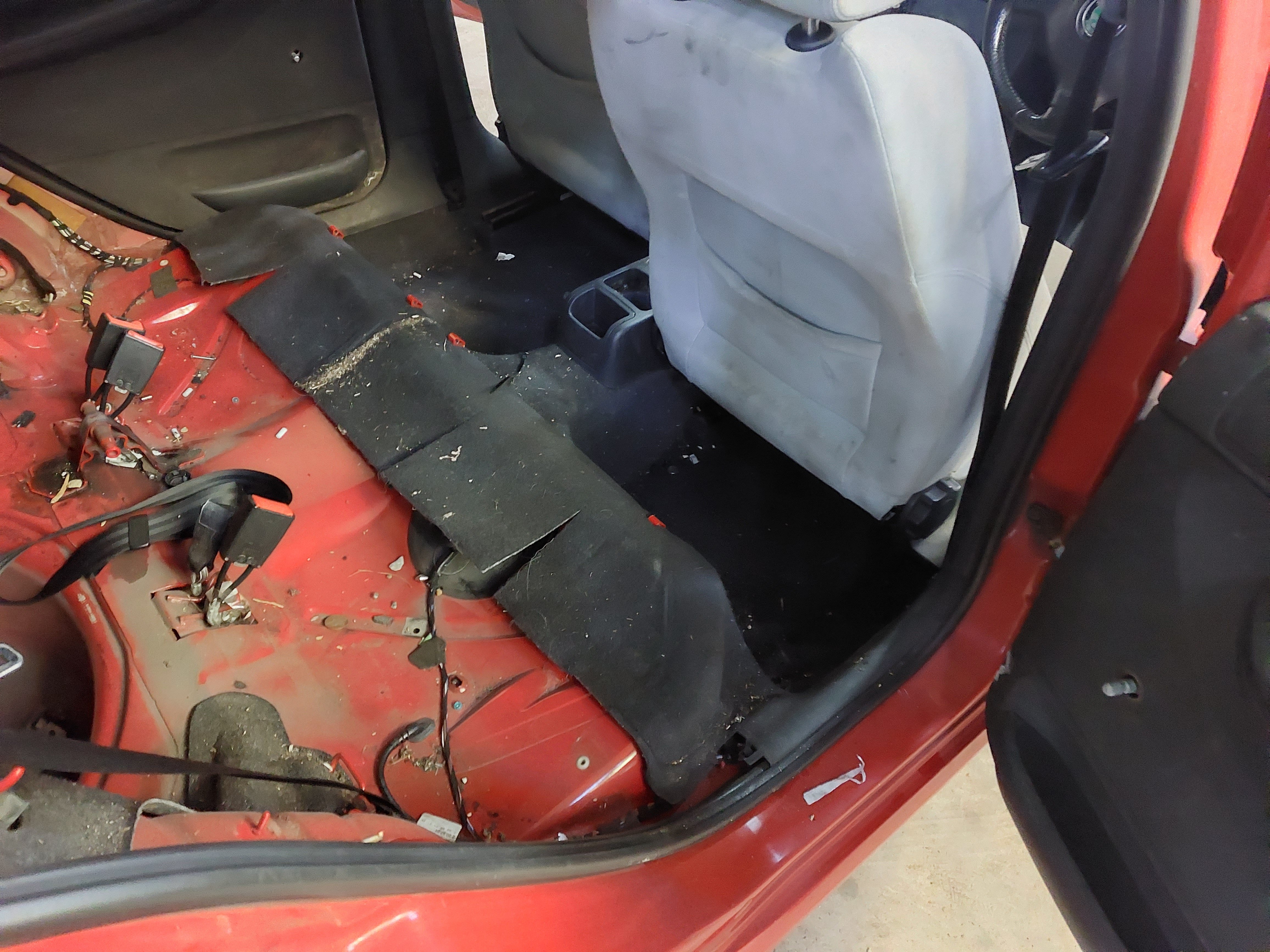

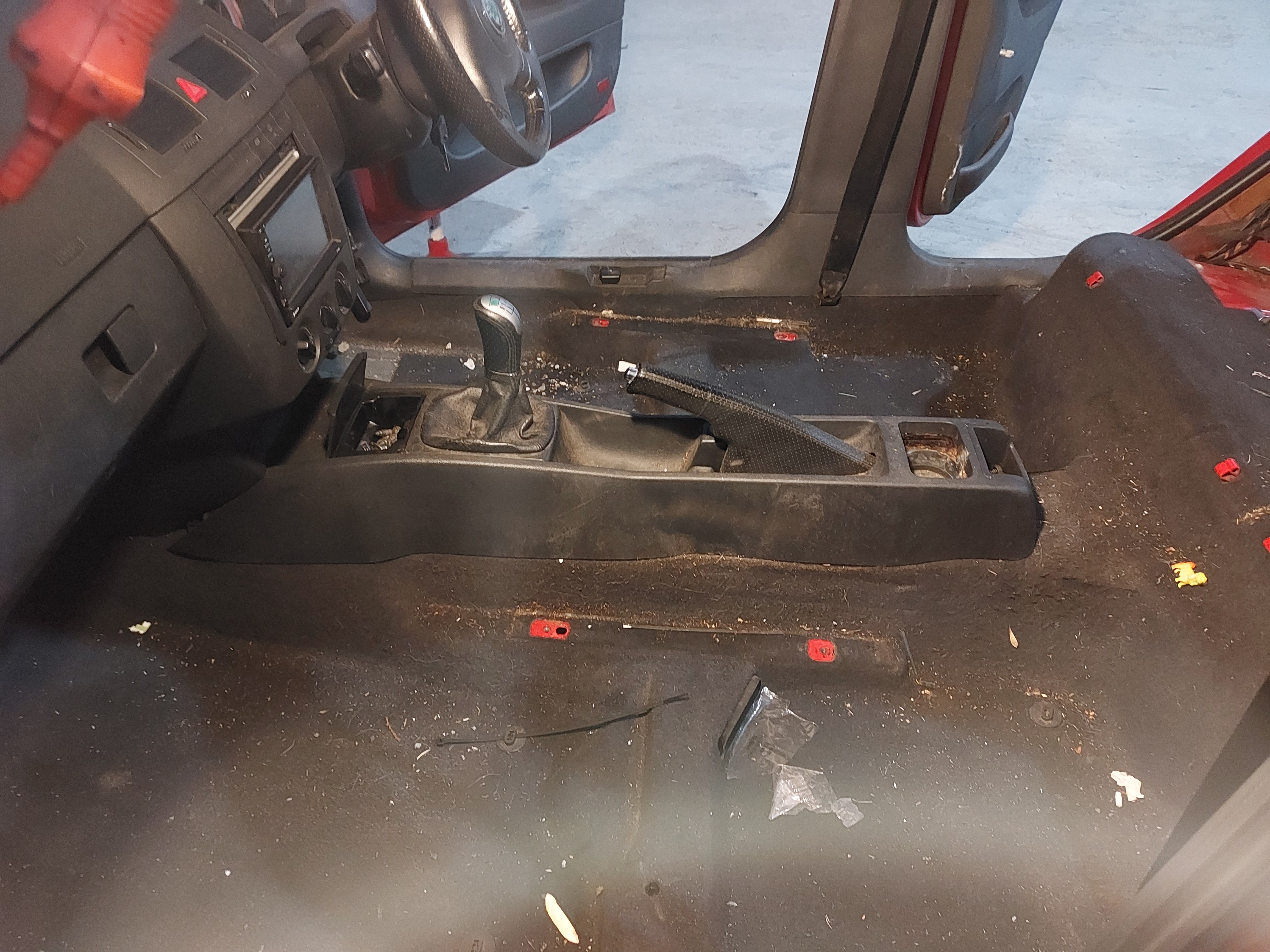

  10. Bit of cleaning of the absolutely manky inside of it. The centre console and glovebox were full of spilled scuzz. Have only put the drivers seat back in it at the minute. Turbo is done should be back tomorrow.

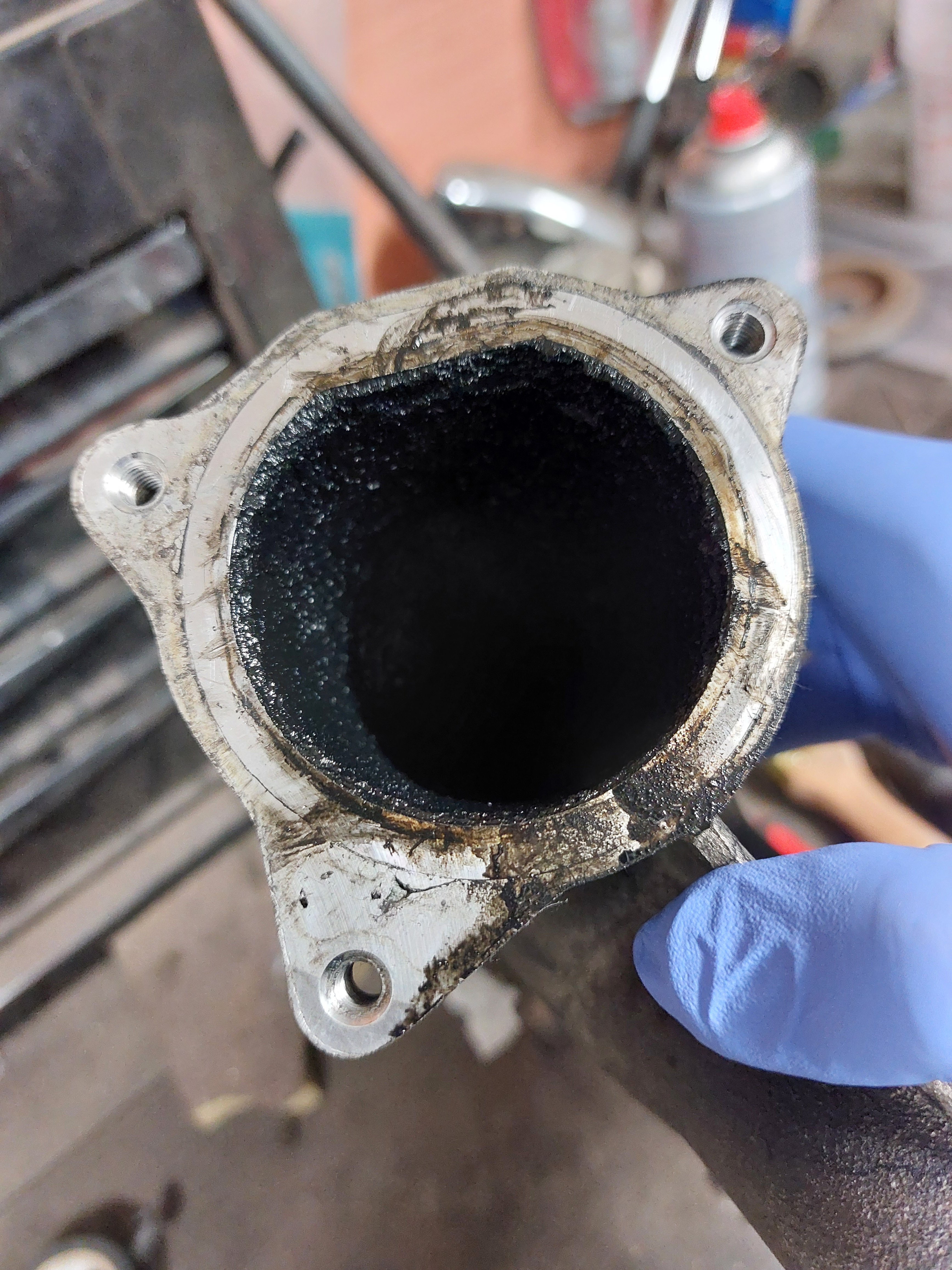

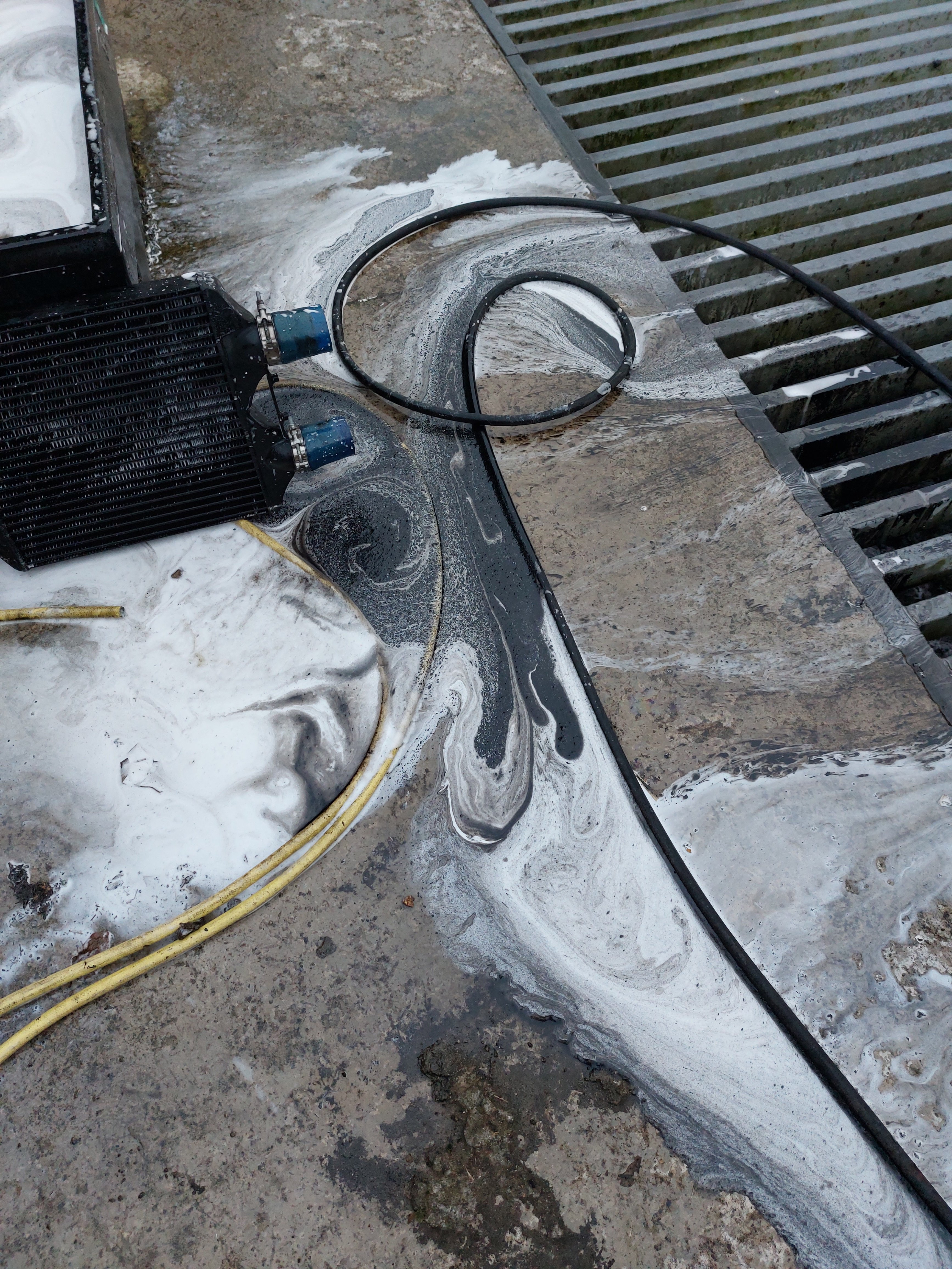

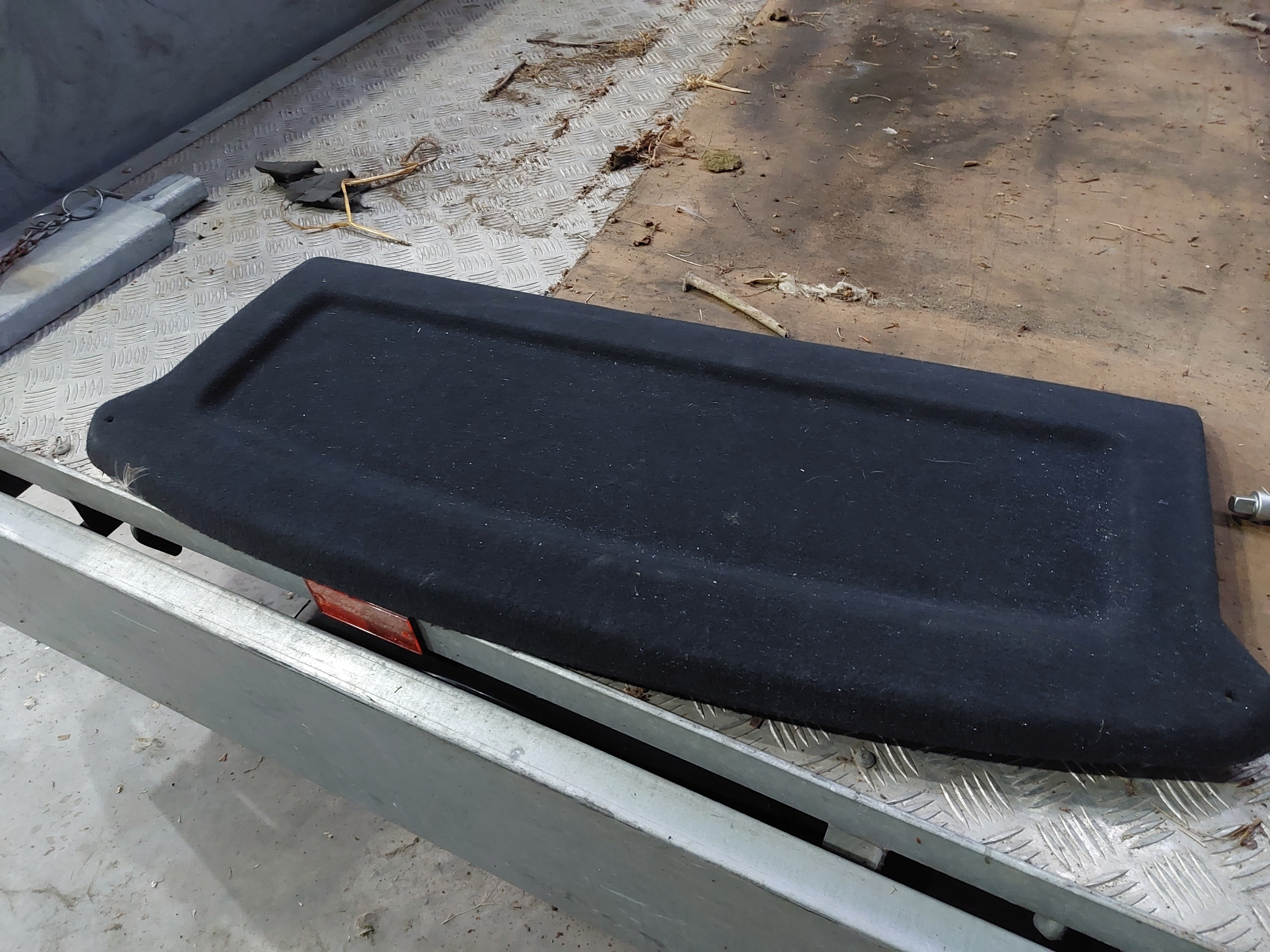

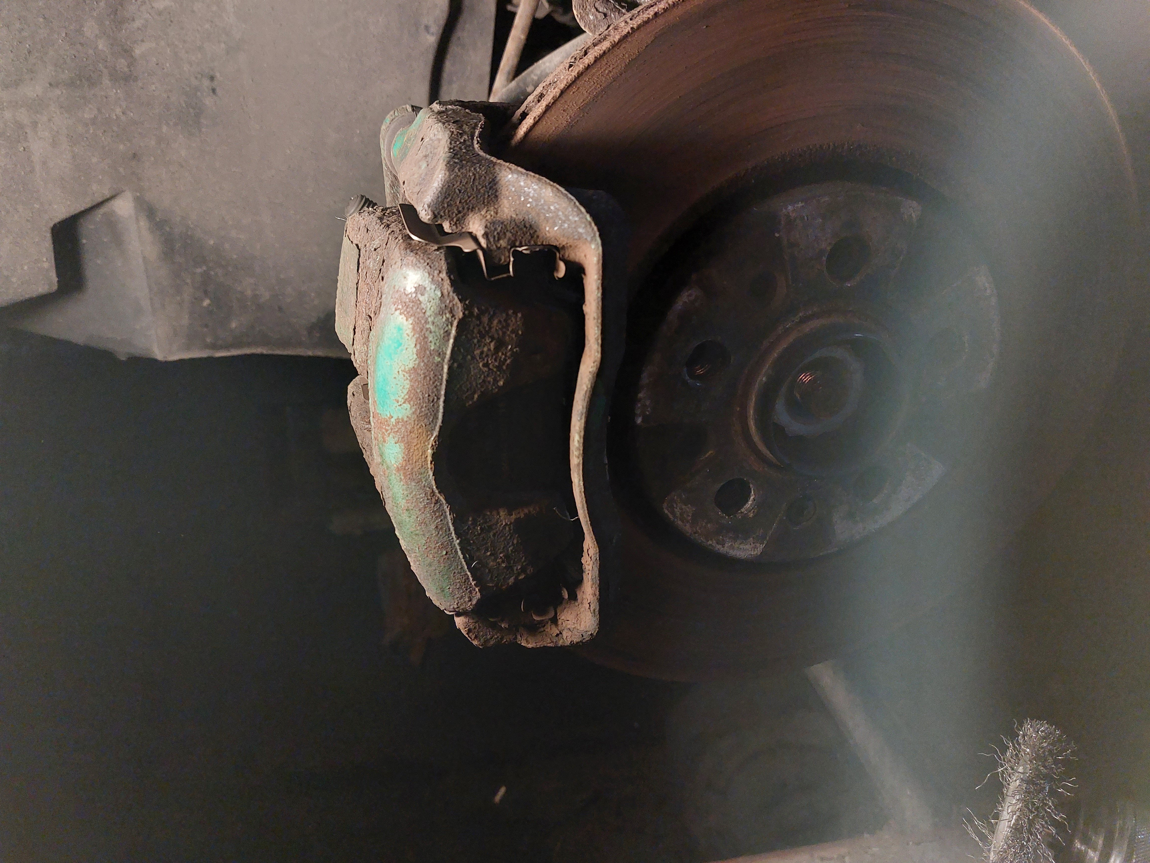

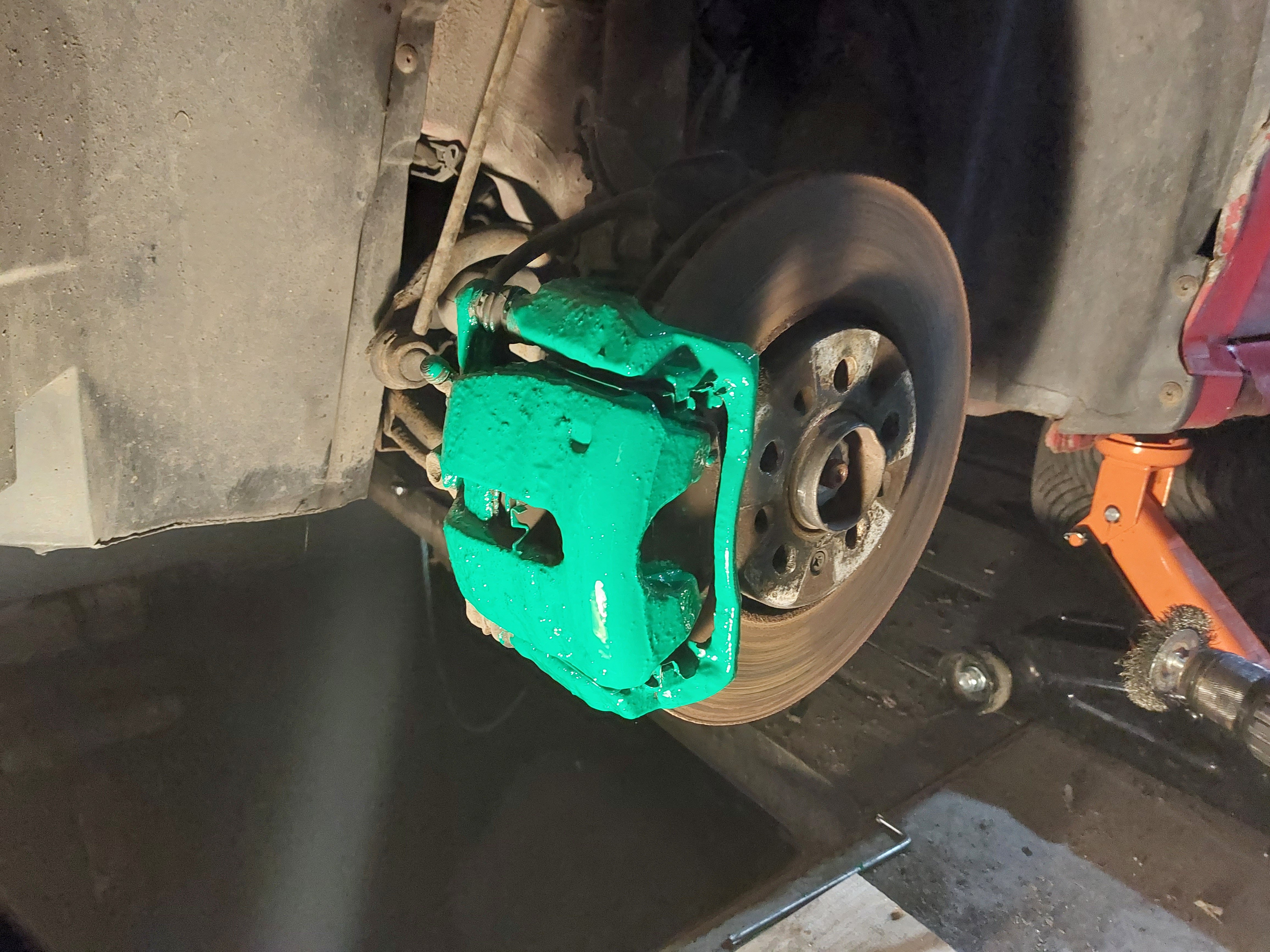

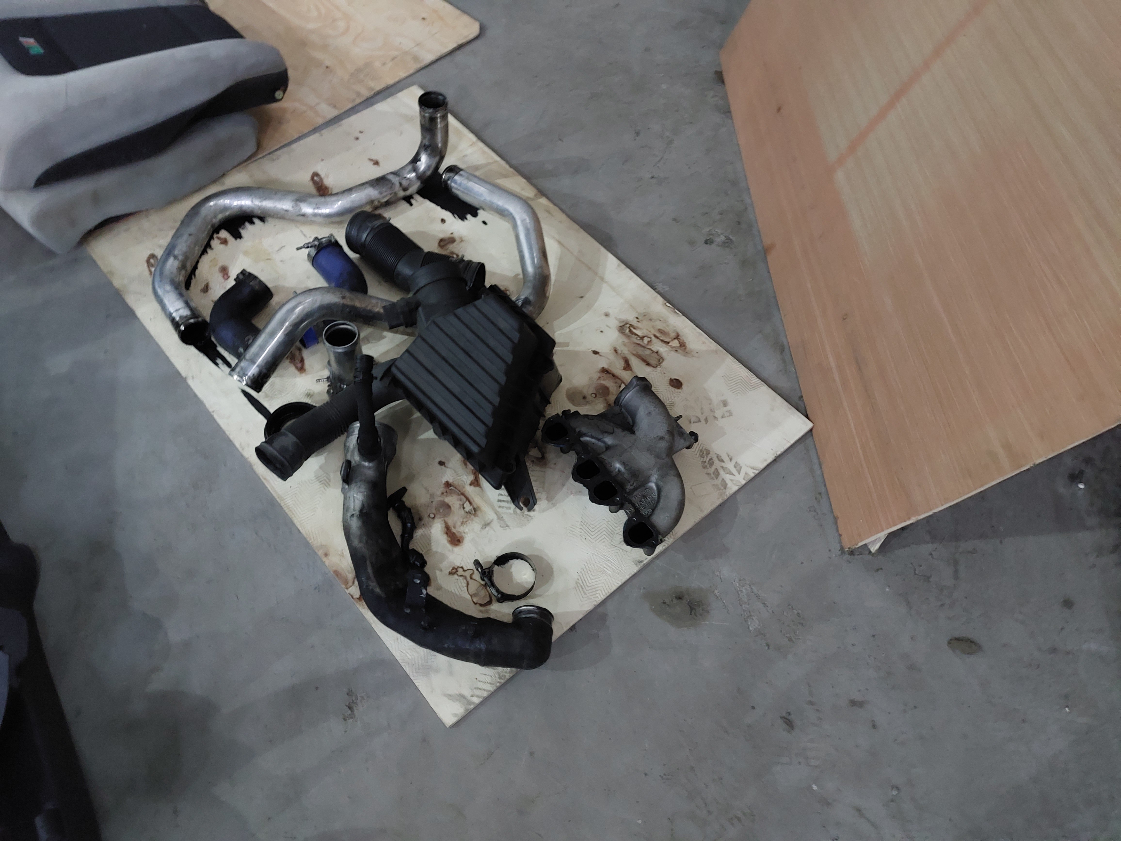

  11. Keeping busy while waiting for the turbo to come back. First, pics of the wing and parcel shelf. Not one with netting unfortunately. Cleaned out the intercooler and piping to get all the dead turbo out Lots and lots of oil Everything's sitting drying now. Cleaned the intake manifold best I could. Lastly gave the front calipers a wire brush and paint. Rears need doing too.
  12. Didn't take that close of a look at it. Looked like any other parcel shelf to me. Why are ones with netting rare?

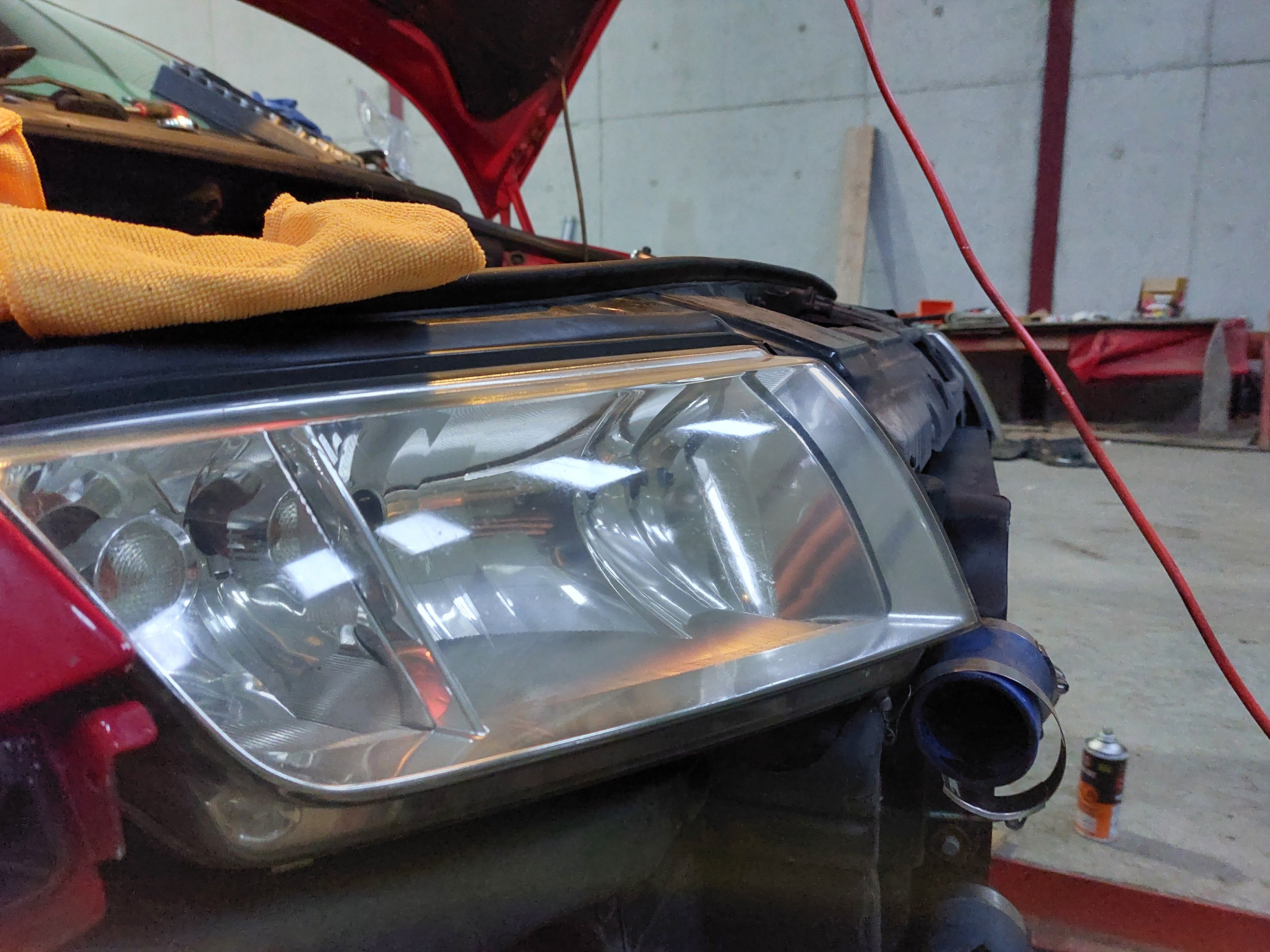

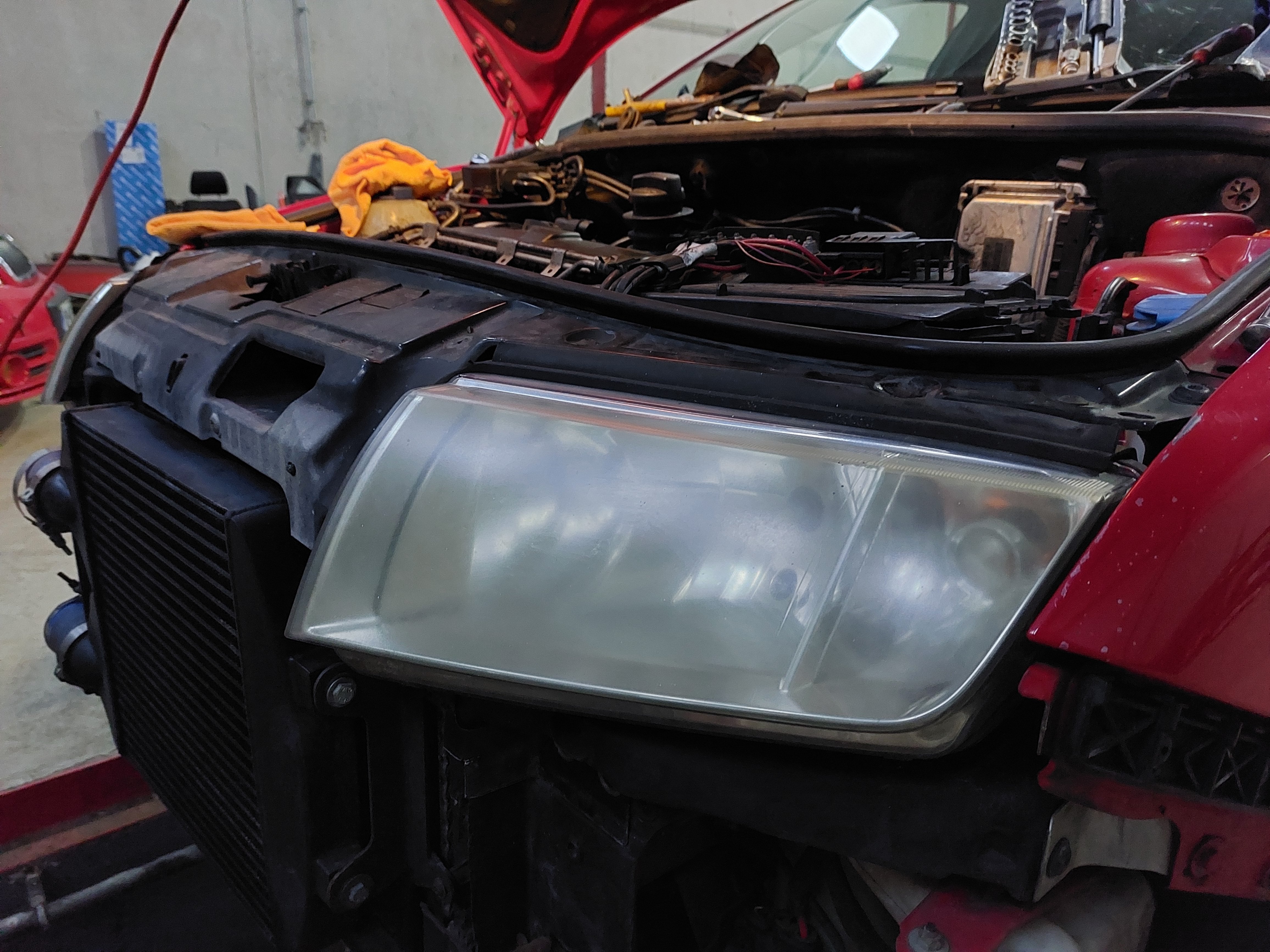

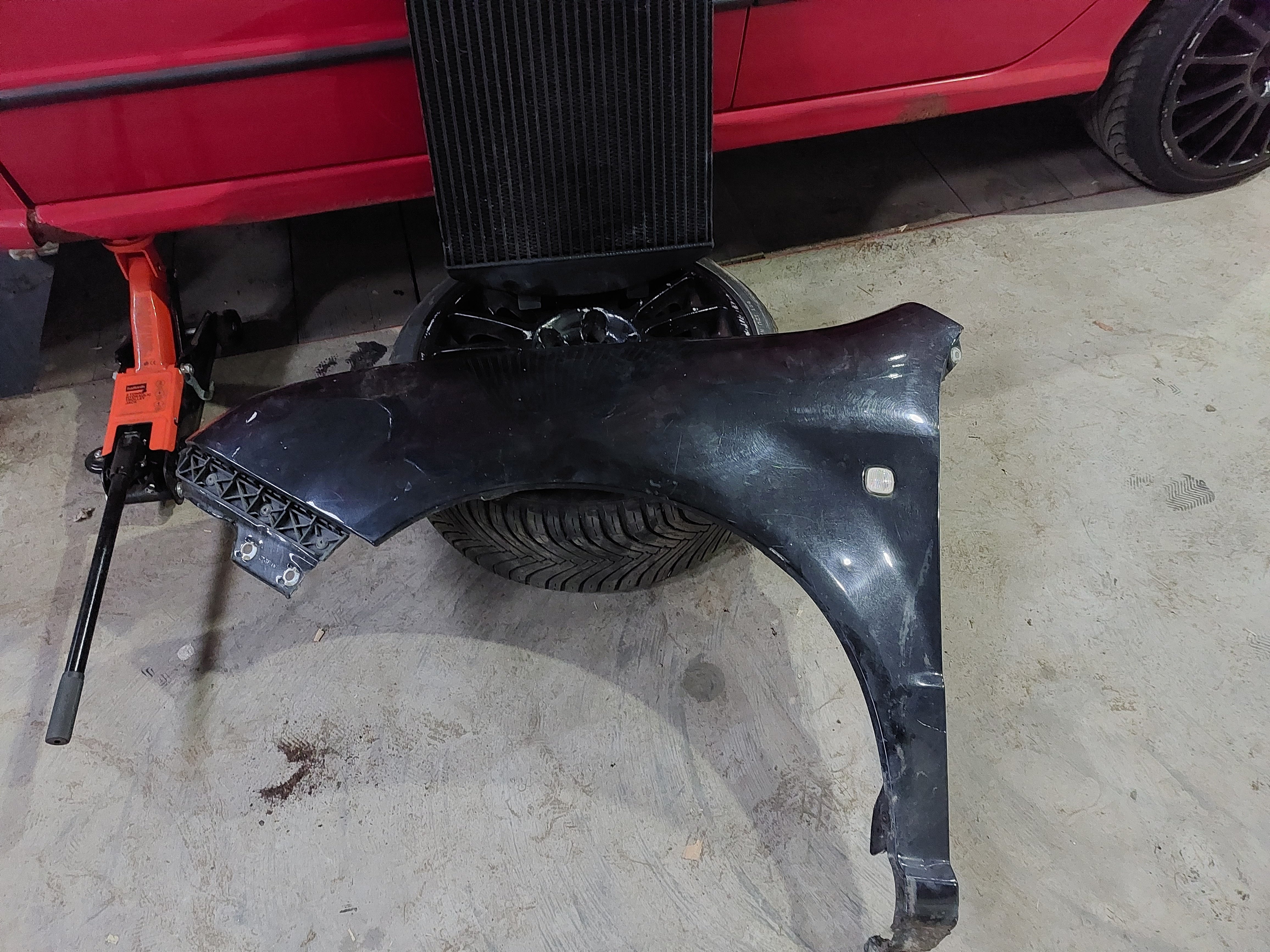

  13. Polished the headlights Came up well Intake manifolds a bit grimy Will clean it up before it all goes back. Also got a Parcel Shelf and passengers wing. And the turbo has been sent off to be reconditioned. Should be done before the weeks out.

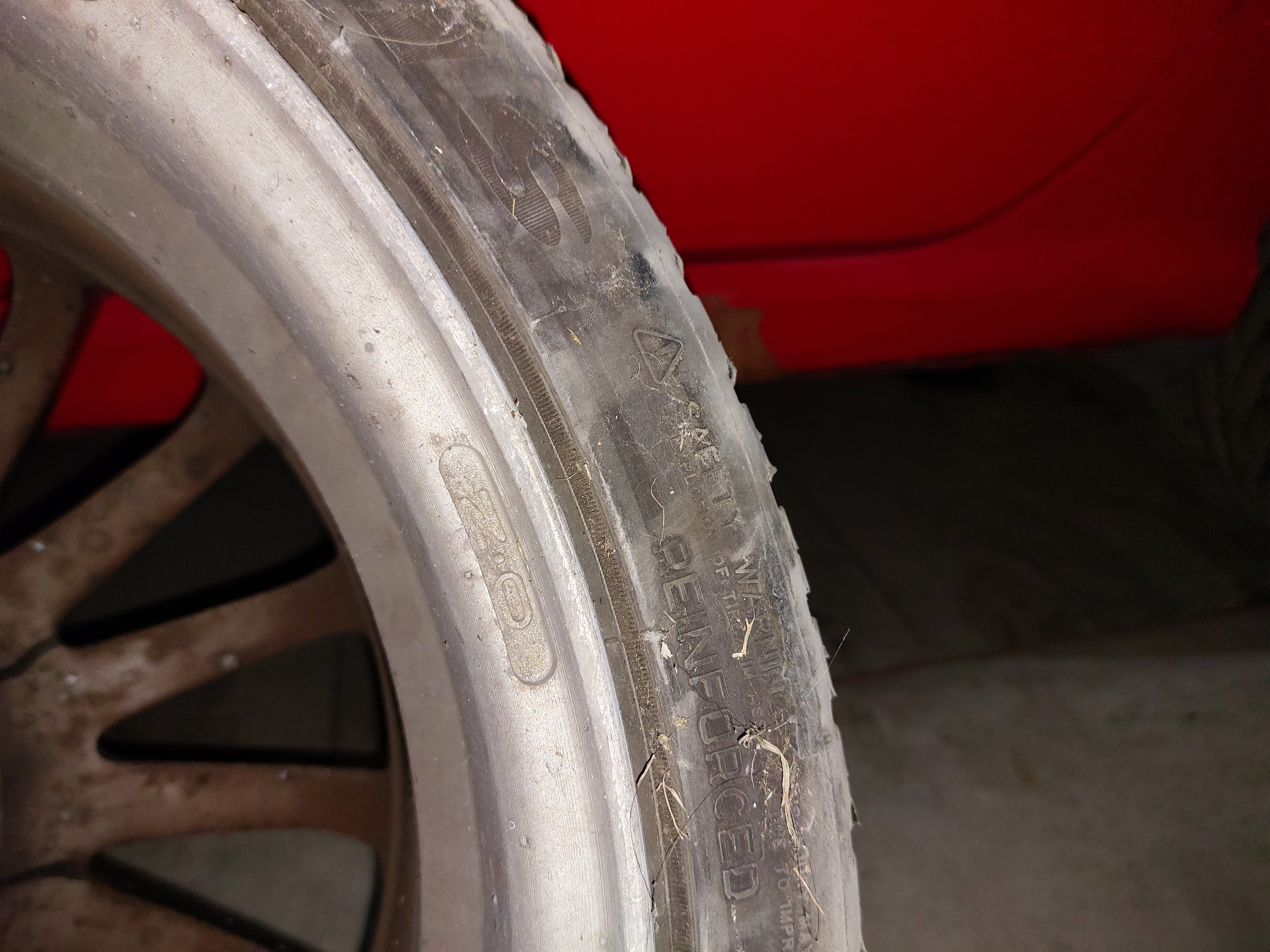

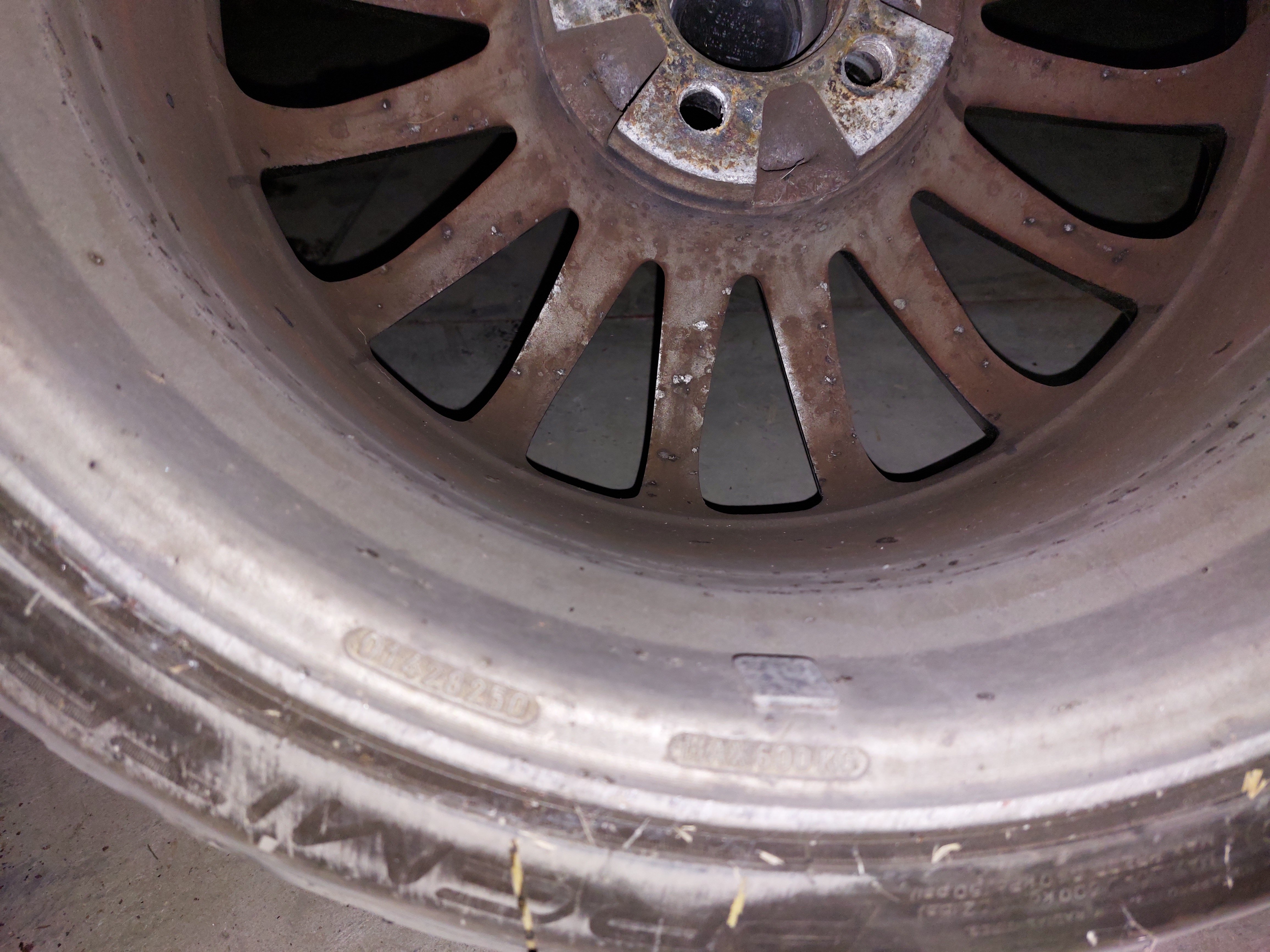

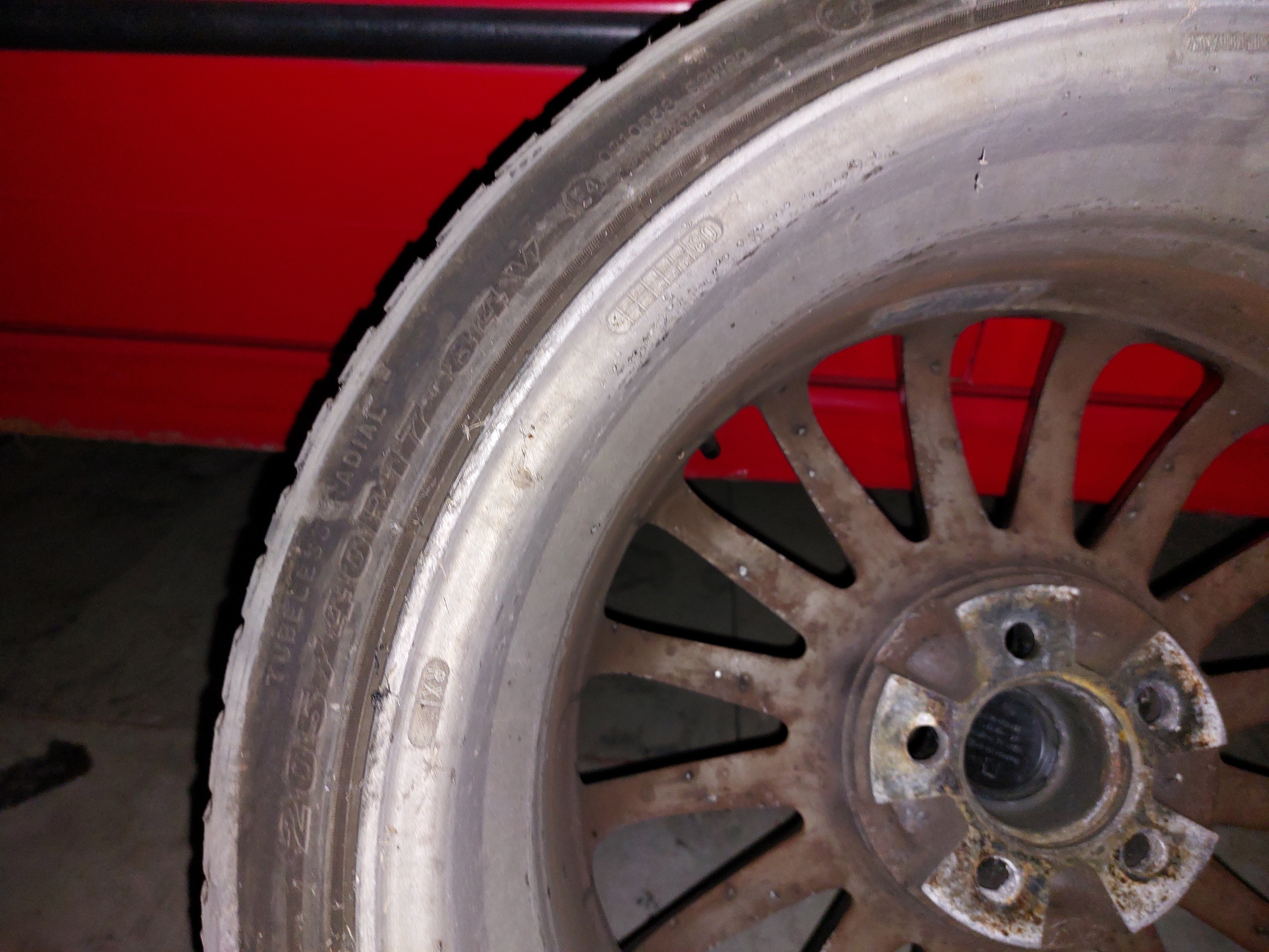

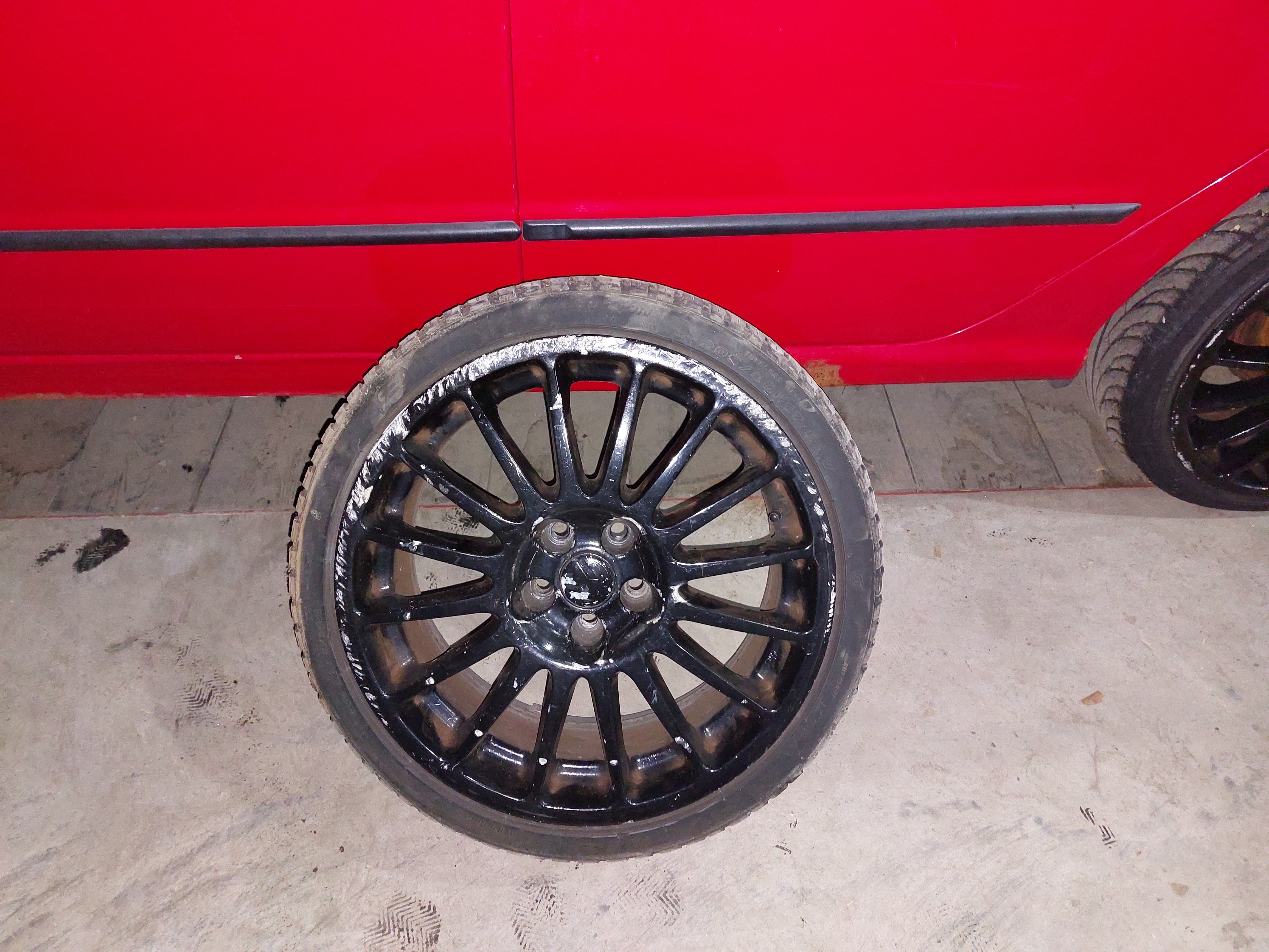

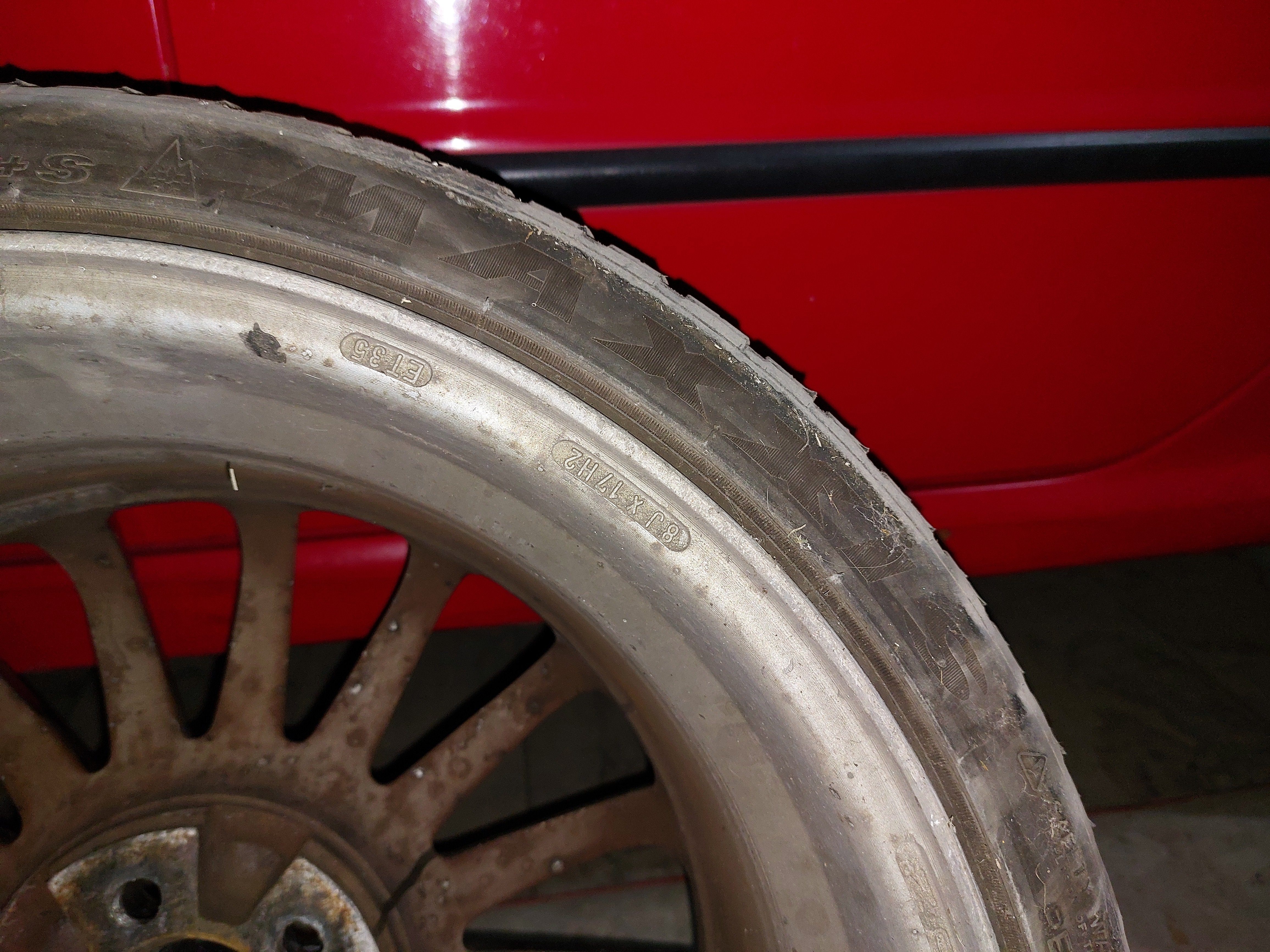

  14. No 17s I've sussed out they are O.Z wheels Most likely O.Z Superturismo GTs 8x17", ET35 offset.

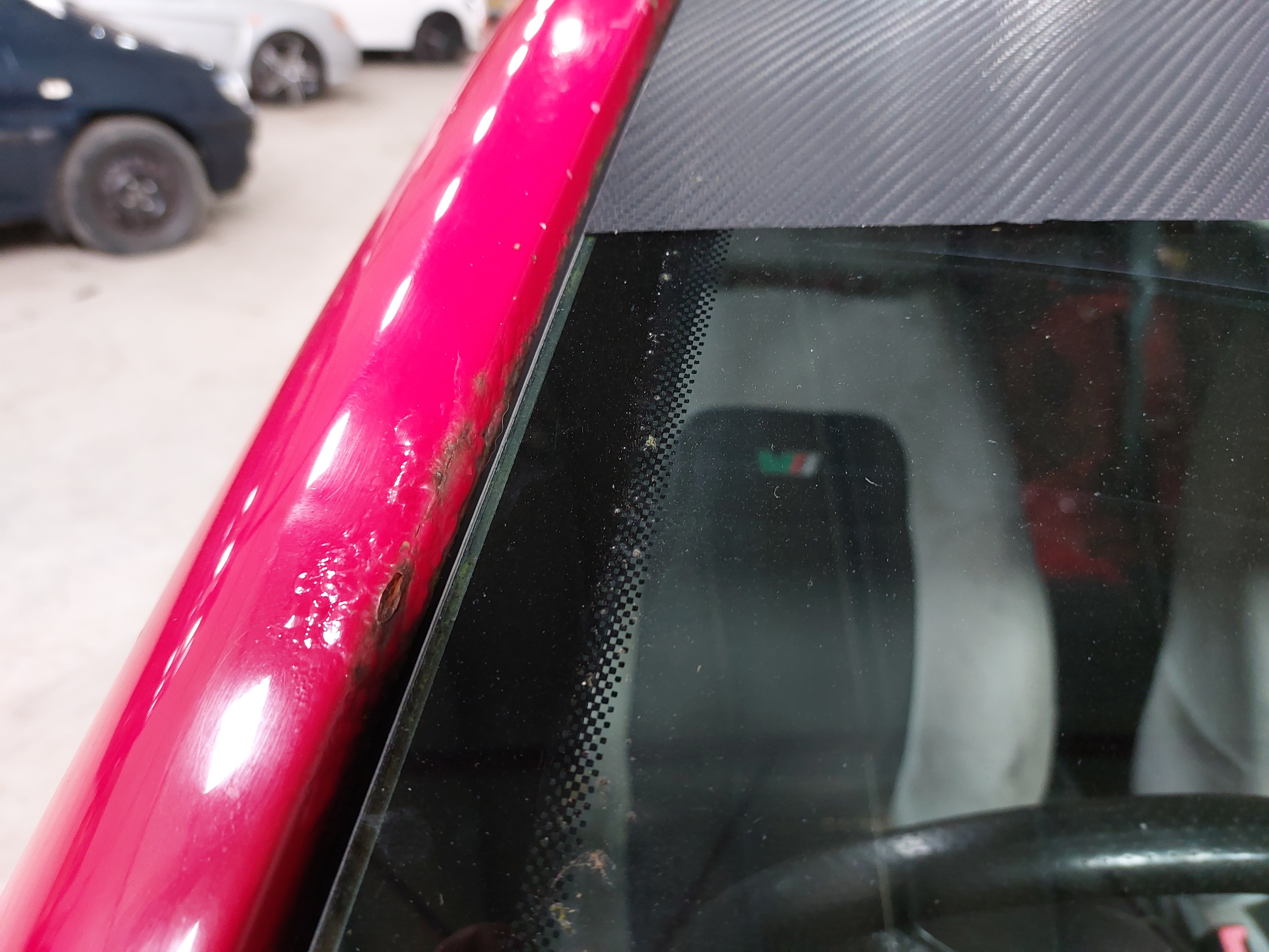

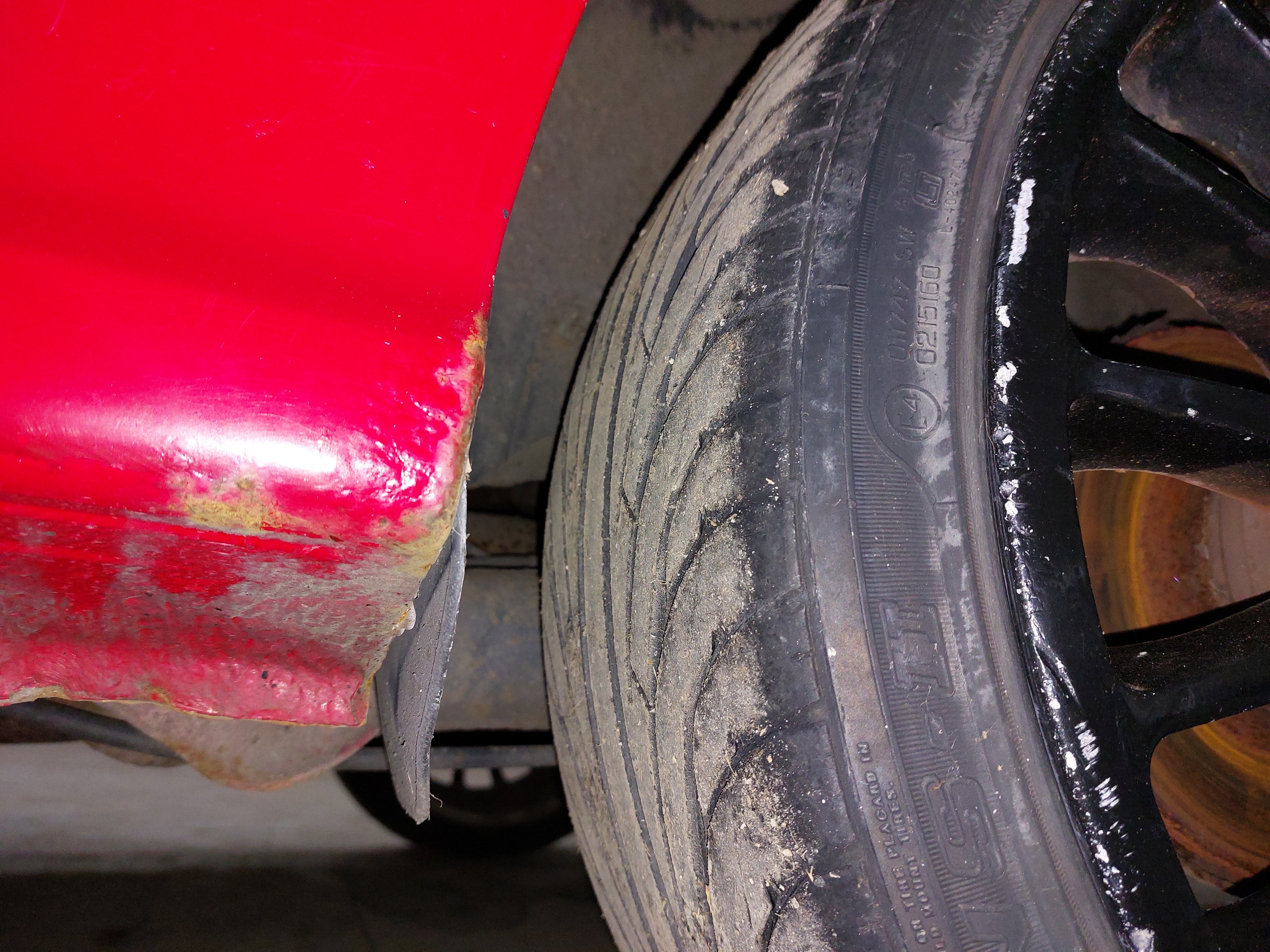

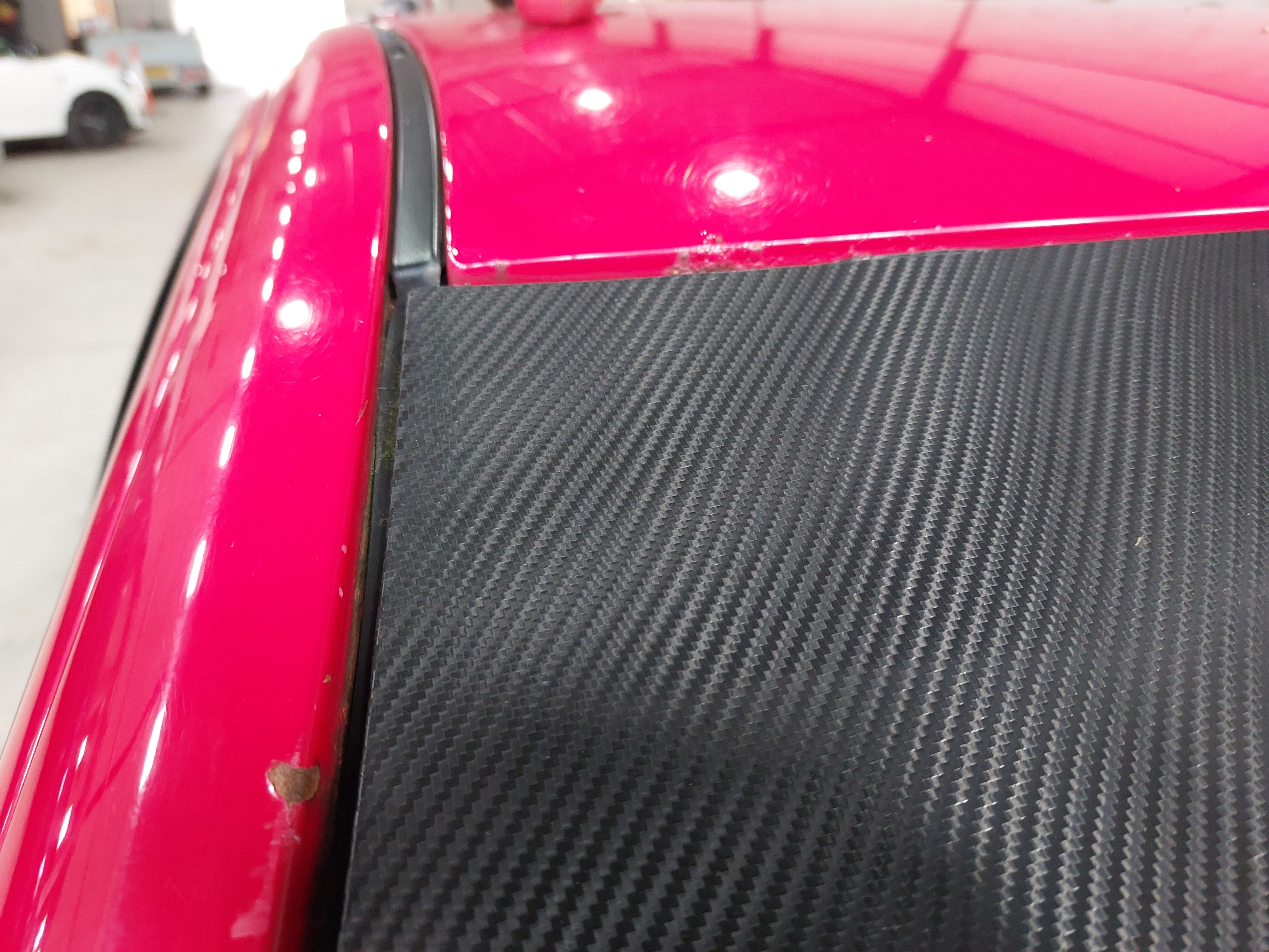

  15. Maybe you can't see it in the photo but it looks to me like it's bubbling along where the glass meets the a pillar. Which would be a **** to sort properly imo. I don't really want to half ass fixing that car to get it to pass an mot only to have it all show up again a few months later Definitely intend on getting the vrs going properly before I decide what to do with it. I wouldn't say I have big plans but I want to ""build"" a mk1 that will last, I think these cars are too old to be messing about half fixing things.

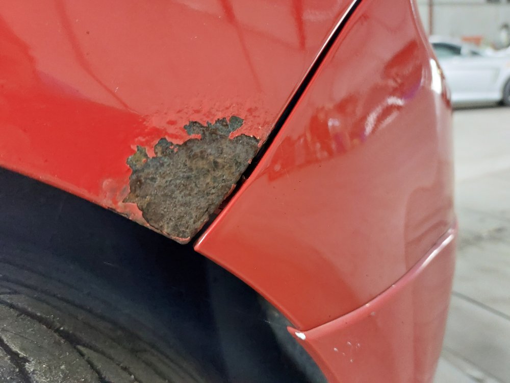

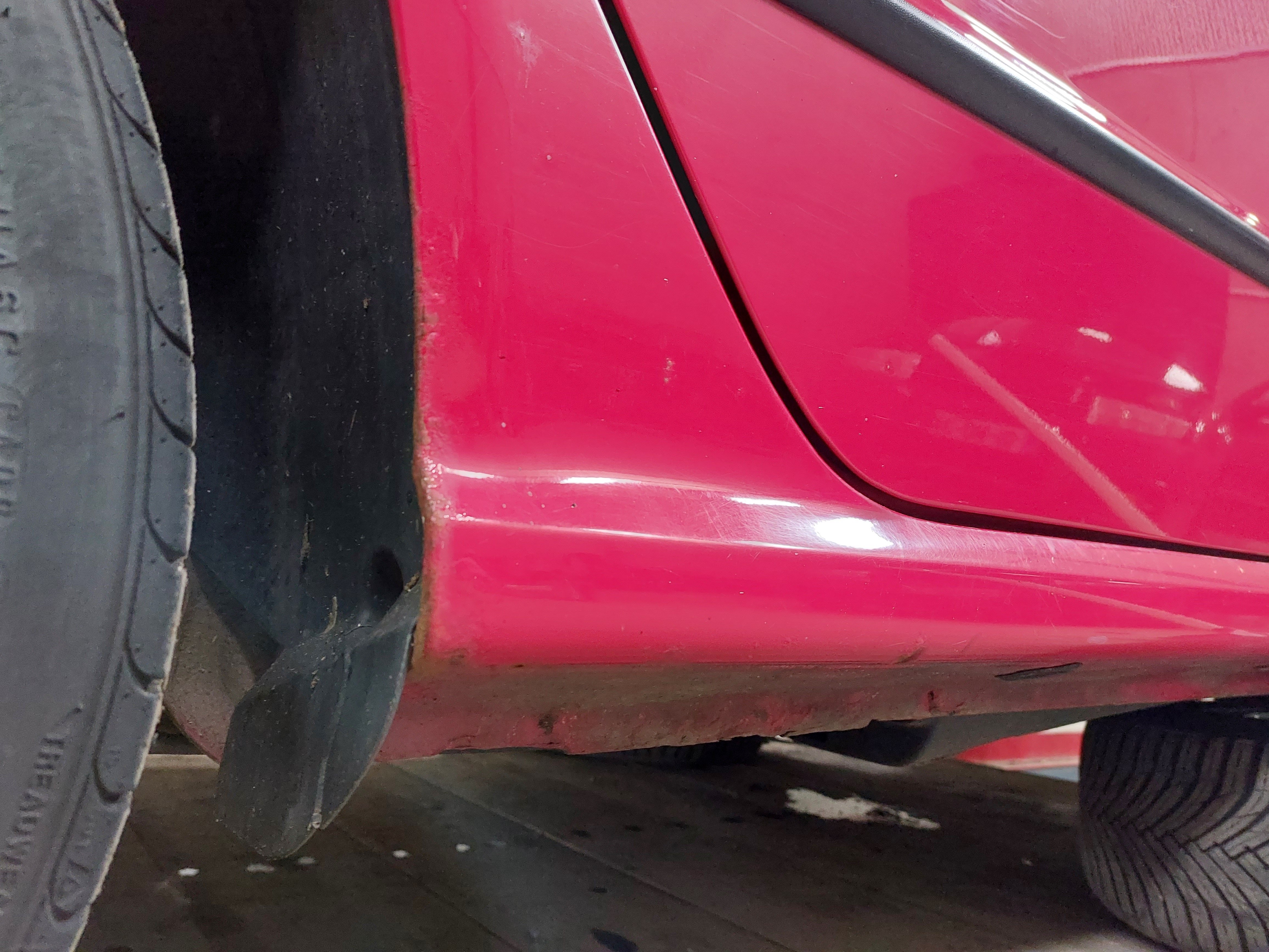

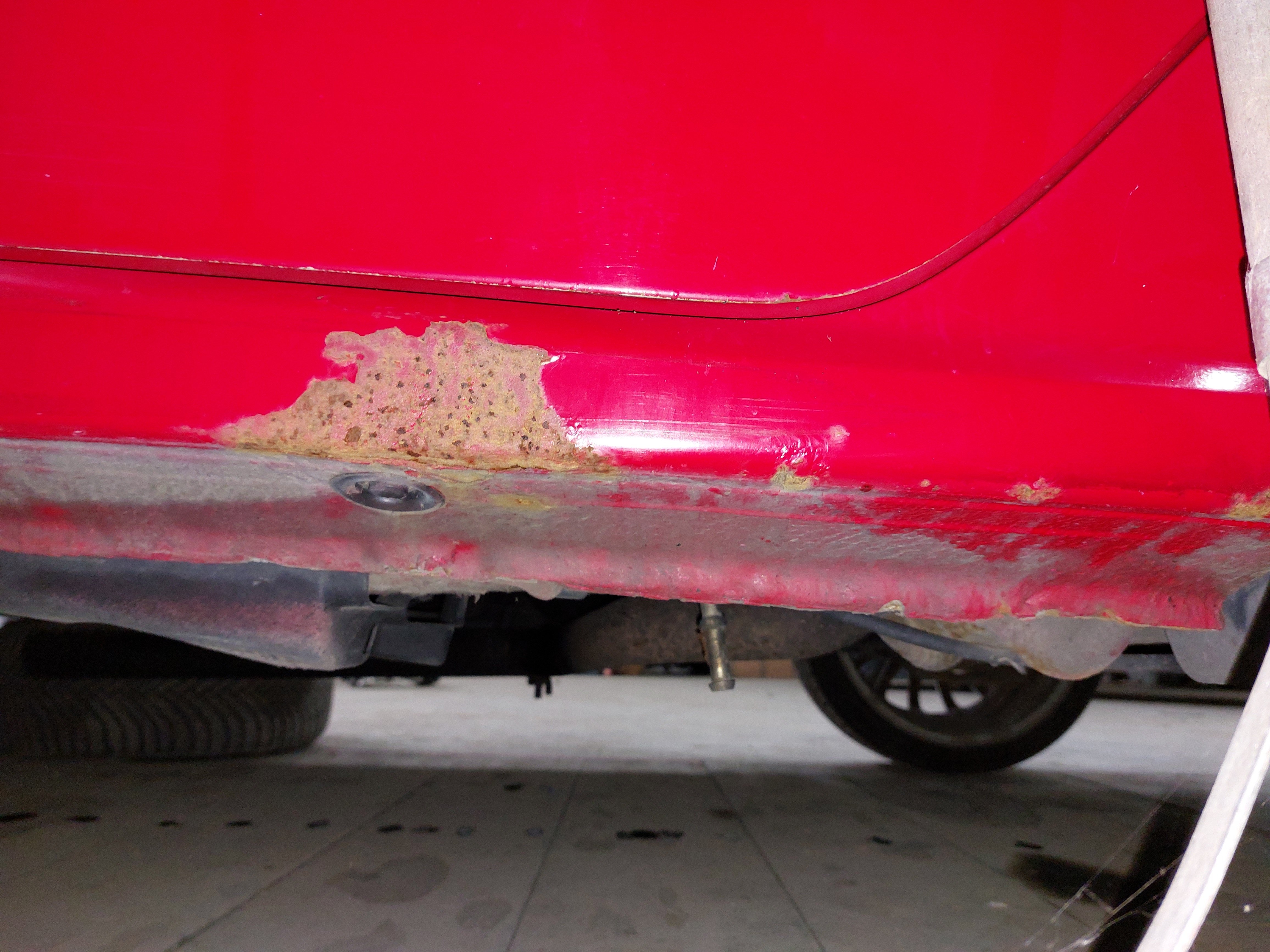

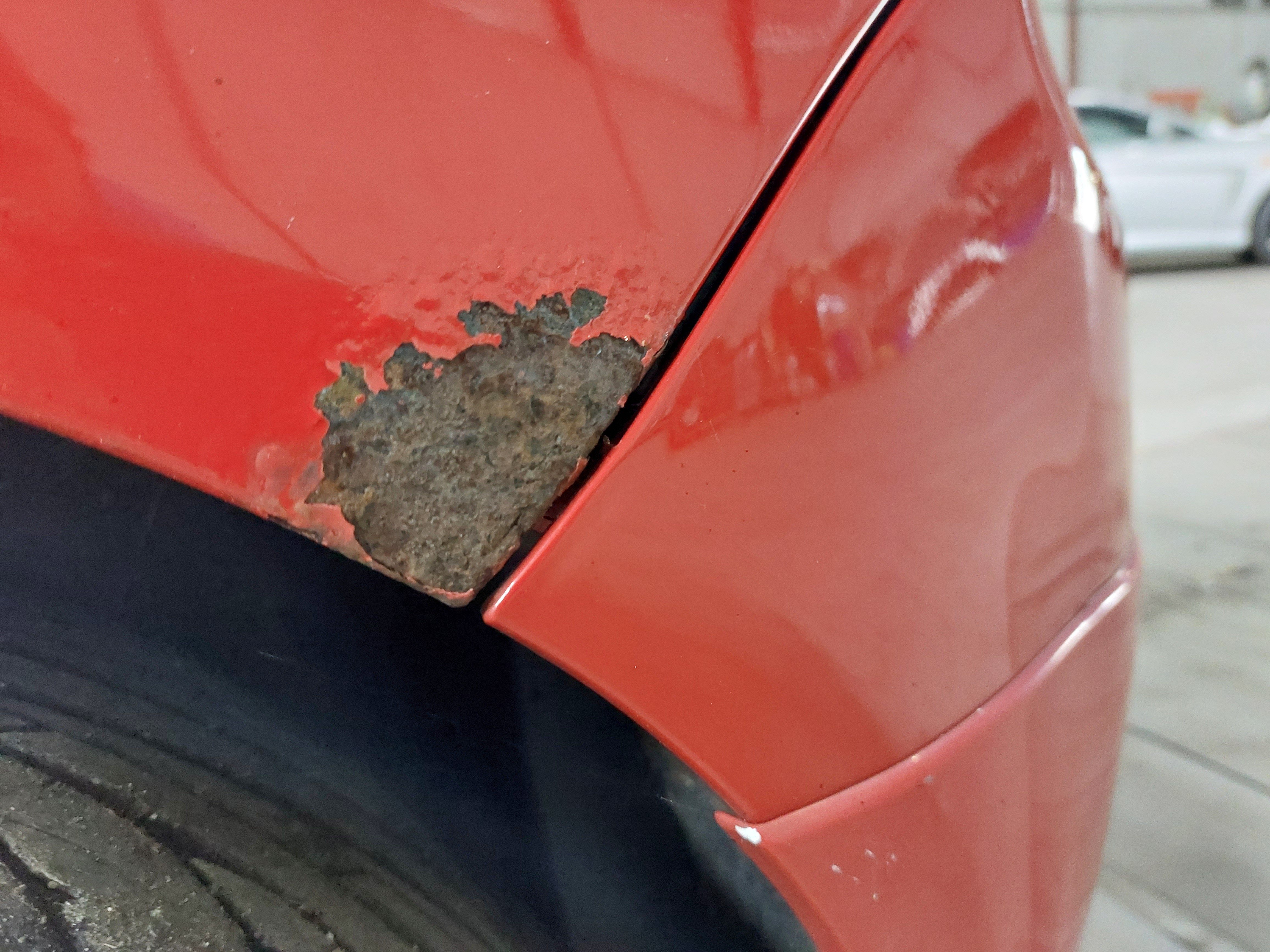

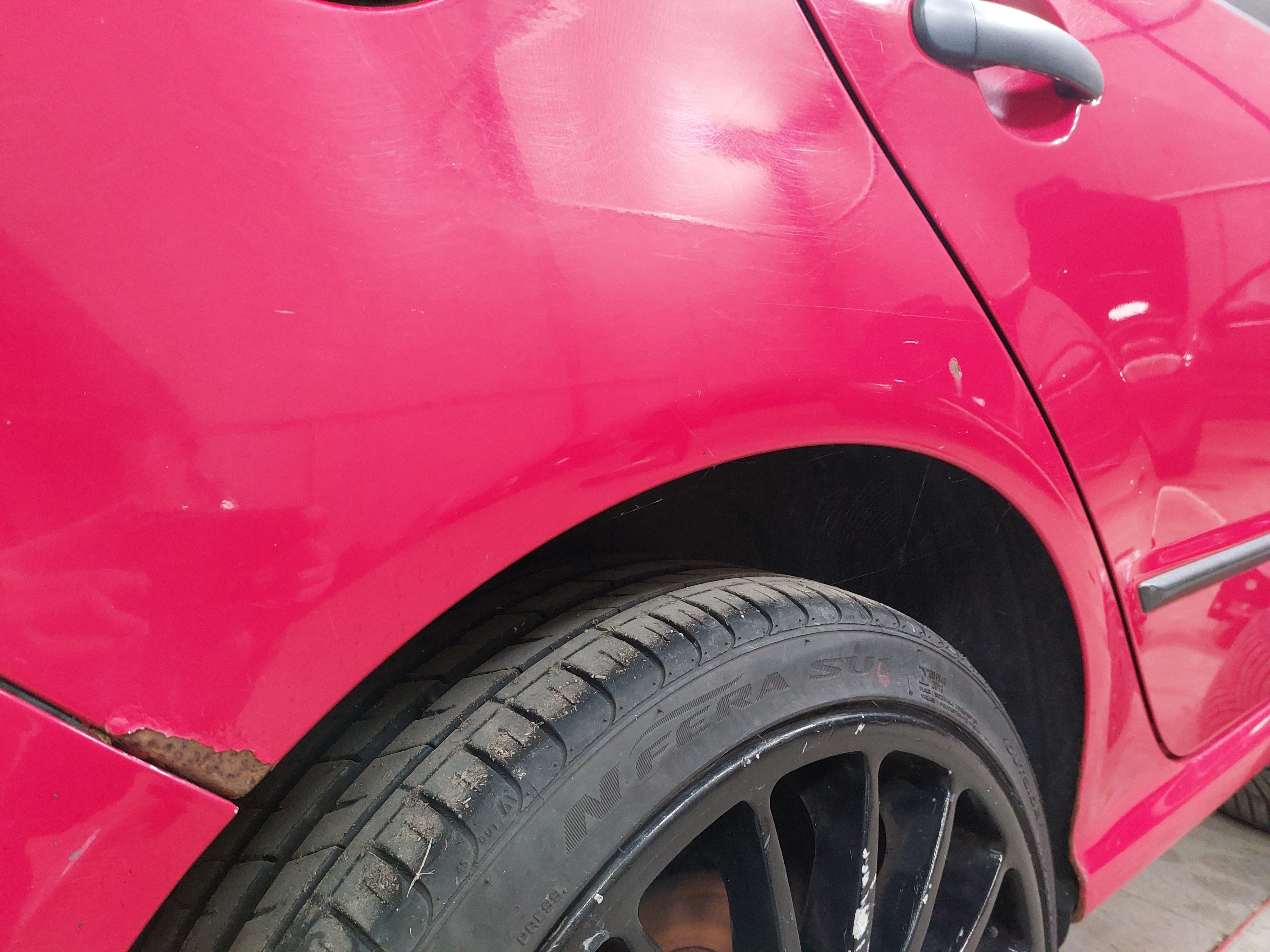

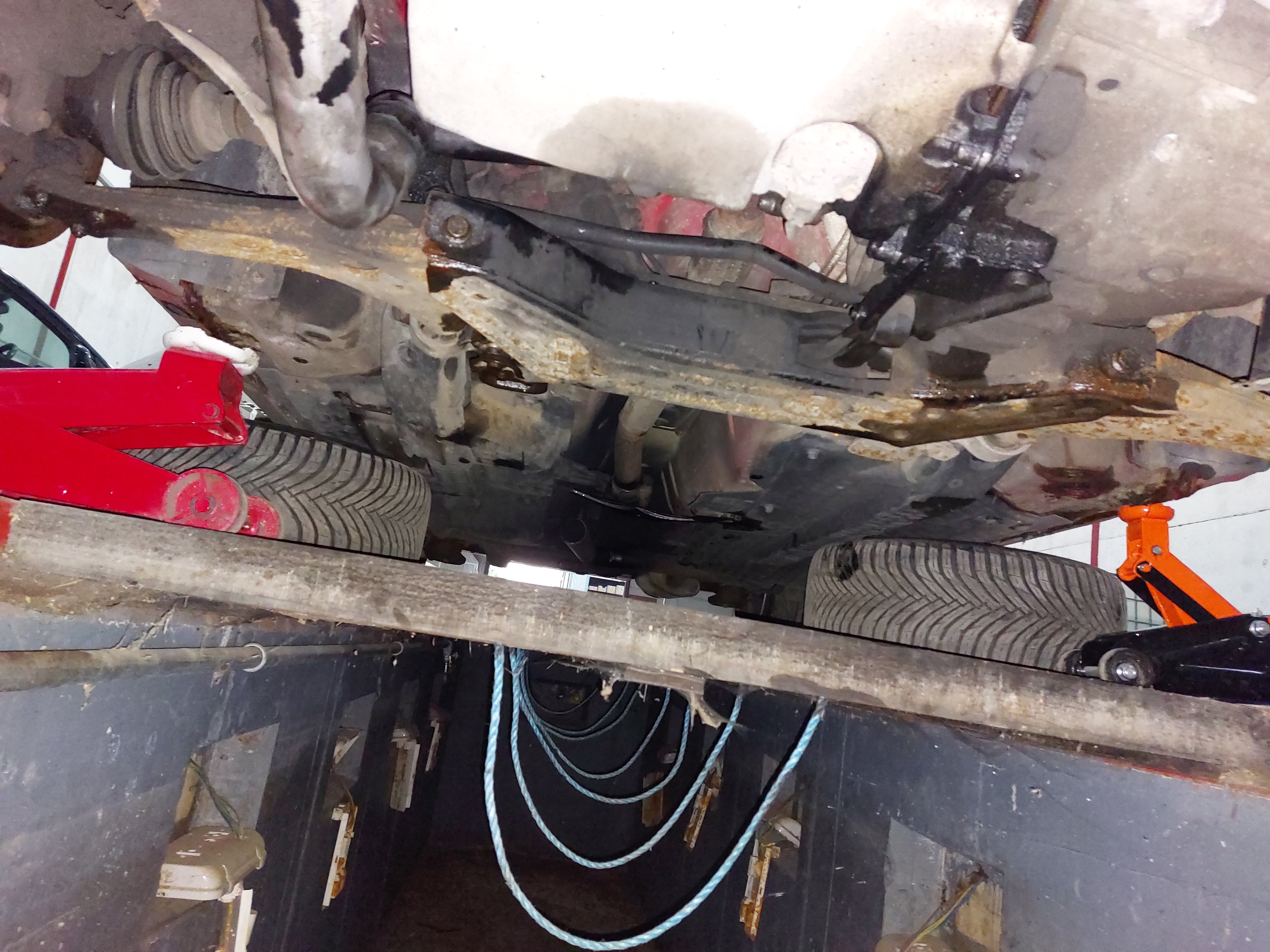

  16. Posting some of the rust on my newest purchase Do we think it should be saved?

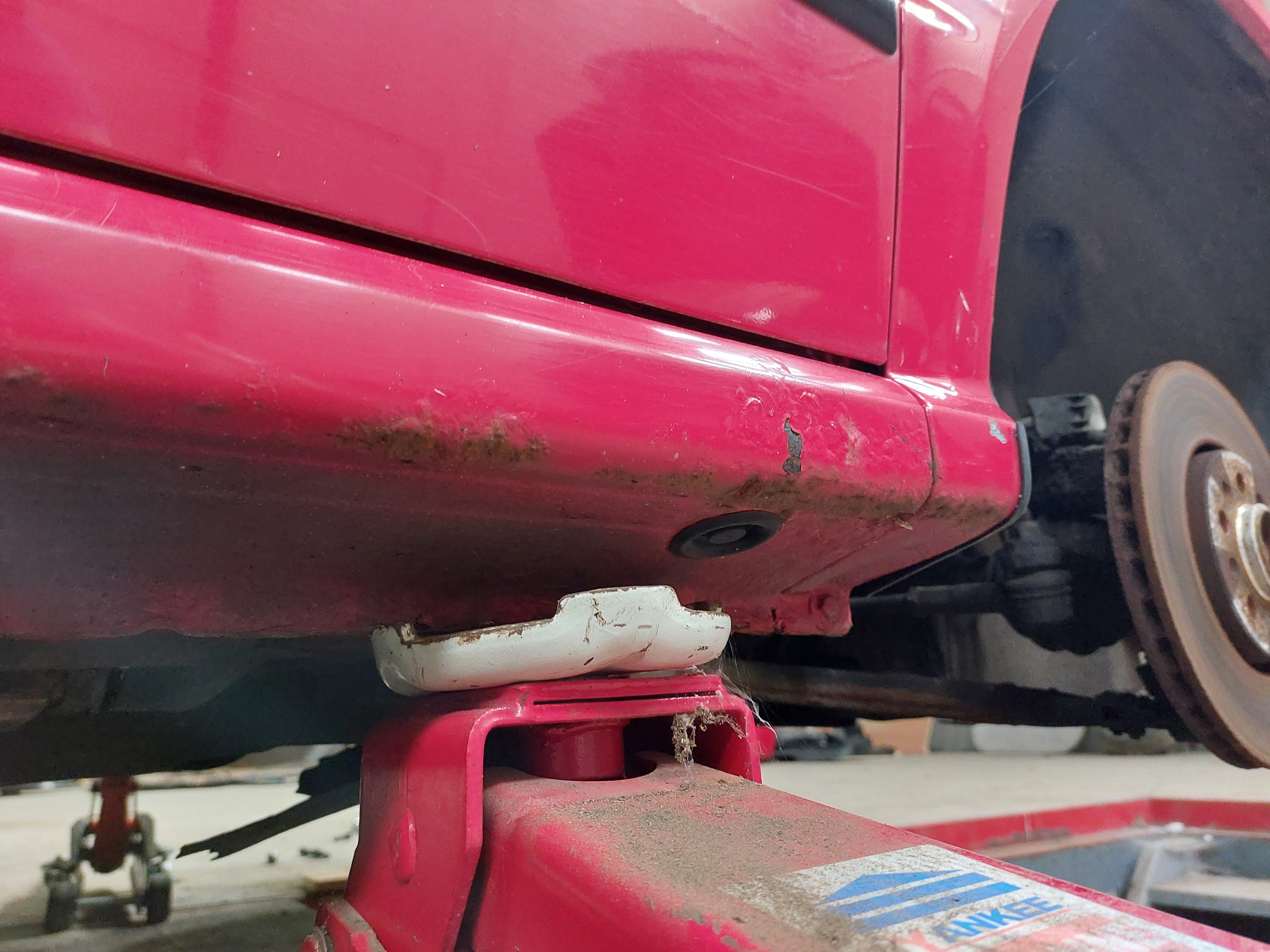

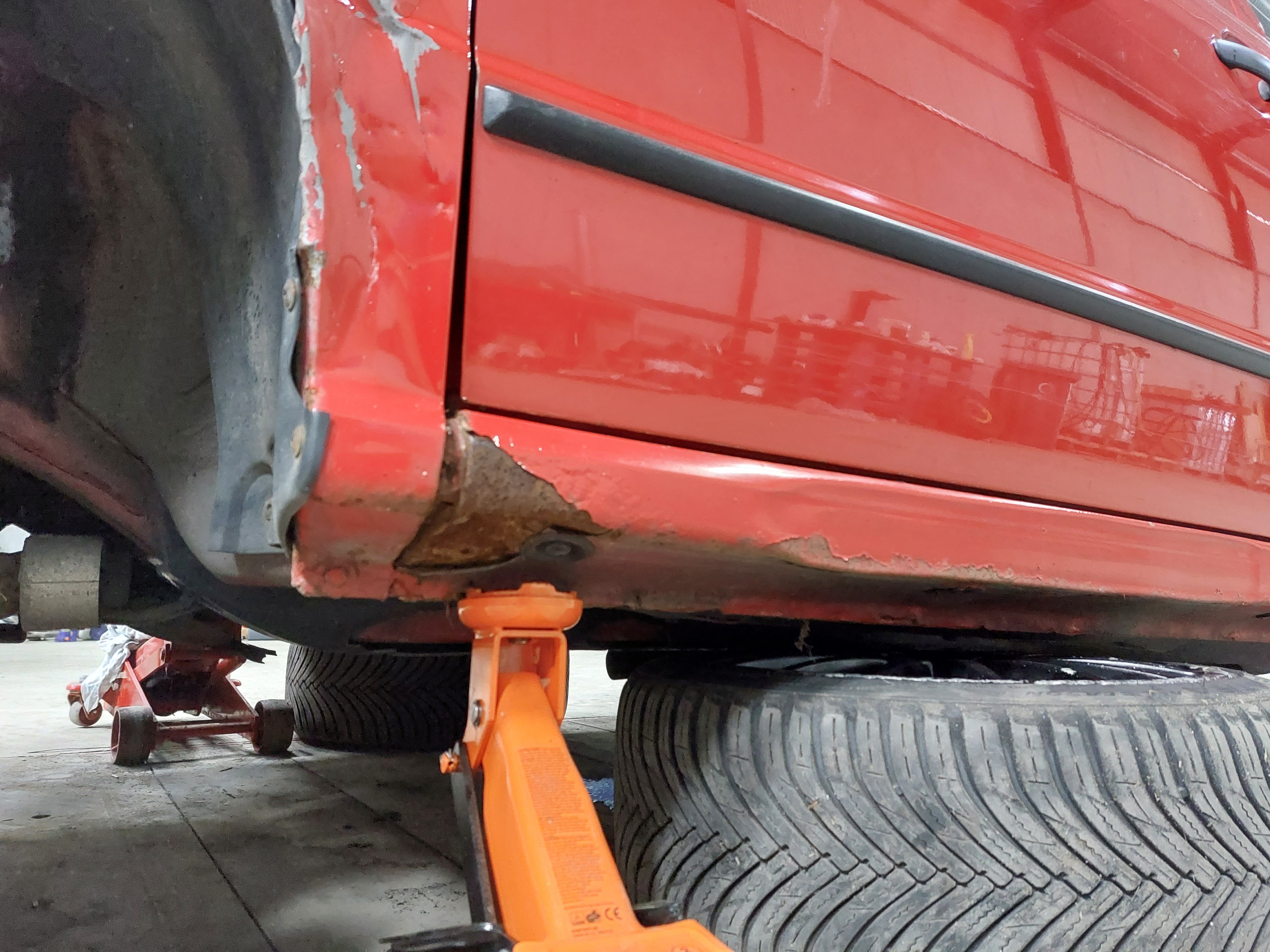

  17. Some photos of the rust on this It's just the angle of the photo that's making the jack look wonky don't worry.

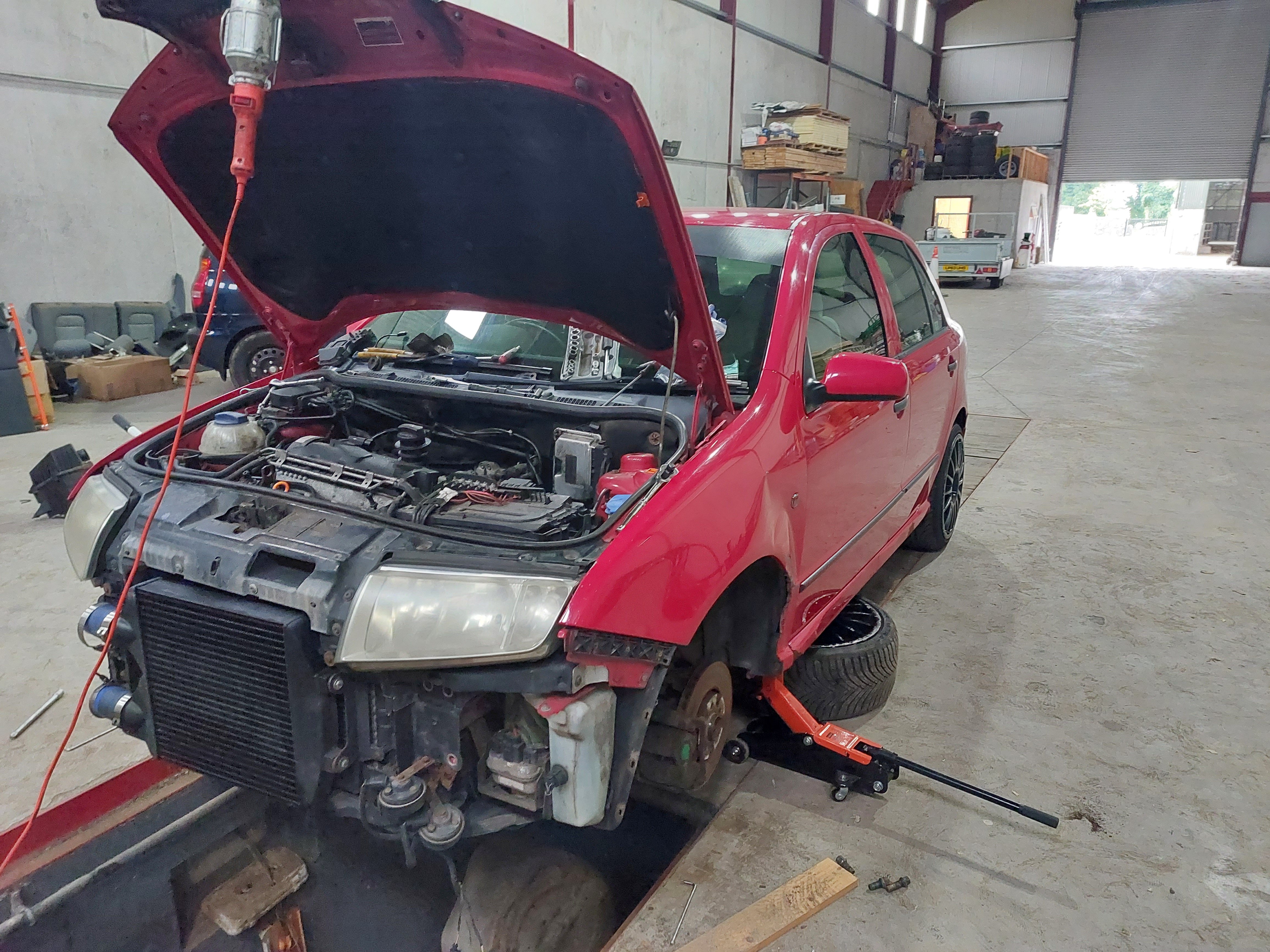

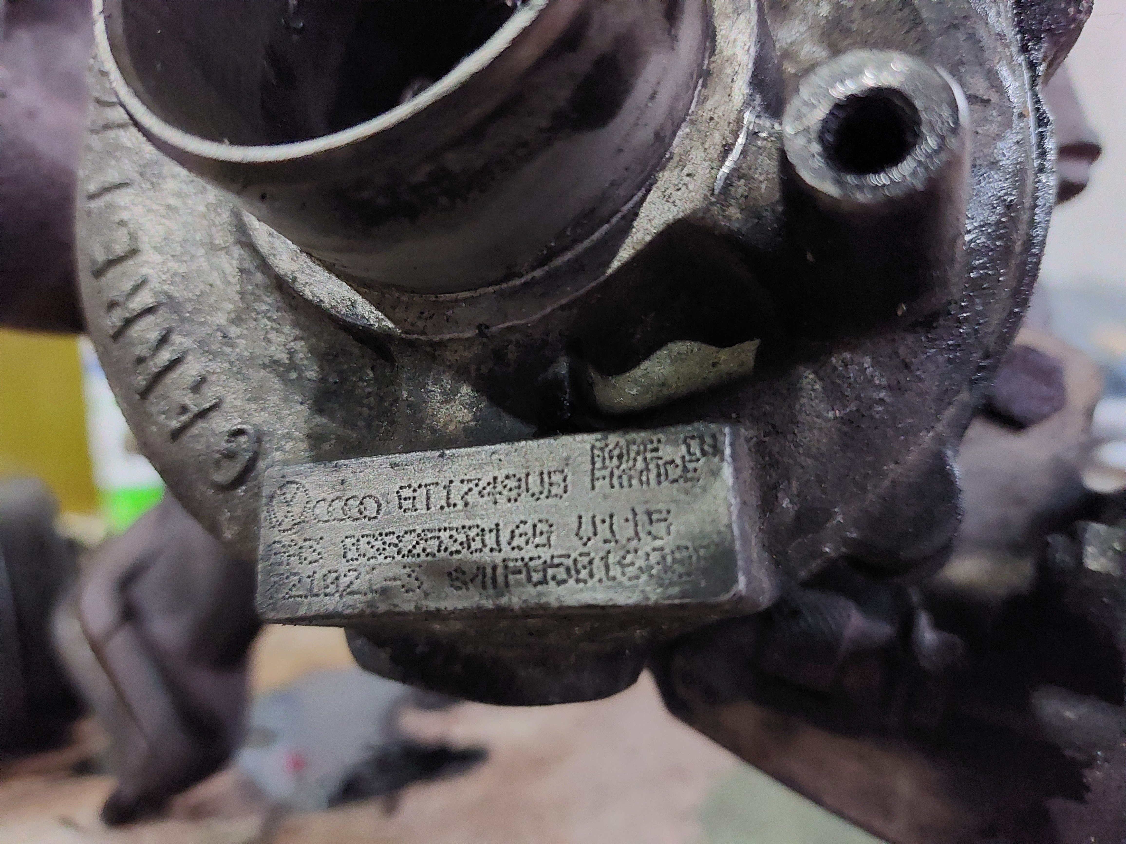

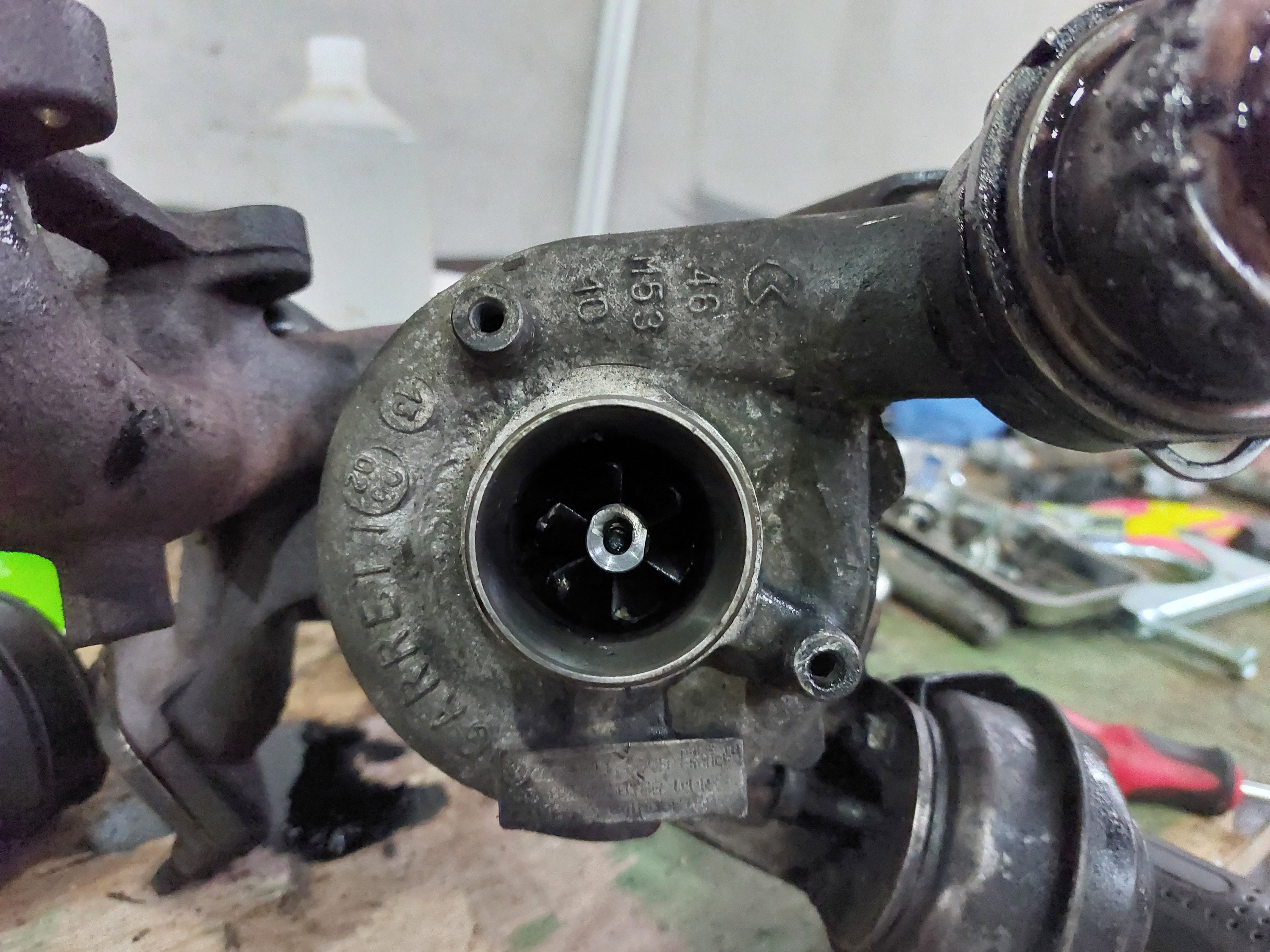

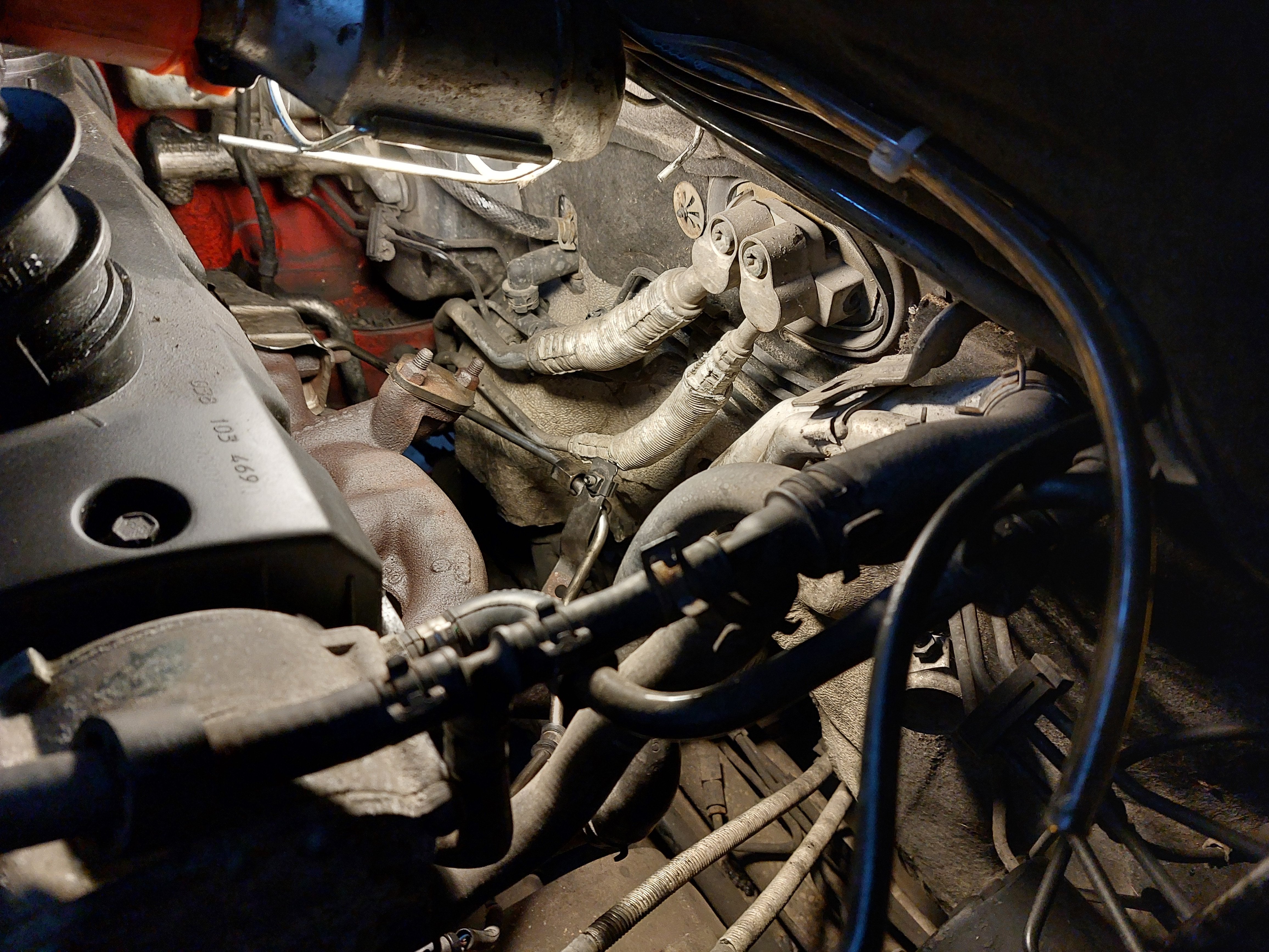

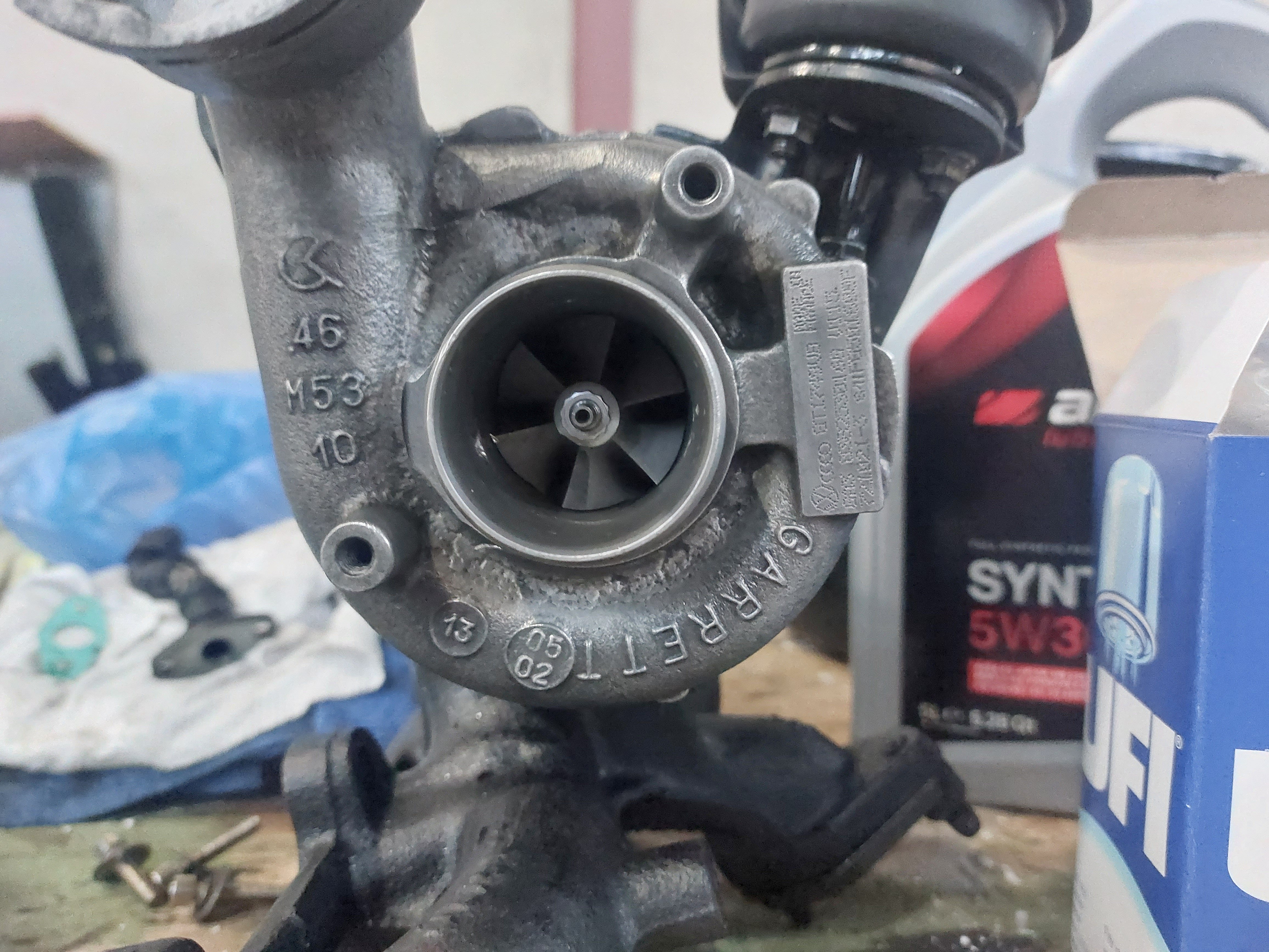

  18. Turbo is out! Much easier than I thought it would be. I used a guide on here to help me See how bad the turbine on the cold side is? It gets worse, the exhaust side doesn't seem too bad for whatever reason. Atleast I now know the model of it Its a garrett GT1749VB. From what I gather its what's fitted to ARL PD150 engines. Was told it was a hybrid turbo, can't really see anything special on it that makes it one. Going to try have this reconditioned but don't have terribly high hopes seeing this. I'll ring a few places tomorrow anyway.

  20. Forgot all about the arch liners! Yeah I'll definitely need to check them out, it has a Blackpool council parking disc on it so it's been by the seaside for some of its life. I appreciate you holding onto that bar for me Have the feeling this one will be quite crusty

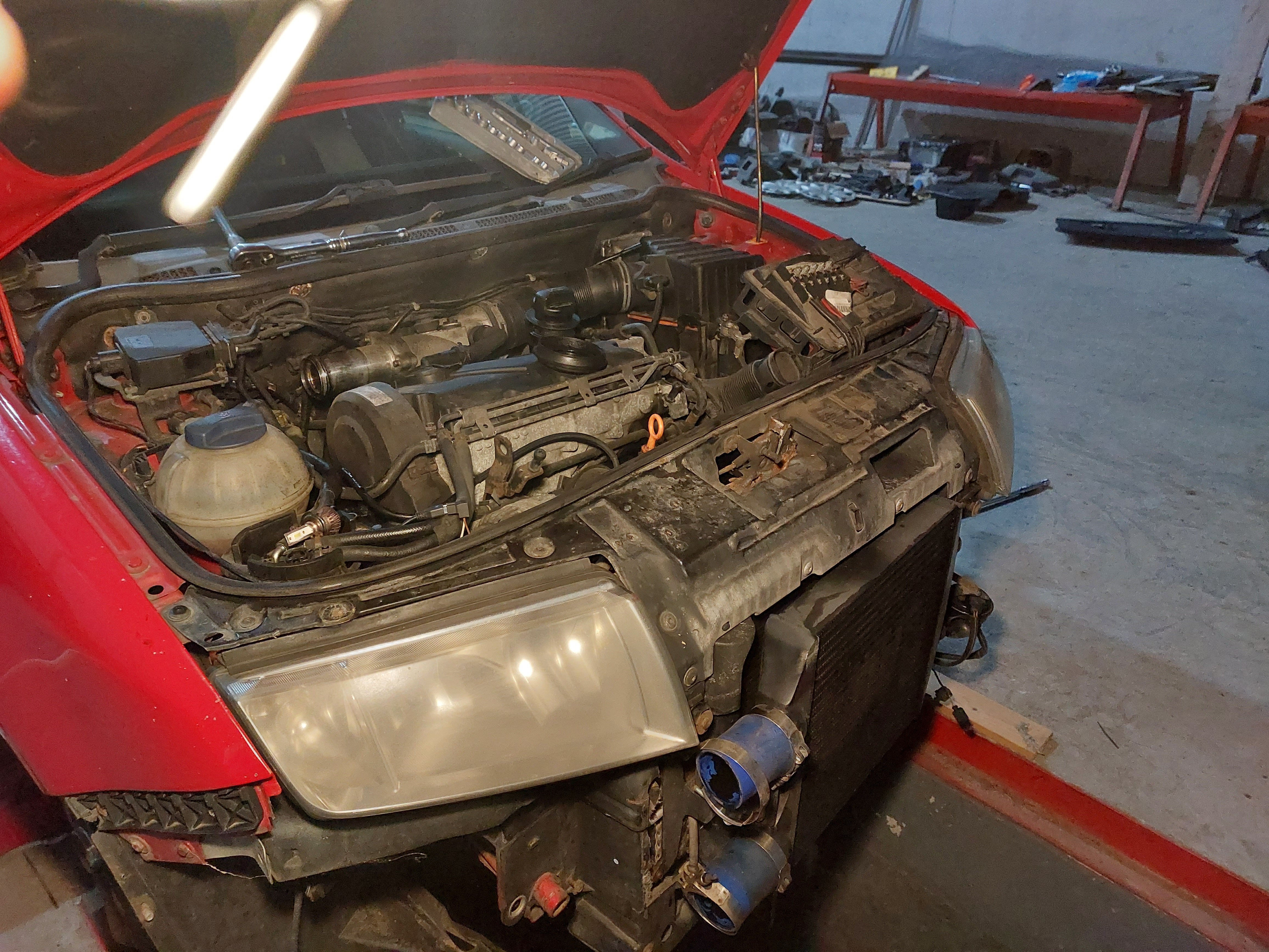

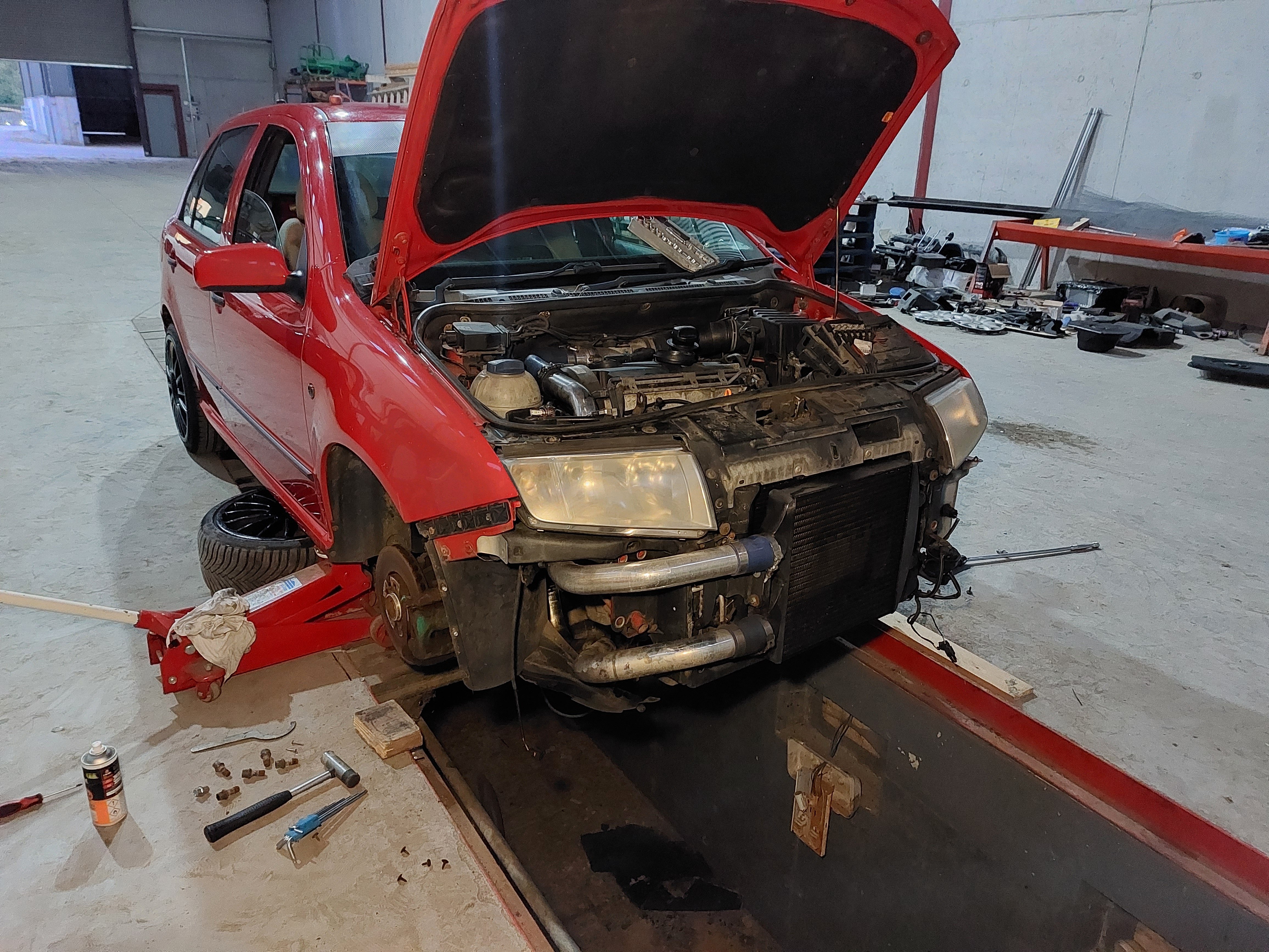

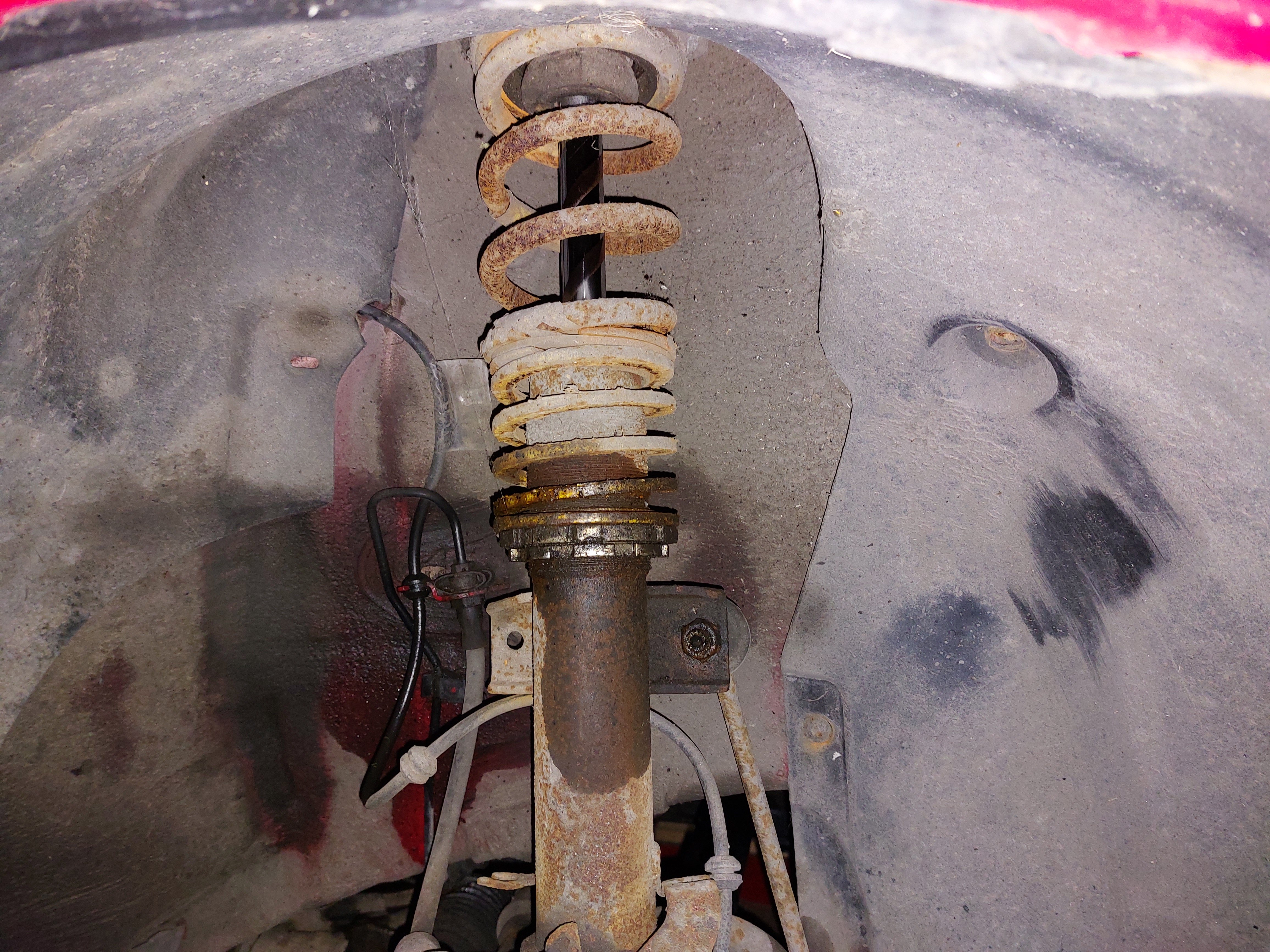

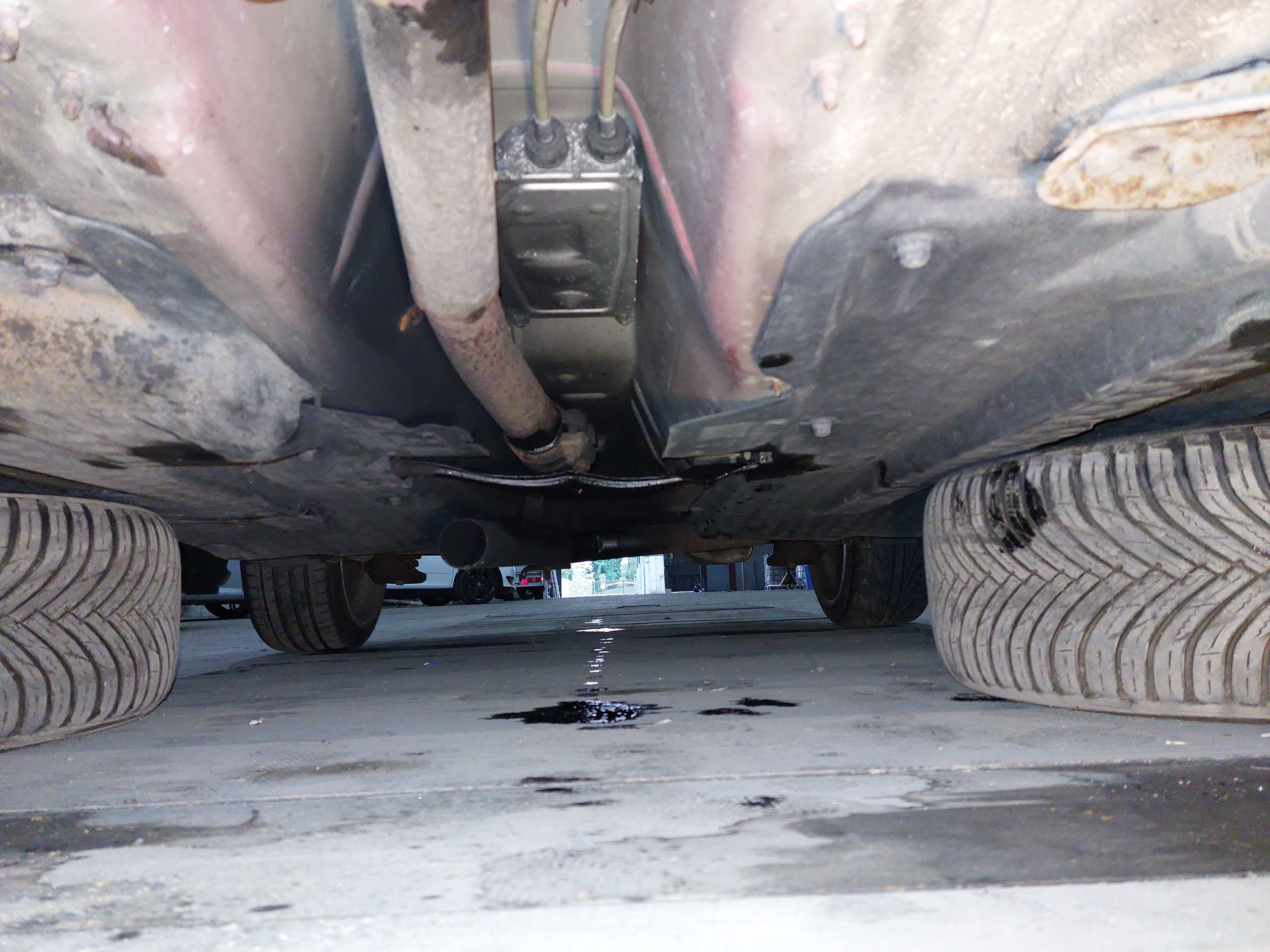

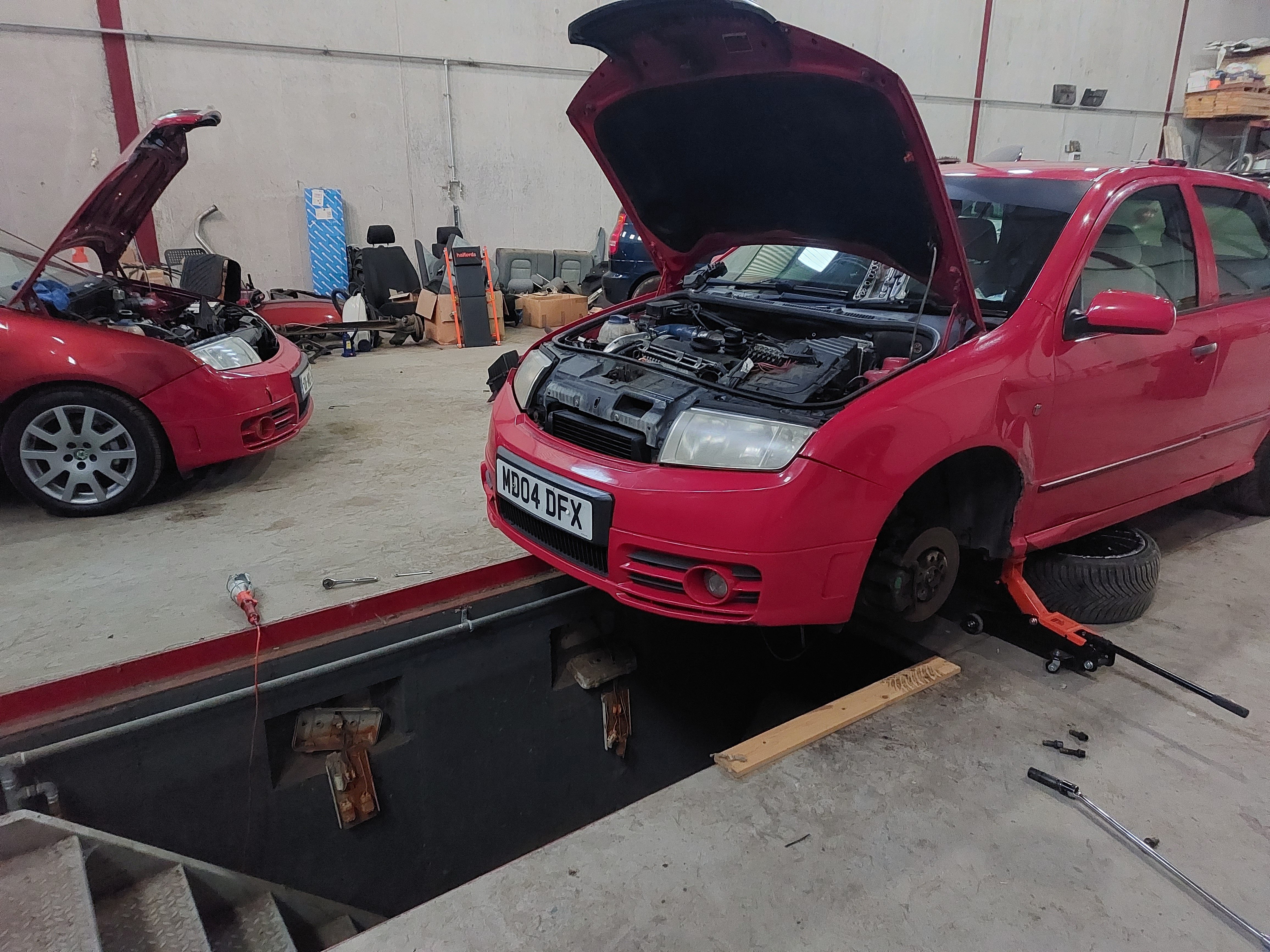

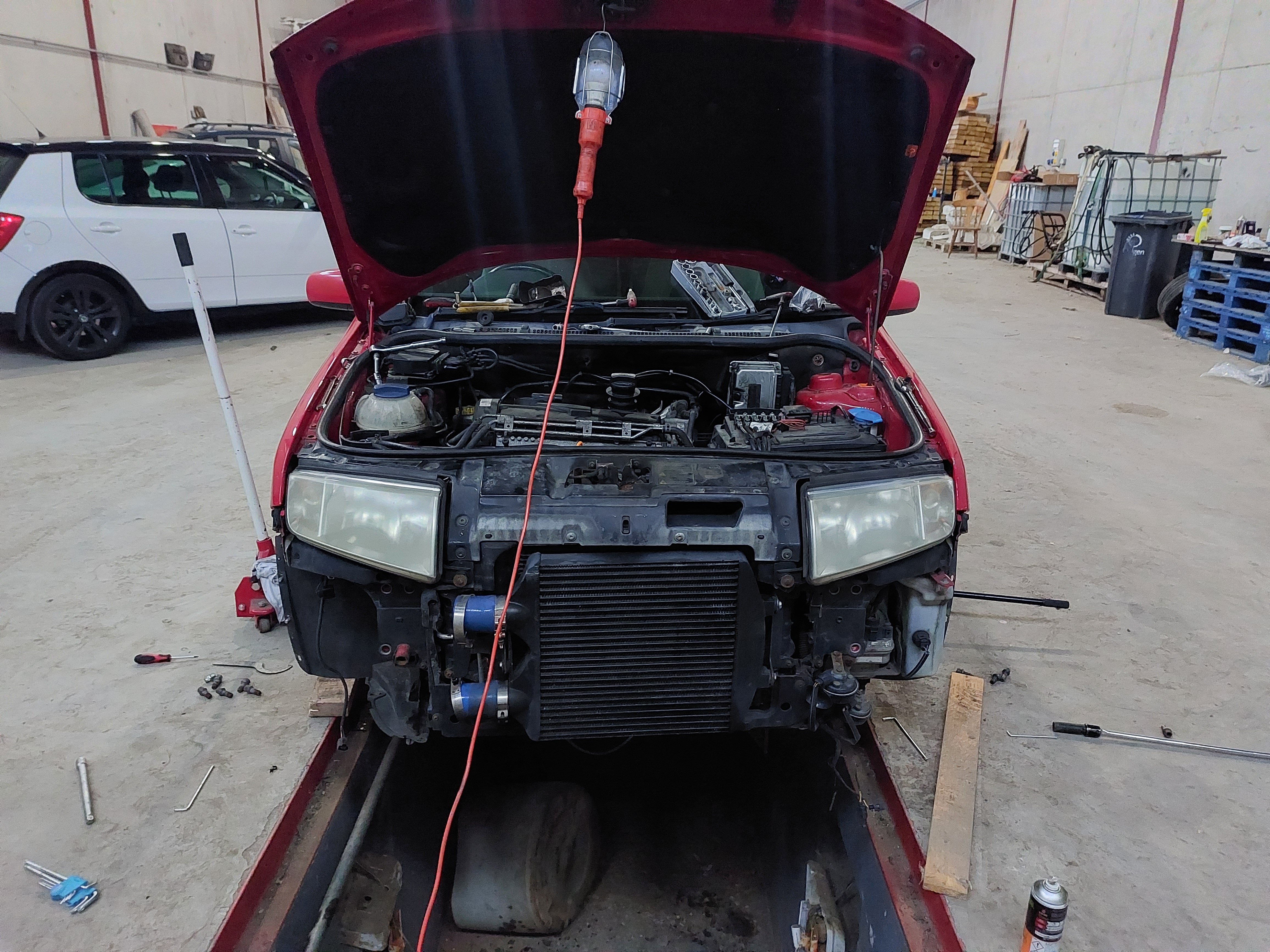

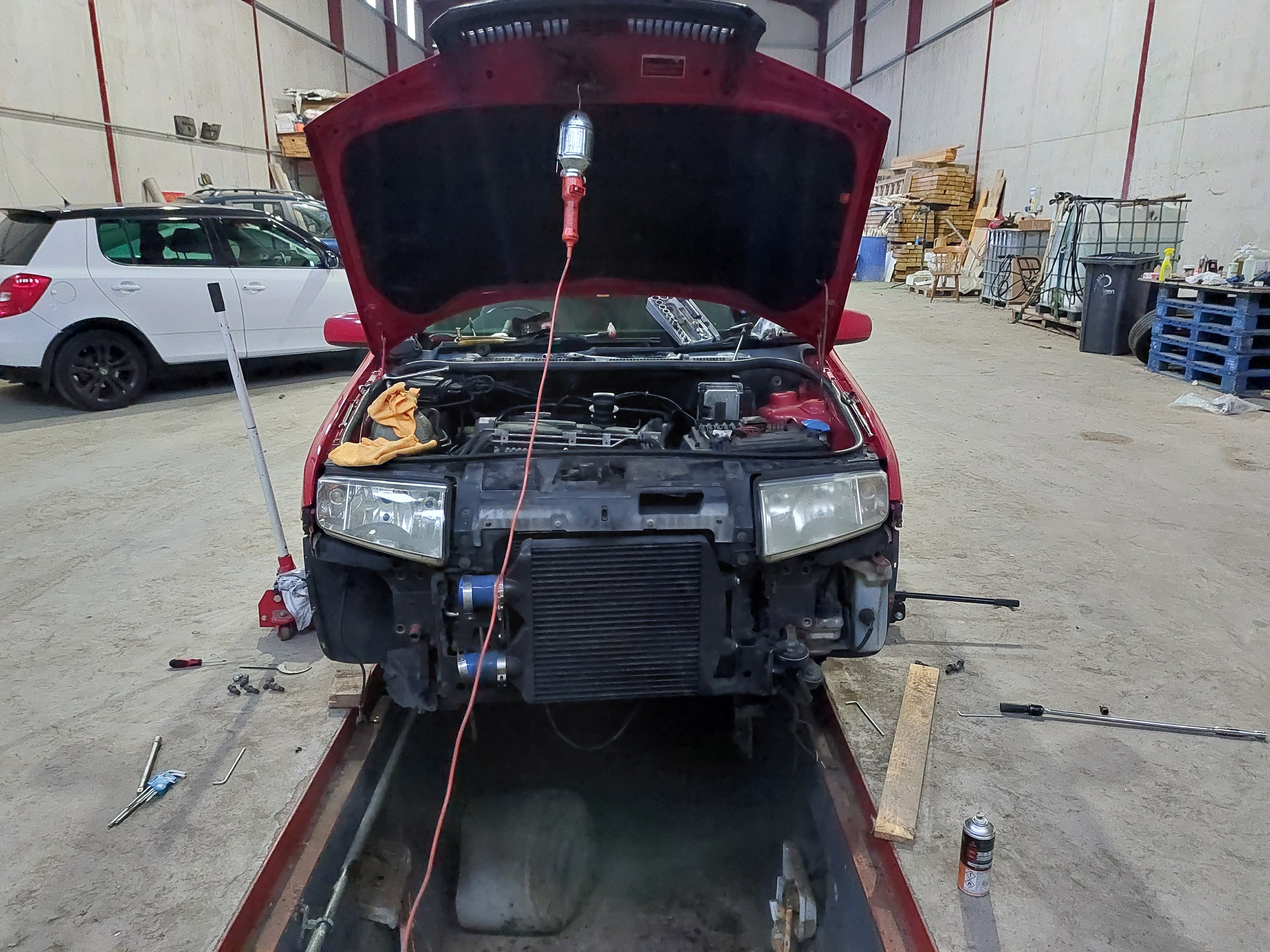

  21. Wheels up to check out the coilovers, hoped they would be free enough to adjust up, no luck. They're the same coilovers as what's on the mk1 already, FK ones. But these are quite a bit rougher and set far too low for me. Exhaust has slipped out can see the pool of oil out the exhaust. It's a bit rough underneath, the plastic cladding is broken in a few spots from the car being too low. Put penetrative oil on the collars just to spin them up a bit. I probably won't use these. The droplinks on this are fubar. Took the bumper off to have a look see. There is no crashbar thanks to the front mount, think an ibiza crash bar is the one to get for these (?) Took all the intercooler piping off and it is flooded with oil, so the turbo is absolutely ****ed. Saying that, it's not grenaded and sent shrapnel into the engine, I think it might be able to be reconditioned because it just seems like seals are gone in it. Looking up around the turbo shows a lot of oil. Sort of aside from this but I'll include it on the same post, some photos of the slam panel I painted compared to the one on this car I'm torn between doing this up and reshelling it into the mk1. This shell is quite rusty. Sills, rear quarters, A pillars and the roof are showing rust through. The A pillar is the one that worries me the most as I know that is quite a structural part of the car especially in a smash. I'll get photos of it next day. I think it can be fixed, but it would be an awful lot of work to do it right and you'd probably be spraying the whole car at that point. The sdi has the hit at the front but it is rust free. I'd have to have it sent off to get the chassis pulled proper though. Then there's the issue of tax, I'd be easily over 5000 euro importing that vrs, I payed 500 for it. Could just not import it but I do not want the hassle of worrying about customs, they're always around my area. I plan on either refurbing this turbo or getting another hybrid, and putting it in this car to make sure it all works properly. If it all works well then I might just plop that drive train into the sdi. Would be cool to have a cayenne metallic "vrs".

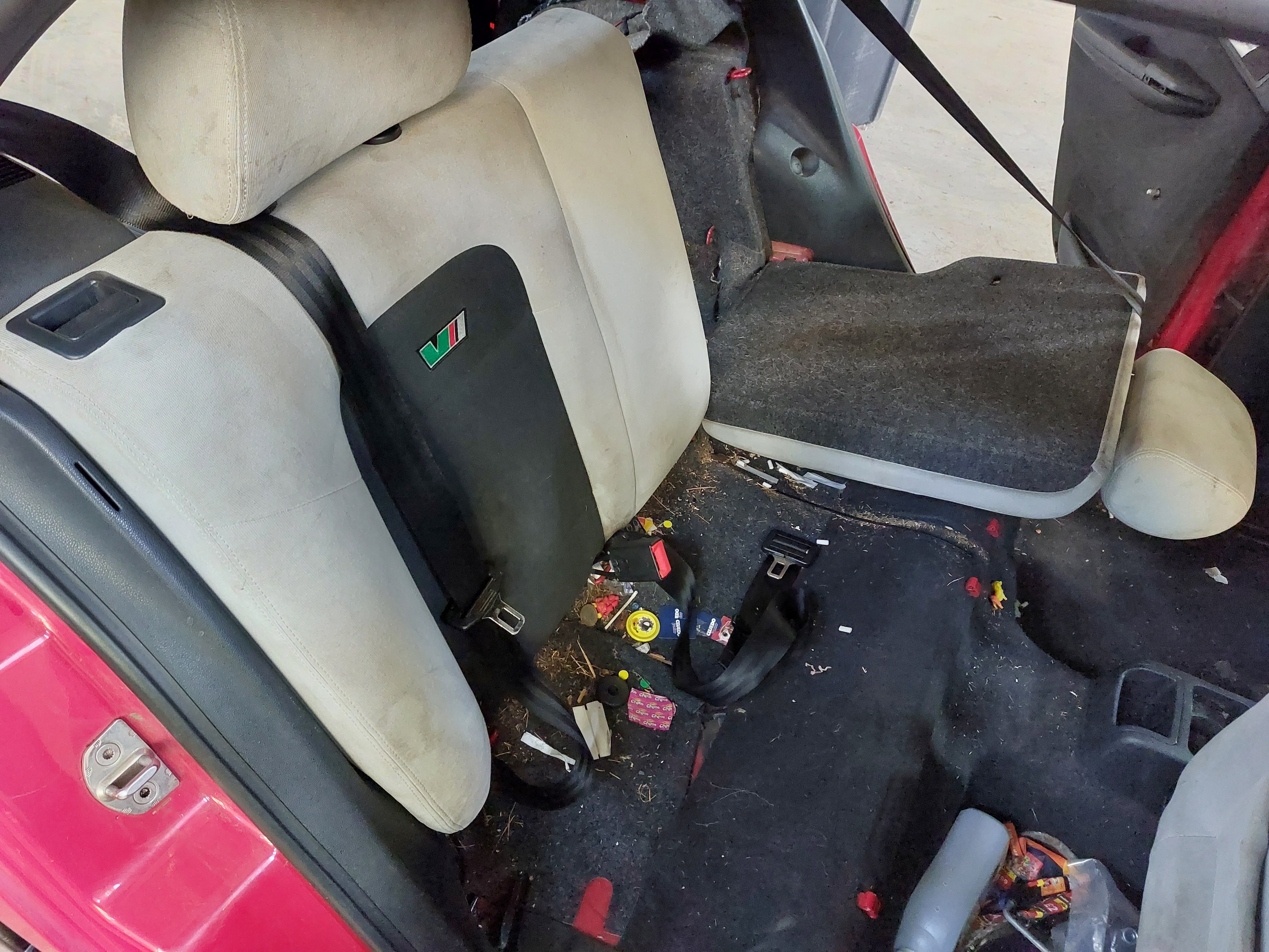

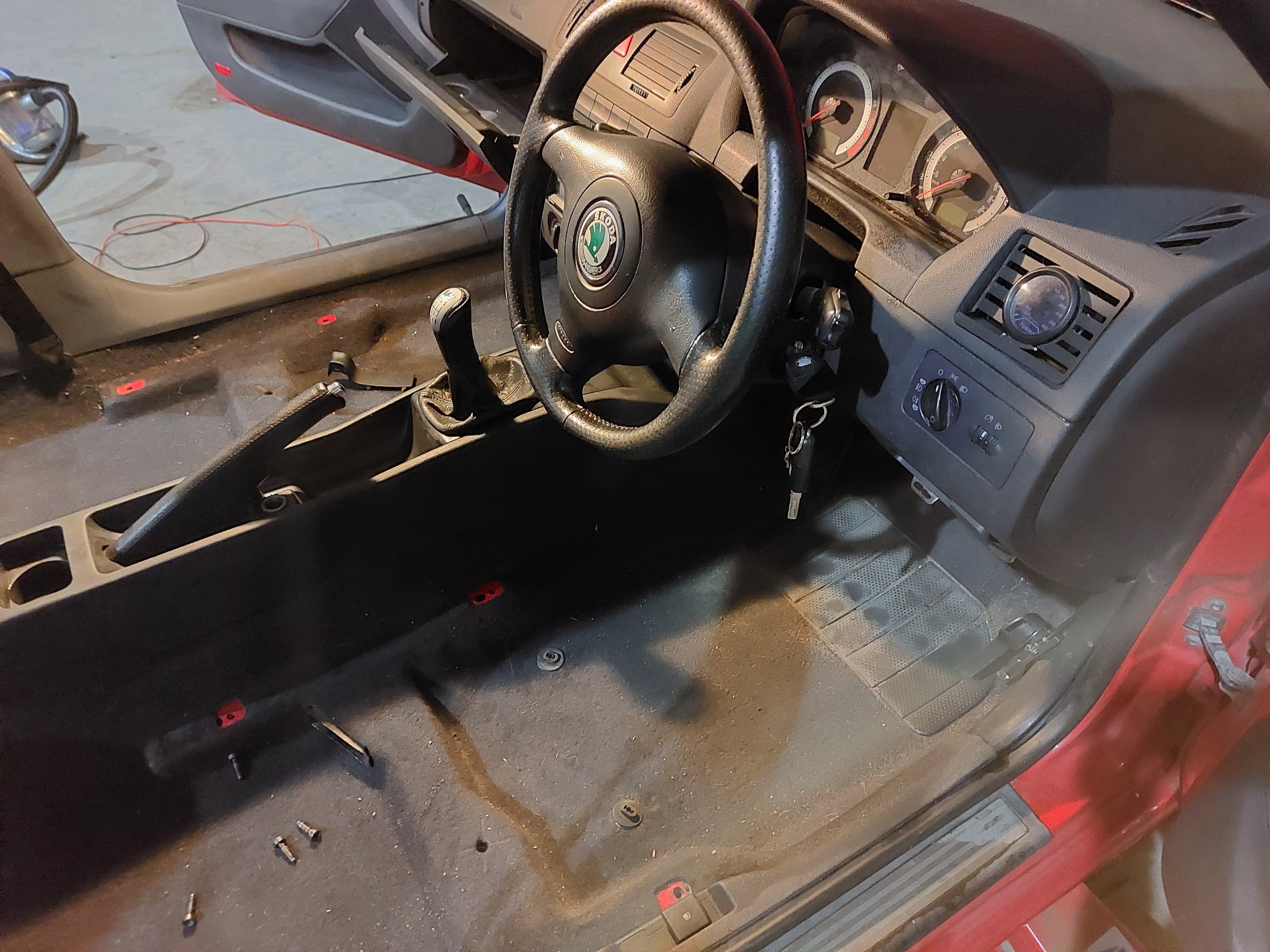

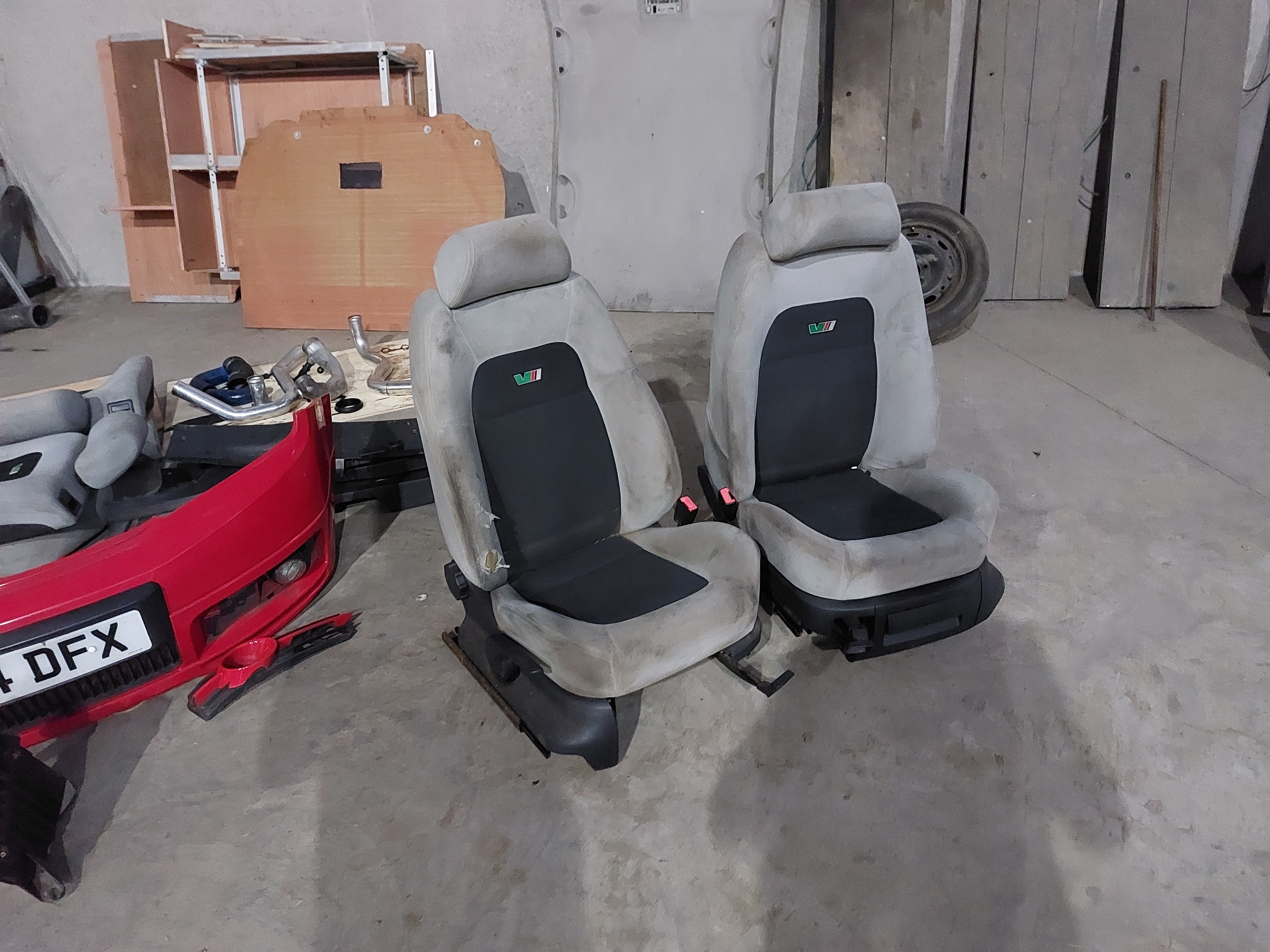

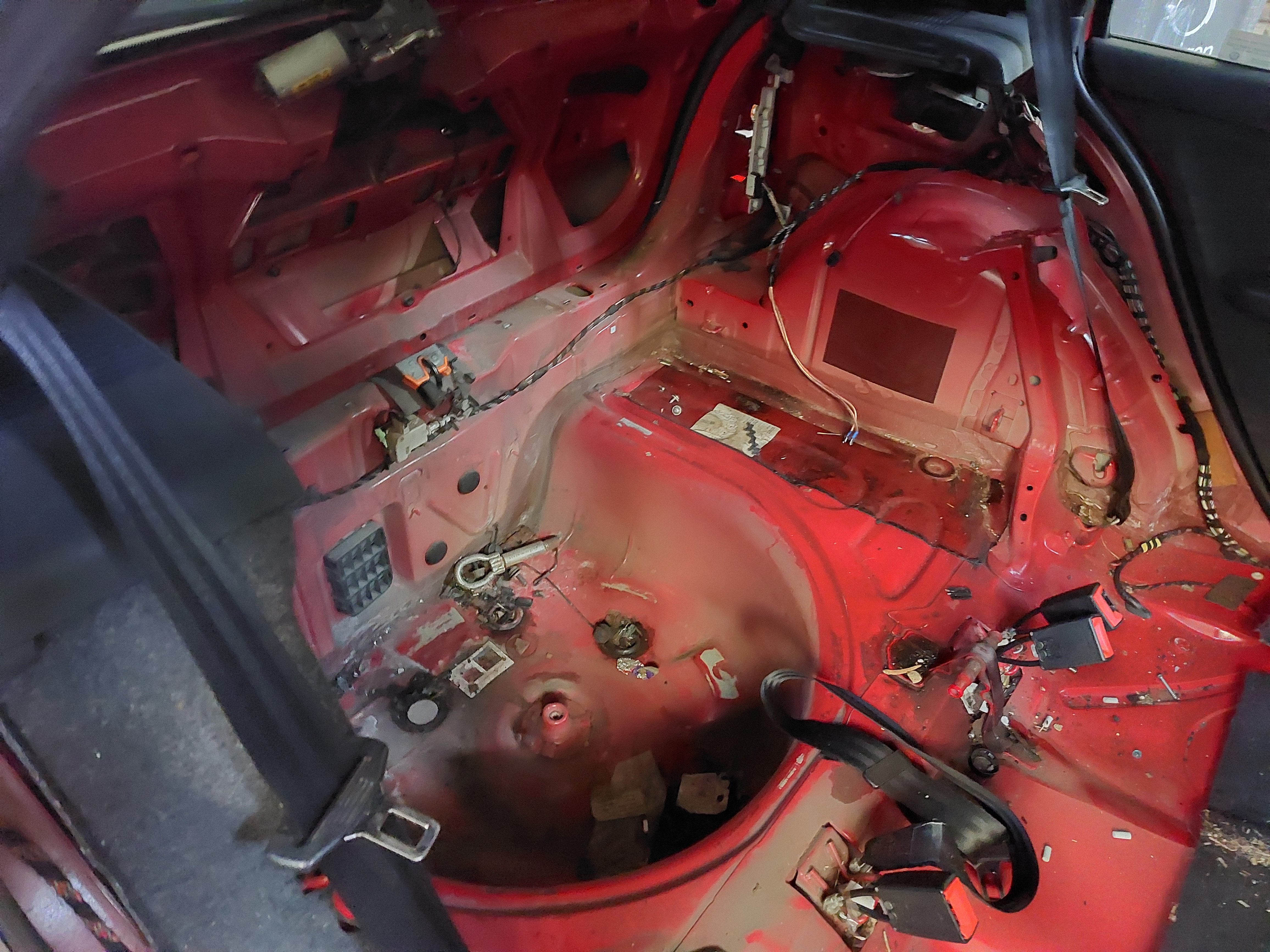

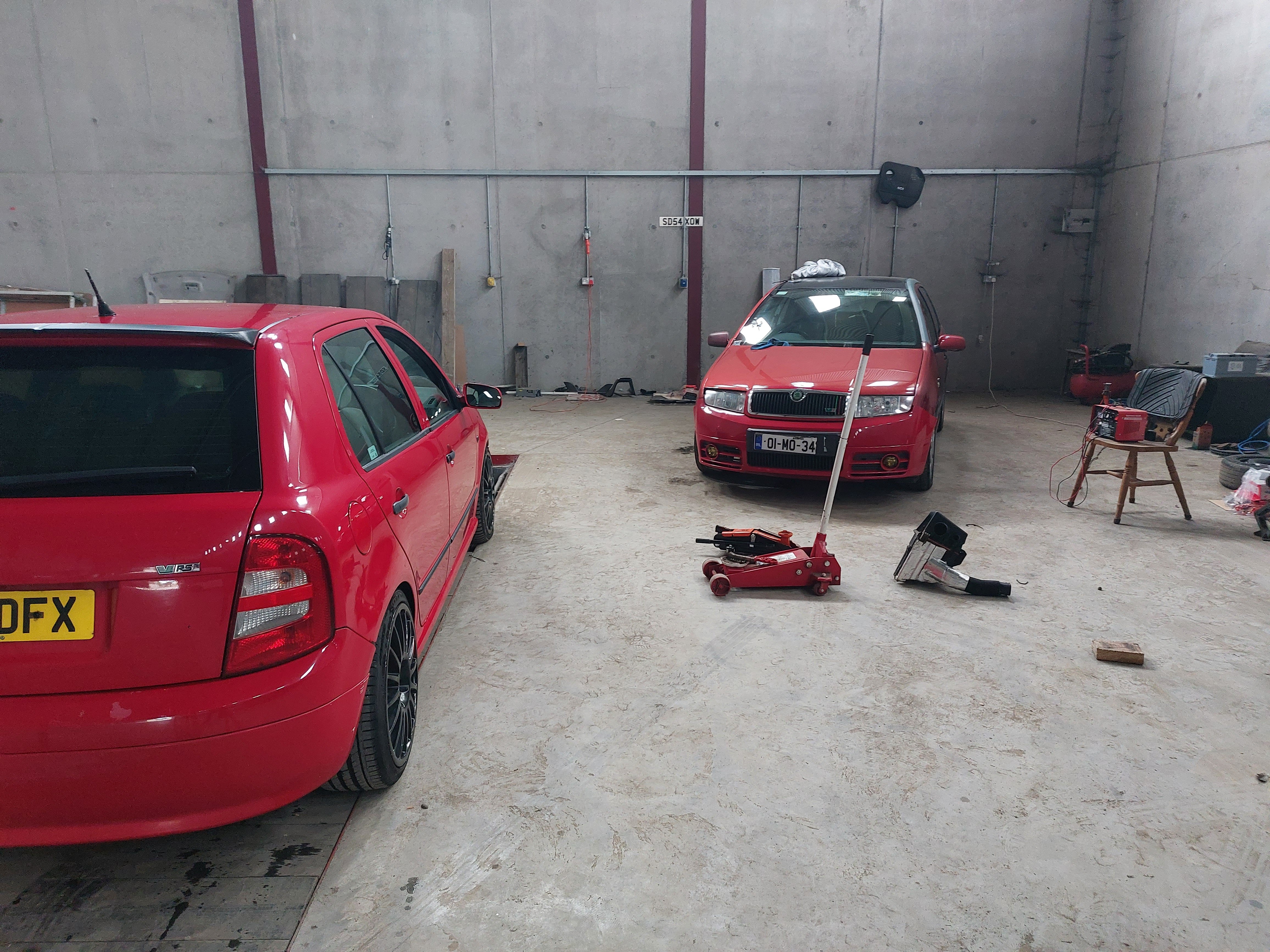

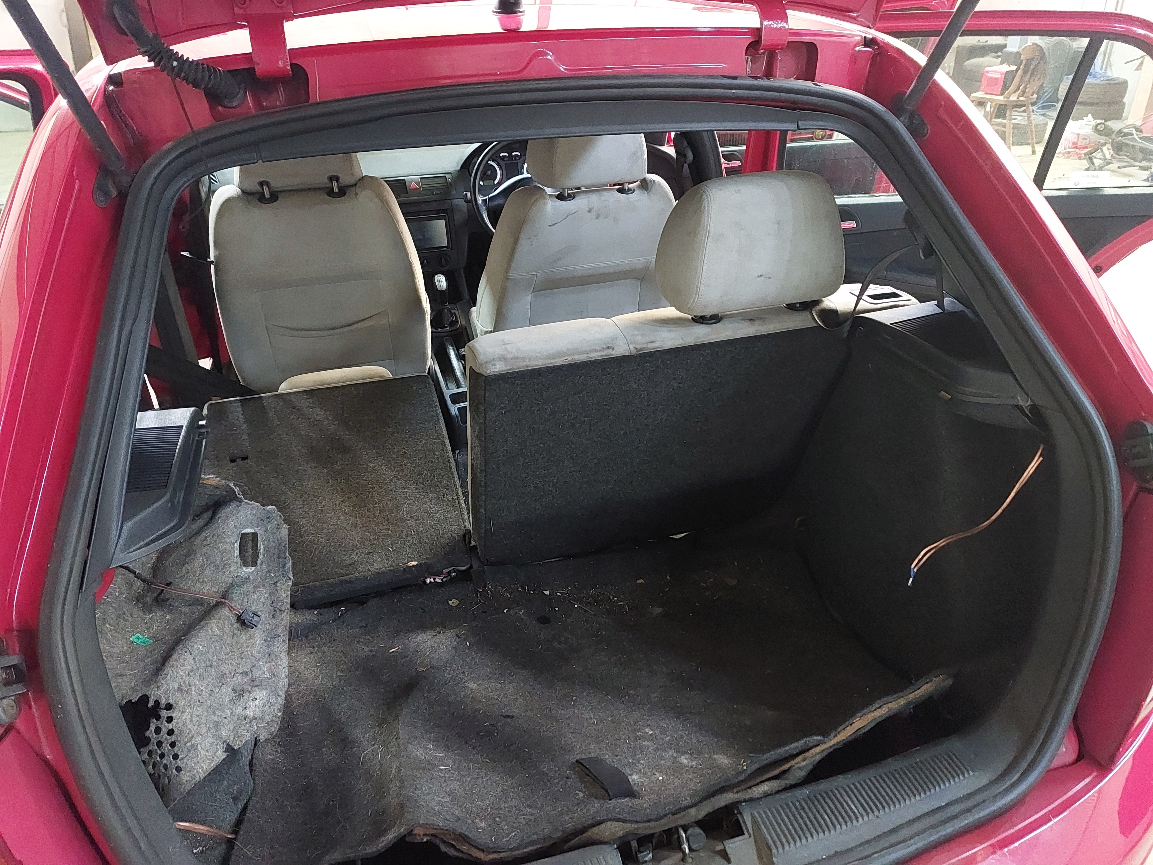

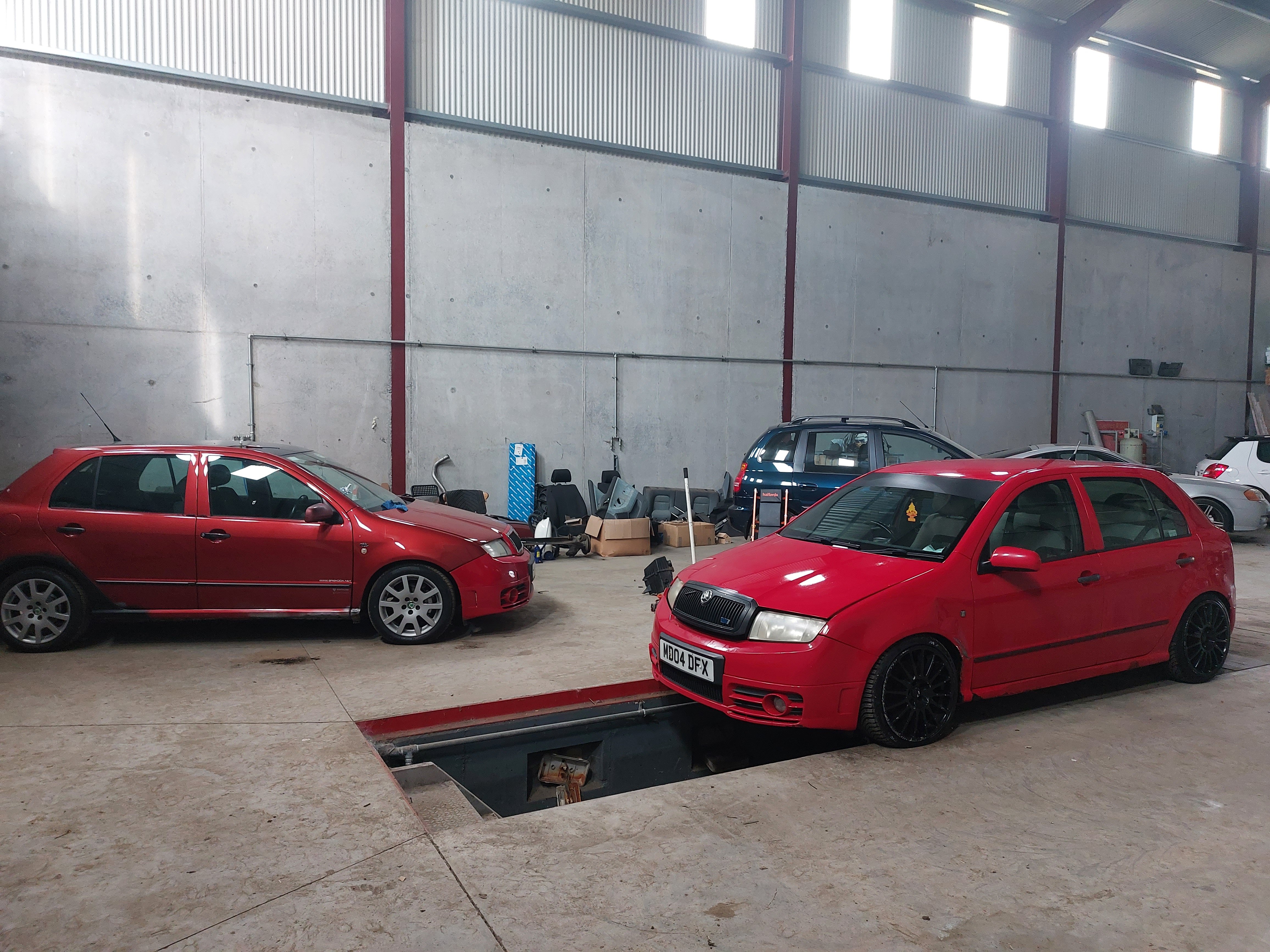

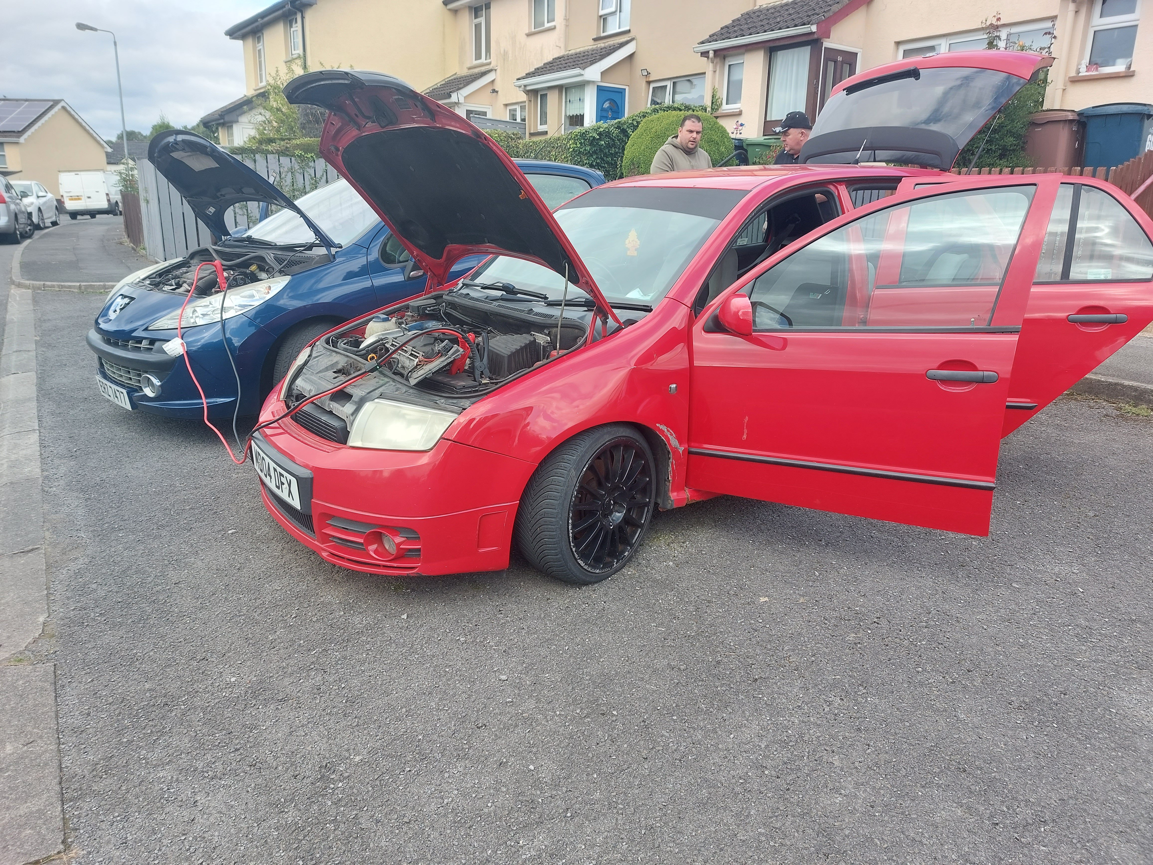

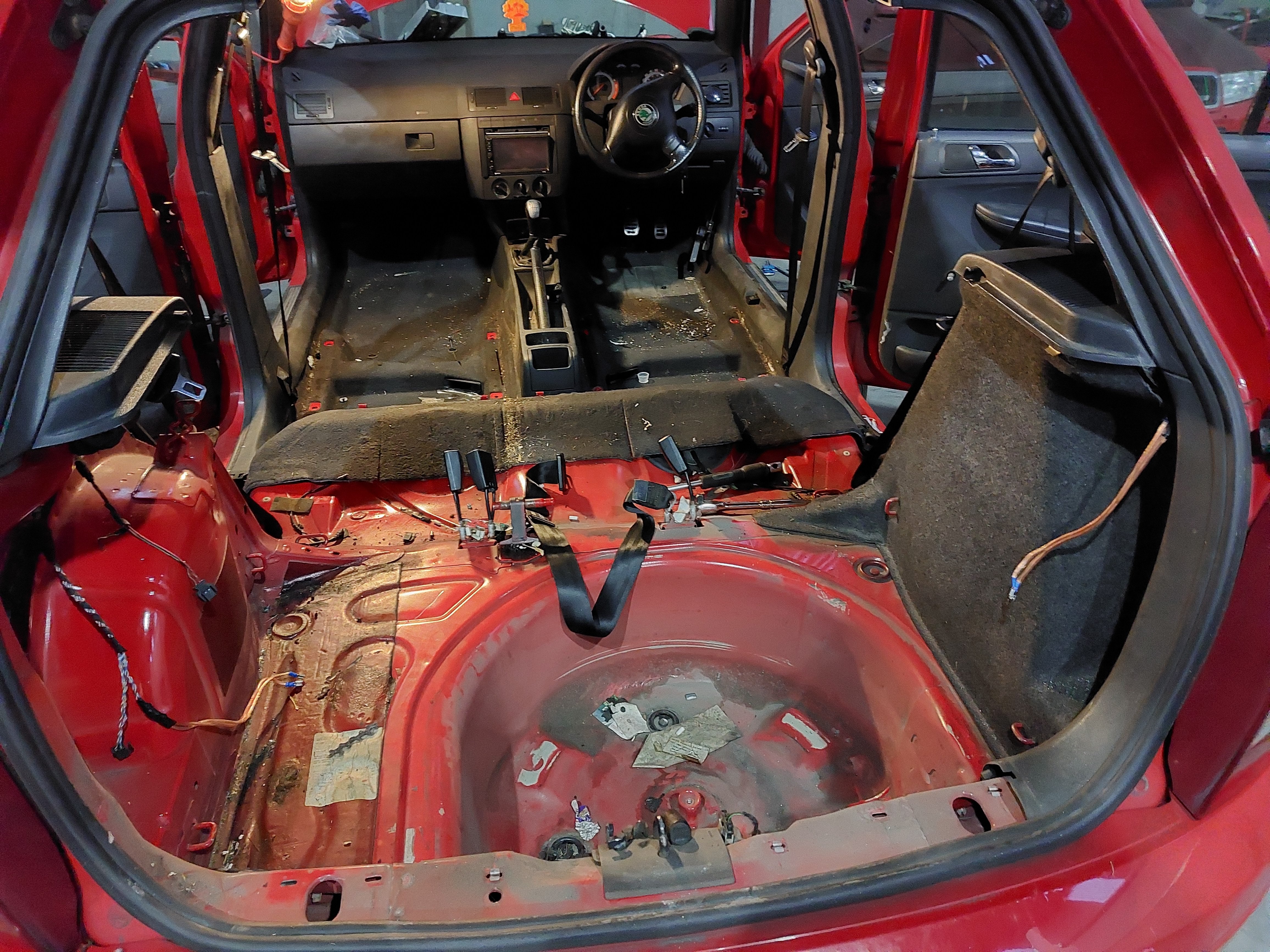

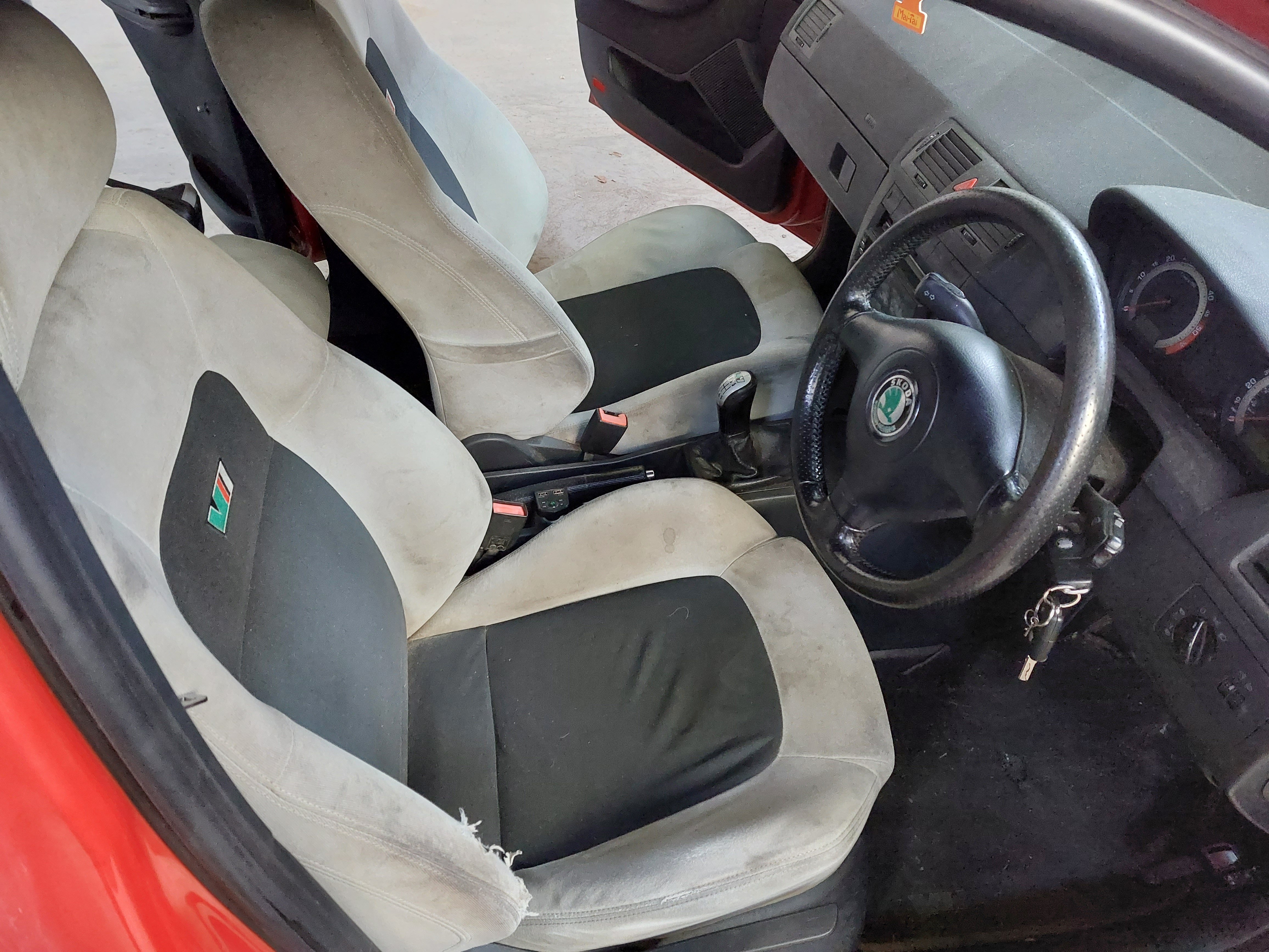

  22. First off, Holy ****. Now that's out of the way, I've bought this lovely vRS today. Still even has MOT for a few days. Bullet points: -216k miles -A hybrid turbo that's blown -Egr delete -Decat -Pop and bang limiter (wonder why it blew) -2 ecus, a standard pd130 ecu and the 230hp one in it now -Coilovers -Decent Service history and a wad of reciepts -2 keys etc etc. Went up not expecting much, battery was stone dead but started from a jump start. Engine fired over very easy, engine itself sounds fine. Drove it onto the trailer even. Got it home and washed it, wasn't bad even though it sat outside for 3 months after the turbo went. Can't drive it for long but it does drive perfect all things considered. Whatever wheels are on it, they sit very wide on the car, no spacers here. They have vw caps on them and the guy I got it off reckons they are vw wheels but I don't think they are. If anyone knows what they are I'd love to know. Ream of paperwork with it. Set to work removing the seats and such, its pretty dirty inside and the front seats are quite worn. The doorcards are quite rough too. Happily I have sport seats and matching doorcards already. Came with a full-size spare too, took it out. More coming
