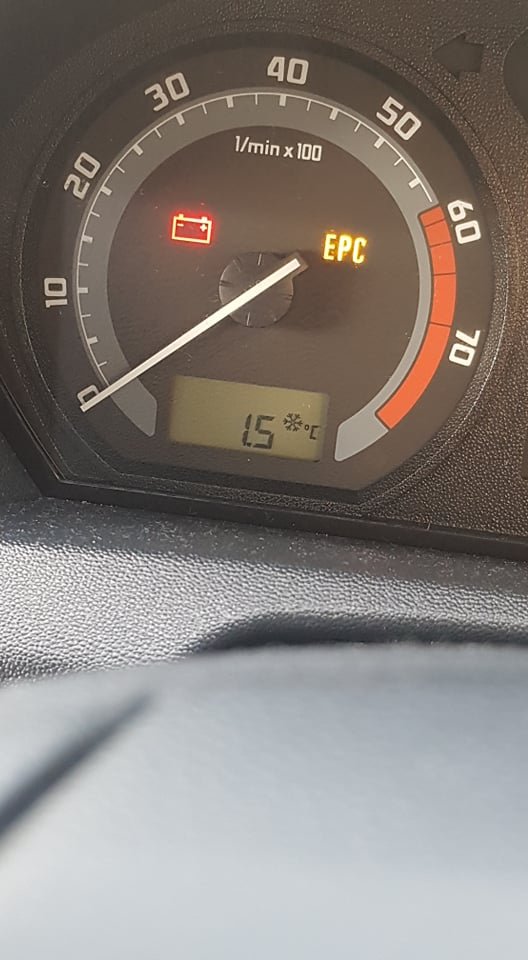

Problematic Throttle - 1.2 12v BME
Oops, I did indeed. It's been a long day.
Just an update to this since I don't want to leave it on a cliff-hanger for those perhaps suffering the same issue. The issue lies with the accelerator pedal position sensor as when the pedal is pulled backwards the revs drop as they're meant to. Issue will be fixed through the week.

So as I have mentioned, my throttle was being an absolute pain (holding revs) which suggested it needed cleaned. After my Grampa and I performed emergency "throttlectomy" in the pouring rain and gave it a clean. No difference sadly. So now, I have diagnosed the issue as the accelerator pedal sensor being dicky. It will be repaired soon, but the car is functional and safe enough so I can't complain all too much. The headlight bulbs have also been replaced and I can see now - plus, I've got a slow puncture so on the spare, but future me will sort that one out!
