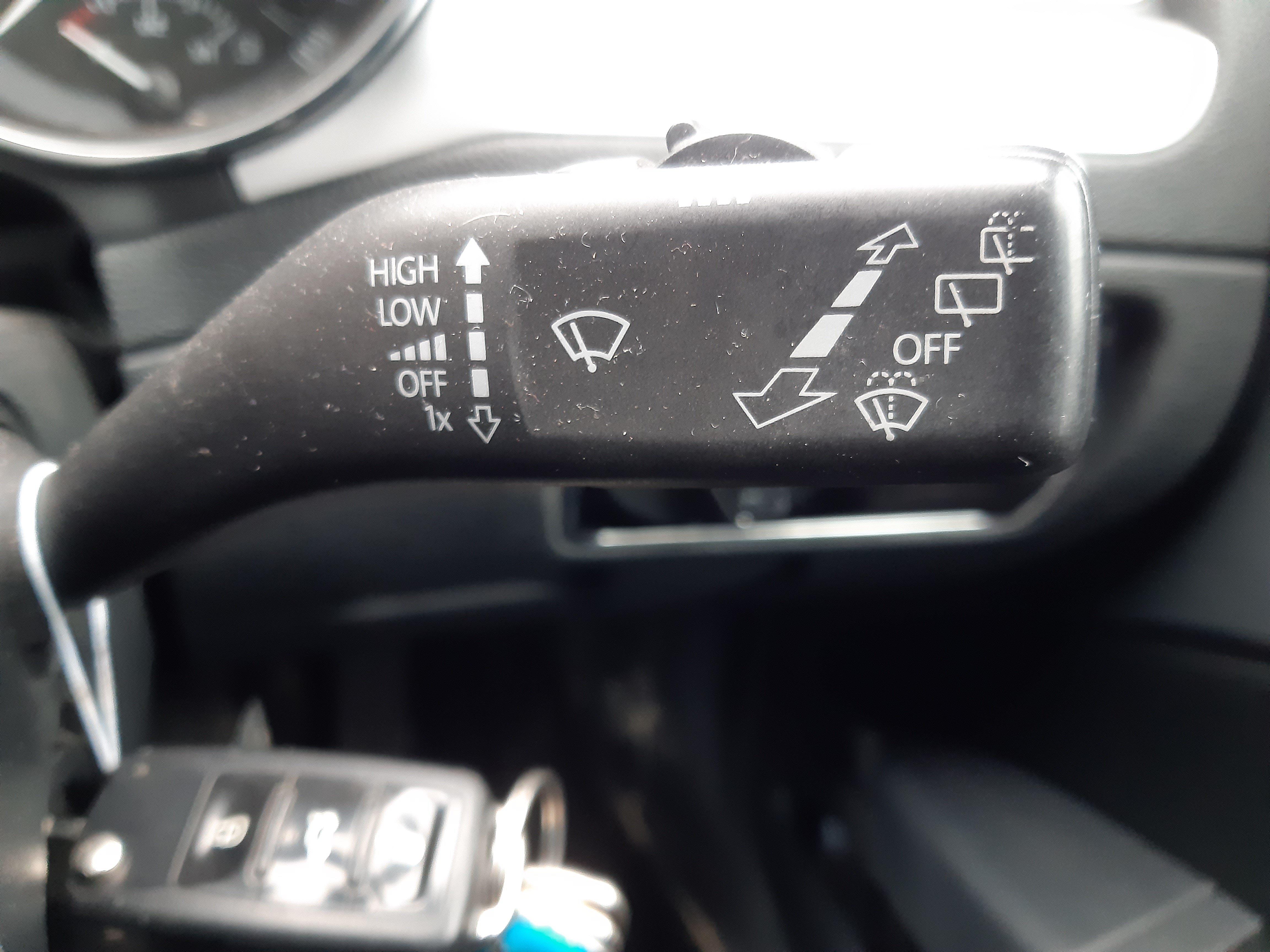

  1. Yes I do have an air freshener hanging form the switch though I wouldn't have said it's heavy enough to impair the spring action? I've counted the switch positions in both directions in both axis. As you say visibly it's difficult to determine if the switches are in the off position! I have another issue in that neither of the near side passenger windows or mirror work anymore! So I've used VCDS this afternoon but there didn't appear to be any error codes for wipers or windows ? Though I'm wondering if I've disturbed the common earth when I fitted a tow bar a few weeks ago?

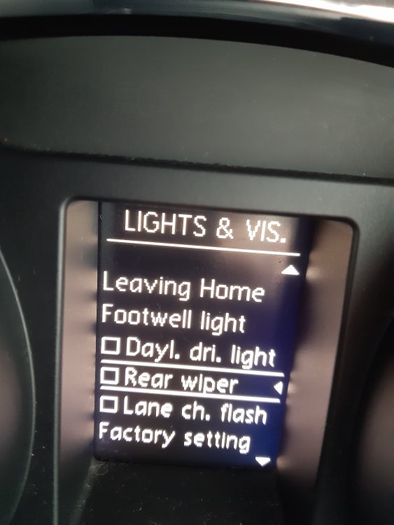

  3. I must have spent over an hour outside freezing my nuts off! Messing about with the rear wiper switch and maxidot settings. A couple of times I managed to stop the rear wiper from a single wipe on turning the ignition on. Neither I'm sure how I got it to start again! But I'm not sure how I did it??? As you suggested DrCorbyLee the Maxidot setting doesn't seem to turn the single wipe on or off at ignition on. I'm either extremely stupid or there is a fault with the wiper switch? Making sure the wiper switch is in both the off positions doesn't seem to stop the single wipe at ignition on.

  6. No matter if I tick the box or don't on the dashboard screen menu the rear wiper always wipes once when I turn the ignition on. I have a vision when there is a heavy frost the wiper will get damaged when it gets stuck to the rear screen and the wiper activates. Is there another way to stop the rear wiper from automatically activating ? 🤔
