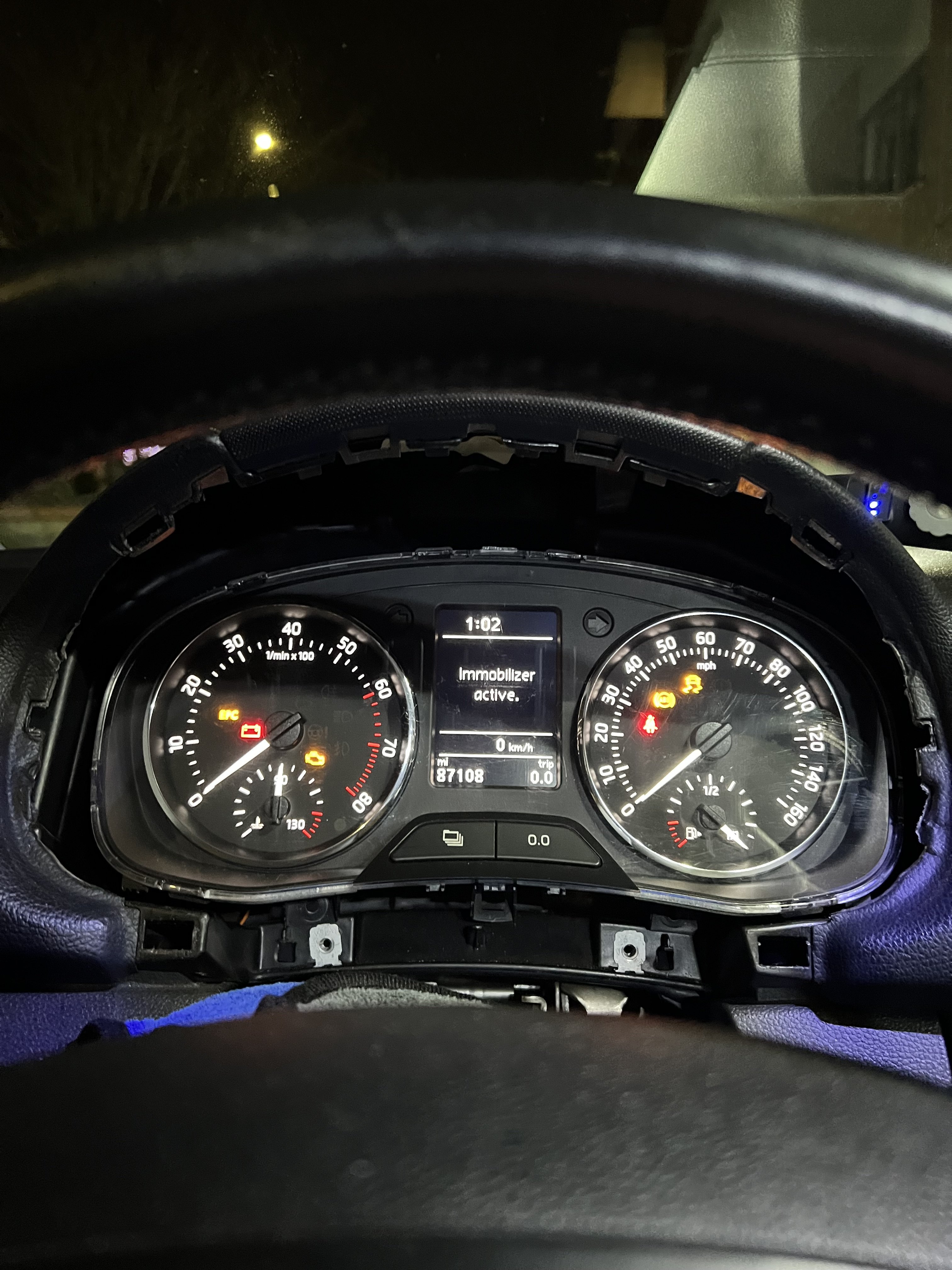

  15. Thank you, I already have vcds, and the cluster is from a 1.2 tsi cbzb rapid, I was looking for Vag Tacho K+Can and Vag Dash Can. The complete immo delete scares me a little bit, just because i would like the car to be original from a theft safety side, I fear a bit that it could be hot-wired easily.

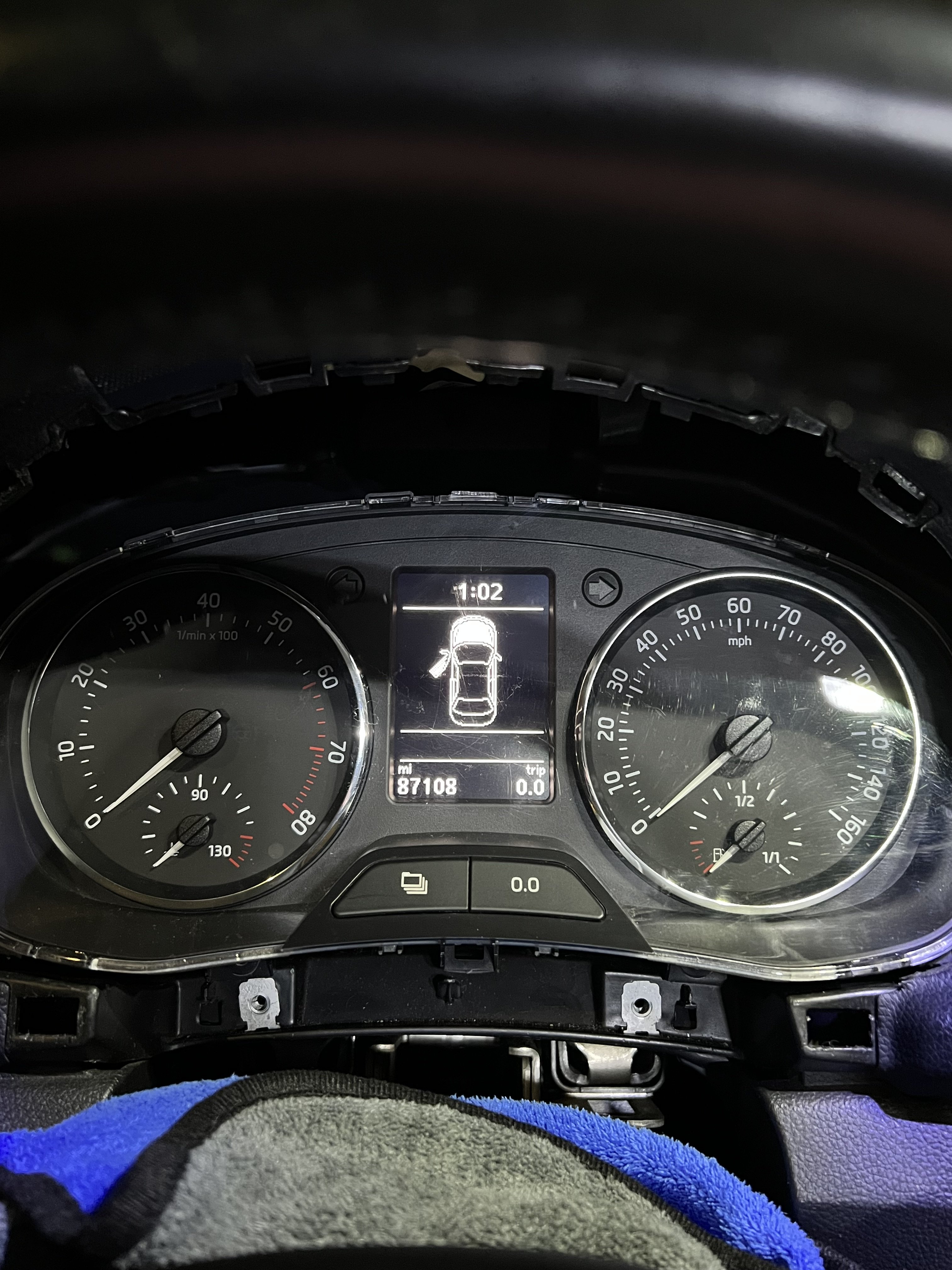

  17. Hi everyone, like in the title I would like to try to swap the green dot in my 2013 Fabia combi 1.2 tsi cbza LHD, I’ve done a lot of retrofit but I’m missing a proper cluster, I’ve found one from the rapid that does have some extra function and that it doesn’t need Steereng wheel button to be used, just the switch on the stalk (like the green dot). The rapid cluster is 5JA920840D, i have vcds but looking around i need also Vag Dash Editor in order to read the green dot immo pin and to transfer it to the rapid cluster and same with the eeprom (yesterday I’ve tried to plug in the cluster that I got from a RHD rapid it wash dirt cheap, and beside the immobiliser message some function were working like: coolant temp fuel gauge and which door was open even the hood). My question is: someone have done a swap like this? I’ve seen swap to mfd adding steering wheel control but I just want something a bit easier. (I’ve bought this cluster just to mess around, if the retrofit is possible I will buy a kph one. Also, I will check in ElsaWin to see if there is any information about reading the EEPROM or the immobilizer pin.). Thanks to everyone
