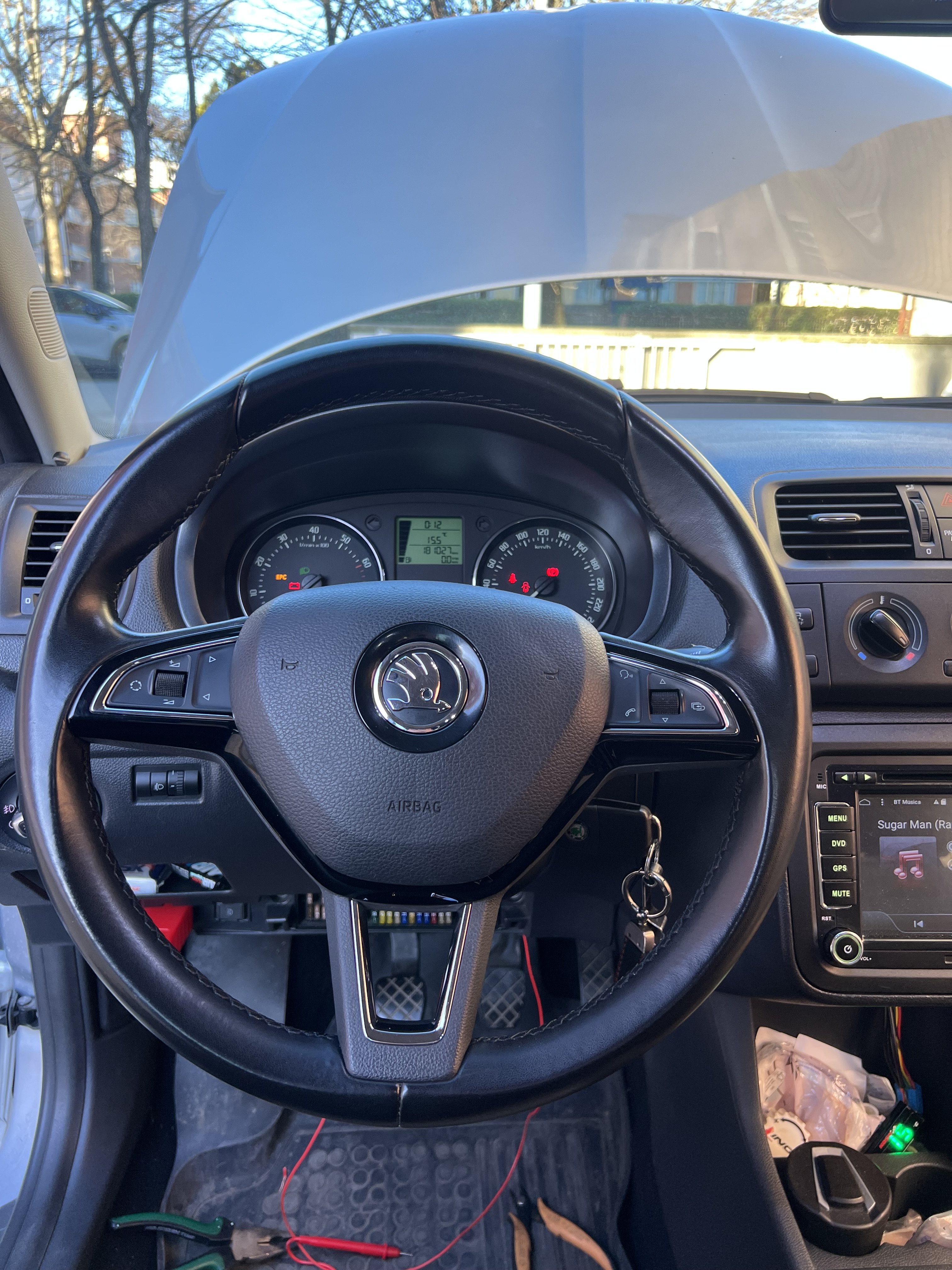

  16. Theoretically, if you replace the ABS module, you need the long coding of the original module in order to know which options the car is equipped with. The module is also linked in part to the VIN. Once you disconnect it and try to connect another one and switch the ignition on, most probably you will lose the original coding. So I hope you did an autoscan with VCDS (it saves the coding on your PC). The same thing happens if you remove the original cluster and plug in a new one without coding it first (ask me how I know, haha). Basically, once you figure out your ABS issue, you will most likely need to code it back.

  19. I've done this a week ago, you will need: airbag loom 5E0971584A in my case i have an elegance model and I've personally retroffitted the cruise control years ago ant i don't remember of a clockspring replacement 2x repair pin this one 00 979 009 E https://www.skoda-parts.com/spare-part/000979009e-cable-line-european-union-43850.html tap the pin in the stalk connector in the connector add pin 9 for 12V pin 10 LINBUS make sure to allign the repair pin correctly in the connector connection, route the LINBUS (this is how i've done it) to the passenger window LINBUS wire, is a gray-white wire if the color is a bit faded don't worry is the only one with that color the other one are completely different, you will find this wire in the passenger footwell btween the end of the dash and the end of the trim that cover the bottom part of the door-closing door area for the 12V I've taken it from the fuse n°22 is the one who power up the clockspring steering wheel you can actually buy every one with the same airbag shape of the one you already have, octavia mk3 normal, scout, vrs, sportline same for the superb mk3 steering wheel switch here the IMPORTANT PART you will need the switch from facelift Yeti around 2011-2014 to have compatibility and green backlight (if you use superb or octavia switch you will have the switch to act crazy like you can only turn the volume up but to lower it you need to press the volume control knob ecc. ?ive tryed this). switch like thise https://ovoko.it/parte/dze13815-5l0419091g-skoda-yeti-5l-volante (the sale here is for the wheel to) since you're doing the retrofit there is no point to get the steering wheel with the switch only on the left side, the only thing that will not work with a full switch steering wheel will be the cluster knob because like me you have the greendot cluster KEEP IN MIND: the retrofit is possible with mid or high bcm version I have the 6R7937087P Also you will need to code the multi function steering wheel in the bcm via vcds (i don't know if obd11 can do it) Also the Yeti switch that you will need are exactly the one in the picture, if you use the one with the adas icon in the right side of the wheel they will not work properly like said before in for the volume control also the rapid wheel is compatible but the switch backlight I belive is all white Off topic, I’ve done a lot of retrofit like electric rear window front headlight washer heated seats heated windshield nozzle jets cornering light via fogliht and currently working on front and rear pdc and esp 9.0i if you need help fell free to ask
