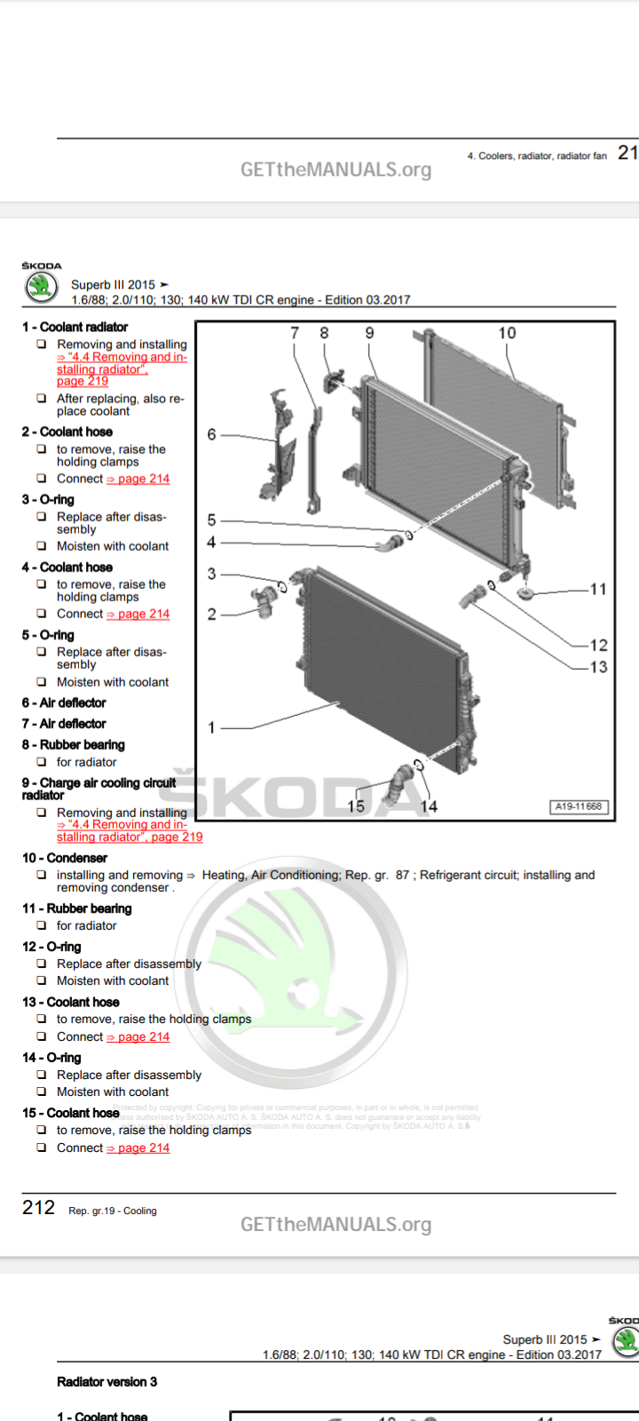

Leaking coolant
There are many areas where the coolant could leak, the charge air electric coolant pump, and heating back up electric pump are candidates for leaks. See p 184 onwards of diesel workshop manual for details. Needs to have the car up on a ramp, remove the undertrays and a detailed inspection in all areas. The main water pump may be leaking, again visual inspection. Not sure but this may involve removing the timing belt cover. Check main radiator for evidence of leaks.
Leaking coolant
Skoda Superb Workshop Manuals are available here Look at the 1.6/2.0 TDI workshop manual pages 212 onward for full details The middle radiator (item 9) is the air charge cooler
Leaking coolant
I believe on the 2 litre diesel, the air charge cooler is water cooled. So if the leak started after it was changed, I think you need to look there.
