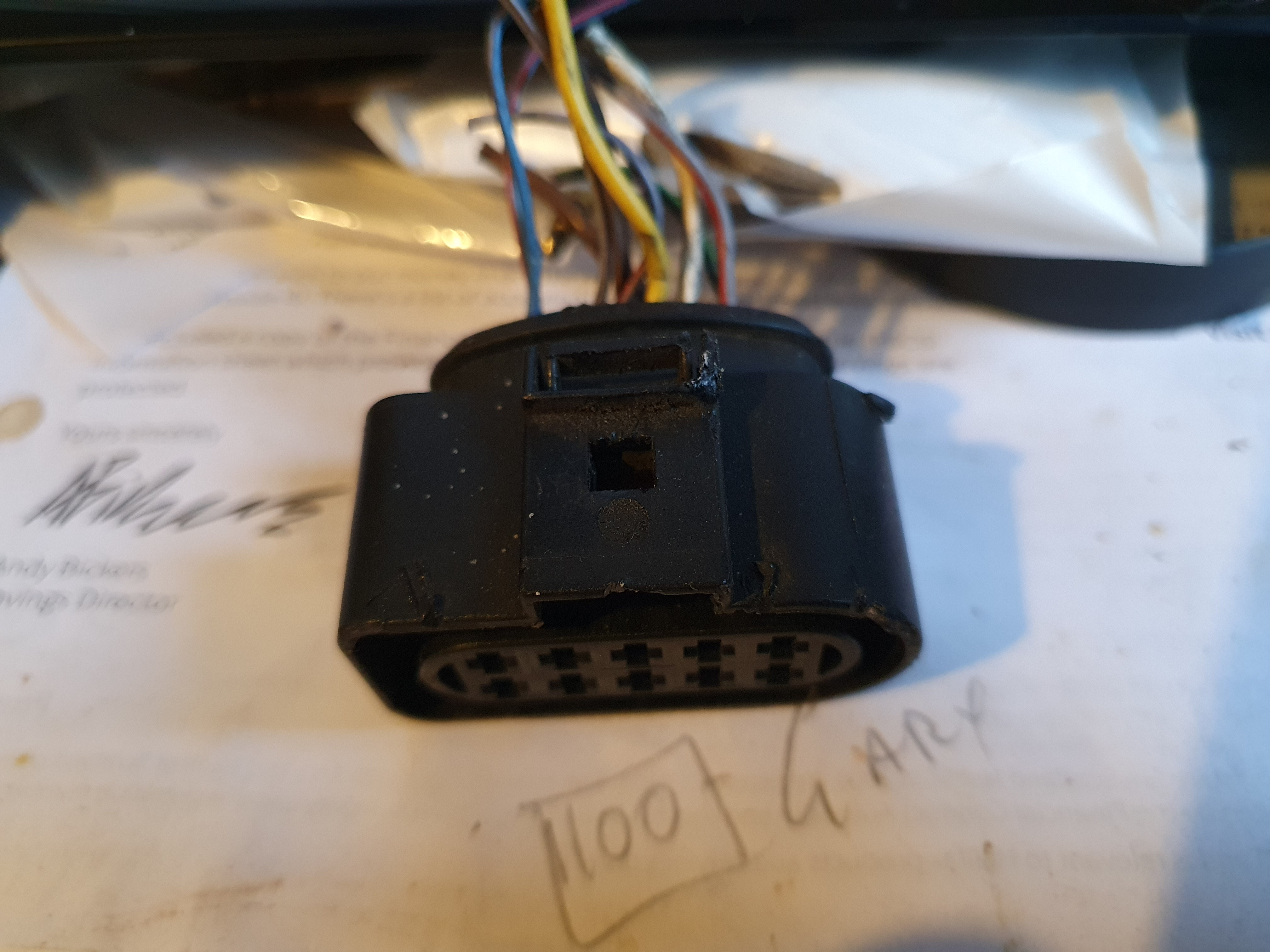

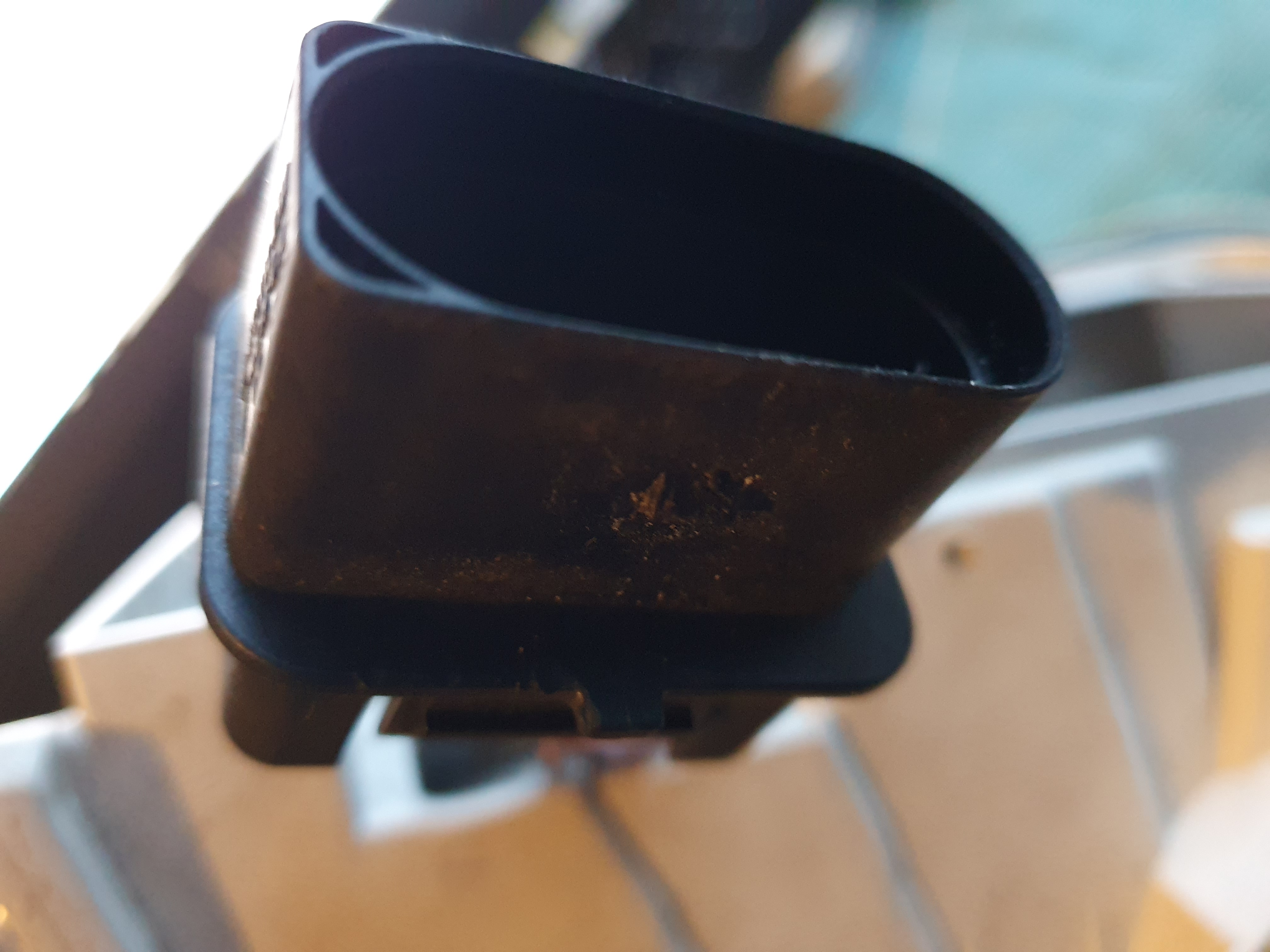

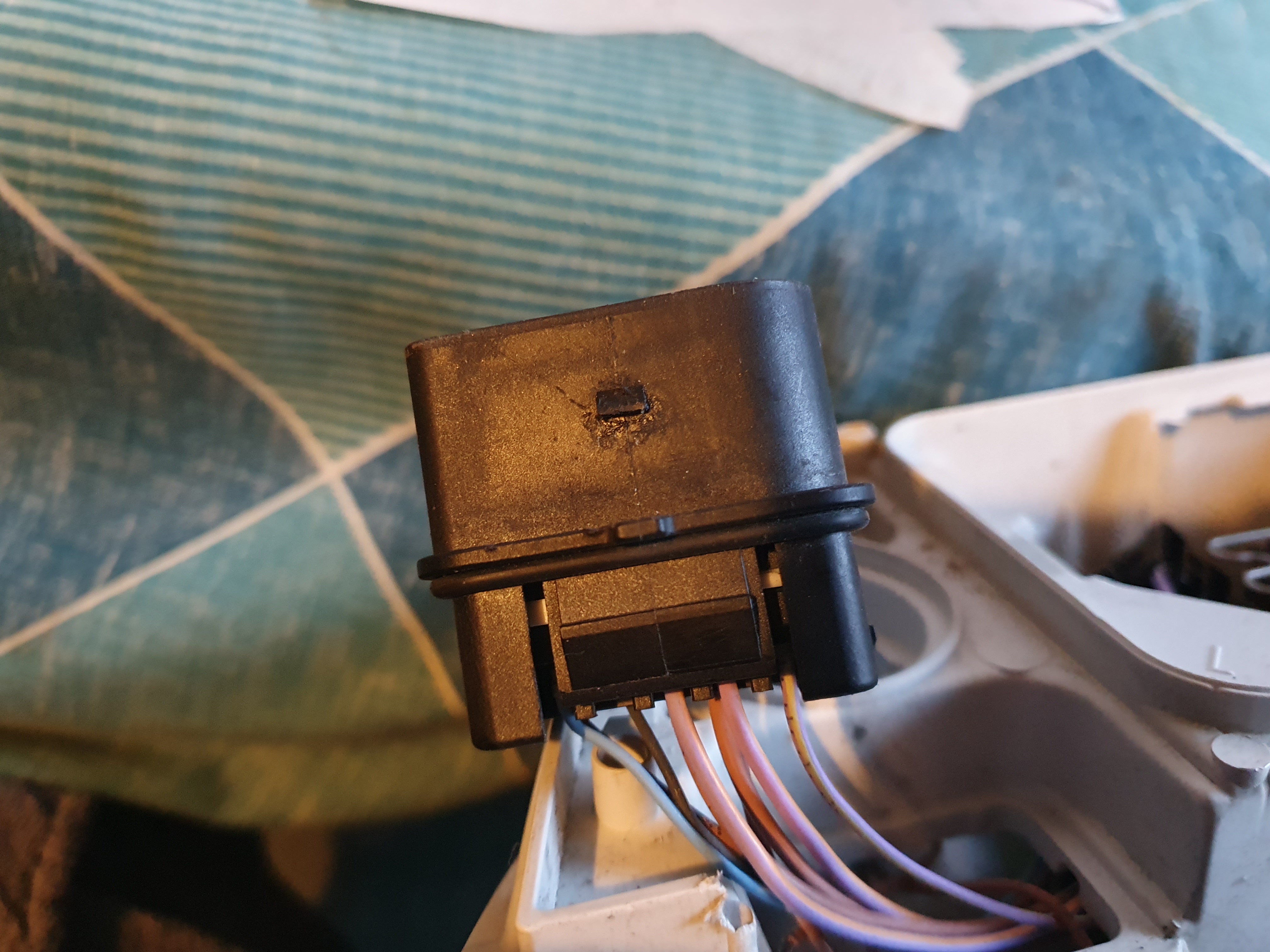

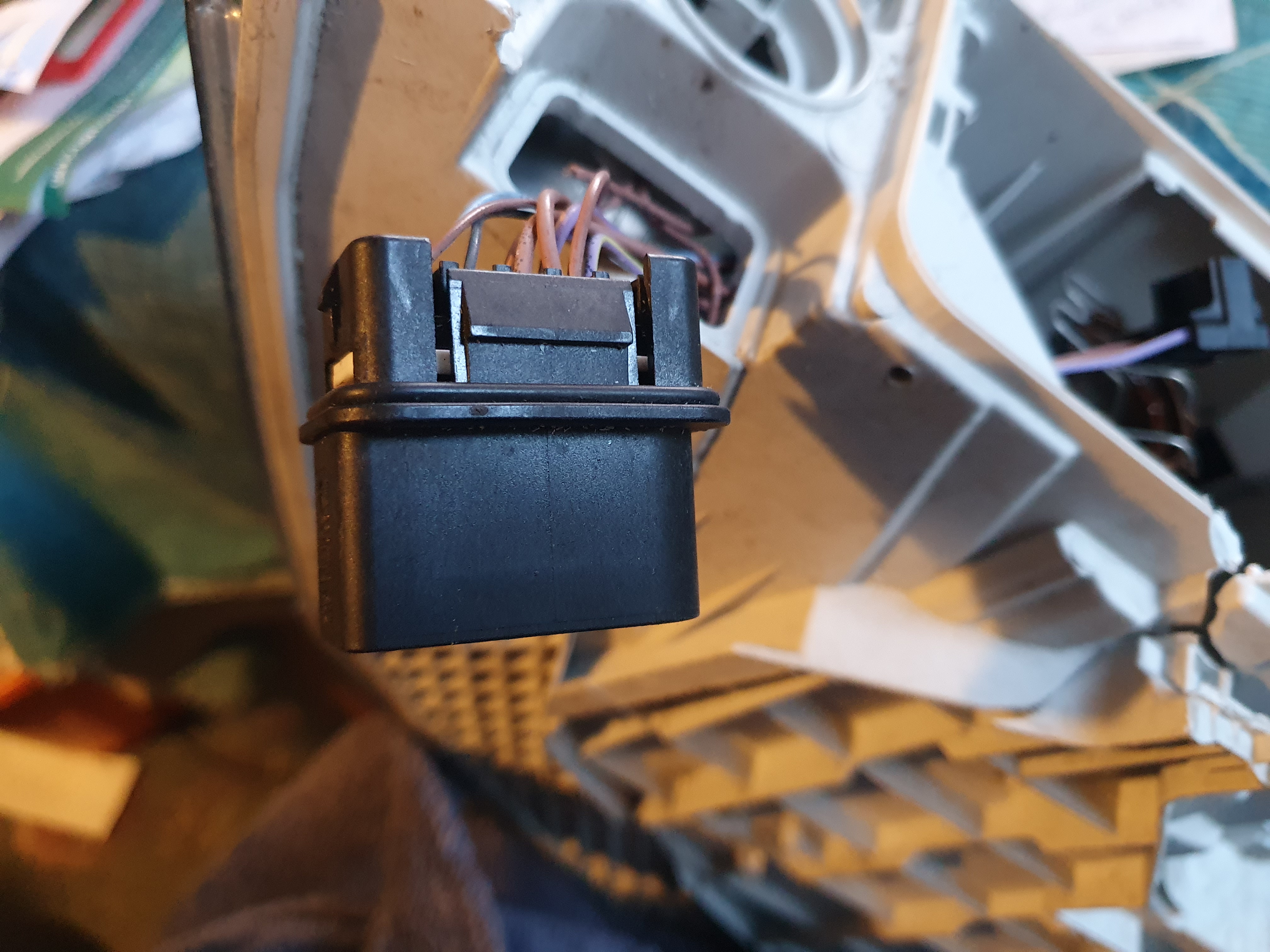

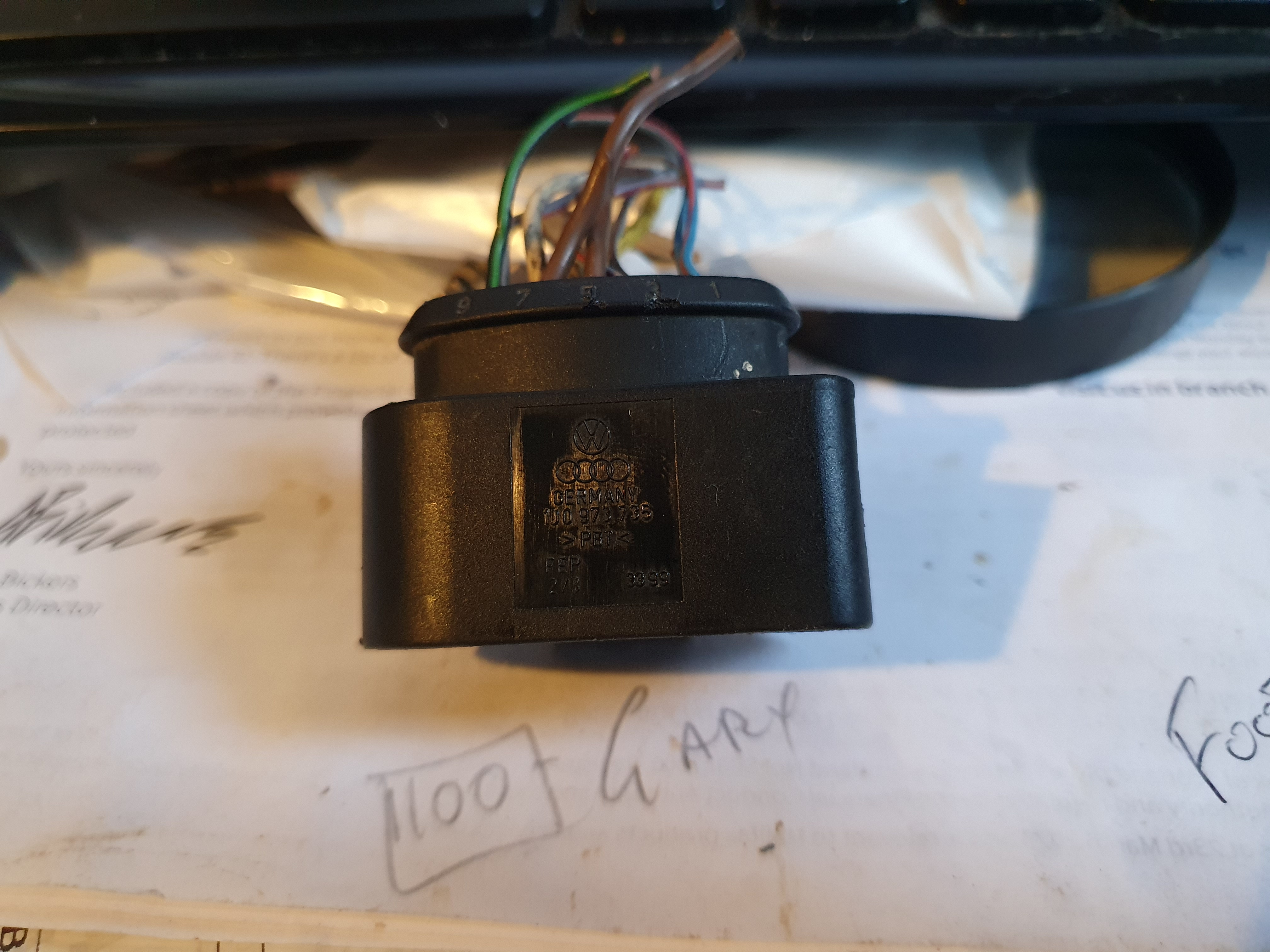

Apologies for the less-than-photo-studio background ... From looking closely at the connector and many previous tried to separate them on the car I don't believe the apparent locking tab is real. It certainly doesn't move. There may be a super-magical Skoda tool that somehow clips into the moulding but nowt I'm aware of. The moulded bump on the socket (on the headlamp) is just a solid bump. When you push the plug down firmly the bump engages with the hole in the side of the plug but I can't see ant moveable tag or clip as part of this. I've learned to insert a right-angled plastic trim tool into the gap at the bottom of the raised 'bar' shape on the plug and gently start to lever the plug off.
