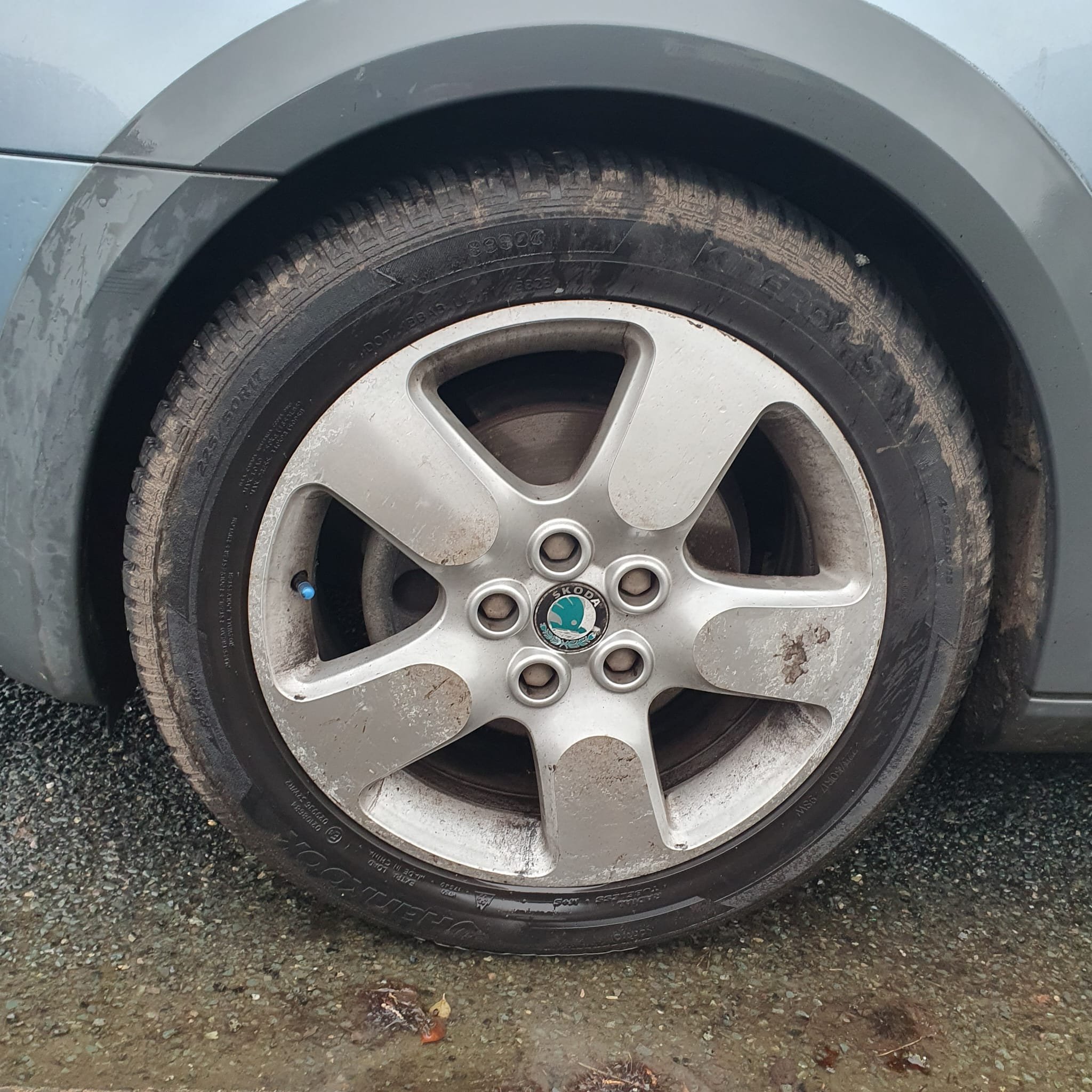

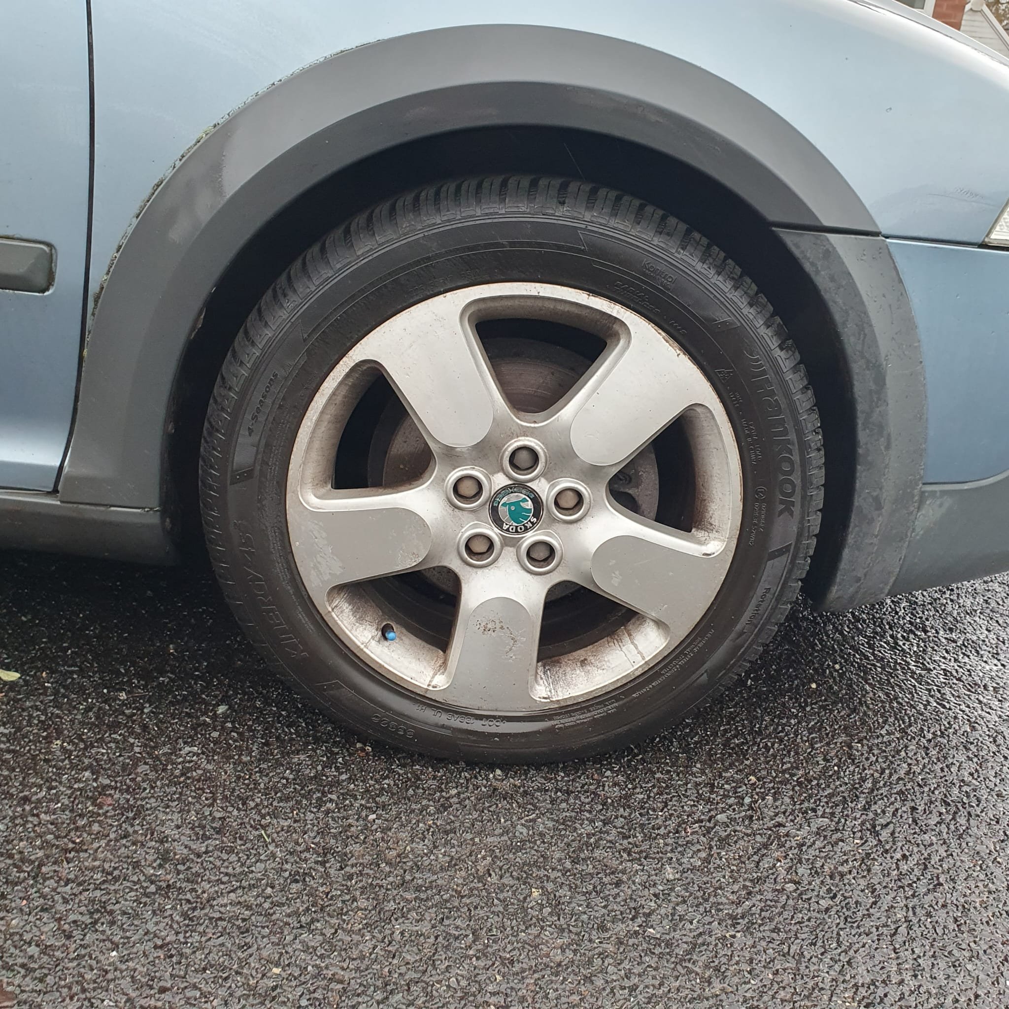

MKII Scout, high speed wobble and a question about suspension. please help me before I do a Basil Fawlty and thrash it with a tree branch.
Driver's side: Pax side: I also note your car is standing a lot higher off the wheel than mine. Both my front shocks were replaced last Summer with the correct part numbers. Edit: just a thought; what size are your wheels? They look to be smaller than my 17s.
Interesting. My PR codes do not include headlamp levelling, although the facility is both present and working. Full list of my PR codes FYI: 1AT = Electronic stabilization program (ESP) 1D0 = Without trailer hitch 1KF = Disc brakes, rear 1N3 = Speed-related variable steering assist (Servotronic) 1NL = Covers for alloy wheels 2UB = Rough-road design 3FA = Without roof insert (standard roof) 3GA = Without cargo area - added later by CH (original owner) 3L3 = Manual height adjustment for front seats 3NW = Rear seat bench/backrest, split folding with center armrest 3QT = 3-point seat belts with tensioner and height adjustment, front 3S2 = Black roof rails 4A0 = Without seat heater 4K3 = Radio remote controlled central locking operated from inside and safe securing 4R4 = Power windows with comfort operation and circuit breaker 4UF = Drivers and front passenger air bag with front passenger air bag deactivation 4X3 = Side air bag front with curtain air bag 5RV = Right exterior mirror: aspherical 5SJ = Left exterior mirror: convex 6FB = Body-colored exterior mirror housings 6Y0 = Without cruise control warning system 7A2 = CD changer 7AH = Electronic vehicle immobilization device with alarm system, passenger compartment control and backup horn 7GG = Emission standard EU4 DPF 7P4 = Manually adjustable lumbar support in front seats 7Q0 = Without navigation device 7X1 = Park distance control 8GU = Alternator 140 A 8L3 = Roof antenna 8QL = Key for locking system with remote control 8RM = 8 speakers (passive) 8WR = Front fog lights 8X1 = Headlight washer system 8YH = Radio, version 1 9AK = Climatronic with impact pressure control free of cfc 9P1 = Seat belt reminder, electric contact in buckle 9W0 = W/o car phone preparation/installation B09 = Type approval Great Britain and Northern Ireland E0A = No special edition F0A = No special purpose vehicle, standard equipment G07 = Front shock absorption HW6 = Tires 225/50 R17 94W J0L = Battery 340 A (70 Ah) L66 = Suspension range 66 installation control only, no requirement forecast QG1 = Service interval prolongation QN1 = Drawer under left front seat
Yes to your supposition about valid dates. Scouts were all (I believe) fitted with HID headlamps along with headlamp washers and levellers.
I'll take a piccy of my '07 Scout front wheel arch tomorrow so you can compare. Mine doesn't wobble. As regards commonality of suspension components there are different entries for saloon, estate, Scout, RS and so on but you can look at the parts catalogue entries HERE for info. The Option Code (PR Code) for my Scout is 2UB, so the page for that is HERE. You can confirm your own Option Codes on the information sticker either in your service book or under the boot mat near the spare wheel well. There's a site which will decode the Codes for you HERE. One possible useless thought; I had a similar problem with our old Mk1 estate which ultimately turned out to be a front wheel bearing - even though there was no noise and no excess shake at the wheel rim.
