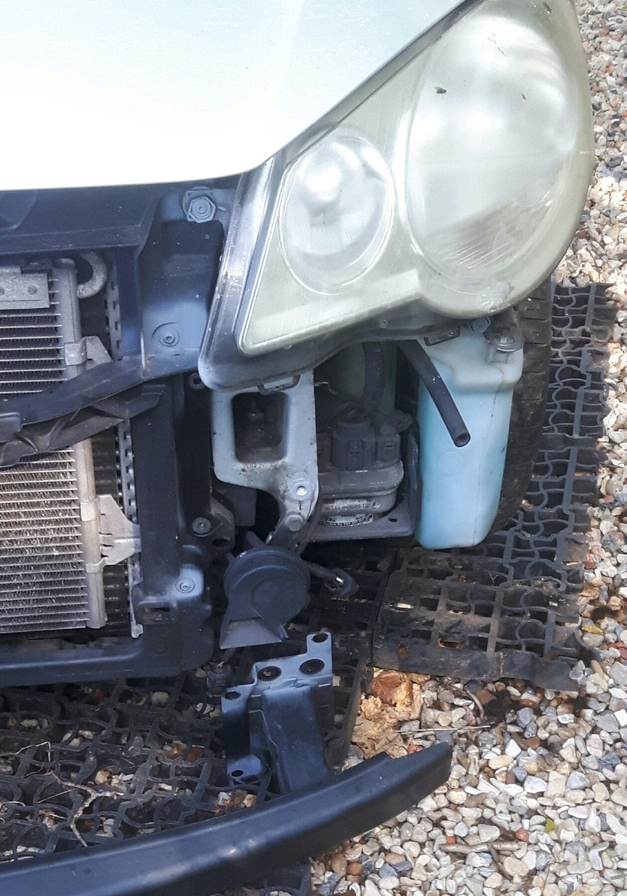

  24. @bTCole Were you undoing the clamp in order to replace this battery? Hopefully, because that yellow foamy stuff is sulphuric acid, and it should be contained within the battery. It's highly corrosive and dangerous to touch. There's actually a rubber drainage pipe connected to the bottom of the battery tray that is supposed to help any such fluid escape, away from metalwork onto the ground. It may be that your entry-point to this pipe is clogged up and so the 'fail-safe' drain wasn't able to do its job. Here's a photo of the far end of that pipe on a Polo, hanging in front of the screenwash reservoir:
