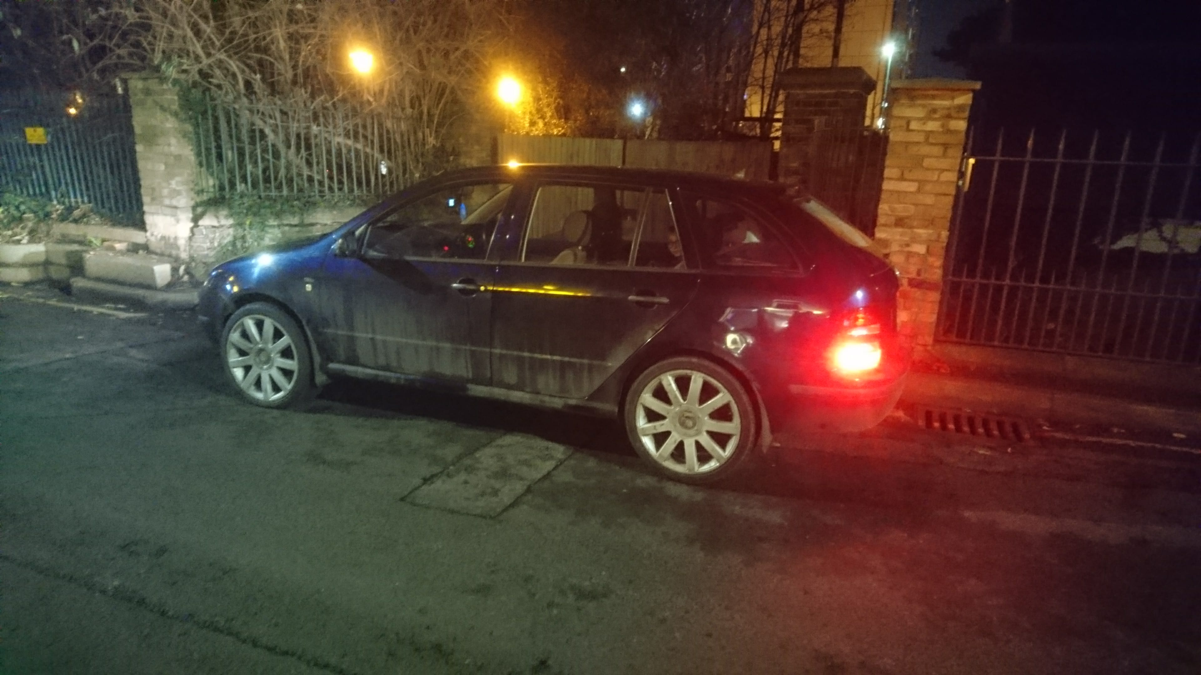

Watch this space, starting my new project this year, gonna build the ultimate fabia estate sleeper using the 1.8 20v turbo Quattro running gear
