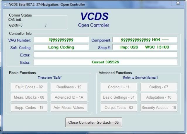

I've got my nav working again. Kind of.
I've got to get some maps on it. It doesn't display a boot screen any more, sd card music doesn't work any more and its CAN gateway is lobotomised...
which makes it hard to code in vcds as you have to do it blind due to no matching label.
Anyway it's all been worth it in my opinion because I've now got this...

I put the original coding I had before the upgrade back on it (0C0004000001000200). This puts it back in Skoda colour scheme and sets the speakers up correctly etc.
Mine plays cds and radio ok, sound quality is perfect.
I've just confirmed the unit still talks to the boot multi-changer ok.
It doesn't always let me connect to it with VCDS any more, I find it loses communication with the ECU and I have to reboot the nav to get access again.
