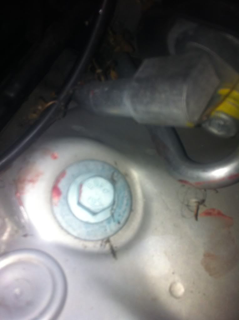

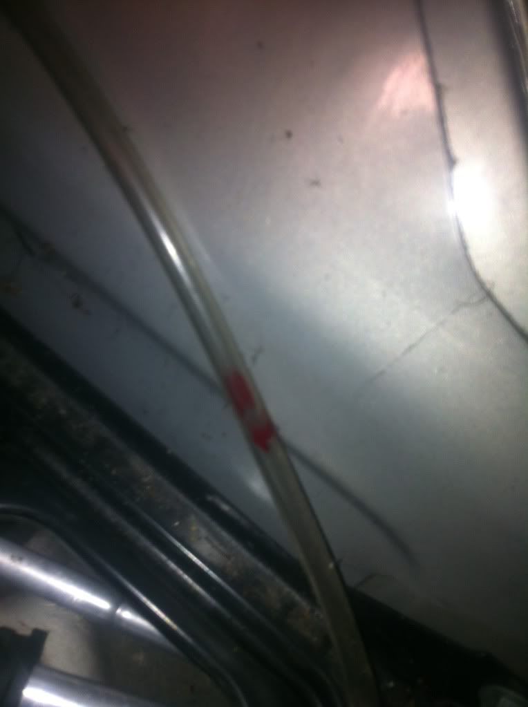

  • Bad news.. It's trickling down the bulk head. First thing to do open bonnet and remove the bonnet sealing strip and pull the trim under the windscreen off. This will expose brake servo, battery and w
  • Well I got started on re-sealing and checking the whole car today. Didn't manage to pull the carpet up as it took me 3 and a half bloody hours JUST to seal the pollen filter area and do the drain plu
  • Drains are under the battery plate and under the brake servo.   Water ingress, if it has happened will be under the carpet in the passenger side.  It can hold gallons before you see it above the car

This is what I found. The seal was damaged and SOAKING, there was water down the hole of the pollen filter. Oh dear.
My car had blood all over it, need to wash it before I get pulled and accused of things! :rofl:
And this is what my hand looked like afterwards.
It's all sealed now anyway.

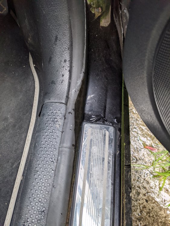

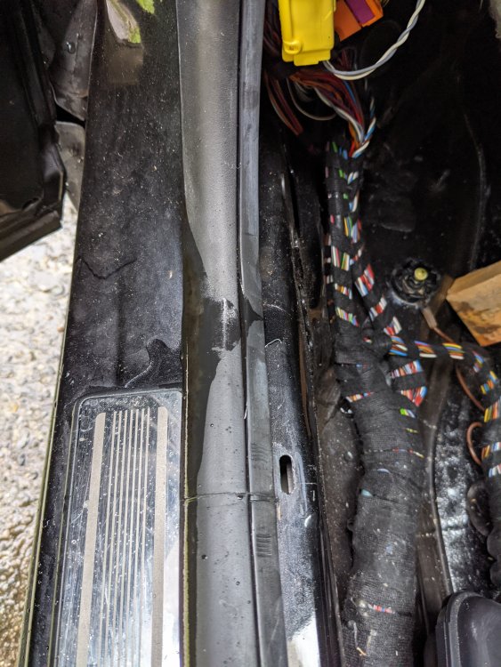

Superb Edition 100 - 100000 miles and now have water ingress, however, it's the REAR DRIVER side footwell. Even more confusing is the water is pooling towards the middle of the car?? Door seals all seem fine and nothing obvious.
All comments/help welcome.
cont'd...
Removed about half a litre of water from underneath my battery - suctioned out.
Wet vac all of the water from the rear driver's side footwell. Check all around to see if any where else is wet and notice nothing.
Footwell carpet still damp, but no visible signs of water.
Go for a quick spin in dry sunny conditions and the rear footwell is sodden again!! :@
Please- any thoughts?

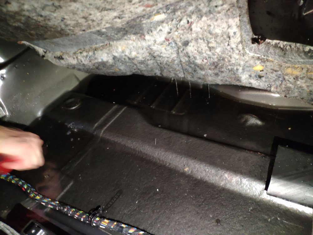

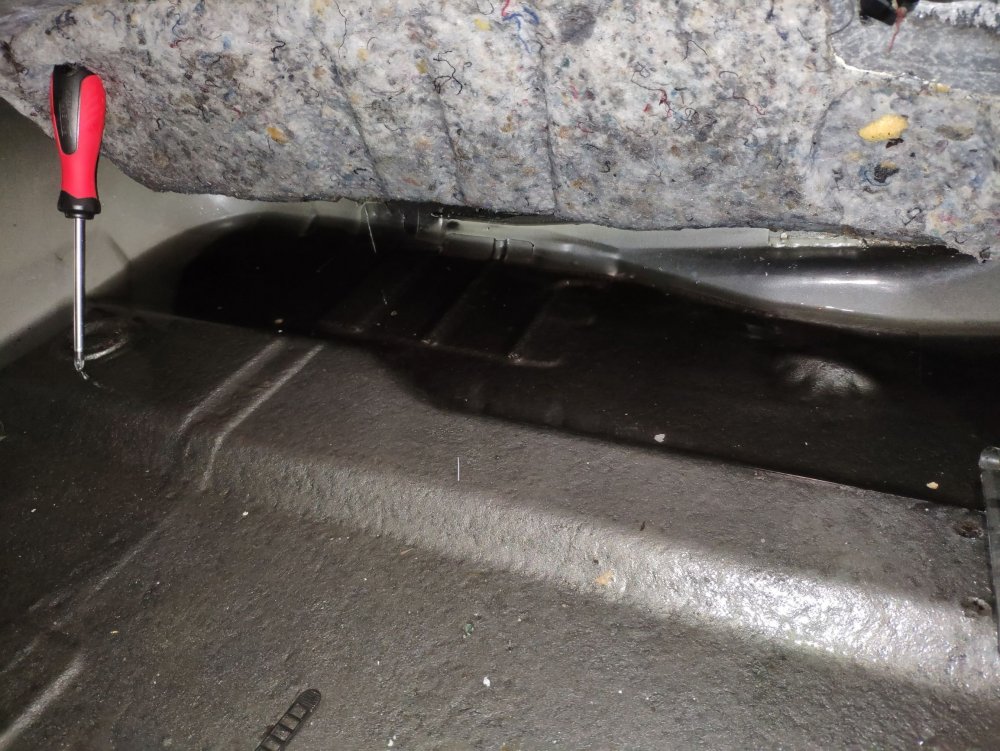

Did you lift the carpet? the water sits in a void under the carpet!
Thanks for replying. No, following a horror story from brother in law about refitting, was put off. I removed a hell of a lot of water. Wet vacced it several times and still sodden. How big is the void underneath?
Probably a bit late for this, but if you don't want to take the carpet out, it would always be possible to carefully drill a few drain holes in the floorpan - just fill them with a rubber grommet when the water's drained out.
Personally, if it were me, I'd do both - lift the carpet and drill a couple of holes from inside the car to outside, to ensure there's nothing in the way of the drill bit - but using a bit-stop would allow you to accurately drill only a mm or two deep, which should be safe enough (I'd drill drain holes because I don't have a wet/dry vacuum and my oil extractor seals have gone so no suction anymore).
Lifting the carpet isn't something that everyone would want to attempt as it does require a fair bit of trim removal including the seat to do a proper job, and trim removal has its own headaches (like myriad different clips to break) - and replacing the trim after is always a headache.

Under the carpet is the worlds biggest sponge. It will holds loads and loads of water. The top surface will feel dry unless you have a real serious amount of water in your car. The water will make it way to the back footwells when on level ground. Going from the front to the back of the car it will pass the CCM module - and knacker it if water gets in it (It is located at the lowest point in the front fottwell. The wiring harness is wrapped with a tape material which also absorbs water and hold the damp next to the wires and the nodes which are simply coppers wires twisted togeather inside a plastic sleave. These get oxidized and stop conducting - hence the lights and stuff stop working. You could drill holes or alternatively there is a large rubber bung in the back rear footwells. They are not so obvouse depending on how much underseal is applied to your car. It is simpler and safer to pull these out than to drill random holes. If you do not lift the carpet I doubt it will ever really dry.
