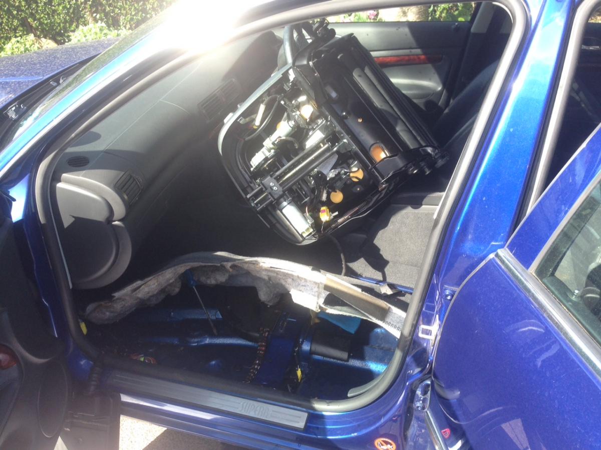

so parked the car up on a drive to take a look at the problem. took the passenger seat out first well undid it and moved it to the drivers side as i didn't want to disconnect it as it has airbags, this came out very easily. disconnect battery. now the seat was out the way the carpet came up a lot better than with it left in. now for anyone thinking of doing this go for it, i'm not into electrics. so first i took the large roll of wires and undid all the tape that hols them together. now what your looking for is a few wire that go together and Finnish up with a plastic seal tube at the end think theirs about ten of them all together tons of colour wires. cut the plugs off, on mine they were all corroded. so this was the problem why things are not working. iv checked the rest and most were like this. taped then all back up and put the battery back on. bingo all work cant believe i put it off for so long. im having to wait for the carpet to dry as this was very wet.

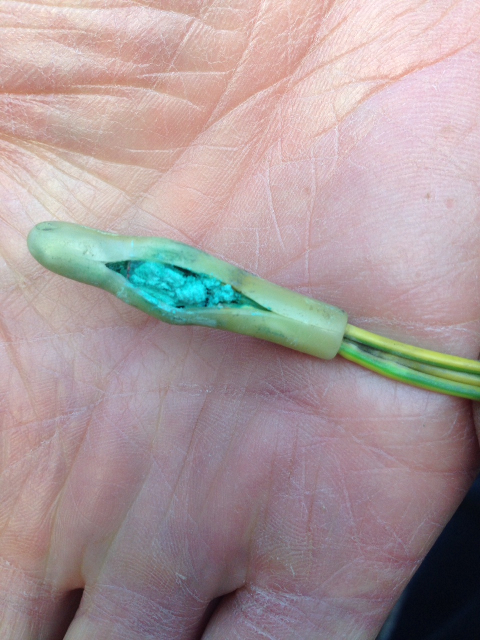

if anyone has one of these and have these problems do it yourself really i found it to be very easy and i was very worried about doing it.
but must stress that this fixed the electrics and not the water leak, you will need to sort this out even if you think your car is ok. at least take out the plugs under the battery.

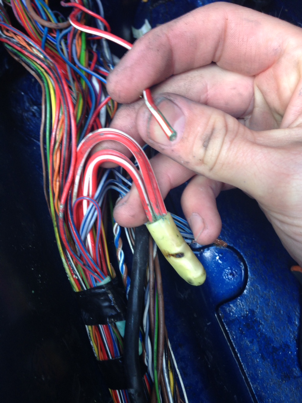

i had the same problem, look at the some of the post from this page it will tell you how to fix it. if you dont fix it it will start rotting your wires which will start to afect your lights inside your car if not already.
here are some photos of my skoda superb 2003 elegance. all the water rotted the wiring. ended up stripping the wire back then crimping the wire together and wrapping back up with tape. hope this helps people see the problem why the lights inside your car dont work, plus other problems.
now all my lights work puddle lights, internal lights and electric windows all work now and have had no more problems with them.
please note that you must stop the water coming in as this will only happen again

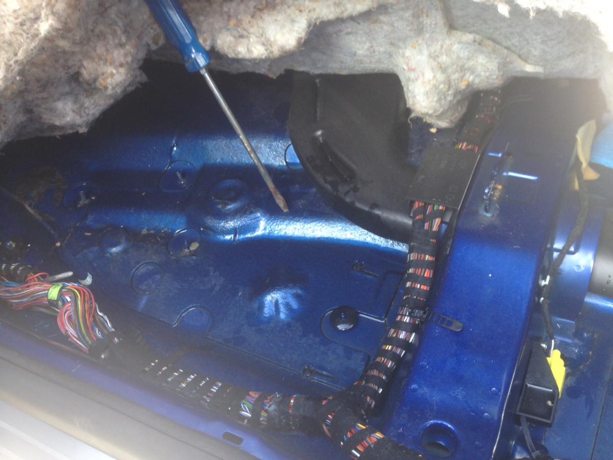

While you are in there the cable bundle need opening up to check for correded joints hidden inside it and also in the rear footwell, where will be more water and some more connections inside the wiring bundle.
Best to do it all and know it's fixed, rather than have to get under there again!
Yes you need to take the front seat out as well, I undid it and rested it on the drivers side. Best to do that then you can lift the full carpet up. When you do all this you will see that the water sits right where the wire sit. Untie the hole of the wire bundle and you'll see a few wire crimped together like in my other post above 3rd pic. Look for all of them and cut the wires back as I found most of them had rotted down the wire, look for shiney wire not black or green, crimp them back up and use electric tape to seal them back up. I used cling film to wrap the hole bundle back up when I knew it was ok to try and stop it happening again.
Main thing Befor you do this is remove the battery.
It's not as hard to do as you think.

i fixed it by stripping the wires back from being rotten (took back a few inch's) as their was a lot of wires coming together i used i 15 mm copper pipe cut it down to 10 mm strips and crimped them together (only did this as i didn't have anything else to use) i did this to all the contentions under the carpet (see my photos). then taped each bit then the lot. hope this helps

 On the uk version car the wire loom runs down the left hand side of the car, its best taking the seat out too. dont forget to check the two plugs in the water run off for the front window, one under the battery and the other on the other side. as for the pollen filter i took it out cleaned it up and re sealed it. check on this site as their lots of people how have took pics as they do it. vw passats the same as the superb as well
