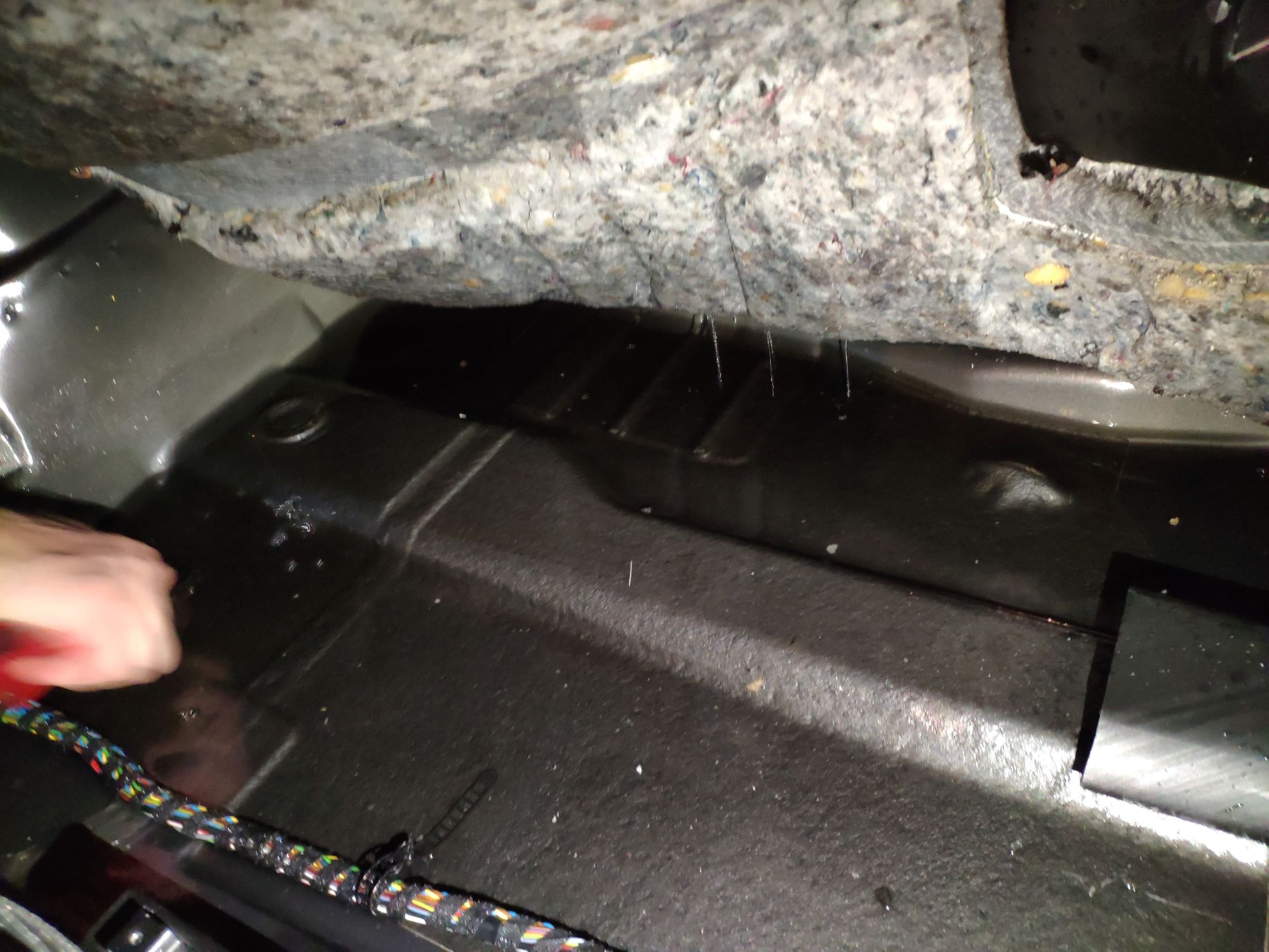

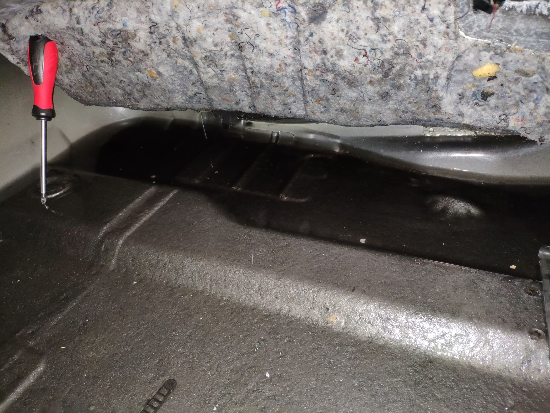

Unfortunate to say I have a very wet underlay in passenger rear footwell (and front due to slope of driveway).
After leaving my car to sit on a slightly rearward slope for approx 3 months over the winter (away with work) I returned to notice my boot and glovebox light stopped working.
Yesterday after feeling through the rear ventilation vent, I decided to pull the carpets.
Found evidence of corrosion on wiring and hoping this is the issue (seems plausible).
CCM box was dry, wiring was wet but nil corrosion evident which is good.
This is @Gizmoold Superb Edition 100, so the preventative maintenance you did almost 12 years ago seemed to do well for quite a while.
Now to seal the pollen filter again, dry out the interior and hope it doesn't happen again!
Just put my finger through the drivers ventilation (rear) and that's damp too... Brill! Looks like I'll need to do some investigation!
For information - my pollen housing seal, ECU and Bonnet grommet are all good, the water isn't coming from here.

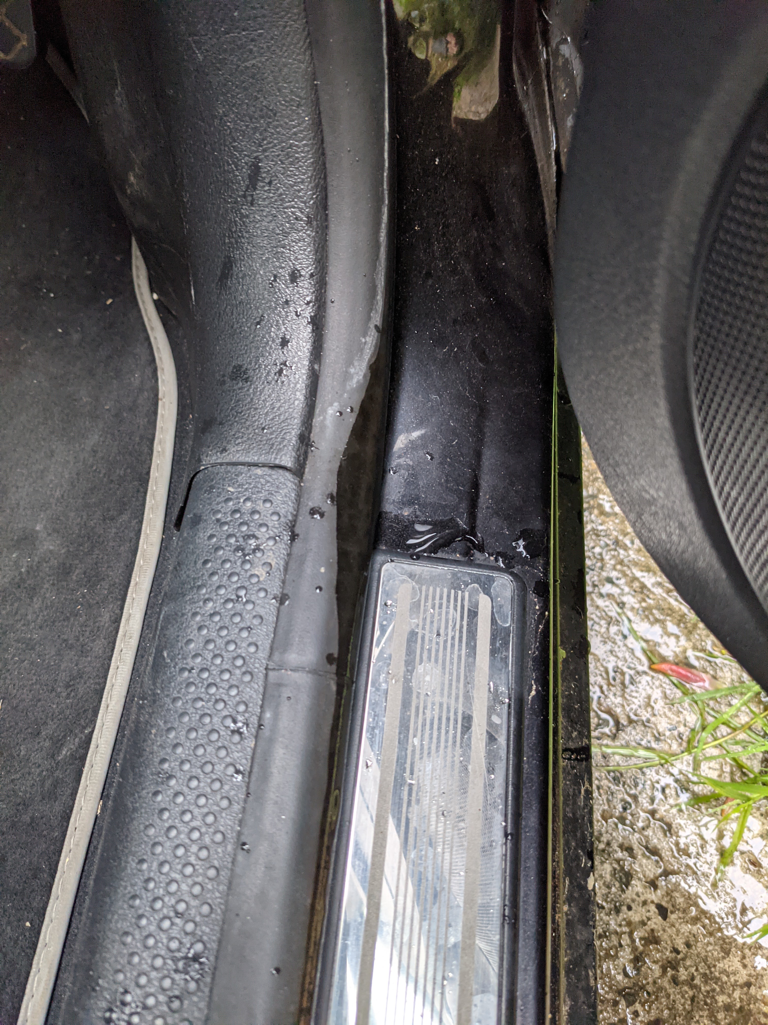

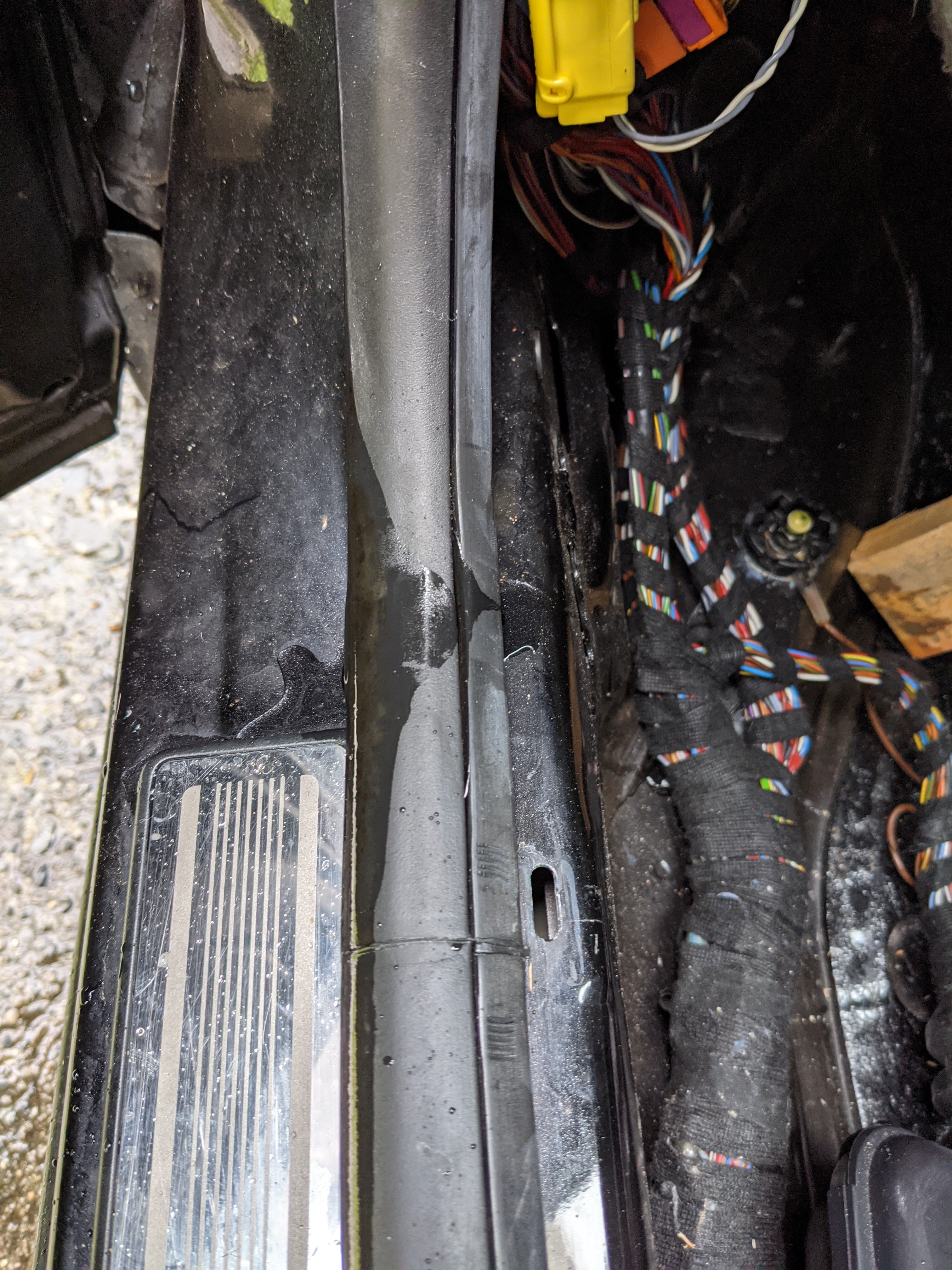

After a downpour today, notice water coming through the door seal as below on both front doors - will seal up the window motor / regulator carrier with silicone tomorrow and see if that works!
For info / future... My issue turned out to be the following:
Driver's door membrane (recently changed regulator).
Sunroof drains - they were clear, although the two front pipes were detached from the rubber bung in the door. Meaning water would just pool into the car and not overboard.
The rear sunroof drain attachment to the sunroof unit were leaking and not a firm seal.
Hopefully that's the end of my water ingress issues for a while!
