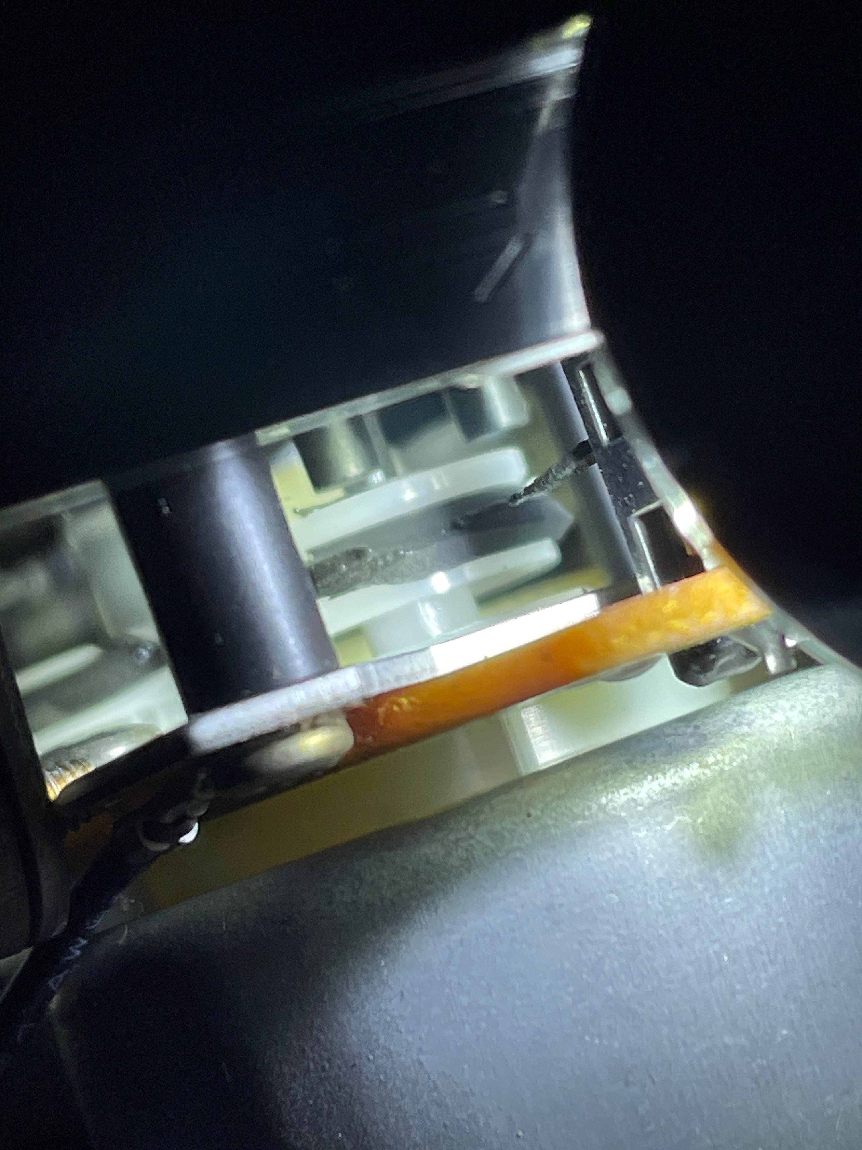

  • Eyes down, look in....   Preparation:     No belt here:     Something not quite right:     Belt remnants around shaft:
  • Well I planned an assault on the thick black sticky mess, armed to the gunwales with my weapons of choice; cocktail sticks, cotton buds and dental floss.  And I'm pleased to say with a positive outcom

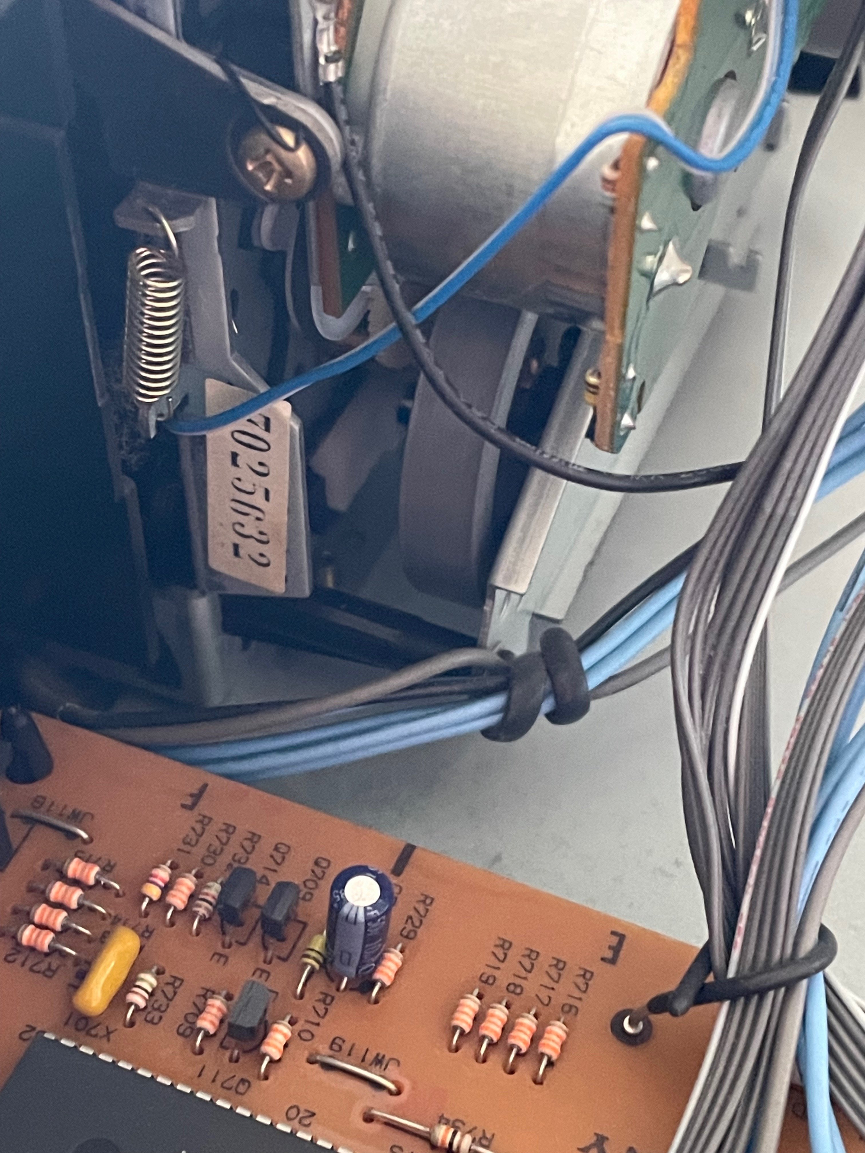

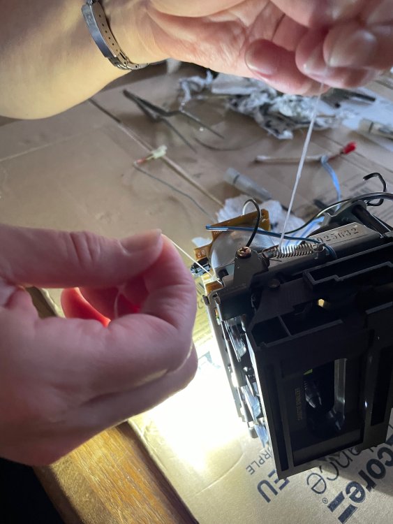

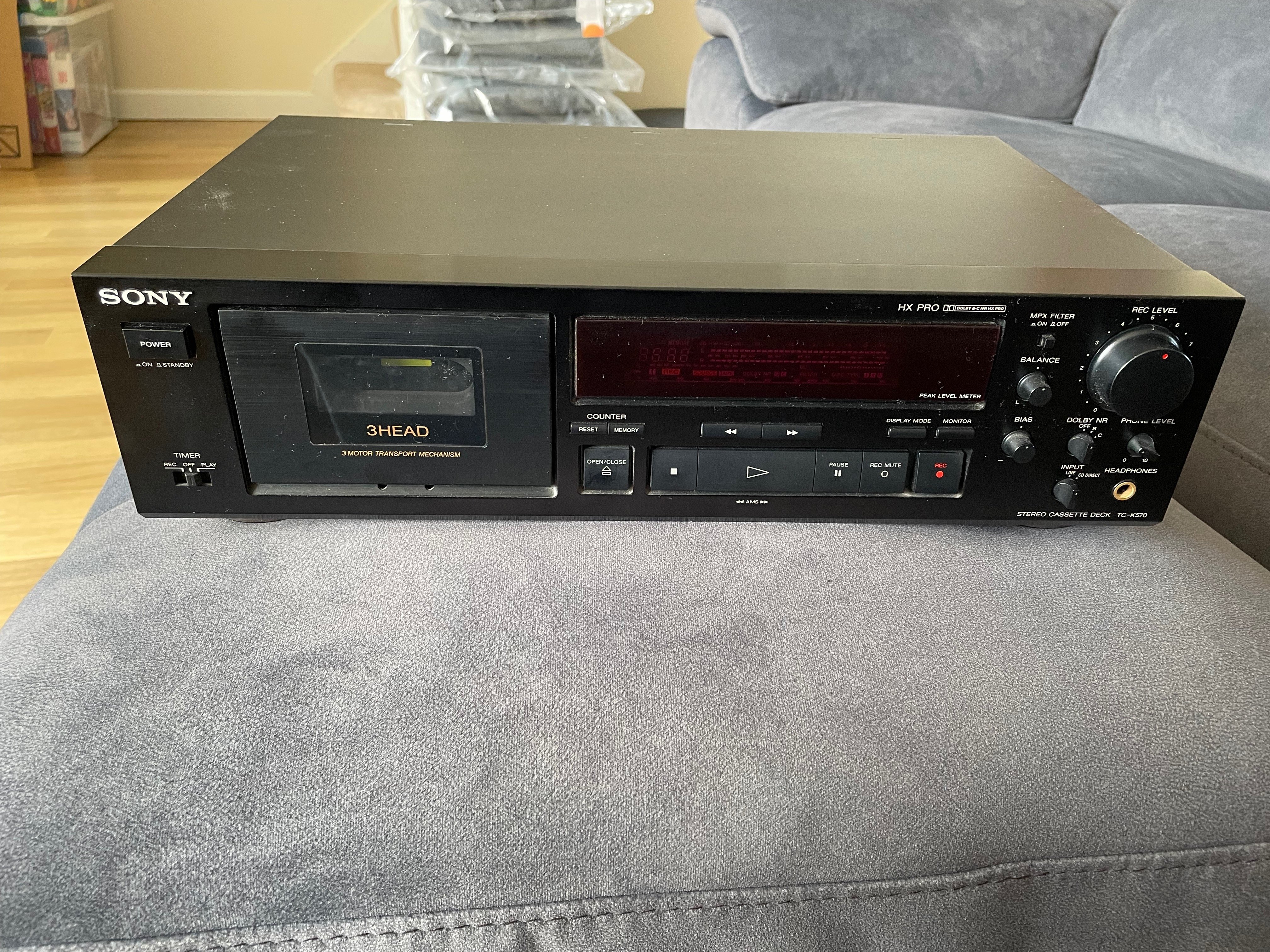

Well my Sony TC-K570 did a death squeal this morning and the cassette tray won't open.  I'm sure I must've used it at least once in the last decade :thinking:  Watching videos on YT seems to suggest it's the belts, which would be no surprise.  A belt kit's only about £7, and I think (ever the optimist) I could do it, but if I won't use it again before the new belts are goo/perished, what's the point.  The unit itself isn't worth a light, repaired or not, so I think I'm just being sentimental in not wanting to just throw it away.  Sad day 😧
Gaz
May as well keep and fix - if only for the pleasure in doing so...   I repaired my FIL's Teac A150 a few years ago for similar reasons - it's still functioning but not used as he's now passed away but one day I'll bring it home and use it.

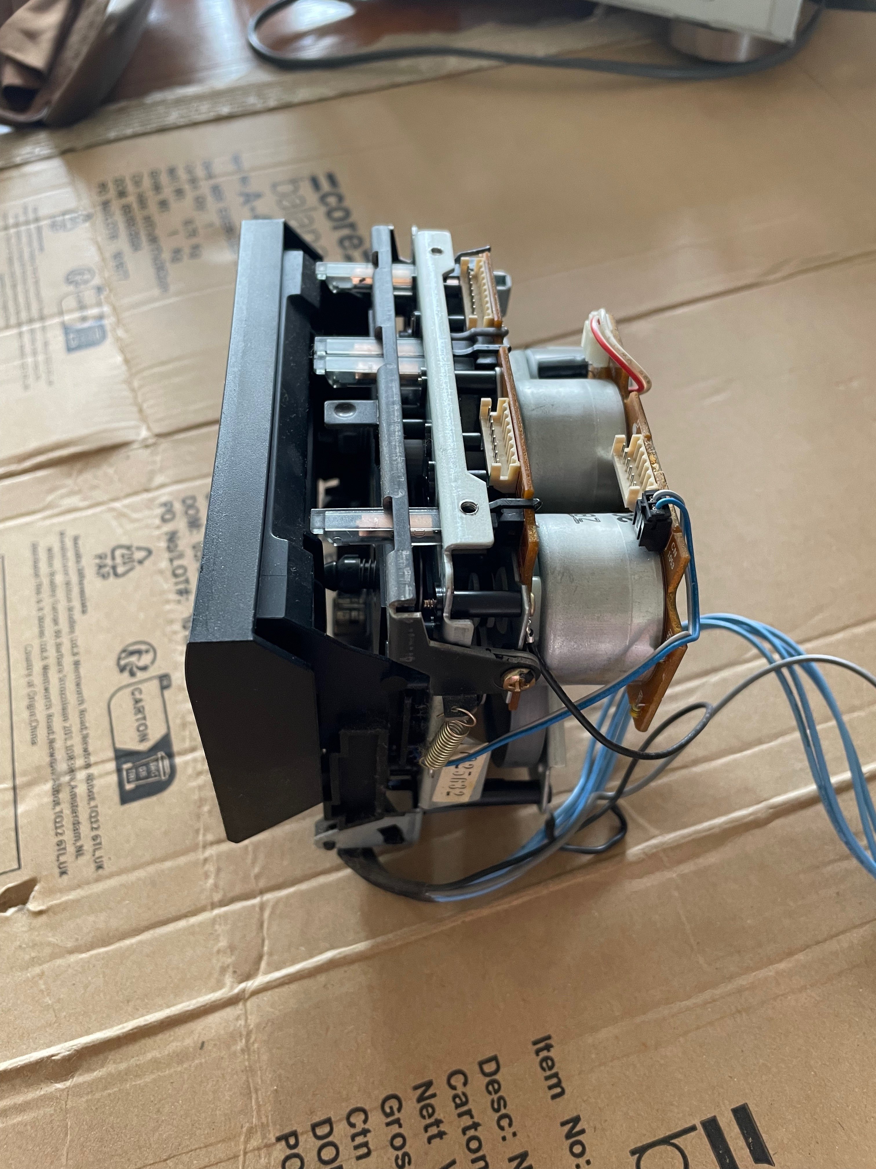

1 hour ago, Lee01 said:
I'm not saying you're prone to the odd mishap, you understand.
I am having to be particularly cautious at the moment as my recently excavated finger is still looking for any excuse to start bleeding again 🩸

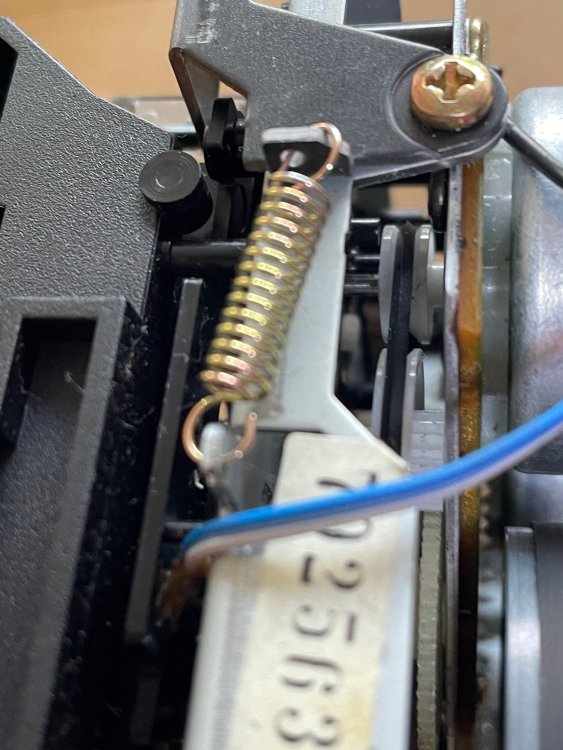

And the inside of this unit has some particularly nasty edges that are just waiting to pounce.  So my survival instincts were running high :nod:

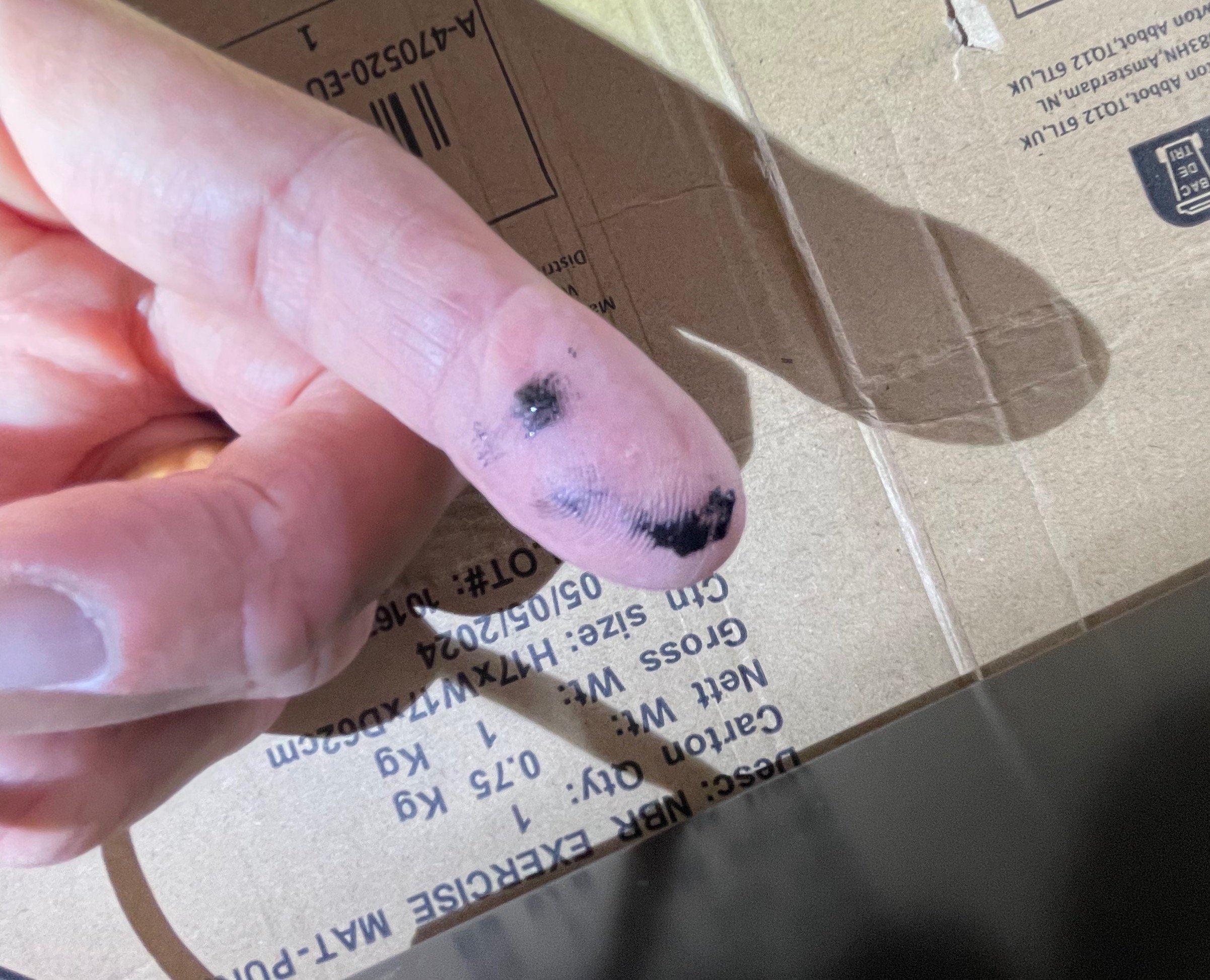

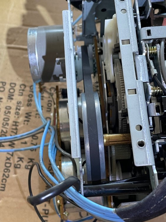

Dunno what the belts are made of, but it's really gloopy and tar like.  Looks like it'd go well under the felt on my garage roof.
New belts ordered and due in two to three days.
Gaz
Common thing for Sony units of this age. My Sony TC-WR445 has belts on their way out, and the Sony MIDI system my Gran and Grampa has packed in sometime when I were a lad. Belts like goo.
The belts on the Teac I mentioned earlier were the same...   They'd disintegrated to a thick black sticky mess
It's a common problem with late 80s/ 90s drive belts and not just tape decks.
VHS, turntables etc suffered as well IIRC.
