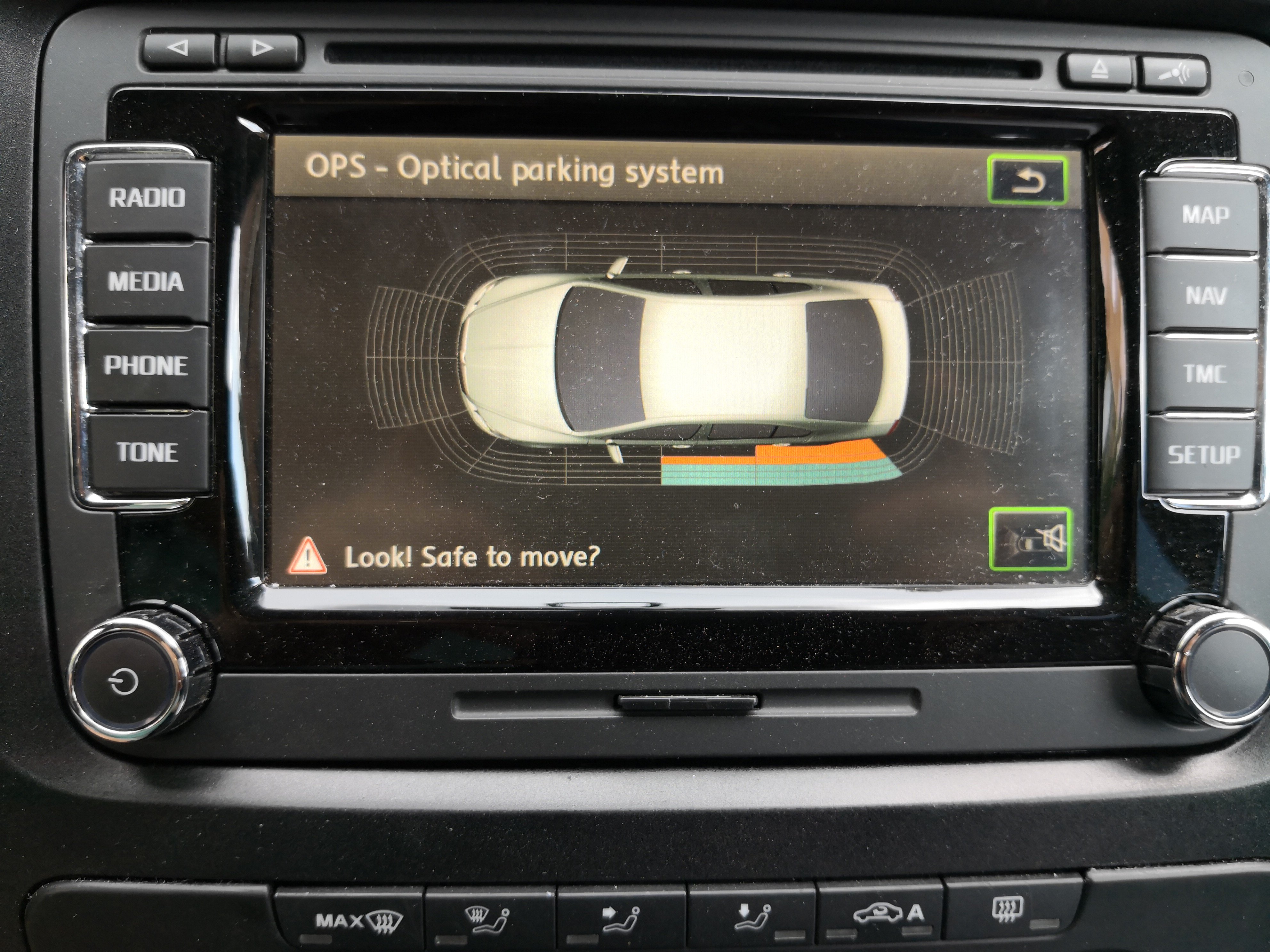

Hello,
Retrofitted PLA 2.0 on my car, all works fine except I do not have 360 OPS on my navigation.
Anyone any ideas?

Hello.
All good now. 360 OPS works, but it will turn on automatically when an obstacle is detected on either side of the car, otherwise it will display only 8 sensors.
