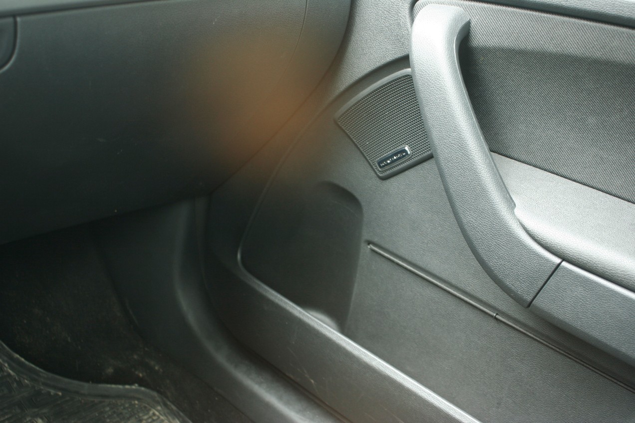

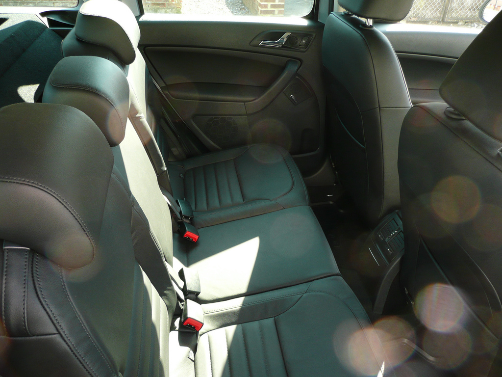

I can't answer all but look at the attached pictures to show you the extra speaker positions on the doors.
And a picture of the speaker in the front door.

Each door has a treble, mid range and 'bass' speaker.
The digital amp is located under the passenger seat of my rhd Yeti.
You must be able to buy the parts but in my opinion the cost will be massive and in terms of quality you'd be better off buying aftermarket kit.
Id say no, the wiring for the additional speakers and amp etc wont be there on all cars - im guessing the loom would be installed at factory only if the option has been specified.
