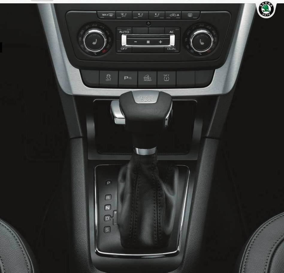

I think the interior light sensor is the black round dot you see in the attached picture just above the two blank buttons between Auto and AC. Thus when you switch your "spotlights" on they shine directly on this sensor and hence the instruments dim.
Sorry, but in automotive terms spotlights are what are fitted to the front of a car to give a pencil beam. Them things inside are map reading lights! :wonder:
No Sorry emoticon-0101-sadsmile.gif. It is the Interior Temperature Sensor emoticon-0148-yes.gif
See Drivers Manual Page 103 - "NOTE: Below the top row of buttonsis located the interior temperature sensor. Do not glue or cover over the sensor, otherwise it could have anunfavourable effect on the Climatronic."

Aha! I stand corrected! But if the interior map lights do change the instrument lighting like that the photocell for that can't be for away from the centre console either!
@90000: for the first time (I think), you're wrong :))))
This is the inside temperature sensor.
The small dark thing with a bump in the center of the dashboard just under the windscreen is the sunlight penetration photosensor (hope you can find it).

@90000: for the first time (I think), you're wrong emoticon-0100-smile.gif)))
emoticon-0136-giggle.gifemoticon-0136-giggle.gif I might have a number for a profile name but a robot I'm not. So being a human I can be wrong too! Or maybe 900000 is right and Johann is human? Hehehe But in saying all that I did say "I think..." So I did not profess my thinking was the truth!
I suspect that the CANBUS is reading that they are on and makes the change itself - To prove it try it with the lights off and shine a bright light around the interior? What do you think??
As others have said this is the interior temperature detector.
When the sun shines across the dashboard you can see the faint outlines of all the warning lights including those that you would have had if you had paid for the top model.
On my FL Octavia (that has illuminated needles but no instrument illumination unless the lights are on for some reason!) there is a simple circular "warning light" outline bottom right of the speedo at around the155mph mark. It is about 4 or 5mm diameter. Is this the ambient light detector? Does the Yeti have the same? Or does it use the signal from the autodimming mirror?
I take this as the ambient light detector. I don't think it's using the mirror sensors
