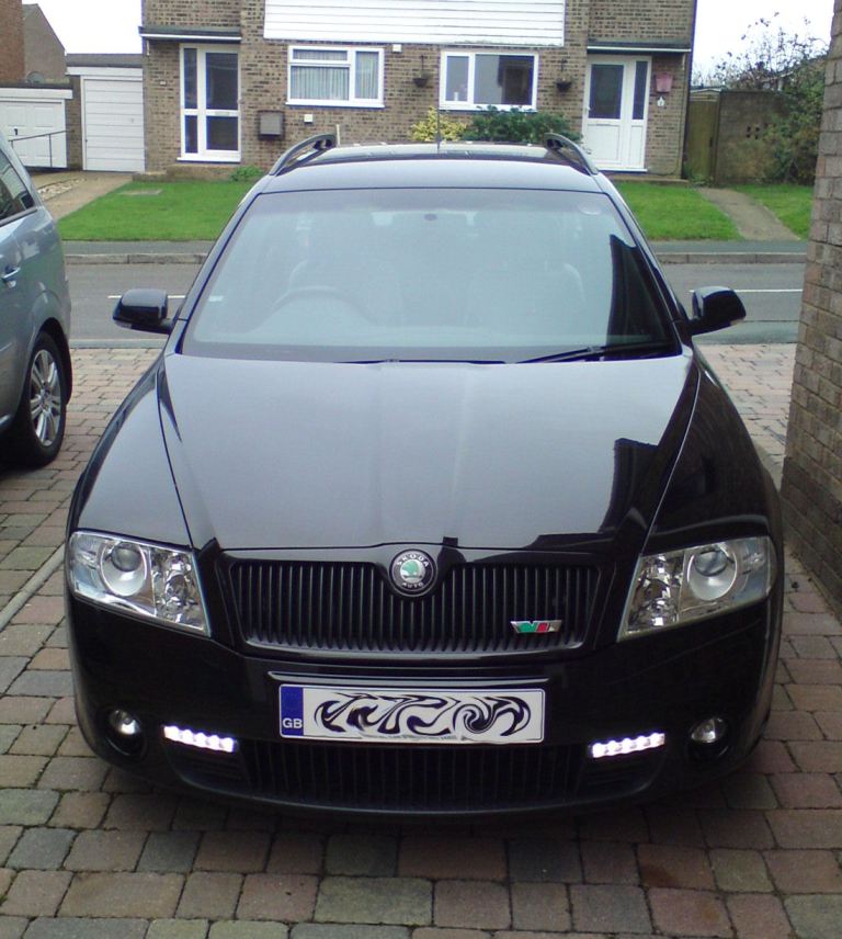

Try these when fitted they look like this:
:thumbup:

Hi All
Here is a picture of a friends car who also wanted a Led stripe with the 68 mini Led bulb for DRL

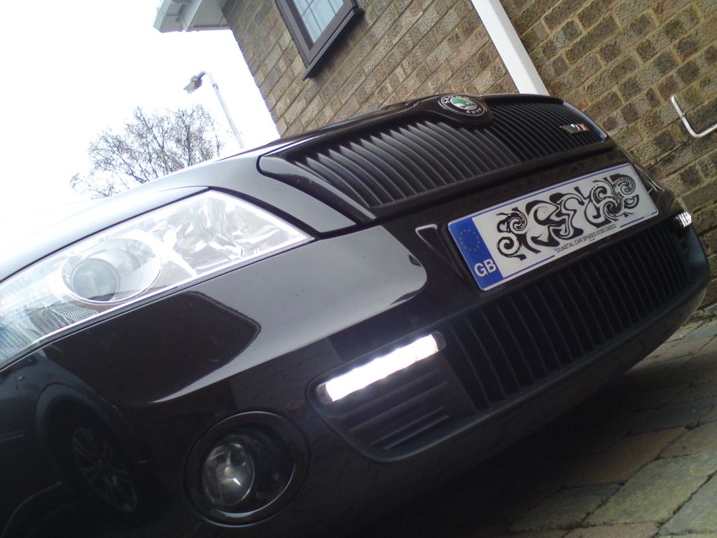

My Led reverse lights, same bulb as the led DRL, used to be a H8 for the foglight, the Led bulb was alot brighter compared to the DRL bulb because it ran on the fogbulb at 38w when the DRL is only 21w.
I have managed to increase the bulb intensity to 110%, it can actually go to 121%.
Look at the picture Nº 2 DRL Led and Nº 3 H8 Led on fog
