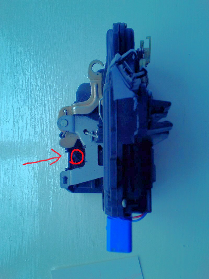

Once the inner panel is removed you can finally get access the locking mechanism. I calculated that I could make a hole in the plastic casing and get access to the gears that the central locking uses. Once exposed I could manually turn the gear to disable the deadlocking and unlock the door. It sounded simple but its tricky to work in such a cramped space and I would be guestimating as to the actual location of the gears simply based on pictures of the lock internals on the internet.
The area to be cut was masked with tape and using a Dremel with cutting wheel, the plastic housing was carefully ground away to expose the large white gear. As the area to be cut (green arrow in pic below) faces the door panel I stuck a small mirror onto the door to help.
The pictures show I got close to the exact area needing to to be removed. It should be noted that the hole is very near to a circuit board on one side and the mechanical pivot on the other so care is needed when cutting not to hit these along with not cutting too deep and damaging the gears. I seem to have lost the measurements to determine the exact location and dimension needed to cut the hole.

I know this is an old post but I had to carry out this job at the weekend so thought I would add my comments.
For me, the door was locked and could not be opened from inside or outside so required removal of the interior door trim, anciliaries carrier etc to gain access, which was pretty fiddly but actually straight forward enough.
I cut into the lock with a Dremel as detailed above and attempted to move the gear wheels but this had no effect with them just turning so I had little choice but to trash the lock mechanism in the hopes it would release.
I did this with a long, narrow cold chisel, hammering at the base of the lock where the main mechanism is and just hoped for the best. This was a bit daunting to do but after maybe 10 mins of hammering I had broken enough of the lock for it to disenguage.
To protect the door skin I taped a piece of 6mm plywood whilst hammering so no external damage was done.
After that and the door was open it was a very straight forward job to unbolt the old lock, replace with a new one (£40 off eBay brand new) and put everything back together again.

The key fob opens the near side locks and boot but does not open the offside locks, both don;t even make an attempt. Drivers door can be opened by turning the key, which also opens both the near side locks and boot. The rear offside cannot be opened at all - deadlocked.
I have read lots of threads about what seems to be a common fault - Rear door becoming deadlocked.  So I've got into the offside rear door but before I wreck the lock, I wonder if the front central locking issue and the rear locking issue are related. Is there a separate fuse for the offside central locking. Anyone know where I can get a wiring diagram?
Alternatively, if i am to take a chisel to it, where do I aim the chisel?

3) I don't have a dremmel and 'smashing it to pieces' sounded simpler to me. Use a pair of pliers to rip the connector off then stick your chisel in there and smash away. I filled the door with some thick material incase anything slipped. When you can see the cog pictured in the first post then you should spin this so that axle/shaft comes towards you (downwards) for quite some time until the door will open. I was under the impression it needed to be spun once or twice, but it takes a while to get the locking pin completely descended. I found it much easier to spin by actually pulling the motor out of the lock by grabbing the smaller, white cog with some pliers and pulling it down. The larger locking cog would then spin freely!
