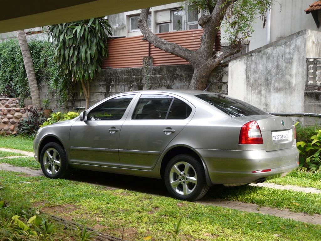

Being in India, i have to deal with the octavias sitting at 165mm!! If i were to go for the eibach pro kit would the height drop from my current height of 165mm or is a fixed drop of 20mm from 145mm (as in the EU octavias). Excuse me if this is a stupid question but in India the roads are pathetic and theres no way we can have our cars sitting at 125mm!!
This pic will give you an Idea of how our cars have been lifted to deal with the bad roads and the consequent ugliness we have to live with!!

I'd try the eibachs - be prepared for a big drop over standard Indian ride height!
