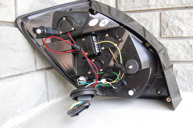

Nope as you'll need to repalce the shole unit inc the wires:
The breakdown adn the picture is below:
Side lights: LED-LED bar
Stop lights: LED
Fog lights: Bulb
Reversing lamp: Bulb
Indicator lights: LED
These units are EU Road Approved with the E Certificate.
If someone is interested I'm more than happy to help with buying these units.
Matty
