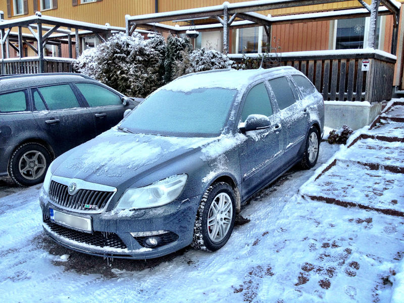

16 inch Audi RS replicas, running Nokian Hakkapeliitta 7 studded tyres:
That looks very cold!
Nothing bad yet, only -15c Worst is yet to come :)
