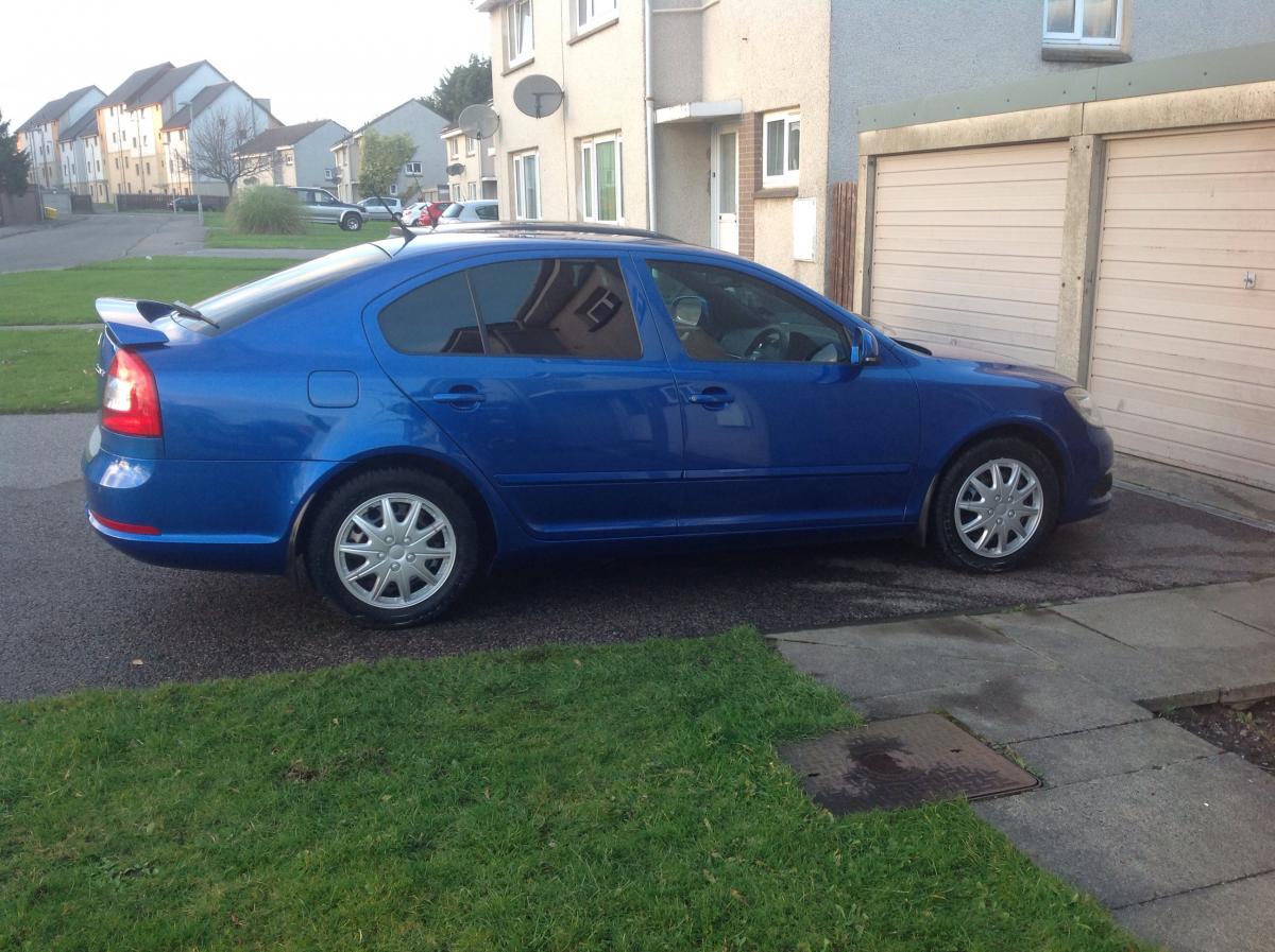

Well as promised, here is my car with the trims fitted.

I won't laugh to much when I see you out on the road with the trims blue lol. The local kwik fit wants £80 to put my winters on, no a hope in hell I'm paying that to them robbers. The place across from mac d's only wants £40

Hey needs must :) means I keep my alloys pristine though and besides, I don't think they look to bad. Have seen worse!
Just change them yourself, I did using just the normally jack. Got Kwik fit to check the torque on the nuts a couple of days later for free.

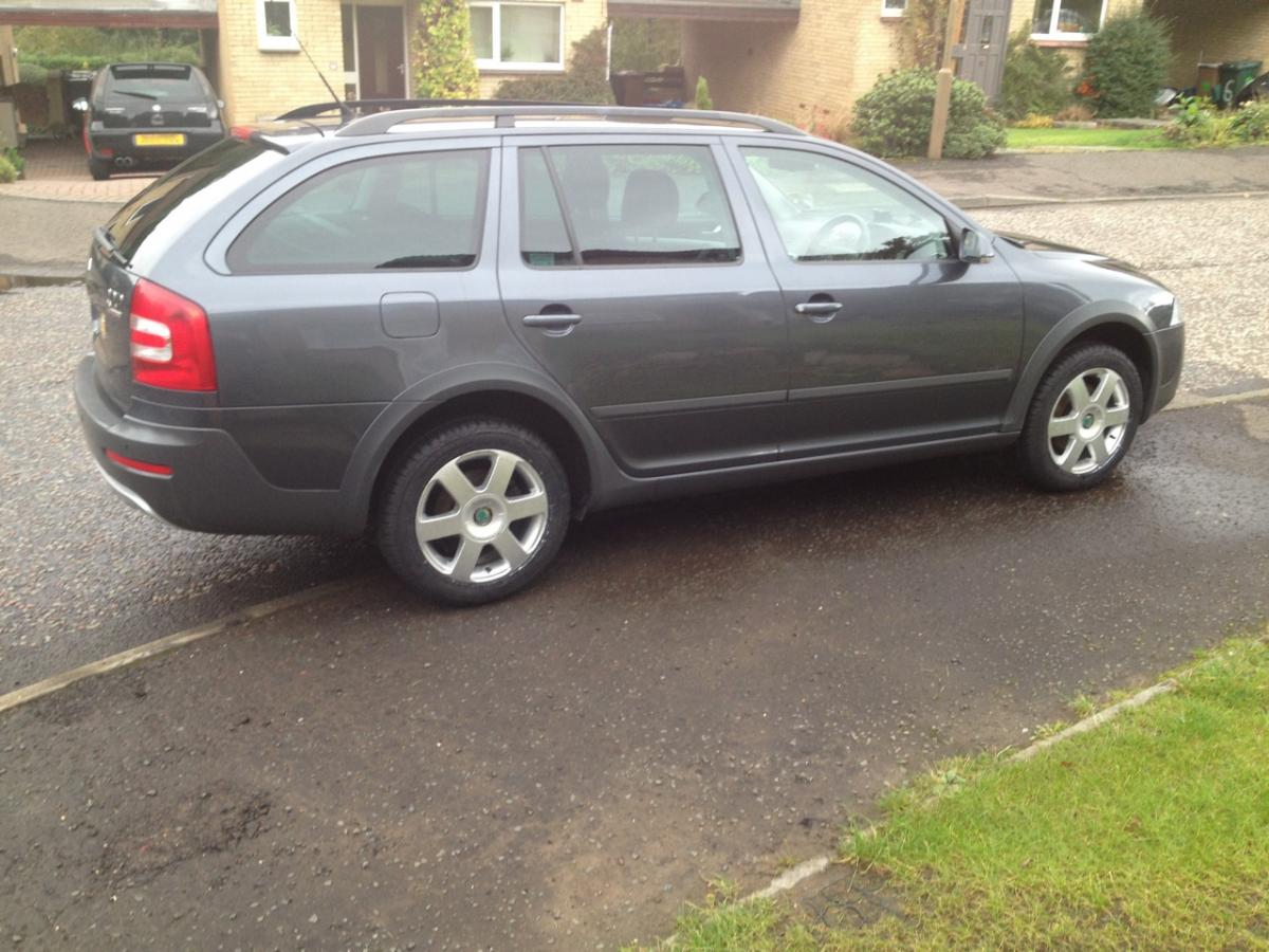

New picture with correct Wheel Centre Caps:

Audi A3 Alloys 16" x 6.5J, ET50, PCD 5 x 112 fitted to a scout. Running Hankook 205/55 Winter tyres:
And also fitted to the Scouts predecessor:
