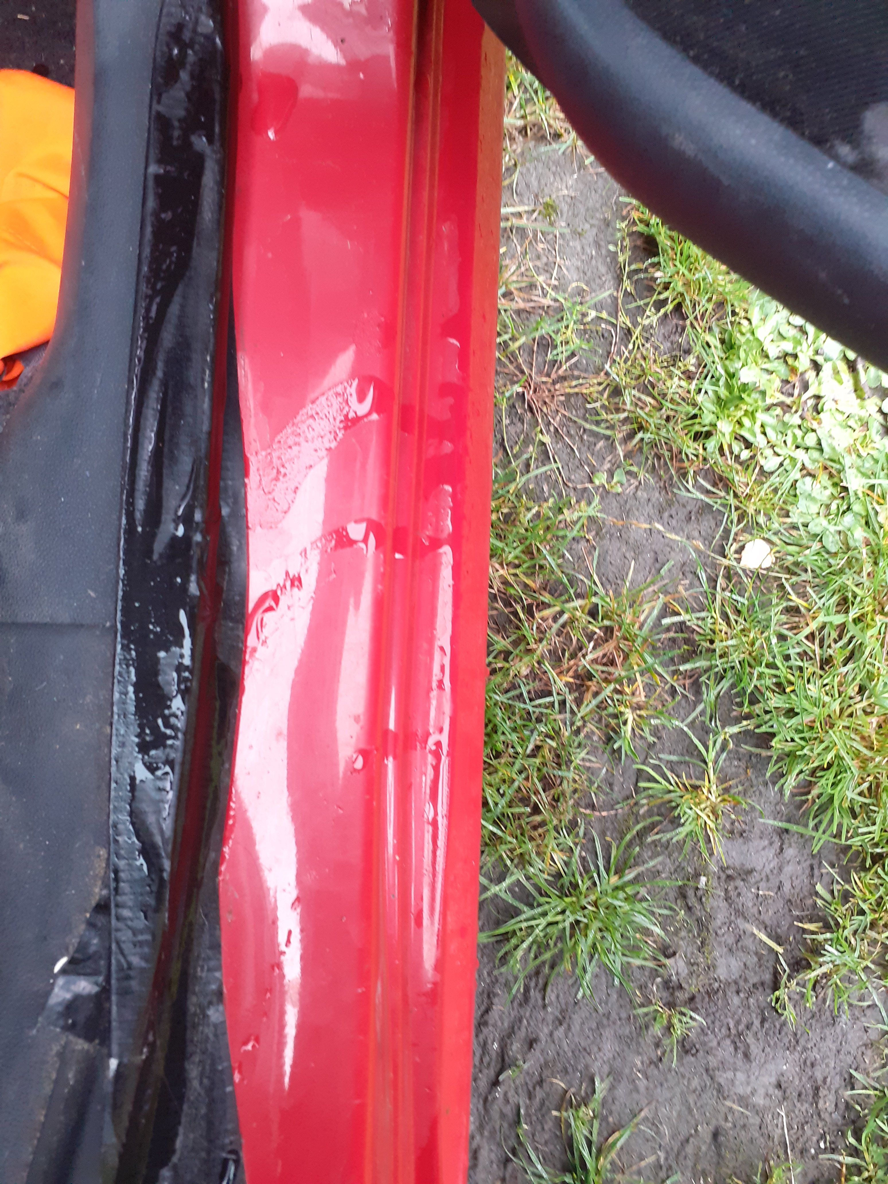

whipped the door card to find the bottom of the door carrier expanded and split the seal AGAIN:angry:
brain wave thought id try and drill and stick some self tappers through just above the bottom(the indentation just above) and voila actually pulled the bottom together pretty well,pee'd out loads of water as it was tightening slowly 1 by 1 across the bottom as id put about 7 self tappers in lol,left to dry for about 15 mins then ran another seal just under and around the screws,leaving the door card off for a week or so this time so i can keep an eye on it more,fingers crossed its sorted for the autumn/winter coming

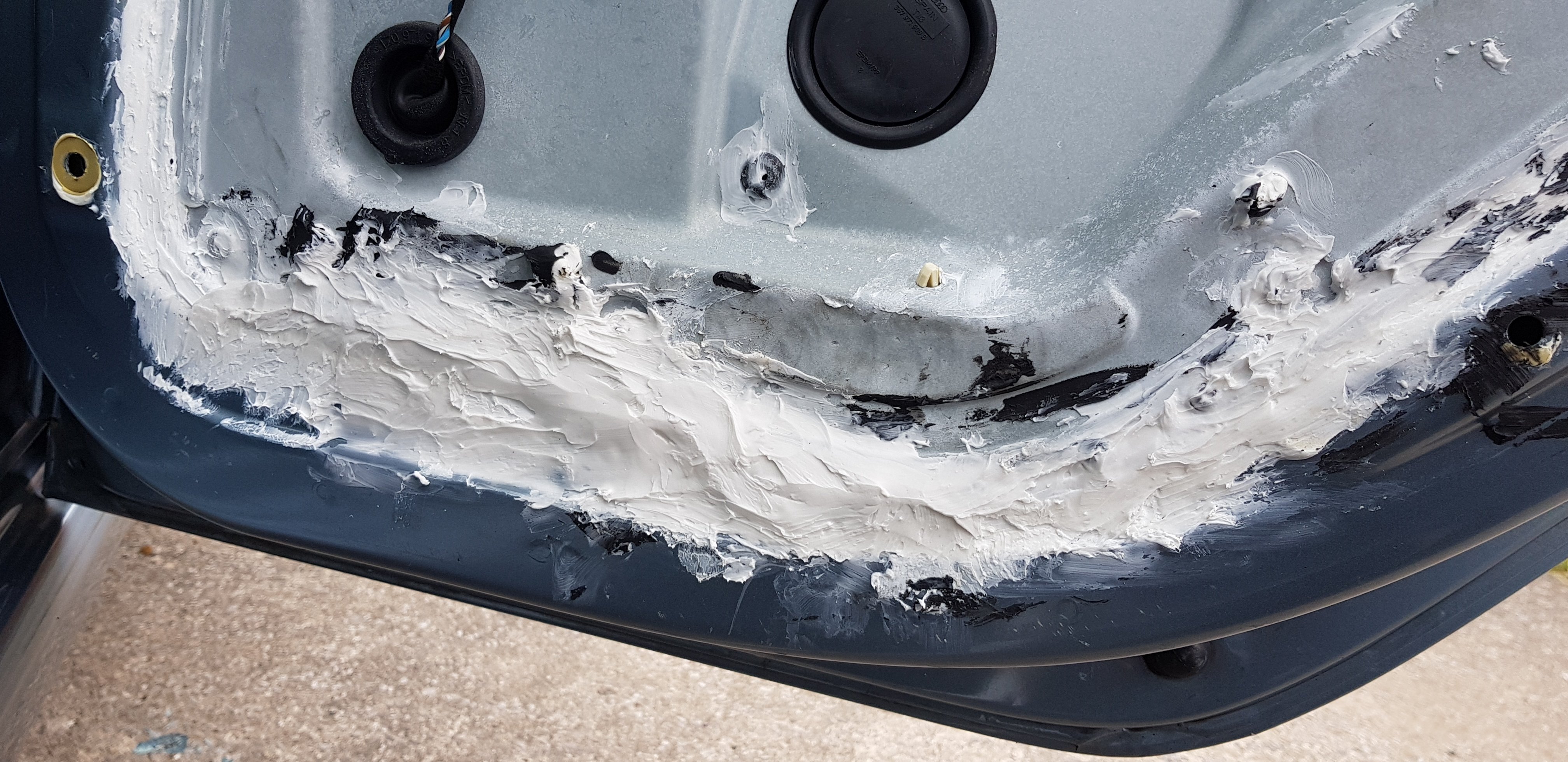

Plastered on but there's a soggy patch an inch wide,possibly a water bubble :sweat:
Did you run any of that behind the tray on the inside edge where the original seal is? If you've applied the sealant on the outside but it doesn't go around the edge of the tray and up the back, that might be why you've got a leak. It's going to be a pig to remove the sealant (if it's decent stuff). I'd also recommend (if you do it again) to use IPA to clean the door panel and left to dry before applying the sealant just in case you've got bonding issues.
Also, you mentioned yours was riveted. Have you replaced them with self-tapping screws?
I put the trigger gun right up against the gap and went very slowly around, going quite high up either side. I then ran my finger (dipped in a little fairy liquid) around gently smoothing and pushing slightly into the gap. I have done 3 doors on two Fabias....and all still hopefully OK.

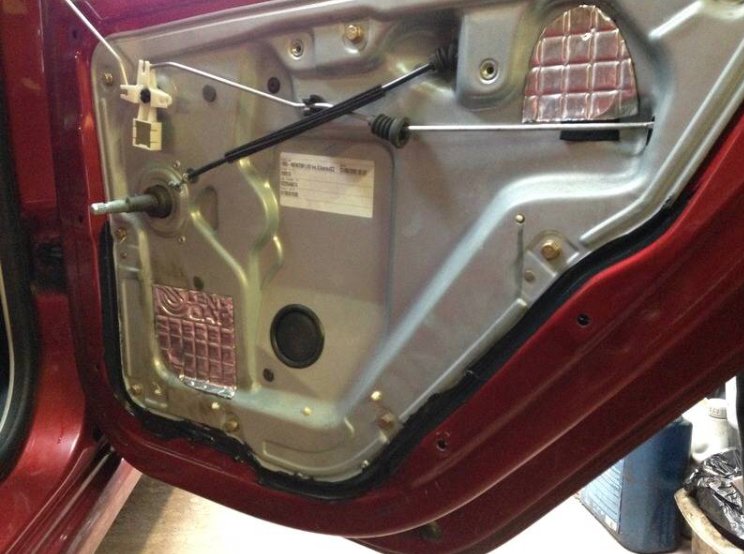

On 25/09/2018 at 07:16, Tech1e said:
Rear ancilleries carrier sealed years ago, still nice and dry, no further leaks.
OOPs I meant to attach this picture to the above post...sorry.
