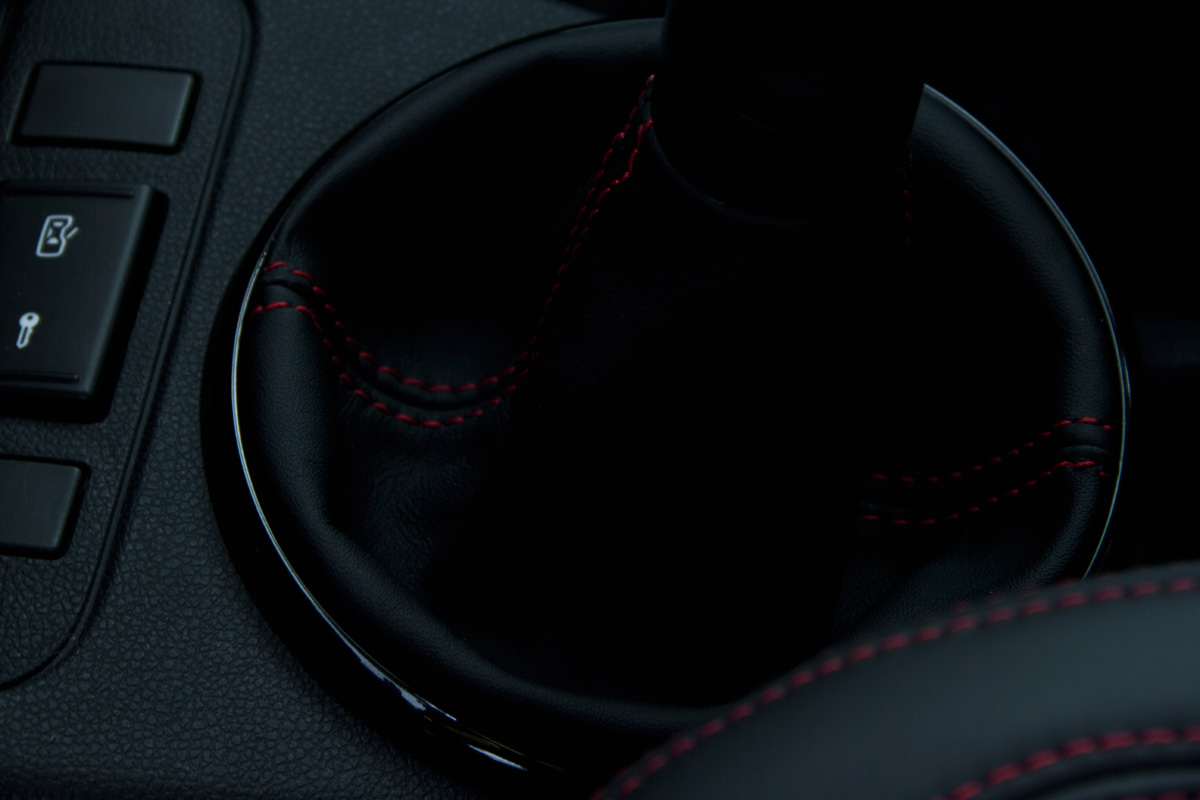

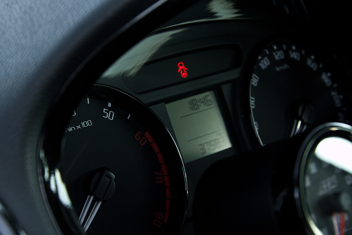

How did you manage to get the boot level matt silver coated ring and the same matt silver coated ring on the console (tacho and speedometers) covered in Gloss black? How were you able to remove the plastic protective screen in front of the consoles and how did you apply the gloss film?

The gear stick ring you can remove with a lot of care - you just lift it up with a prying tool from underneath.
As for the tacho you need to pull out the plastic behind the steering wheel, then the surround plastic of the tacho and then you will be able to unscrew the tacho itself.
The protective screen needs to be un-clipped and then you have access to the rings that can be pulled out with a bit of force.

Many thanks for your feedback. I'm going to be trying to put black gloss film on my car's interiors where there are the aluminium silver finished parts. I've read your posts and understand except for the a/c central vents garnish, everything else can be softly opened with a pry tool.
Only concerned about the tacho rings behind the steering. Sorry to bother you but how to 'un-clip' the plastic surround from the IP console? Would you be able to help explain that please?
1. First you have to remove the top plastic part of your steering column. It is the one sitting right above your indicator/wiper switches.Just push it up and it will come off.
2. The end part is attached to a leather trim that comes with the plastic surround of the tacho pod. Remove that too, it unclips and then the steering column cover will be free.
3. Then remove the tacho pod surround by simply pulling it towards you. It is not easy as there are metallic clips holding it behind so force it a bit. Make sure you don't loose and of those metallic clips.
4. Unscrew the tacho, I think there are two screws holding in and then remove the 2 plugs behind it. I think taking off the leads from the battery before removing the plugs is a good idea.
5. Unclip the transparent facia, it is clear what you need to do soon as you see it and then pull out the rings. They need a bit of force, use your nails there is no other way around it.
Hope is helps.
