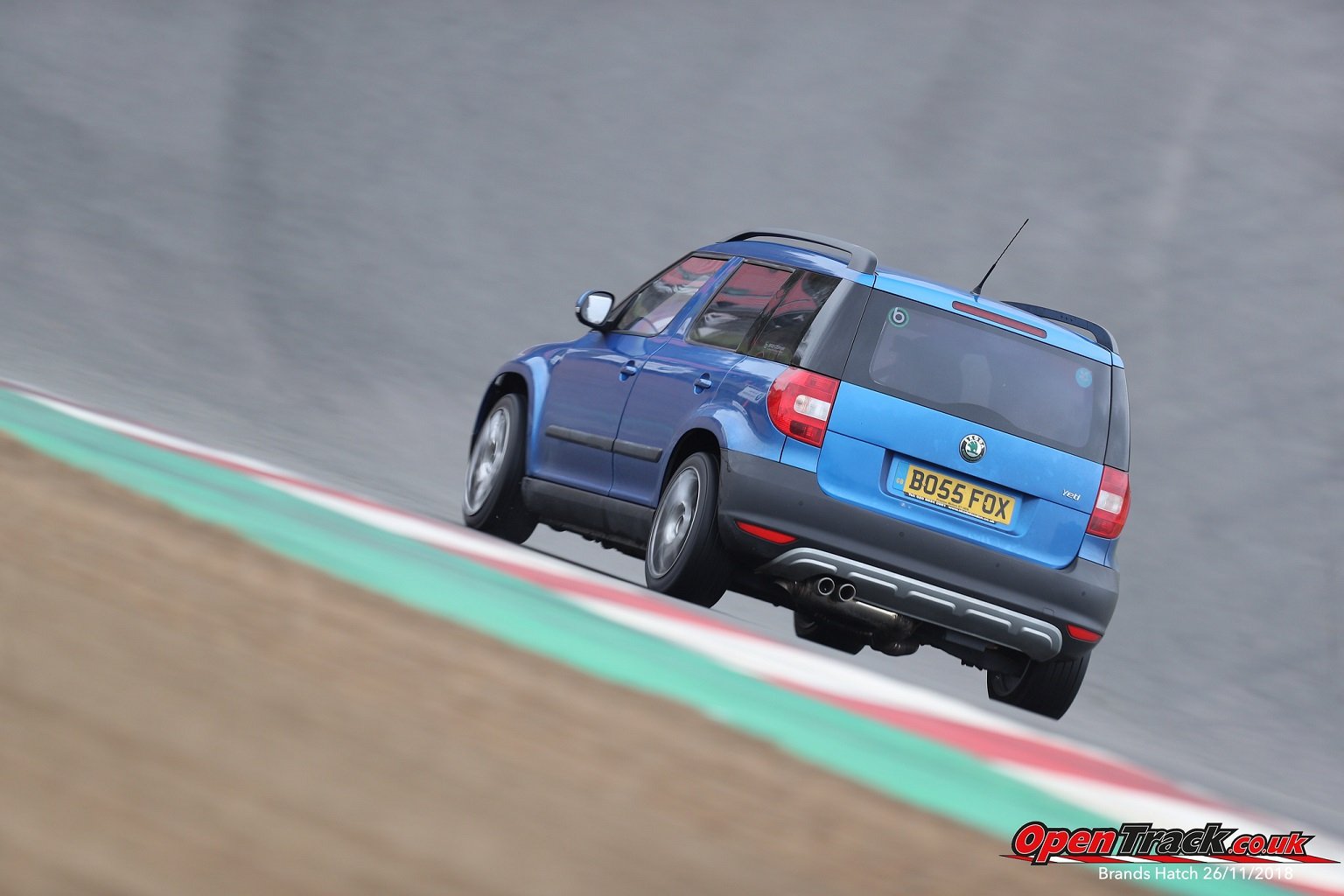

Said to someone on the pitwall that the Gold GTR was doing about 145mph at the end of the straight but the YETI looked like it was hitting 150mph so not far out with my estimate. Looked and sounded INSANE, fantastic effort by everyone involved with the PROJECT and makes every Skoda OWNER fill with PRIDE.:envy:

And a little bracing for the polycarb screen as it deformed slightly as we hit 152mph at the end of the straight.

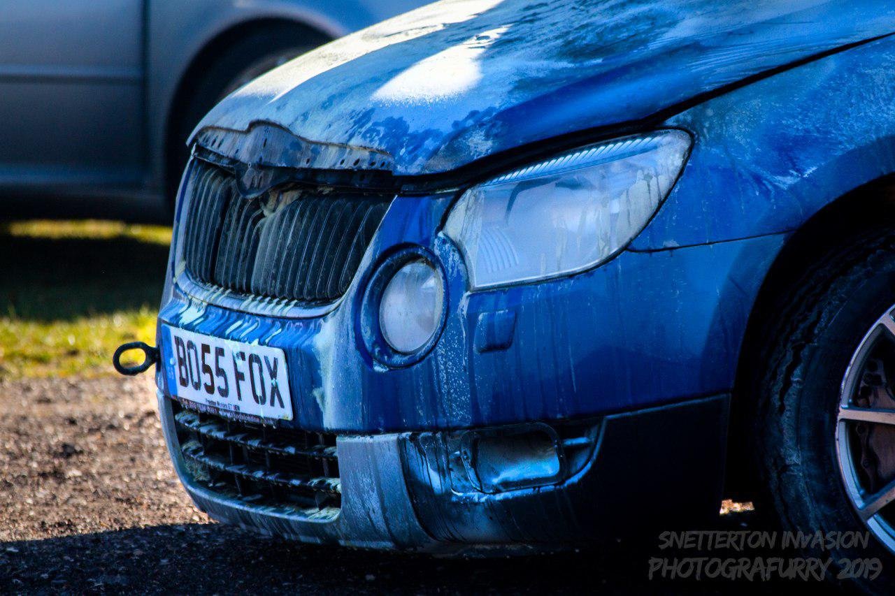

At Snetterton yesterday we hit a slight issue.
Initial investigation looks like a fuel leak from an injector or somewhere in the top half of the engine day.
Coming onto the Bentley straight the engine lost power, which was the Syvecs ECU cutting power due to low fuel pressure apparently.
Then it cut out.
At which point I started to get smoke in through the air vents, so pulled onto the grass and got out.
The MSV Marshals were on the scene quickly and deployed a fair number of extinguishers into the engine bay.
Then the car was recovered back and washed off before being taken back to the workshop.
It looks a bit sorry for itself but it's not that bad.
Sure, the soft bits in the top of the engine bay have burnt/melted but all the stuff near the middle/bottom looks OK and mechanically it should be fine.
Probably need to repalce most of the top end stuff like injectors, wiring, cam covers, coolant bottle etc which started to melt in the heat.
Will update with full report when we know the full story.
Main thing is, that's a car in the picture above that still looks like a Yeti, not a burnt out shell.
It's not terminal and it can be fixed.

No the old engien is toast.
All we can do is sell the cams off as switching to the newer design so don;t need them.
Some of the foam got into the engine.  It's toast.  Starting fresh with a better base engine.
