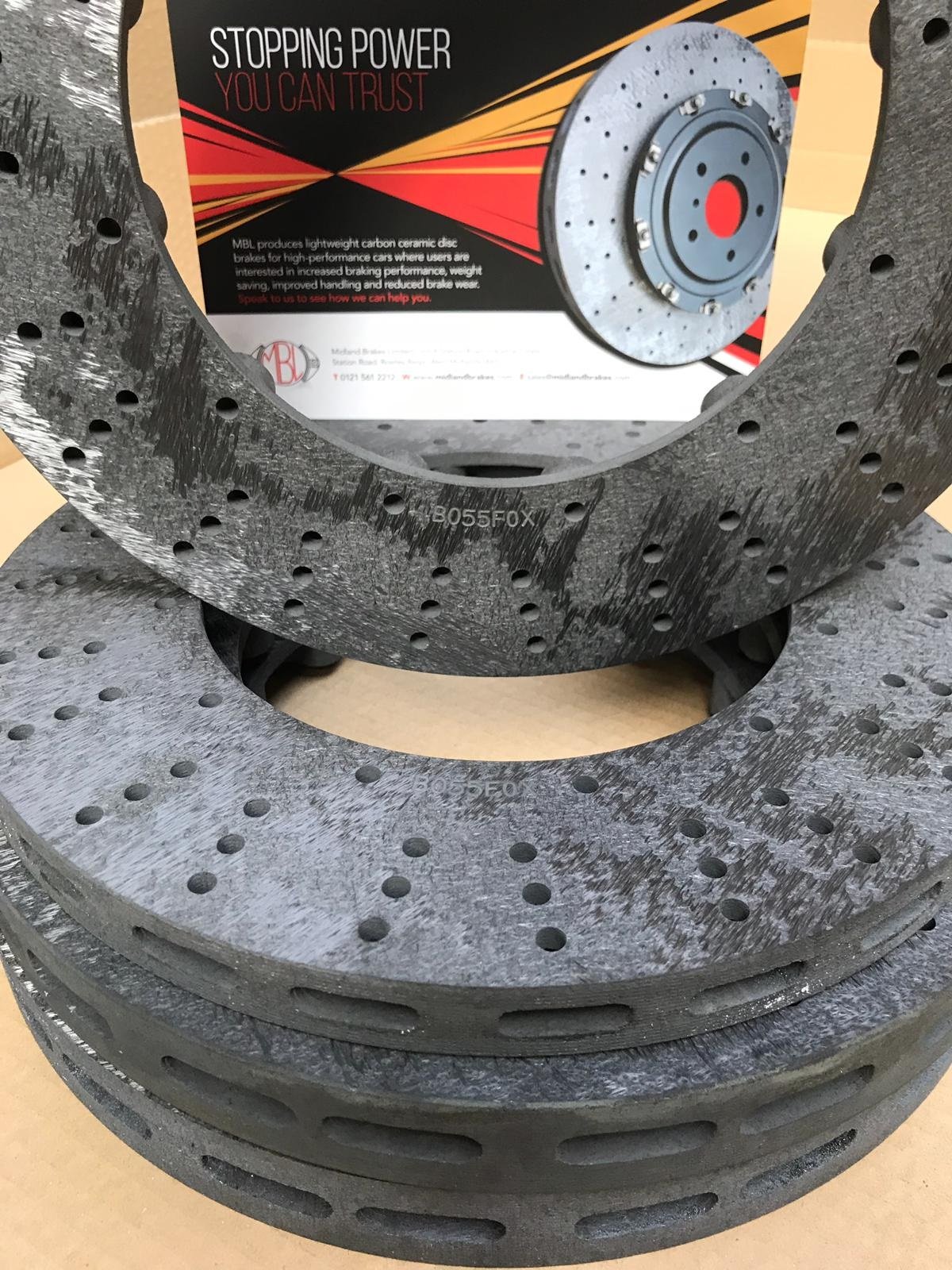

1 minute ago, BossFox said:
After adding a lot of extra go, and reducing weight, we are also adding a bit of extra stopping power.
With bonus rotating weight savings!
Only just spotted the subtle etching on the disk - additional weight removal? ;)
Do need carbon pads to work with these ceramic discs?:blink:
Not special ones.
We will be running Pagid RS29 pads as recommended by the disc supplier.
There is a specific bedding in procedure with carbons to transfer friction material on to the disc for optimum performance.
So with their suggestion of pad and procedure we should be good to go soon!
Not special ones.
