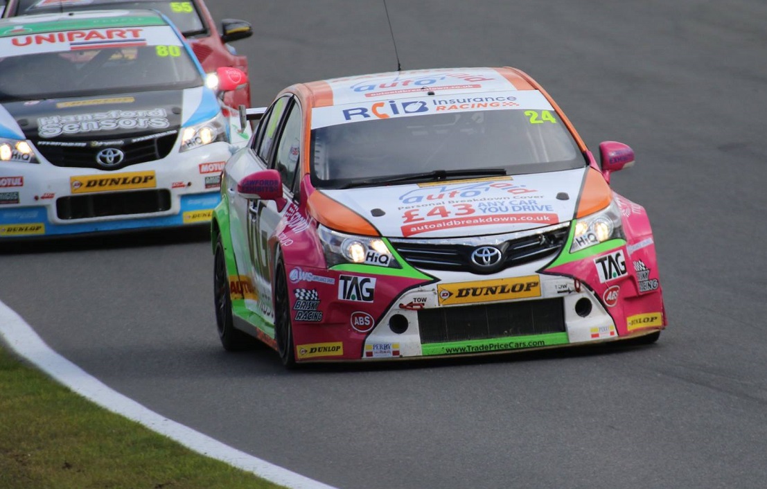

There might be some exciting news about this later on today.
But it's not Yeti related.
something Jap that had a brake recall? :notme:
Not quite...  but will try to keep this thread more Yeti based. :)
I hate you. :) haha
Edited by Copey
Is that the car Jake Hill was driving this season?
Looks like it.
That would be awesome to see that on the track amongst us. Especially when driven by Jake.
Yes
The Elan would have been a good choice but Jake's car will suffice  :D
Nice one Richard, does this mean BTCC privateer next season?.. :D
Be good to see it in action, will try to swing by at the track day, be good to catch up with you and the gang.:)
