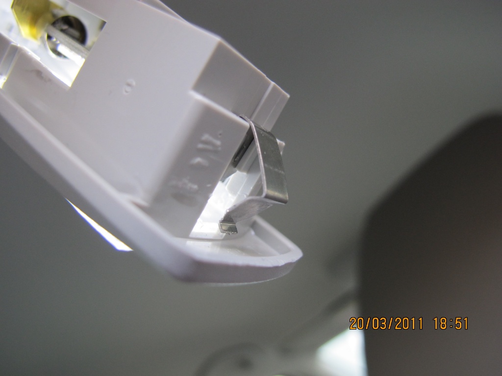

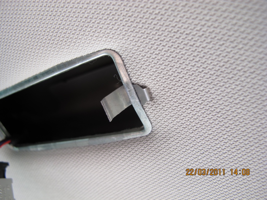

I have replaced mine and they can be difficult. I learnt the hard way and broke a metal clip.
Basically you need a very thin blade screwdriver and need to push a metal clip towards the rear of the car. You need to be very gentle, and make sure you are pushing between the light and the metal frame that goes round the headlining. If in doubt, don't do it.
Here is the light and the clip you need to push.
The metal frame with my broken clip.....
Thanks for that looks easy enough to do I take the bulb in there is the same as the boot bulb then
