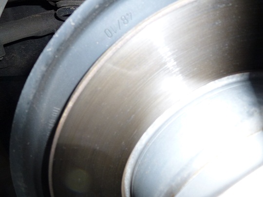

Since refitting the alloys I've noticed the rear discs appear to be getting more and more corroded on both sides; beginning to wonder if the callipers are not sticking. Any other 4x4 owner with the Bosch callipers (from WK45/09) experienced this :wonder:
Rear discs; similar both sides.

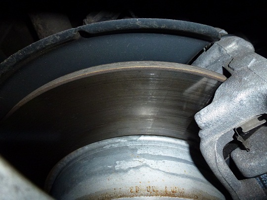

Front for comparison.

Just to update my thread;
decided against taking it to one of the local dealers, as the quality of their workmanship in the past has been left wanting. Therefore I asked a mate of mine who teaches motor vehicle to have a look, which he had chance to do this morning.
Found that there was little movement from either sets of pads due to a build-up of hard crud in the stainless steel clips, which both hold/support and allow the movement of the pads against the disc. Neither was there any sign of any lubricating medium to help retain this movement.
Cleaned everything up added a bit of copper slip and put it all back together. Of note however was the level of surface corrosion on the calliper castings (she's only a year old), some of which had to be ‘brushed’ off to get the clips seated correctly back into the castings. Also the calliper piston acts directly on the outer face of the inner pad, the witness makes to this suggest that neither piston is acting square in the middle of said pads but slightly offset, again reducing the effectiveness of the pad acting against the discs with an even pressure :S
Of further concern was the condition of the discs which are in a generally poor state. There’s a noticeable ‘step’ between the clean inner disc face and the corroded and grooved outer section. Hope with use this might improve, as the 20 mile drive back only managed to clean off the high points in the corroded area, despite re-facing the pads to remove the corresponding grooves. Otherwise it’s new discs and pads after only a year :doh:
