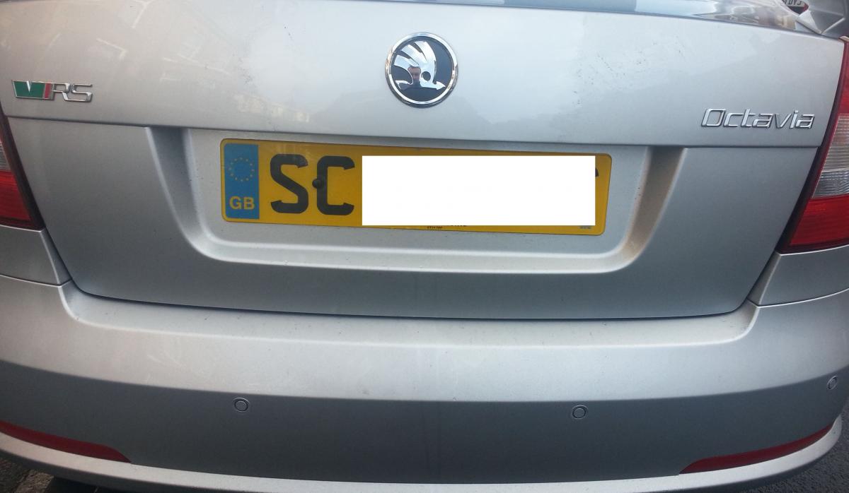

I know its not to everyones taste but i now have the new citigo badges on my Silver Octy & to me it appears to be a lot smrter than the previous coloured badges that had white worm & the car is only 2 yrs old.
At least these wont go the same way as the old ones
Please excuse the slightly dirty car but the current snow / rain & grit doesnt help the photo, the grille came off & was thoroughly cleaned before putting the replacement on, & the rear was also cleaned & clay barred before sticking the replacement.
