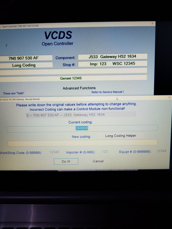

Unfortunately there is no 'long coding' button, only a 'long coding helper' which isn't much help. I will try and attach some screen shots of what I am looking at.
Can't upload any more pictures. But by clicking on the long coding helper I am greeted with the long coding screen with a drop down box containing:
00 Control module NOT coded
35 Vehicle platform PQ35/PQ36 (already selected)
46 Vehicle platform PQ46
I have tried selecting the 46 but nothing changed, so I changed it back to 35.
I also went through the 'Installation list' but no mention of RHD and all the boxes are ticked for what my car has installed.
Any thoughts?
35 is correct for byte 0, you should check byte 1 and 2 :)

you need to get to the other bytes in the long coding, using the down arrow on the keyboard
you will have
Byte zero = Vehicle Platform
Byte one = vehicle make and body type
byte Two = LHD / RHD and number of doors
Many thanks Langers2k, that did the trick! Well happy! Still getting the fault code of CAN gateway incorrectly coded, but I suppose it is because it is not the one that is supposed to be in the car??
