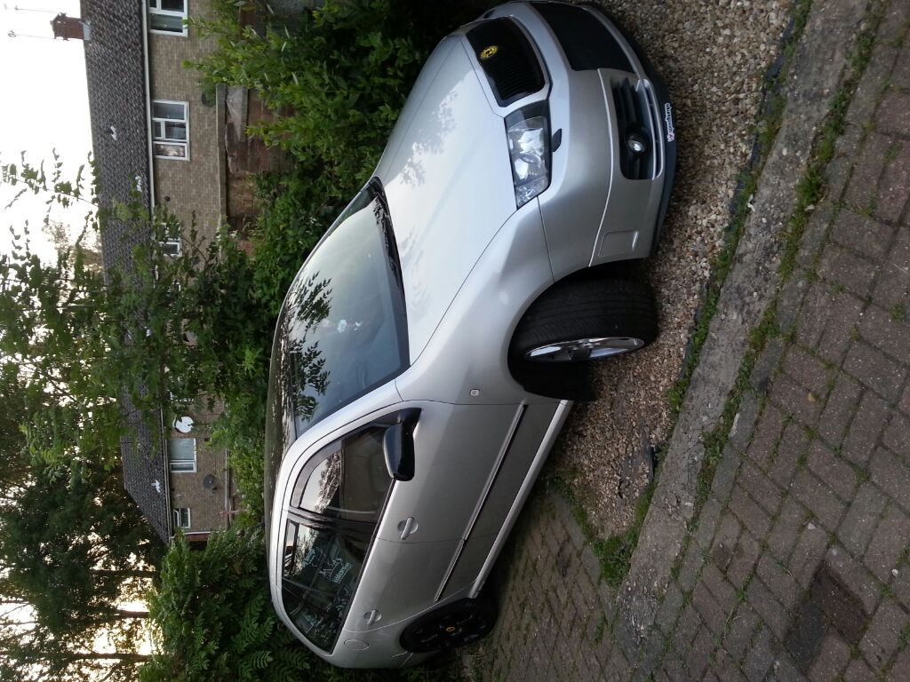

Are you talking about my picture as well as the OP?
My tyres are defiantly wider than the rim
Sent from my GT-I9300 using Tapatalk 2

Those on OPs combi are 205/40 17 on a 7.5" rim which is well within spec.

Sorry about the side photo
Yes I was. It might be me that edge of rim is visiable or edge tyre protector sticks out. Either way to me (based on that picture) that tyre might be 10-20 mm to narrow tyre pressure or damage to tyre caused to look like that. Its hard to tell without seeing life.
