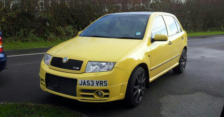

  • Got abit further with this now and am pretty happy so far. This was the first mock up just to see the size and what else needed doing as in other supports etc Second mock up started today and thi
  • Sorry only just seen this. I am nearly finished just waiting on a couple more bends to replace the top pipe from egr. Jkevs i will pm you.
  • Here you go southy, the fabia is 140mm at its widest and the ibiza is 100mm. It is also alot lighter than the fabia item. Also my fabia crash bar is the shorter type as there are two types thats wh
Cheers mate appreciate the comments, nice to hear :)
As already said, good work!
Shame you chopped the bar, Only to virtually remove it! Lol. Had my bumper off today to sus out whats there ready for my intercooler build, need to order that crash bar now to save some room!
I know but what was left was pointless being there so i thought i might aswell do it and not hide the cooler away. It would of been alot easier if i had a thinner cooler though.

Any pics of this piping down right hand side bud? Want some clue as to how to run mine :p
What do you reckon it will run?
Im going to go for about 210bhp and limit the torque to around 300 but will up it after i get a clutch
Its the same set up as the txautosport from the right side i couldnt find a better way of doing it to be fair.
Done a quick search and found it inanother thread of yours. I dont really like the idea of running it all the way back underneath.
Ill probably go passat inlet manifold and run it that way i think, just need to get hold of one!
That will be cool to see i never thought of that before, keep me updated with it all be interested to see it.
