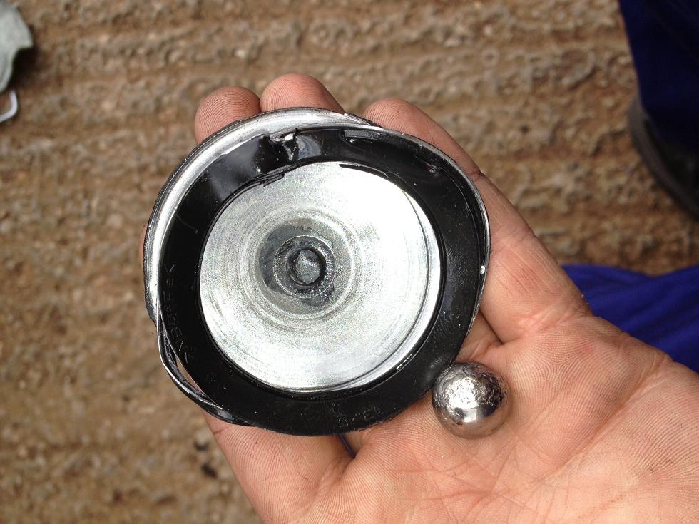

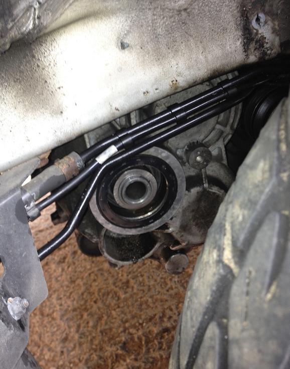

I managed to have a quick look on my lunch break...
Needless to say I have found the culprit.
Not as bad as I thought, although is this a "top hat" type bearing? i.e. gearbox out job to replace?
Left my darn Haynes at home.
If anyone has any clues to the part number (cant find it on vagcat) it would be appreciated.
All I can come up from the knackered bearing is 07M 301 377 B, and GC 79 9.8 W02, again, these arent on vagcat.
If it indeed can only be inserted from the other side, its gonna be an expensive fix to pull out the box and dismantle....
