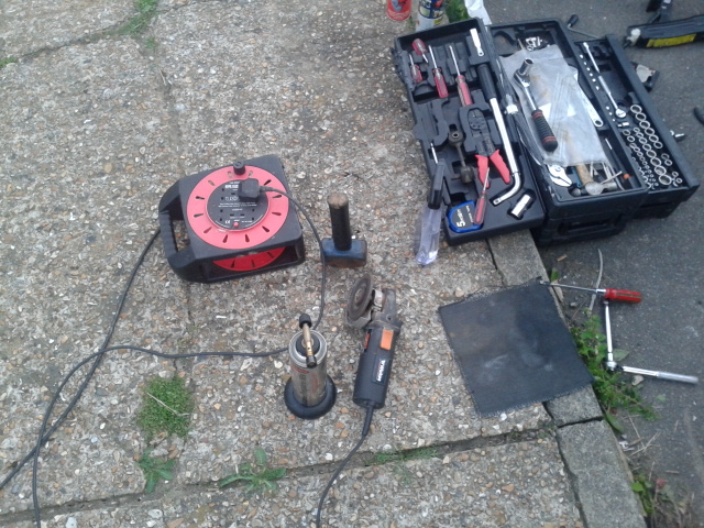

tools used to removed top mounts that broke preventing us from undoing the blots
Hammer heat and a grinder! The correct way :)
Got a bit extreme for a couple of top mounts. All seems good now though. Hopefully the annoying knocks are fixed :)
