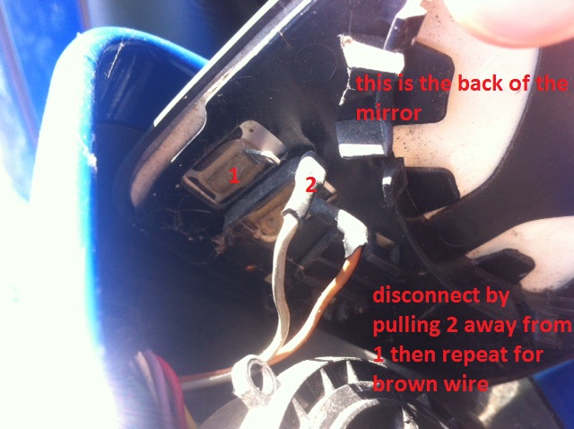

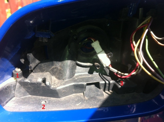

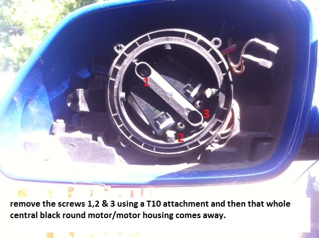

from the attached pictures could you give me some guidance. is this the same as your one that you have done?
you can see how far i got to replacing the wing mirror indicater/puddle lamp form the pictures attached. i dont have a T10 alan key to remove those last 3 screws (if they are the last piece to the puzzle). do you have to remove them to get the lamp out?
Also after reconnecting everything together again i tested my wing mirror adjuster and now, if i adjust the off side mirror the nearside mirror moves at the same time but in the opposite direction. the near side mirror (the one i slightly dissasembled) still adjusts independantly. WTF!? i am pretty sure they both moved independently before. all i did was disconnect the heating. i left everything else plugged in as there was no need to unplug the cables going into the motor/motor housing.
Yeah I see where you are at.
I didn't remove the motor. I did remove the casing (beware the finger pain...) then worked with a T10 torx screwdriver from the top to get the base off including the indicator. IIRC the casing and the indicator locate together so you may need to take the casing off first.
Does that help?
But unfortunately I don't think you can buy a cheaper replacement for just the indicator unit with say a cut out for the puddle lamp, so the cost is 40 quid once the indicator goes regardless.
Adam

Also, you don't have to remove the motor to replace the indicator unit. Remove glass, and with the old "gently but firmly" grip, pull the coloured surround upwards, it should pop off and give straight access to the torx-screws. If you've installed an LED in the puddle light, don't forget to change that over too.
