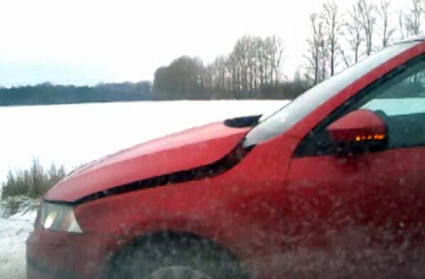

Look at the picture from Superskoda (already linked by ahaavi):
There's a black plastic thing on either side with some fairly chunky looking wiring -it isn't easy to see if it is a solenoid or some sort of pyrotechnic plunger -if activated it probably mangles the bonnet or hinges or both.

She's off the hook, I've found the wiring, definitely active on mine!
