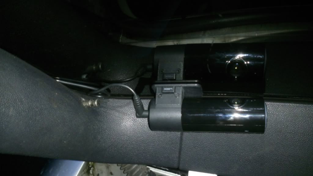

It is when you have a multimeter. It was the black wire on the wiper motor plug which was the switched live. This was traced into the top corner of the screen, and spliced in, along with a convenient earth - think it was brown wire.
Installed
Installed and on
View from rearview mirror. Its sort of tucked away up a bit so I don't really see much of it.
View with boot open
I'll borrow a multimeter :whew:
looks good, though, cheers for the pics
Just a little excess wire to tuck behind the trim but I wanted to ensure there was more, not less, when it came to plugging it in. :D
